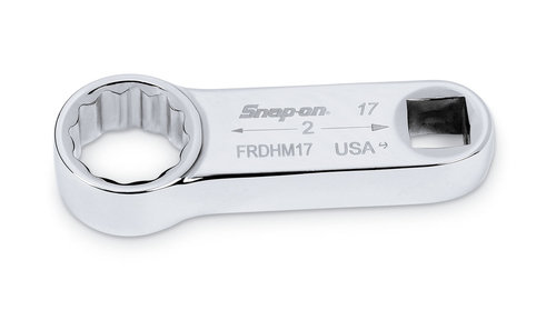

    Did you guys torque down the bearing assembly bolts? I could only fit a wrench in there, and I don't believe a socket would even fit in between. Looks like its supposed to be 59 ft*lbf. Mine's making a slight noise each rotation, maybe mine didn't seat completely right (my fault/first time installing this).

    To do that properly you’d need a torque adapter.
    The bolts come with a lock tight type coating on them already, no need to add but if already did probably wouldn’t hurt.

    @lo2hi I would think a crows foot would be the appropriate tool to use for getting those bolts torqued.

    Nice! I was wondering about the name for those adapters. I did both wheel bearings without them, and just got them nice and tight.

    but anyway, I've been told that if you use a crows foot at a 90 degree angle that it really should not affect the torque settings. no it with that being said I would probably use the shortest one possible at a 90 degree angle and take it with a grain of salt.
    Obviously if you use a crows foot straight on and extend the length of the tool that will affect everything
