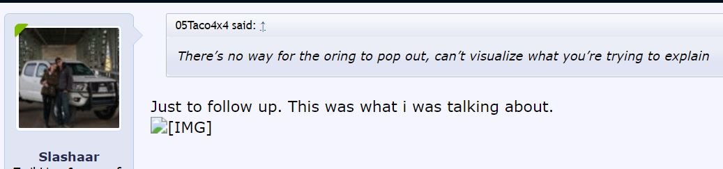

    Dangit. I'll reupload when I get off.

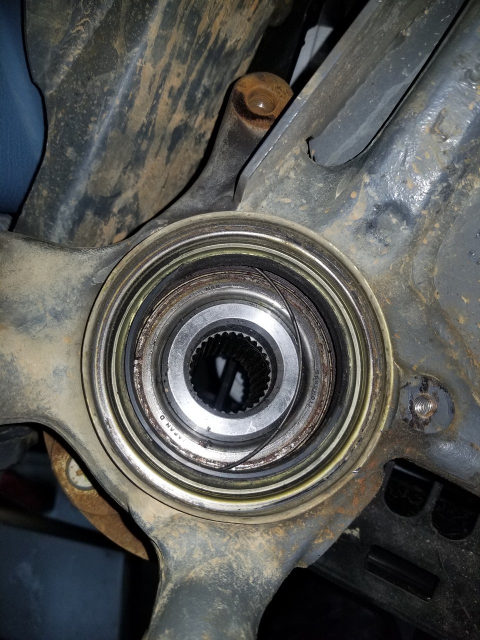

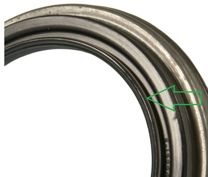

    That looks to be the spring out of that seal, there is no o-ring on that side of the spindle

    Alright thanks.

    I have the same issue with one of mine. Won't hold as the seal that keeps it in place is torn on mine.

    Well I was told I needed to replace a seal (since I bought these used), but I didn't know if that was a separate issue and just wanted to double check. After looking at that picture it makes more sense now.
    I think I have them but I need to double check what's on my shelf in my garage.

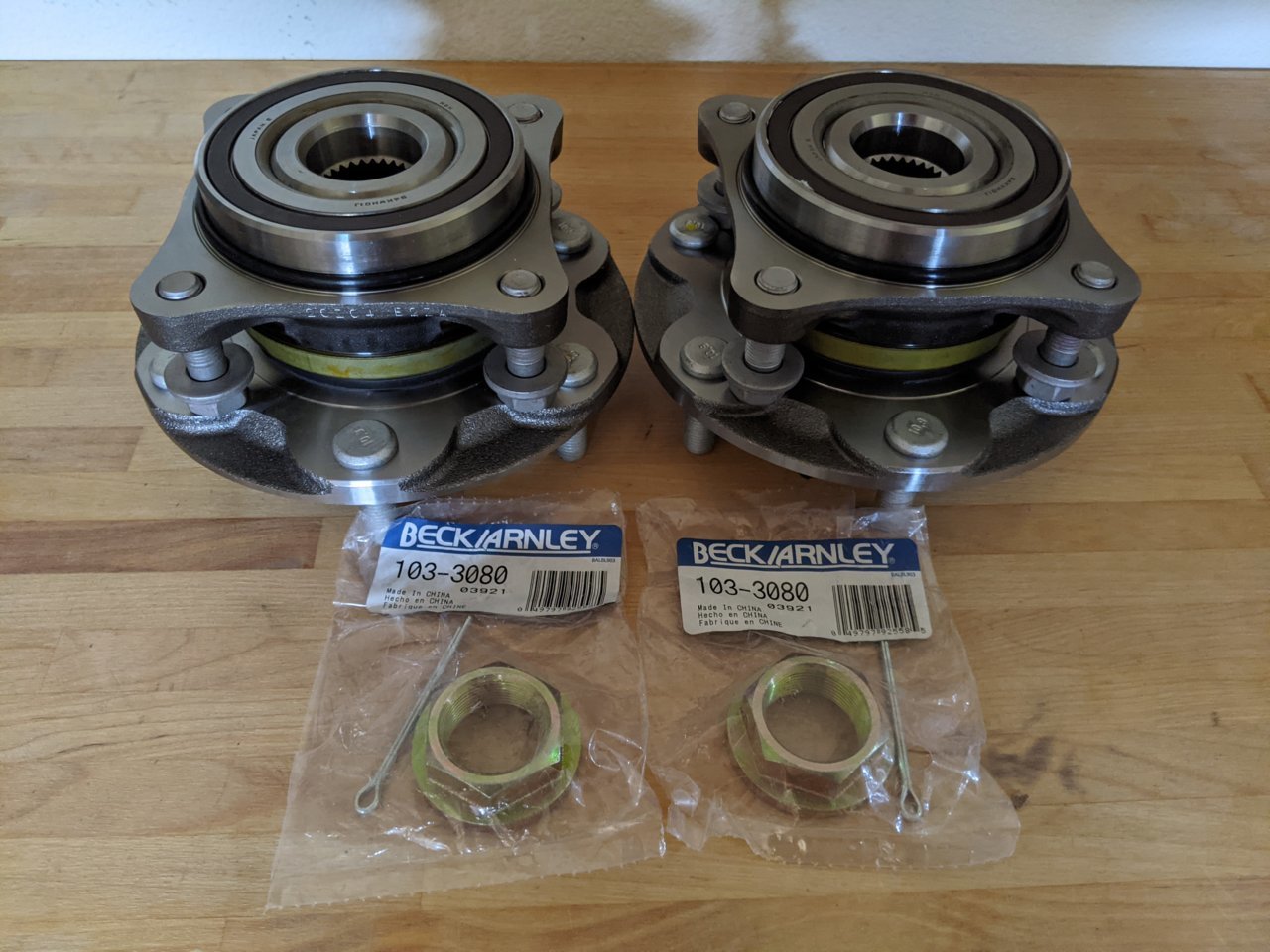

    Got the hubs today. Look real solid. Thanks @05Taco4x4 ! Hoping to install them this weekend.
