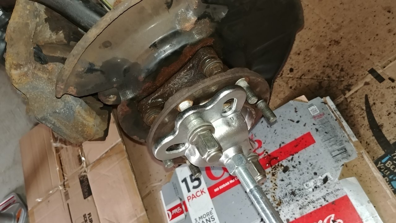

    Got a problem, need advice ASAP. Cannot for the life of me get the wheel bearing hub/assembly off. Just borrowed a slide hammer, thing is not even budging. 35mm nut is off (4x4), 4 bolts all loose. Its like it is locked on the spline or something. Can I shoot PB blaster in the spline area? 130k miles thia thing is corroded to all ****.

    Is the axle out of the hub? Once out I had to wail on my old bearing with a 3lb hammer and use a crow bar and stuff

    If CV stub still in it, put round end of ball peen on end of it and hit other end of hammer with big hammer.
    You can’t back the 4 bolts all the way out and pull it- you have to back half way out, slide hammer it, finish back bolts out, then slide hammer out again

    Trying to post a pic.

    I need to hit the CV shaft inwards...?

    Bolts- back the bolts rest of way out lol

    Its not stuck on the bolts.
