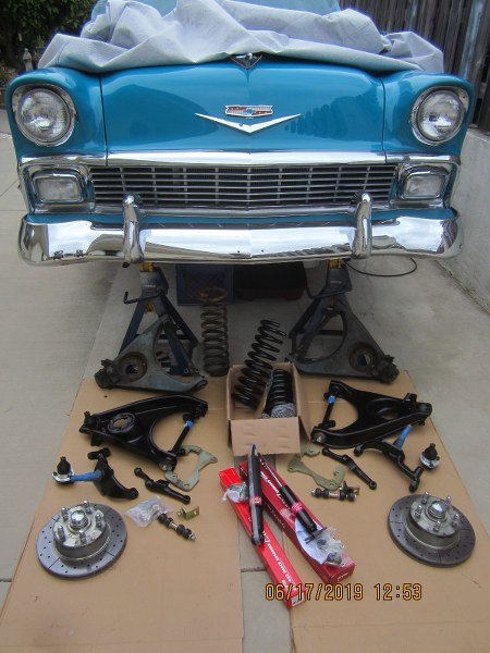

    Thanks for all the input!! I need to get a decent shop book for the Tacoma. Is a Haines manual decent help?
    I’m not a newbie, just haven’t done a Taco. A197CDB0-D90E-464B-806A-B2A36DB3B759.jpg
