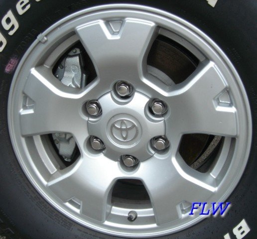

    You guys have been extremely helpful. Hoping to get some more advice, I had a caliper on the passenger side hang up. Wasn’t able to get to it for a while and it’s left HEAVY brake dust and corrosion on the rim. I’ve been trying cleaners from my local parts store and Walmart but nothing is touching it. Found this acid based cleaner on line but it warns not to use on “PVD, polished uncoated aluminum, plastic or anodized rims.” Wasn’t sure of anyone knew if the rims fall into any of these categories...

    Those look like the wheels on my truck.
    I’m going to say they are coated. (Powder coating?)
    The coating on mine has been coming off for years.
    Some will claim it’s from using a loose socket on the impact wrench.
    But mine actually started peeling on the “spoke” of the wheel first.
    I’d personally NOT use the cleaner you mention.
    Simply on the fact, that if there is an abrasions that goes through to the aluminum.
    It may cause the coating (powder coating?) to peel off.
    FWIW, I think early model trucks might of had a TSB on the coating peeling off.
    When I found out about it, it was too late. No big deal to me.
    I just don’t “scrub” my wheels as often.

    Zep Purple Industrial Degreaser is a good off the shelf product. Can be found at almost any Lowe's or Home Depot. For filthy wheels I use a wheel acid from Meguiars, but for the average person I'd avoid that as it's something you have to be super careful with. Those second gen TRD wheels are painted aluminum and with age and certain conditions will corrode and peel like mad. I can confirm a wheel acid will make that problem worse, but I knew the risk going in. Meguiars also makes a Non-Acid version that is really good, not quite as strong, but works well. Unfortunately it has to be ordered online by the gallon. However if you dilute it to the lowest strength it will be cost effective and is a good daily wash cleaner.

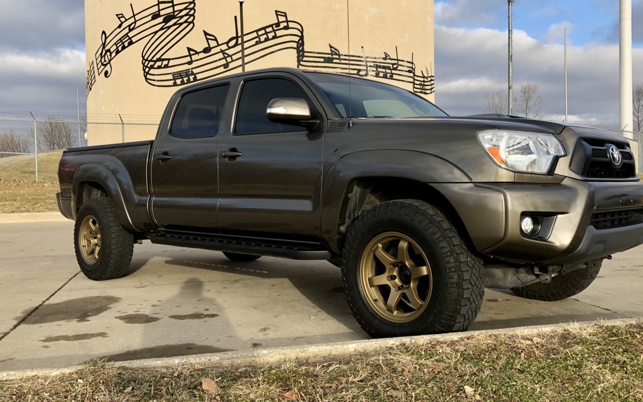

    If it is from brake pads you will want an Iron Decon. This is available in most autoparts stores. Make sure you spray it on to a DRY wheel, any pre-wetting WILL dilute to be not very effective.
    https://www.amazon.com/Meguiars-G18...?keywords=meguiars+iron&qid=1582293686&sr=8-3
    Next use the wheel cleaner of your choice. I prefer ArmorAll Extreme Wheel and Tire Cleaner, also available at most autoparts stores. I have used MANY other products, all that are mentioned above and they all work but not as well as this. I HATE HATE HATE ALL AromorAll products, but this one is fantastic! What I like about it is that its safe on pretty much any wheel and removes ALL the browning from the tire in 1 or 2 applications with minimal scrubbing that is common for most detailers to run into. This is a must to ensure the tire is as clean as possible for your tire dressing to last as long as it can. Also apply when before wetting the wheel/tire down.
    https://www.amazon.com/Armor-All-Ex...+wheel+and+tile+cleaner&qid=1582293805&sr=8-3
    I have tried many different cleaners, from McKees 37, BleachWhite (good, but only for tires), all the ones mentioned above, a couple citrus all purpose/degreasers and most of Meguiars Professional line of cleaners. So far I am most happy with the ones I shared above. Meguiars D1801 Iron decon is fantastic, but I don't recommend it as it comes in a gallon and not many people need that much iron decon.
    FYI the tire dressing I used below is CarPro Perl mixed to 4:1, I like the satin finish that it gives and decent life too.
