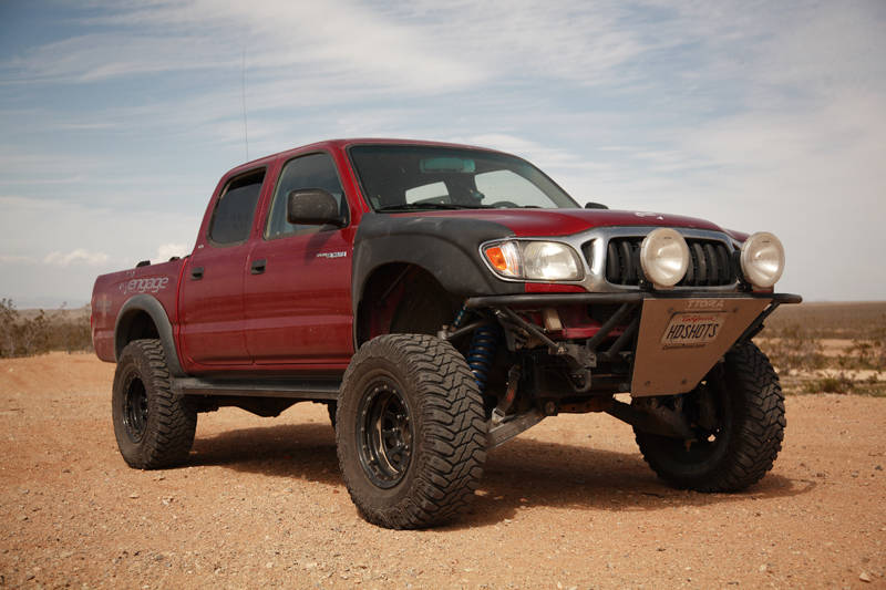

    they will work on a tacoma, just too expensive for a steel wheel that most skip them... they are also heavy...
    as for not seeing other tacomas running them, i have them on my tacoma, and i have seen a few others, 2nd gen included, who are running the same wheel...
