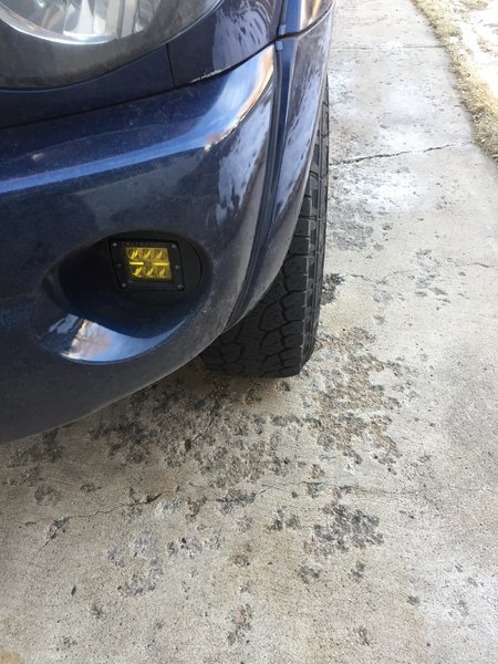

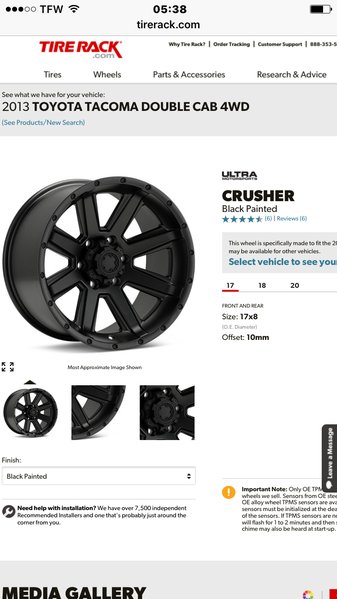

    This may help with your choice

    If you go to the link I provided and put in current wheel size and new wheel size it will show the difference.
    +10mm is close to 5" b/s
    I would shoot for 4.5 b/S

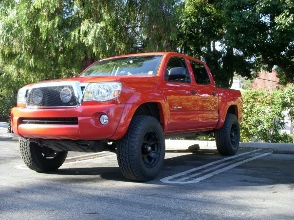

    This might help.
    Different wheel, but same fitment specs. 17"x8" +10mm offset.

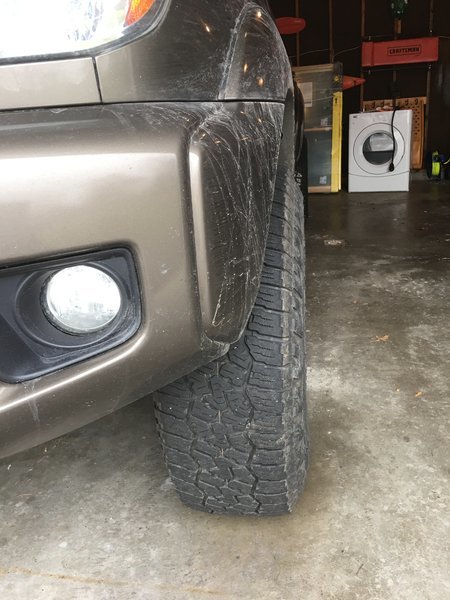

    5100 @ 0” w/ 2.5” Eibach spring, 1.5" Icon Progressive 3 leaf + 1” block, Procomp Wheels, Grill Thin Lip (Custom Car Grills Mod), Access Tonneau Cover, Pop & Lock Tailgate Electronic Lock PL8521
    This is 0mm on an 8" wheel with 265 size tires. Also, depending on the make of tire, they will stick out differently from one another. I had duratracs which we're the exact same size, but the tread stuck out a bit further than my current tires on the same wheels.
