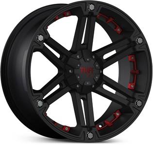

    Well, i think ill go with the -13 then. Here they are in case you all were wondering
    [​IMG][/url][/IMG]
  10. Jul 12, 2012 at 4:30 PM
    tacoma07pre
    tacoma07pre Well-Known Member
    Dec 10, 2011
    #68529
    75
    kansas city
    Those are the same wheels I just ordered in 17x8 +10 offset. I did so because I have no desire to run 285s because of the necessary trimming. With the +10th 265s work great and look really good too. If you don't mind the trimming with 285s then do the -13 offset.

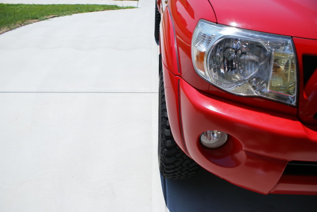

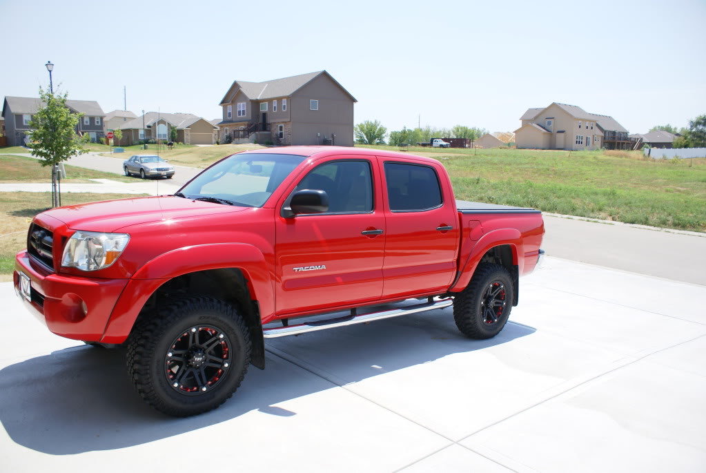

  15. Jul 14, 2012 at 8:18 AM
    tacoma07pre
    Dec 10, 2011
    #68529
    75
    kansas city
    I ordered them from sd wheel Corp. The 17x8 are $525 per set shipped and arrived in 4 days from placing order. I found them on eBay and ordered over the phone for that price. I was also able to use my tpms with these wheels and ordered a black lug kit off eBay for $17 shipped. Had them installed yesterday and all is great. Very happy customer.
  16. Jul 14, 2012 at 8:20 AM
    #16
    tacoma07pre
    Dec 10, 2011
    #68529
    75
    kansas city
    Also FYI..... The red in pictures looks like it may be an anodized look but is pretty much a direct match to radiant red.
  17. Jul 15, 2012 at 9:19 AM
    #17
    WillzTaco
    WillzTaco [OP] Well-Known Member
    Feb 24, 2011
    #51754
    159
    North Carolina
    05 TRD Off Road Silver
    Are you sure the guy didn't just paint the chrome ones red? Lol also post some pics of them mounted please!
  18. Jul 15, 2012 at 2:18 PM
    #18
    tacoma07pre
    Dec 10, 2011
    #68529
    75
    kansas city
    These are the Tuff t01 17x8 +10mm offset with 255/75/17 BFG Mud Terrain KM tires on a my 2007 Radiant Red Tacoma. I am running 5100s in the front on 0 setting with OME 885x coils and a 2" wheelers add a leaf in the rear.

    looks good on the radiant red taco, any trimming to run the 255's?
  20. Jul 15, 2012 at 3:57 PM
    #20
    tacoma07pre
    Dec 10, 2011
    #68529
    75
    kansas city
    No, no trimming necessary.
