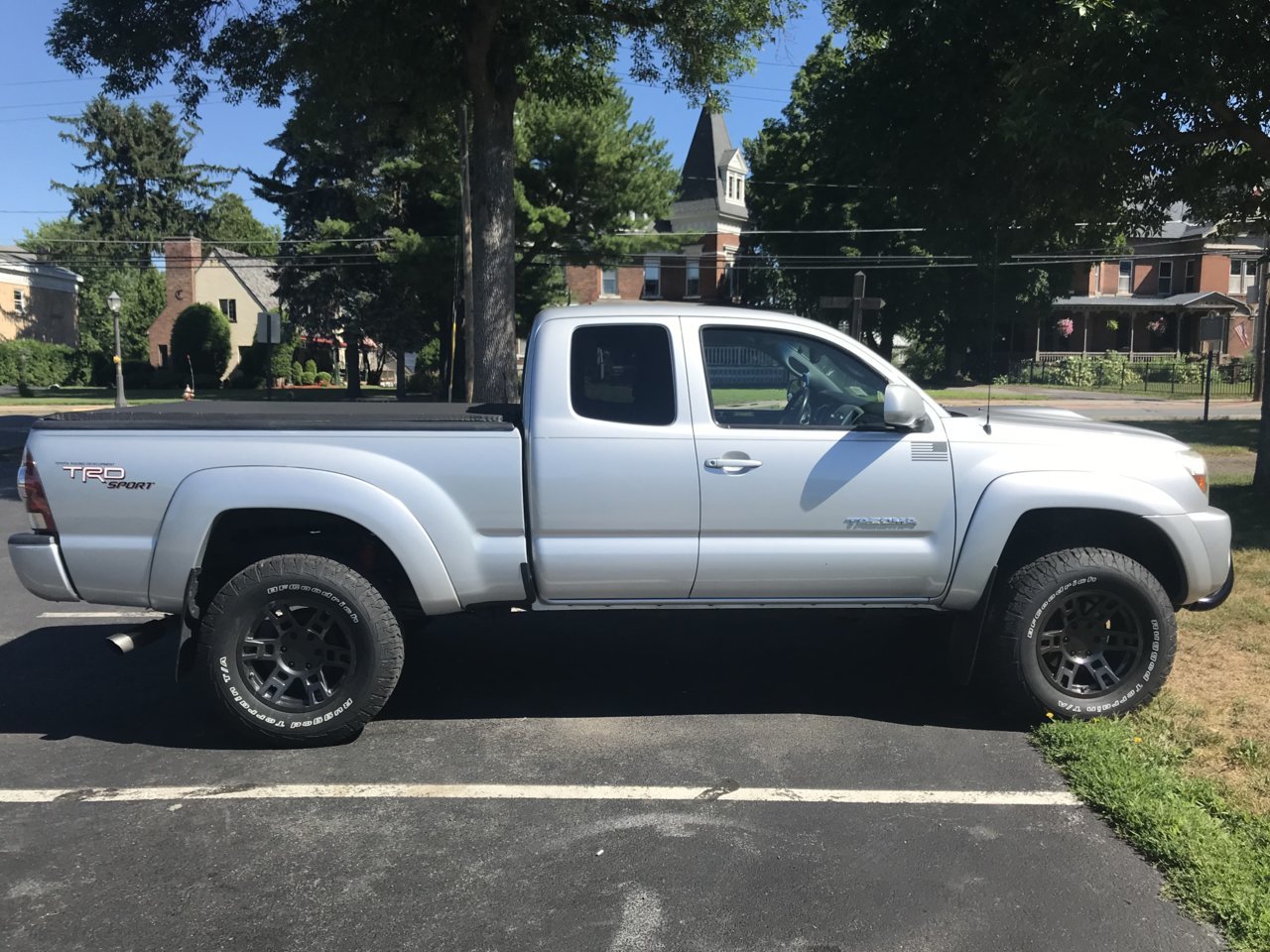

    Call Dustin at FN wheels he will set you up with a nice set of TRD pro wheels. Good price and excellent service. I have the TRD pro wheels with 265/70/17. No problems and that is as big you can go with no issues on a 2.5 inch lift. ThatIMG_1834.jpg s why I got the 265/70/17 tires. That is when it only had a 2.5 inch lift.
