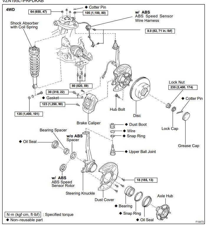

    Where can I find spec sheets for the oil seal and snap ring dimensions? I'd like to replace those too.
    While I'm at it, any other components along the axle I should check/ replace before they go bad?

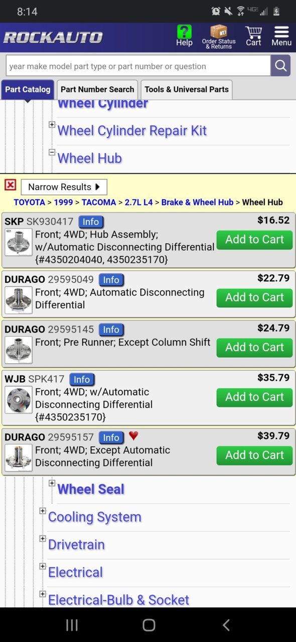

    @0xDEADBEEF rock auto doesn't seem to stock Koyo(OEM) bearings, so I'll probably get them from napa.

    @Old green toyota I have a Manual 4x4. Obviously, no Automatic Disconnecting Differential.
    Unfortunately rockauto doesn't stock manual wheel hubs. Anyone know where you can get them?

    I ordered the manual hubs from the link I posted above. Look at the last listing that opens up.

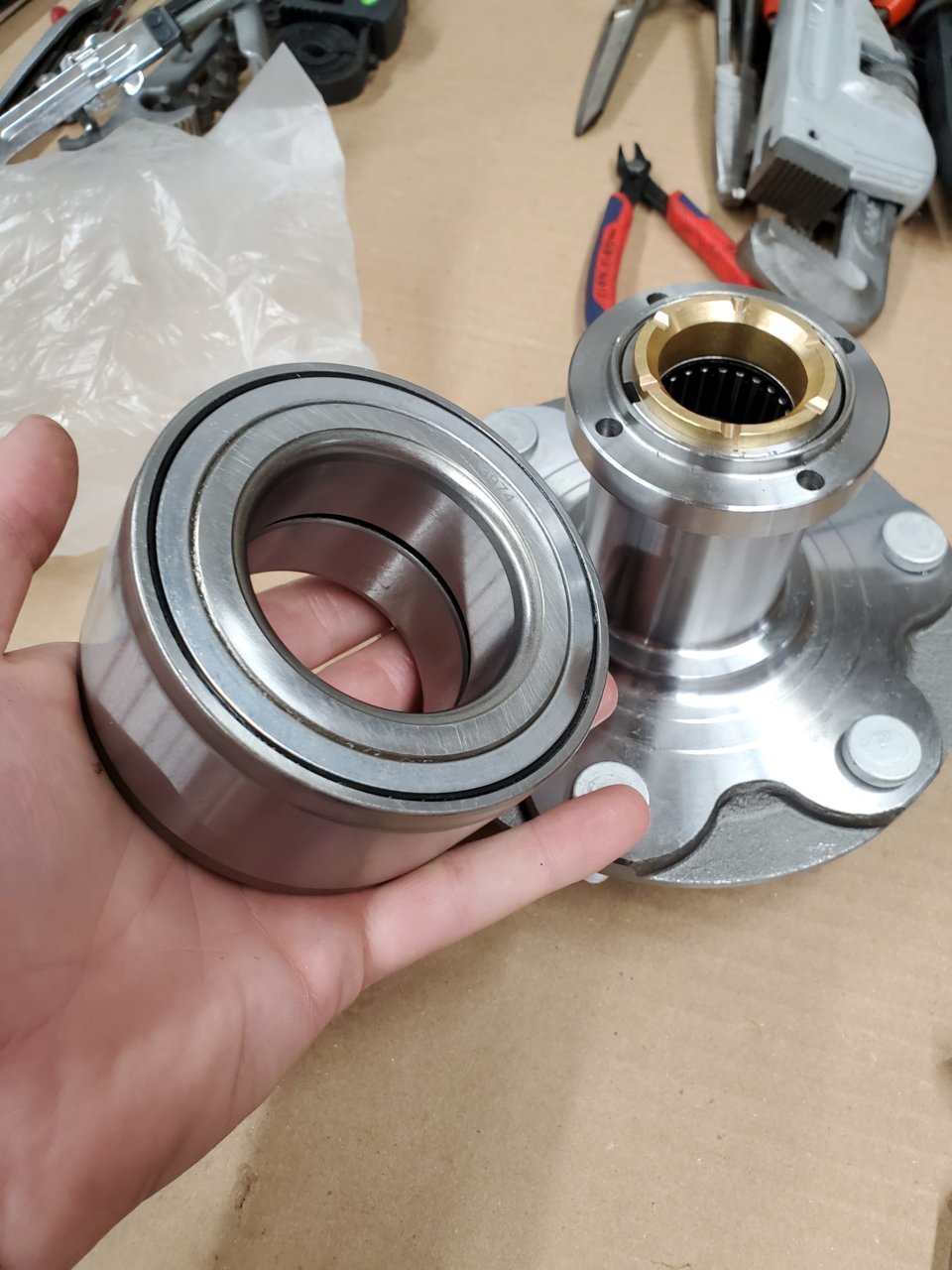

    Here is what your wheel hub looks like WITH ADD
    Here are pictures of non add hubs notice the lack of splines in the bore20200812_102156.jpg
