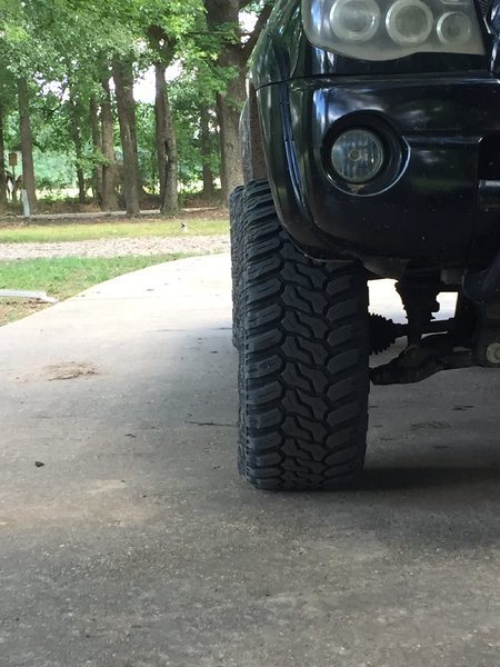

    is it me or does the front wheel look tilted in?

    Like - camber?

    Camber set all the way for the tire to lean in but spindles and hubs are fine no slack in the nor wear, truck only had 102,xxx miles
