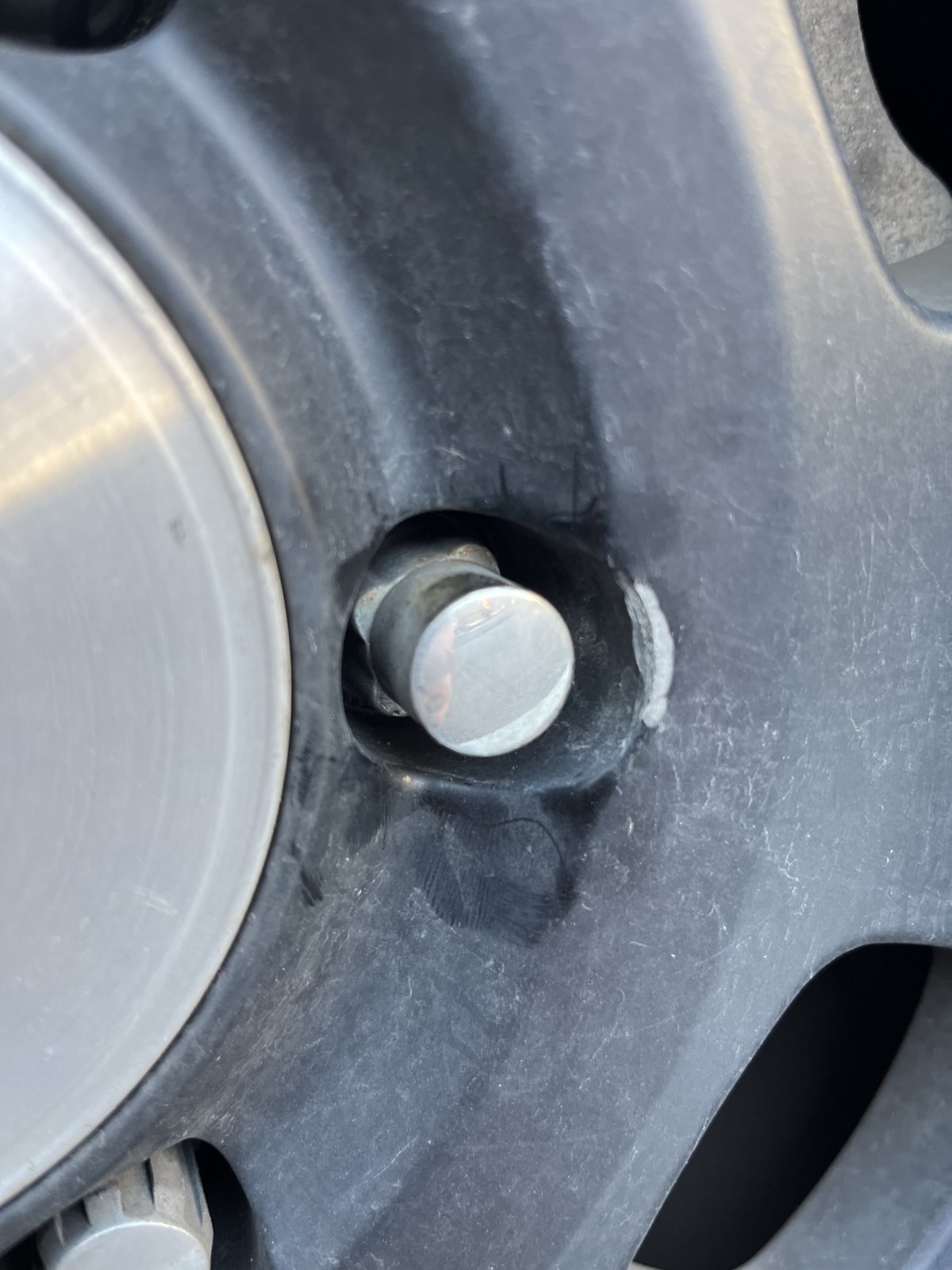

    Hey guys. I need some help with some wheel locks. I bought this truck used from a dealership and it has a set of wheel locks on it that I never received the key for. I have tried every option I can think of to get these off but everything is a dead end. I went back to the dealer but they don’t have a key. I went to a Toyota dealer but it’s not theirs. I went to discount tire to ask them to take it off but they don’t have lugs “small enough”. I went to another local tired shop but they want to charge me $400 to get them off. I’m at my wits end with these.
    Does anyone know what brand these could possibly be so I can try to find a key online? The other lug nuts are McGard brand that I have found the correct socket for but this one on the picture I don’t. It is a 5 sprocket lock is all I can tell.

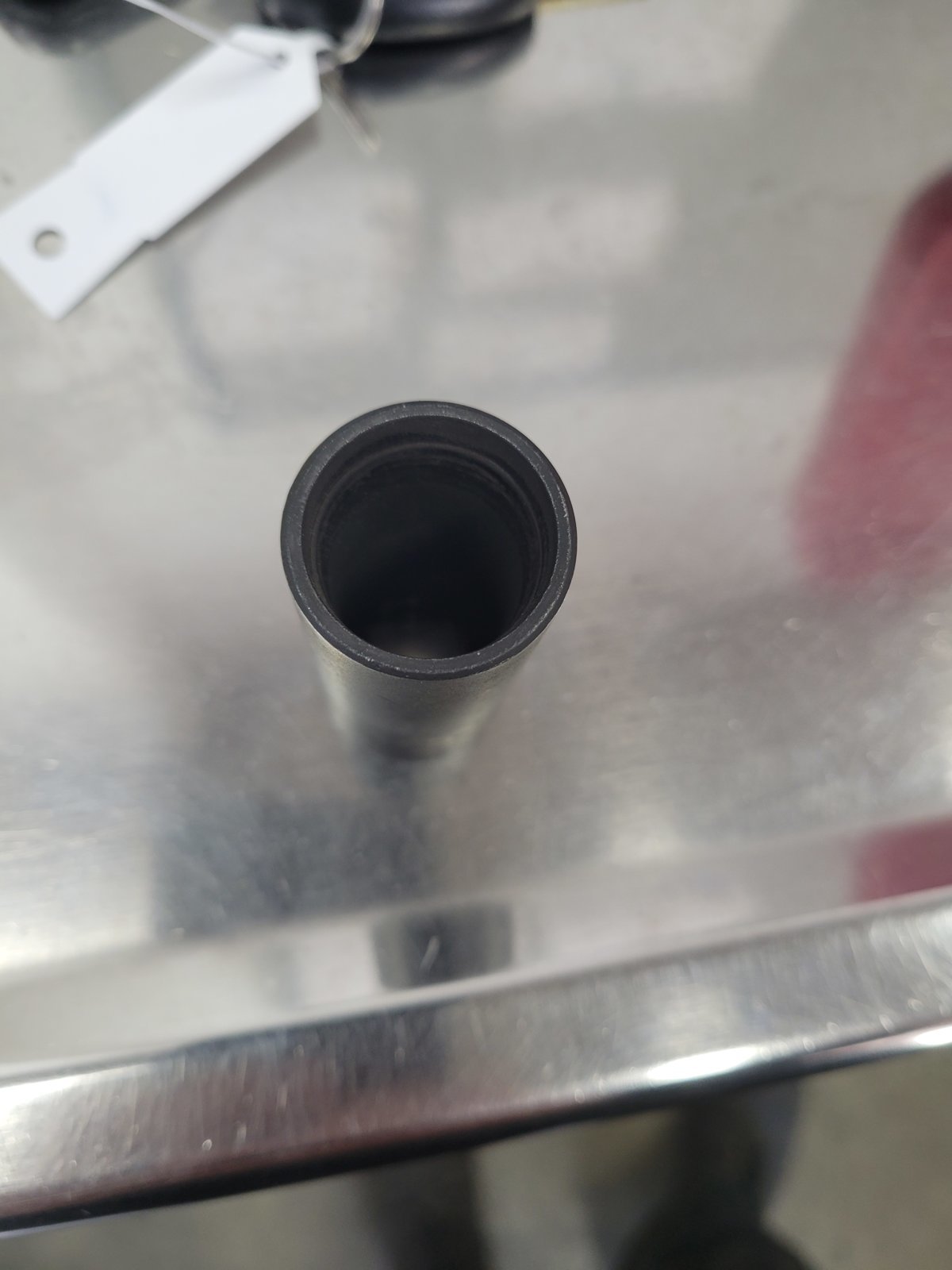

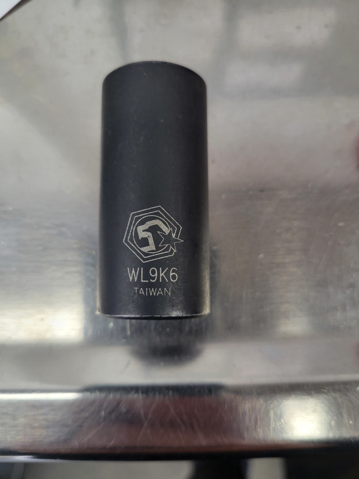

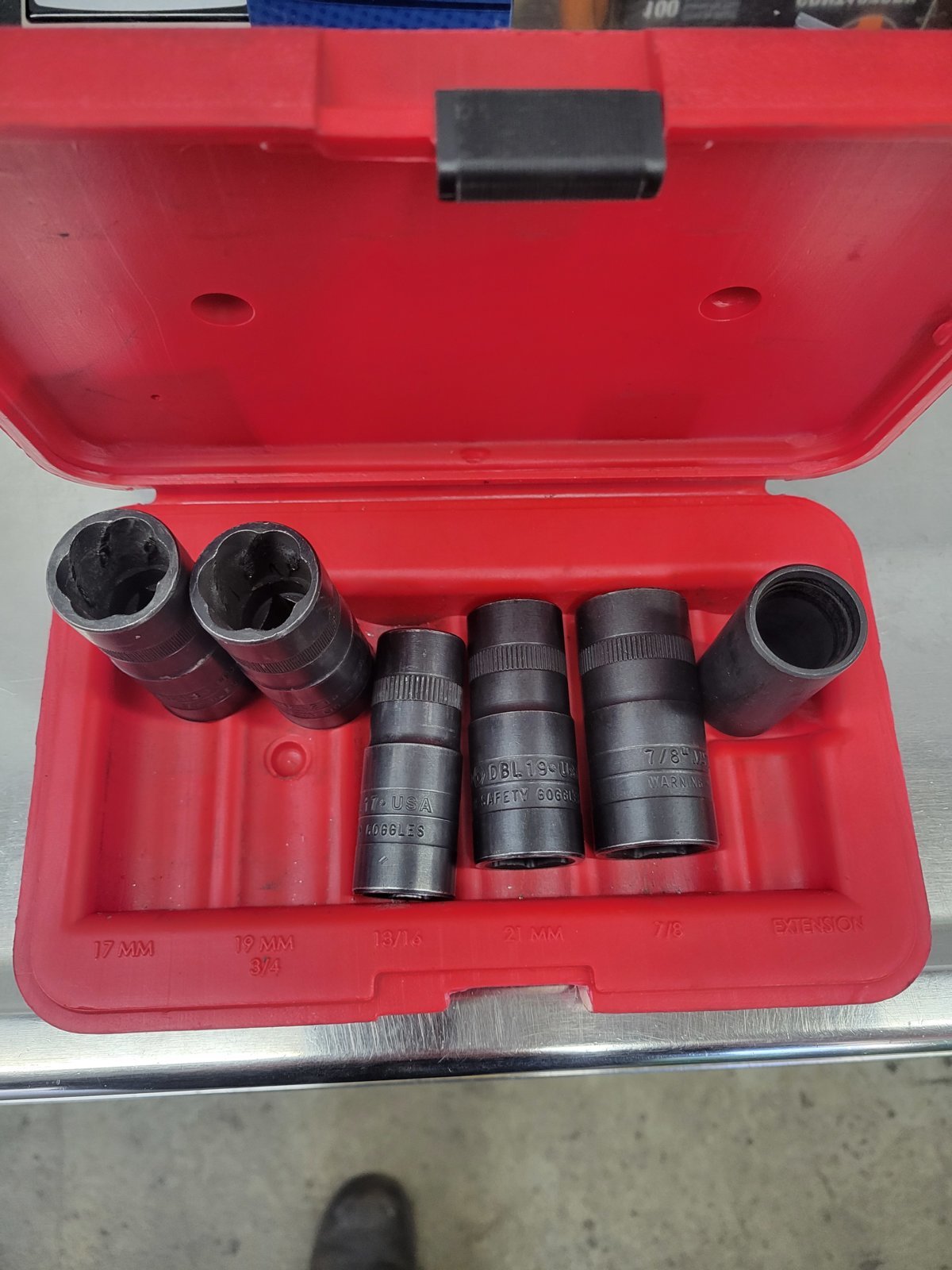

    Matco lug remover set
    And I bought this smooth tapered one that works too, just have to pound it on really good
