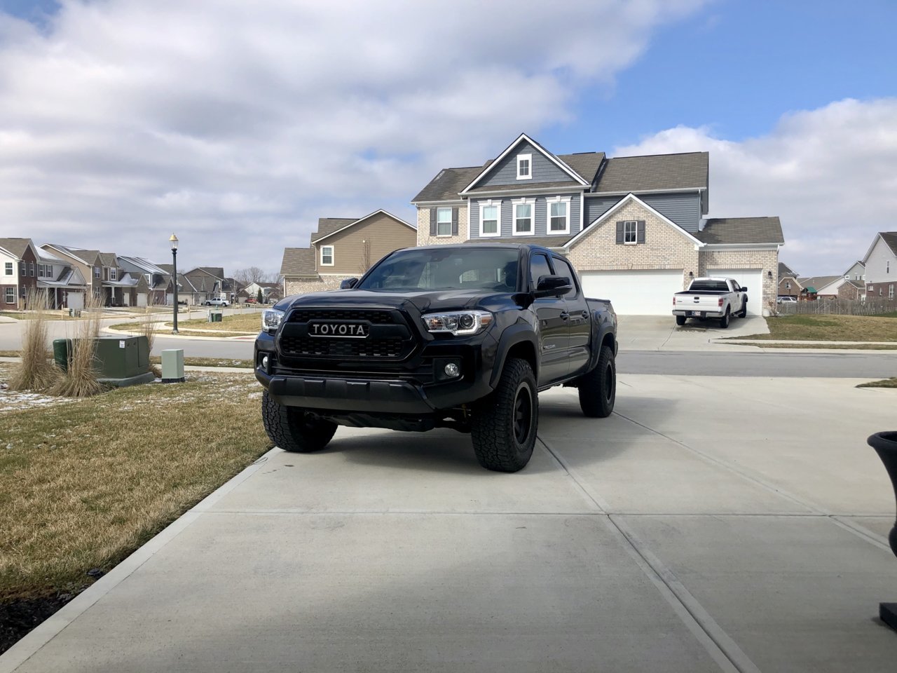

    I may be wrong but if I remember correctly I think the SR5s have a +24 or +25 offset on the stock wheels, so a -12 offset will push each wheel out about 1.5 inches from their current position. I currently have -12 offset SCS wheels on my truck and they sit pretty flush with the aftermarket flares (they're further out than stock) that are installed.

    Do you care to post a pic of it so I can check it out. Offset is one thing I can say I’m absolutely clueless about

    I'll try to grab a pic here shortly, I don't think I have any straight on (or close to it) pics to give a good idea of the pooch. Let me check.

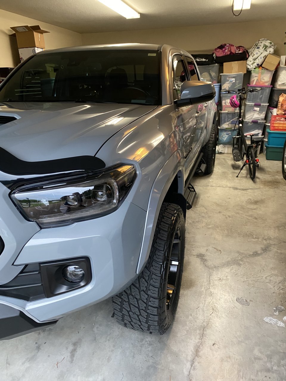

    Agreed - 85\60R18 -12 offset

    285/60 R18 on a 3x2 rough country leveling lift (coil overs in the front blocks in the back). I have not changed UCA/LCA.

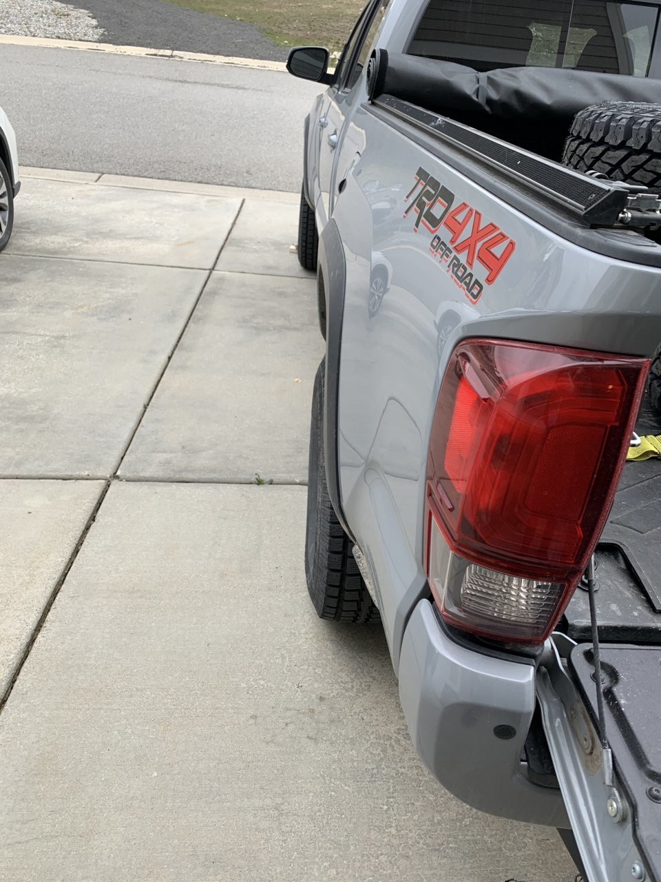

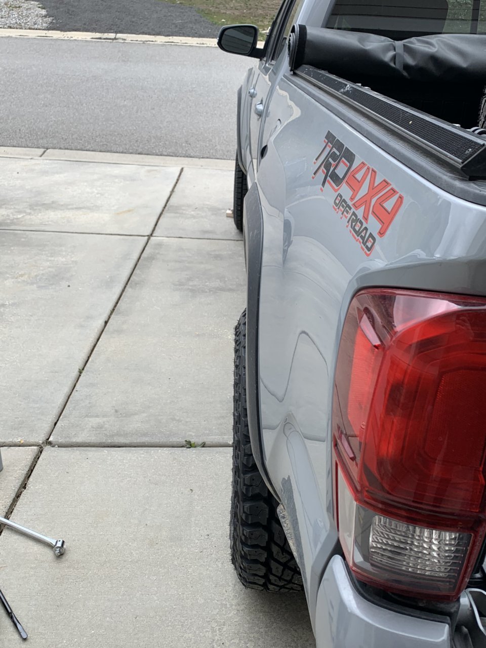

    The front is a stock 16x7.5” +25 offset. The rear is a 17x8.5” 0 offset. So an 8.5” wide -12 rim will stick out 12mm more than that. The bottom picture is with a stock wheel on the rear too.
