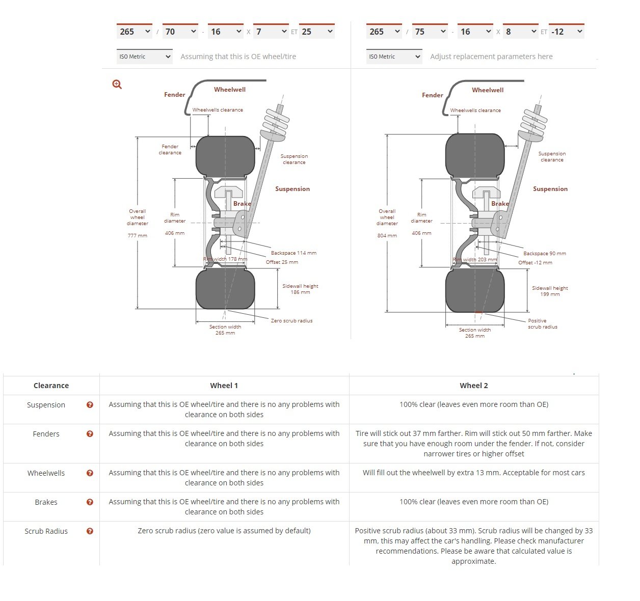

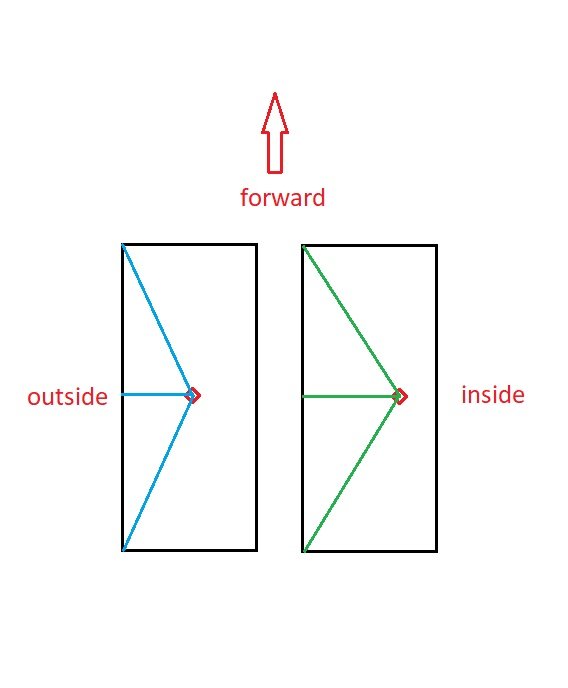

    If widths are different, comparing poke may not be accurate.
    This is a top view of what higher offset does...
    It puts more tire on the outside of the point on which your tires pivot.
    The blue(stock) and green(higher offset) represent the different radii of the arcs the outside of the tire follows.
    The larger radius follows a greater arc and thus more movement forward/backward in the wheel well.
    Here's a decent site to do comparisons. This example shows an increase of 33mm of positive scrub radius.
    The additional positive scrub radius will cause the tires to toe-out more when driven.

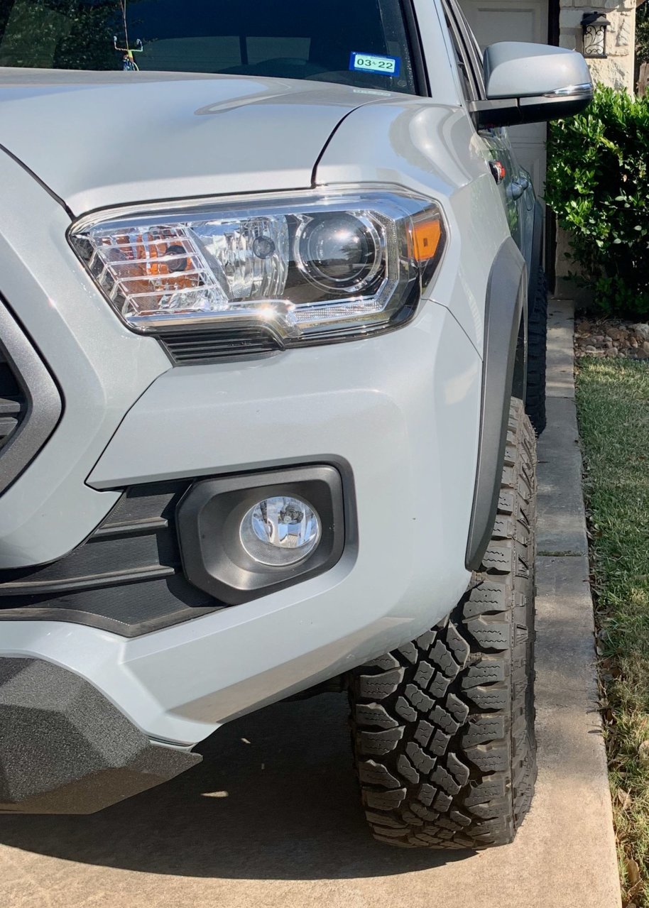

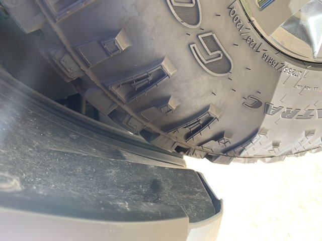

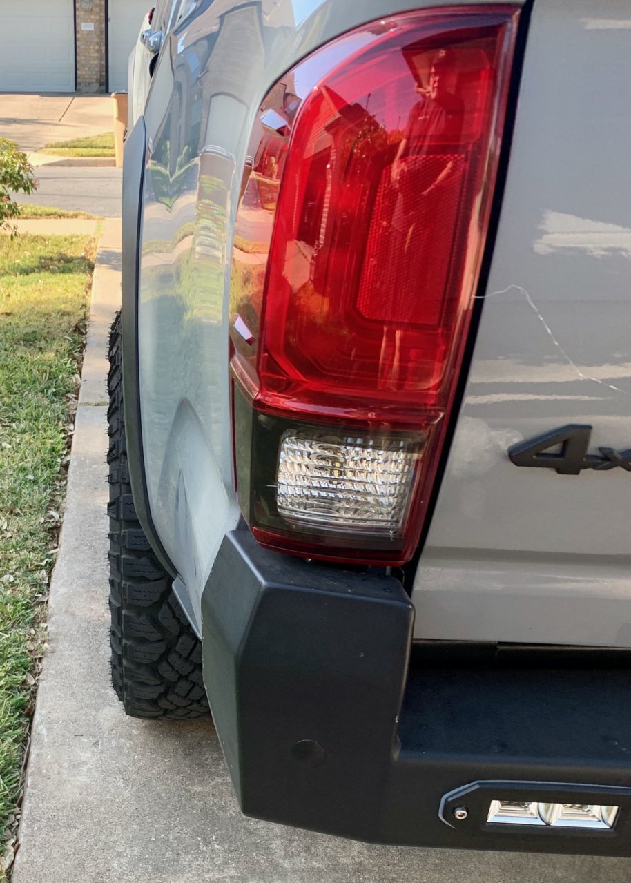

    Here are photos with the clearances with the configuration as above. It looks closer, but there is about 1/2” clearance at the back of the wheel well with the wheel turned. With the 17” wheels you are looking at it’s going to be touch and go and you may have to do a little trimming.96D93566-0C7D-40AA-BA1D-4FA3717AB4FF.jpg97E49537-F923-4D05-8297-9B5F5C342579.jpg54BE76CC-4742-47BA-91C9-6C18F7B943D9.jpg
