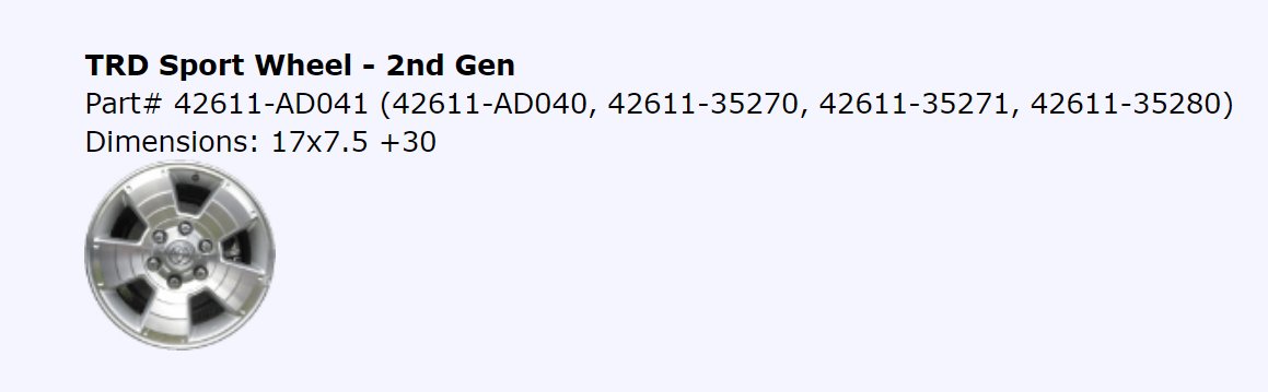

    Im getting new tires and started looking at some wheel too but noticed different backseat/offset, I’m not looking to change the anything from the stock appearance regarding wheels sticking out further , would someone know what the stock wheels are on a 2013 Sport, tire size is 265/65/17....

    Yep! These answers are saved as "sticky" threads which will always appear at the top of the wheel/tire section.
    Answer:
    https://www.tacomaworld.com/threads/wheel-specs.30754/
    Wheel information:
    https://www.tacomaworld.com/threads/wheel-backspacing-and-offset-info.102992/
    Wheel & Tire section:
    https://www.tacomaworld.com/forums/wheels-tires.15/
    It'll be very difficult for you to find aftermarket wheels that adhere to the factory dimensions. Your best choice there would be to opt for other factory toyota wheels from special trim levels, and even then the offset/width/backspacing may be different.

    Thank you , that’s my wheel

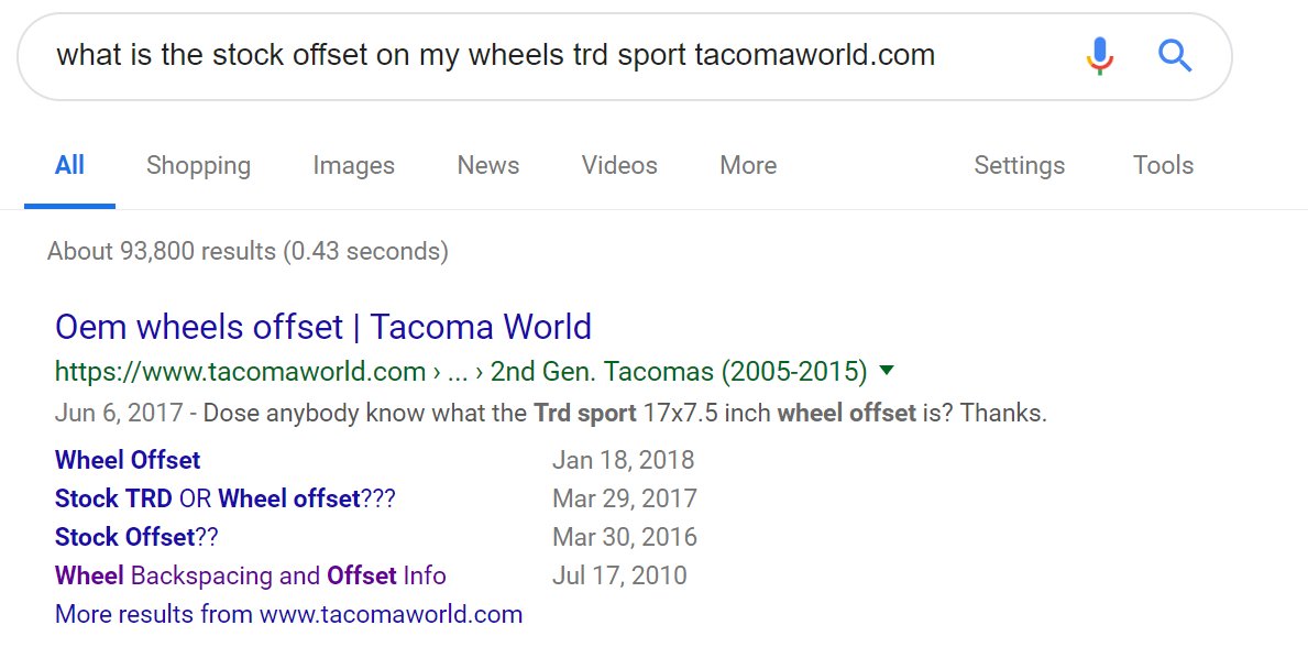

    This information, as well as damn near everything you could ever want to know about has already been asked, answered and beaten to death in many threads.
    So now tap in @seedy_tea , search!
    Typically if you google "what is the stock offset on my wheels trd sport tacomaworld.com" you'll find your answer.

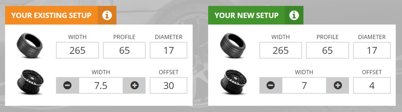

    I’m still a little/lot confused about the offset thing , I found these but they have a 4mm offset so according to the ad it’ll be a little wider stance then stock (1”) would this be correct or am I misunderstanding ... Would that be 1” overall or per wheel ?

  8. May 9, 2019 at 3:21 PM
    lickitysplit
    lickitysplit [OP] Well-Known Member
    Dec 30, 2015
    #173523
    61
    john
    2013 Tacoma Access Cab Sport
    Ok great, that diagram is pretty sweet it explains it/ shows what I wanted to know , thank you ...
    Love this forum
