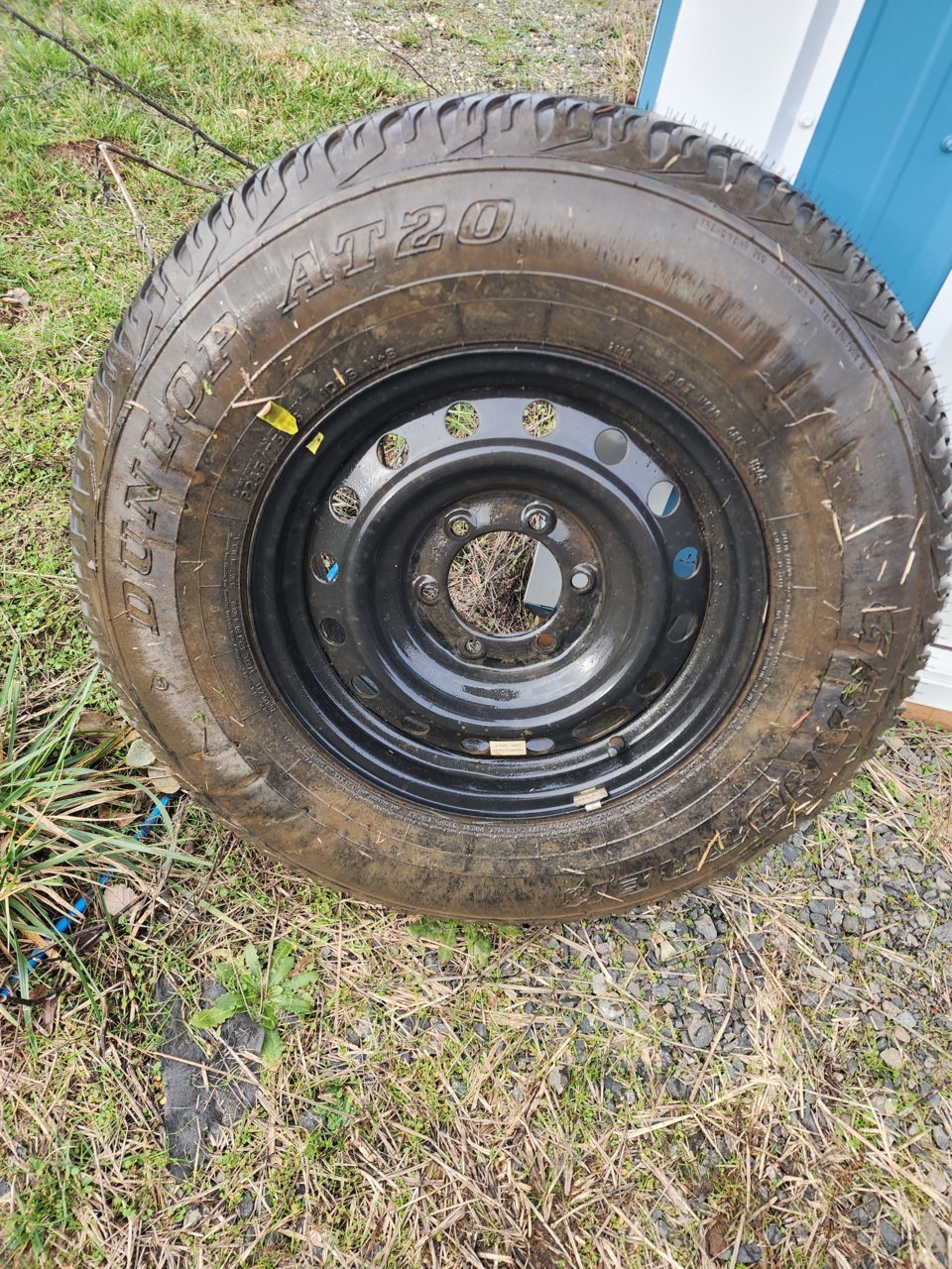

    not sure if you can see but that is a standard valve stem. So I don't think there is a TPMS sensor. that is the spare off of my 2009 tacoma.

    I see. Mine doesn't have a sensor in the spare, but I connected an Innova 5510 OBD scan tool to my Taco, and it appears the ECU can take 5 sensors. Thought about putting one in the spare to ensure it has air when/if I need it. I also understand that I will need some sort of programming device, like this one?
    https://www.amazon.com/dp/B00VZYFYKG/?coliid=I3FYBO8RDC85BW&colid=3POG09BBD5O5K
    I'm just learning all of this stuff in order to avoid the stealership; I'm tired of being ripped off.

    3rd gen TPMS sensors will not work in your 2nd gen truck. If you have alloy wheels you'll need to order sensors for them. If they're steel, then you'll need to order for them. You do not have a sensor in the spare. Toyota stopped putting them in Tacoma trucks in 2009. Some 2009 trucks may have them, but most don't.
    If it were me, I'd put new sensors in. Just so I wouldn't have to replace them is a year or so when the batteries start to go out.
