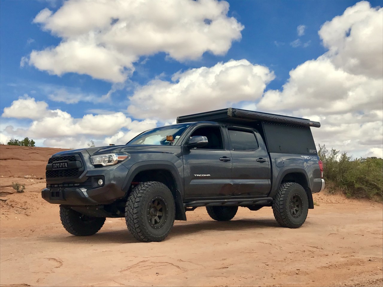

    255 85 R16 is the answer you seek.
    Dug up an old picture so you can see them with a GFC.
    If for some reason you have to have 17’s (that shouldn’t be what’s on your truck right now if it’s an OR) you want 255 80 R17’s. Perhaps you know this but your wheel size doesn’t give you more clearance. Your tire diameter does. So 16-17’s is only a matter of sidewall which is why the OR comes with 16’s more sidewall=better on a truck. Different for a performance vehicle.

    Hi YOTA 4x4! Thanks for the rec! Was curios also what kind of suspension do you have? And with your 33 inch wheels do you have an rubbing?

    Hey man, I’ve got an OME lift.
    +660 leaf springs (I have bags too)
    886X coils in the front.
    those are the heaviest ones they make and they worked well with my go fast. I added the Air Bags after I sold my GFC and installed the new camper since it was quite a bit heavier.
    I would say the front coils I have are a little stiff without a front bumper and or winch.
    Marie @HeadStrong Off-Road is a great resource to order from.

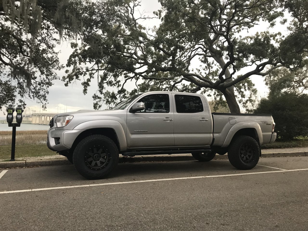

    Rough Country 3.5 Lift SCS BR6 wheels rolling in 285/70/17 Falken Wildpeaks
    My 2012 long bed is lifted with Fox shocks and I have Falken Wildpeak 285/70/17's on some nice SCS SR8's rims.
    Ride is smooth as butter on hot breakfast toast.

    No issues with rubbing? Also which fox shocks? And how much lift does it give you? Did you have to get UCAs? Doff drop or other additional parts?

    yes you will need a cab mount chop and hammer down your pinch weld.
    Fox 2.5 Factory Coilovers for the front
    Fox 2.0 Perfromance Extended Length in the rear with AAL
    I was a big time BFG All Terrain guy before I made the switch to Wildpeaks. Love them. :burnrubber:
