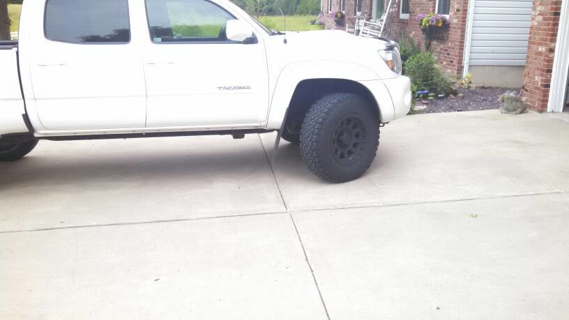

    I went with the pro comp 17x9 and 275/70/17 KO2s. Looks and drivers great. Had to trim a little but I'm happy with it.

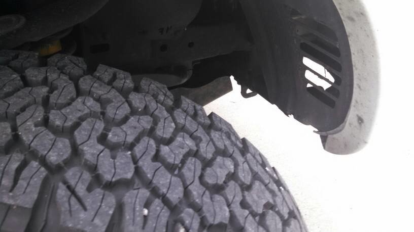

    What'd you have to trim if you don't mind me asking?

    I have a 3" lift with the 17x9 XD Monster 2 and 275/70/17 KO2s. Had to take off the front mud flaps but no rubbing.

    9ae8095f169dffe1bb6a8b1fb8f1f7b2_cde9dc3fef8dfb8eee7608d9447bc516bb096d73.jpg6d4692765160df9a2d30e171776ddddd_decc87ff9614087f88f739b88e806f51bc09449b.jpg
