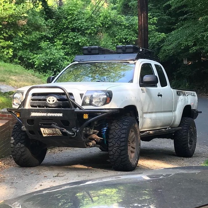

    In my own first-hand experience, 295/70r17 is the sweet spot of tire size on these trucks. Of course, wheel specs play a large role, but I removed my coilover to cycle my suspension and I had full clearance throughout the entire range of travel. It didn't take much more than fitting 285s (I had to hammer the firewall back a little bit, trim cab mount and trim back fenders) and these are almost a full inch taller. As far as regearing, being a manual AND a 4 cylinder, you're going to want to regear.
    I have since switched to 35s but I tubbed the firewall so I still clear through the full range of motion.

    33s don’t require much cutting and you don’t have to tub to make them fit. That’s why you see them more often than anything else.
    @EatSleepTacos fit 35s the proper way. Give his build thread a look over to see what went into it. I would imagine he put pictures in there. Might be hard to sift through though.......

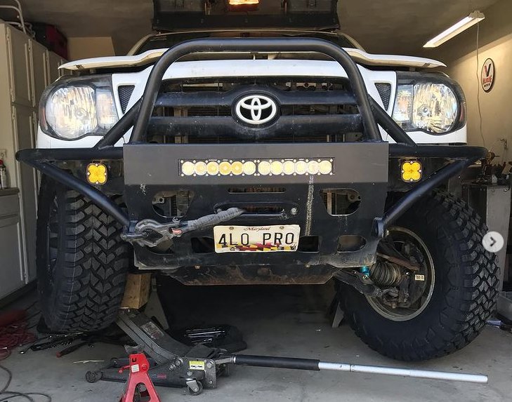

    I just saw the pictures in this thread tho, thanks!
    So in that 1st pic, is there is that small lower hole.
    Is that where the cab mount was chopped and is that a structural/load bearing piece welded back in there?
    It looks like inside the large opening there is a welded-in plate capping the end of the frame. Is that structural?
    I'm figuring the large opening itself just needs to be sealed up against water/dirt intrusion
    And/or is the large hole where the firewall is getting pushed back?
