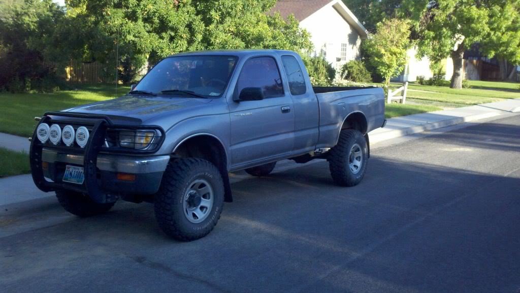

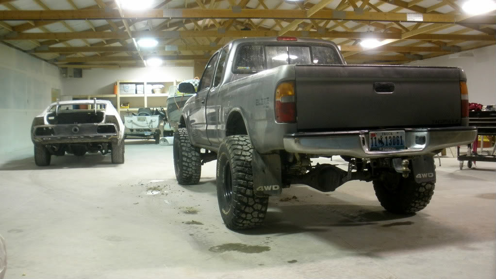

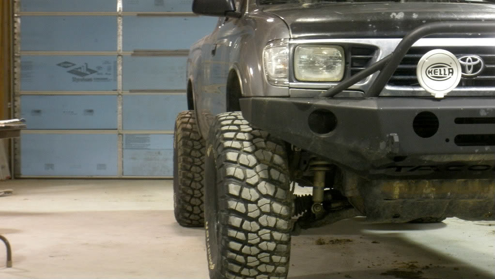

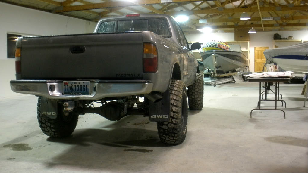

    No worries about spacers here man. I ran Allpro 1.5'' ones for a while and will keep running em once i get some bushwackers.
    If installed correctly there will be no issues.
    I ran then wim 31'' tires and it made it look way way better.
    Just keep an eye on the torque but mine never budged.
    Also GET EXTENDED THREAD LUGS!! You will be VERY happy you did especially for the fronts.

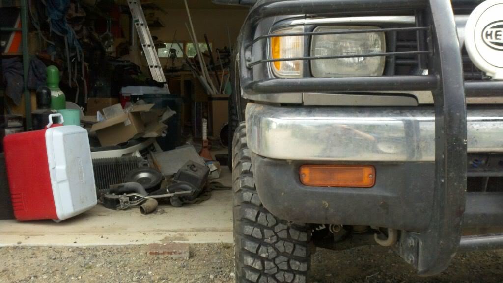

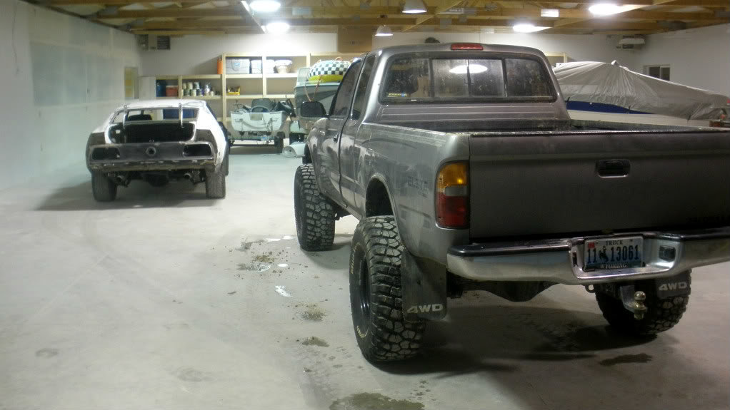

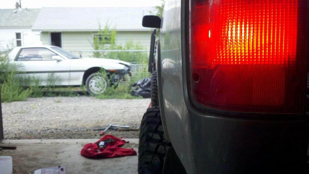

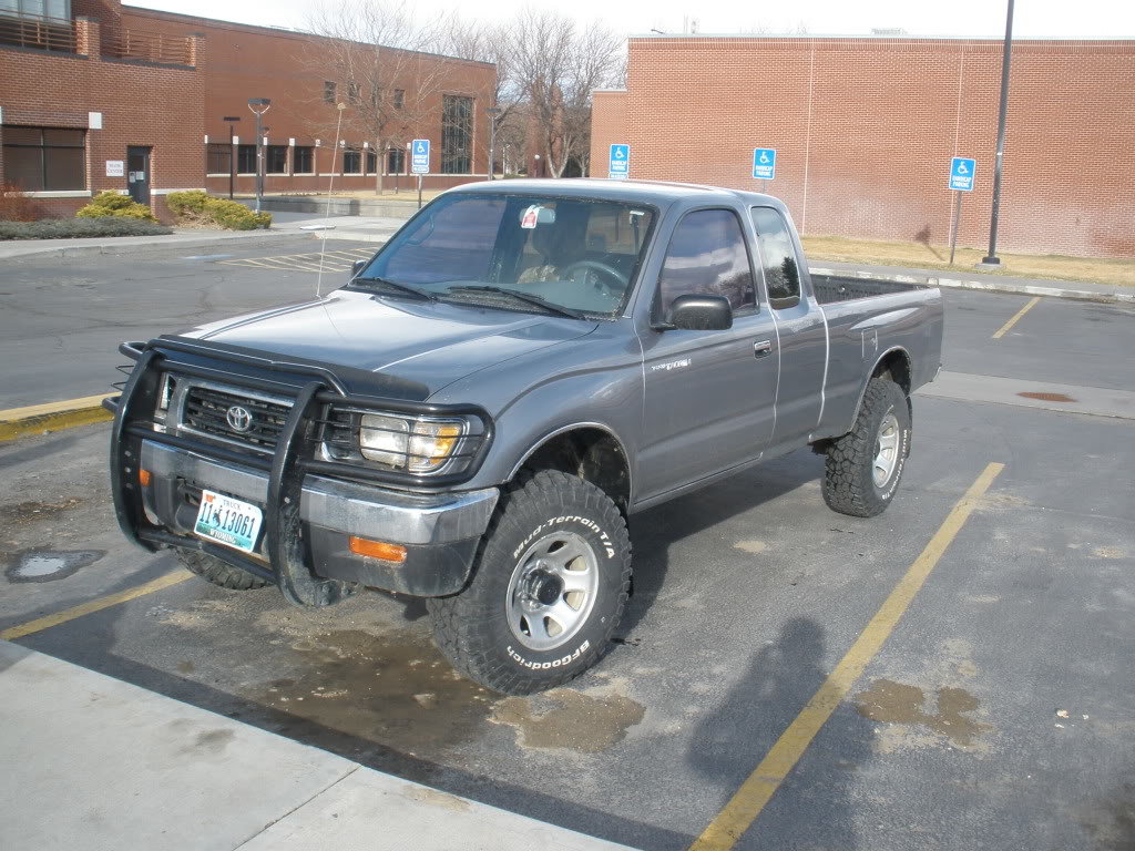

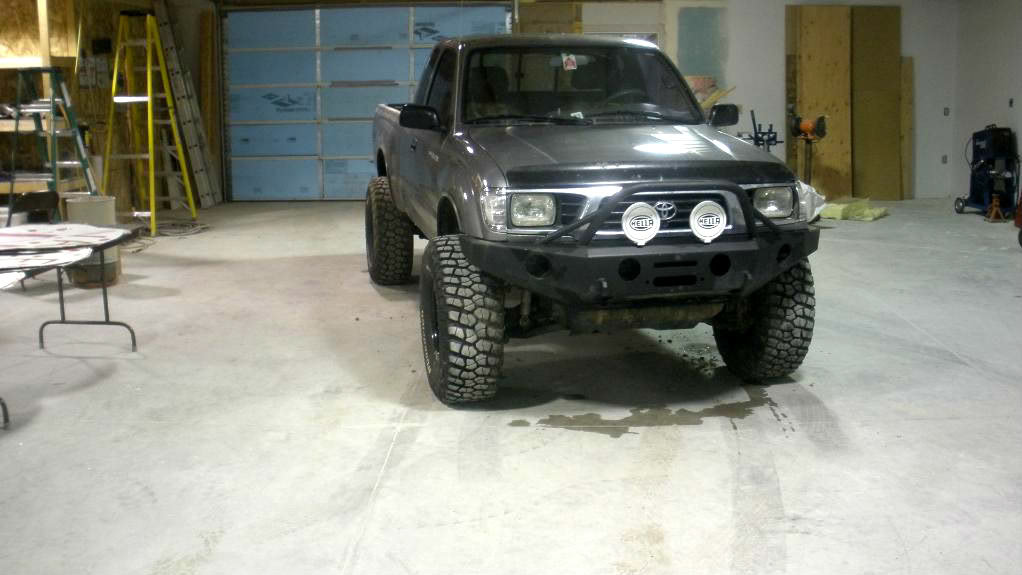

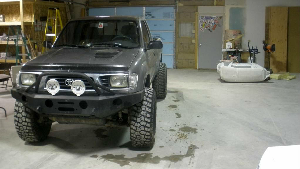

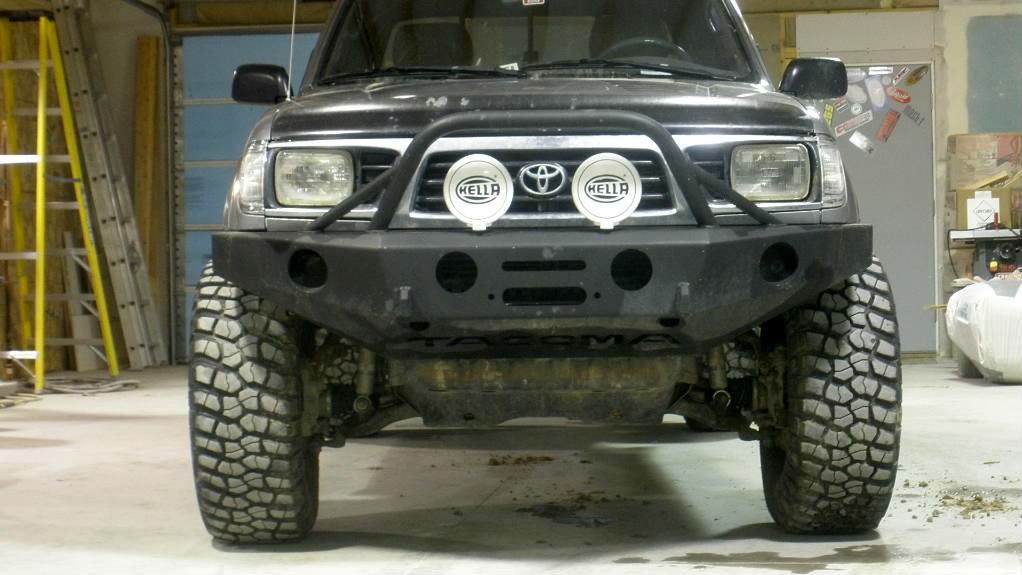

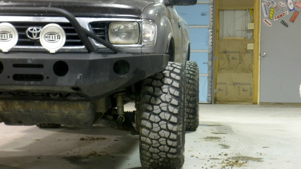

    Pics:
    Pre lift and spacers
    Lift
    Spacers on Driver side..
    No spacers Pass side..
    Lift and spacers :cool:

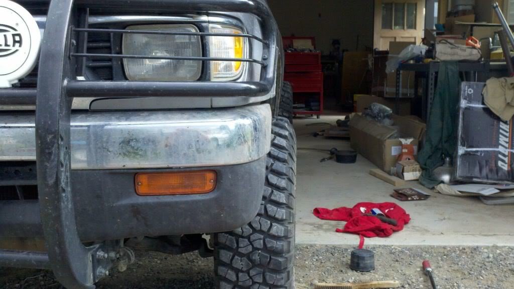

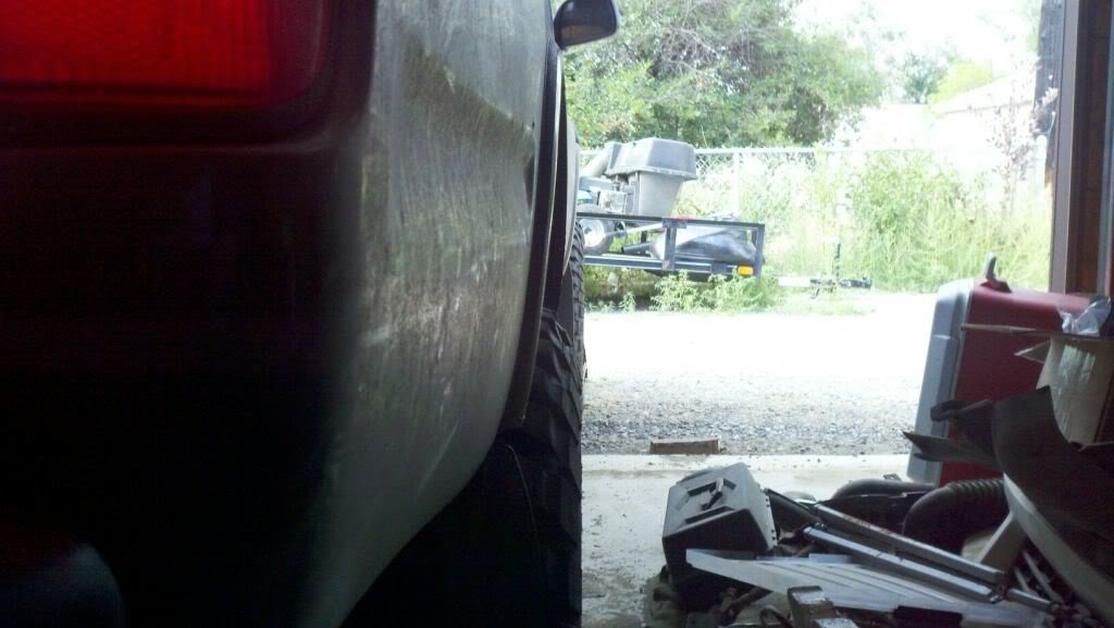

    Yea spacer won't help that. Get a cutting tool out :cool:
    here is my 33x12.5s with my spacers back on.
    P1221835_bd4d193e2f1b5edaf965dc89a104b2522921638e.jpgP1221839_5b91767d4a433bbcd3b7c5b2f2e1cb6c33044c13.jpg

    Dude, love your Taco...but especially love your garage! Damn! You could park several Taco's and a C130 in there.
