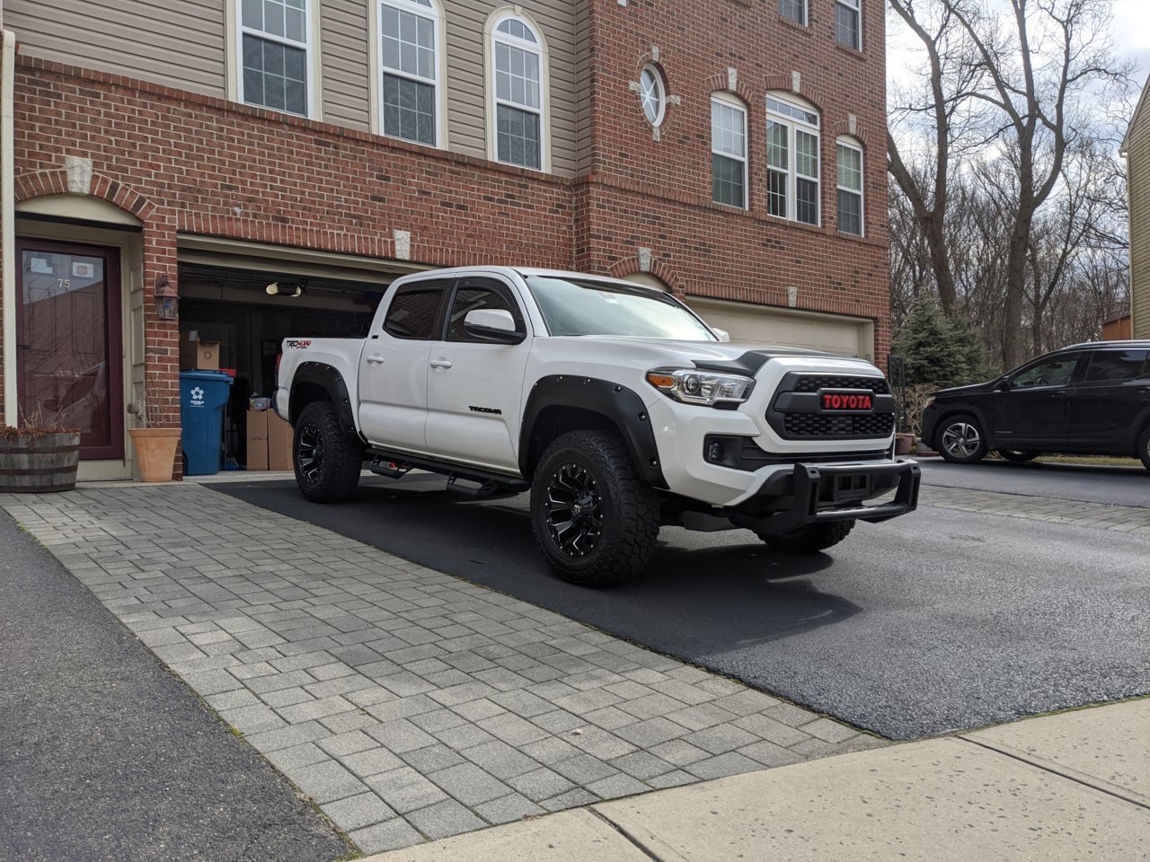

    Replacement rims and tires
    Hi guys,
    I just installed Fuel assault D567 rims 17X9 with a -12 offset and Micky Thompson tires 265/70R17. I think factory rims were 16X7 with tires 256/70R16. I called there seller they confirmed it will fit and they do but I got one issue that's driving me nuts, yes the lug nuts. New wheels are co-centric nuts and they don't thread in all the way to stock wheel studs call the seller they send me extended wheel lug nuts put them on and still the little too short I forget I will install longer wheel studs because I went from a 16 7 to the 179 so there's not enough stud going through the wheel and that's a concern to me everybody's saying put spaces but I don't think that's logical I think putting in the wheel studs giving that extra length would it be a better option than anyone please advise thanks
