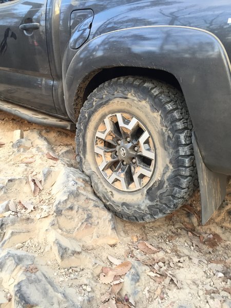

    @consultadrone i believe I have what you are looking for. i have Spidertrax 1.25" wheel spacers- and I wheel hard! No issues.
    TRD OEM wheels are 16 x 7" with a POSITIVE 32 mm backspace. (Pushing tire in to wheel well.) 32mm is damn close to 1.25".
    Using 1.25" spacer, effectively gives your truck a more "centerline" hub mount- with an OEM TRD wheel.
    Here is a profile shot:
    MadJacks, RobDee, itzryyster and 18 others like this.

    Yup, that's exactly what I was looking for! You rock! Thanks for the info, really do appreciate it! And, nice looking truck!!
