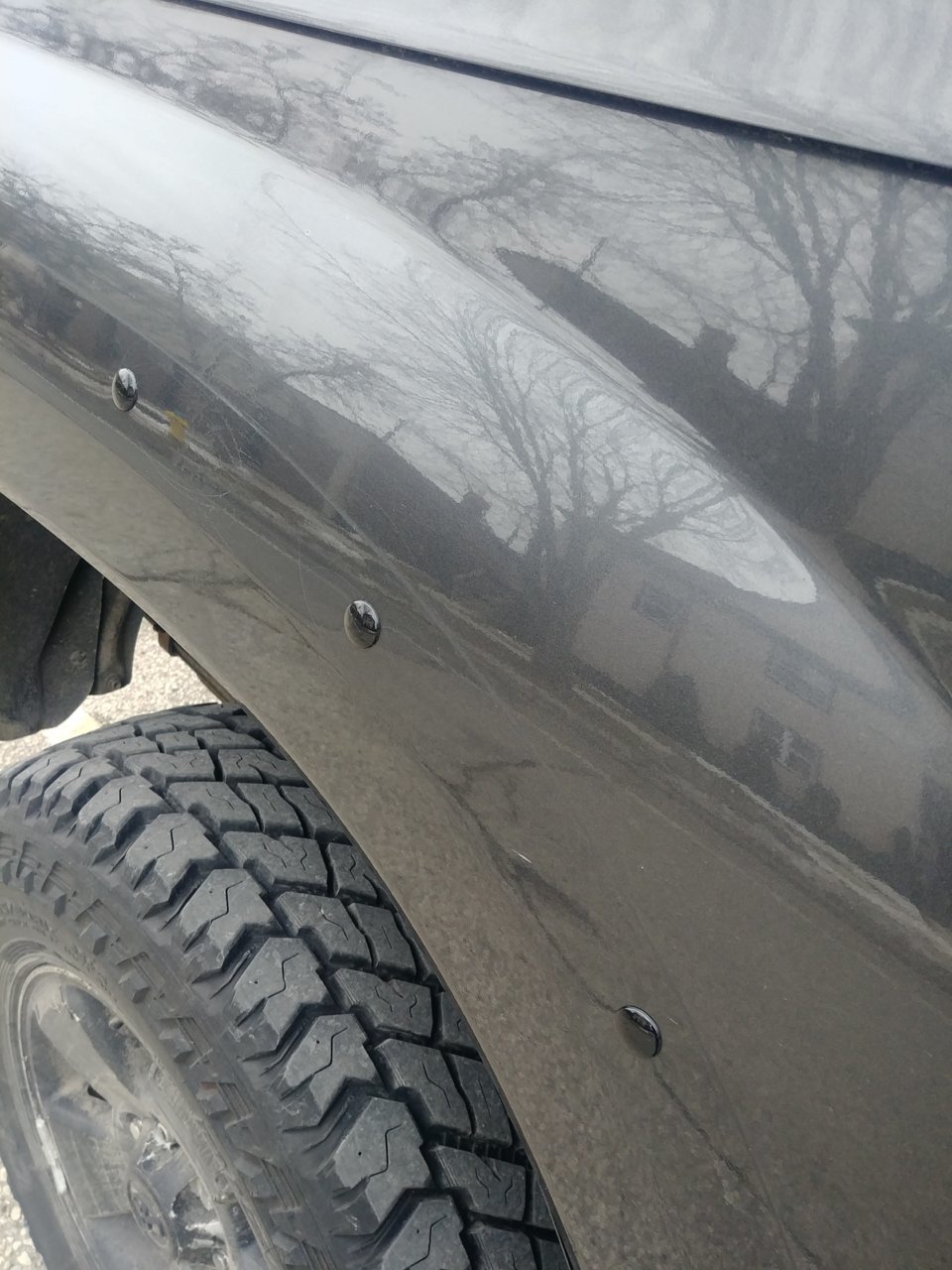

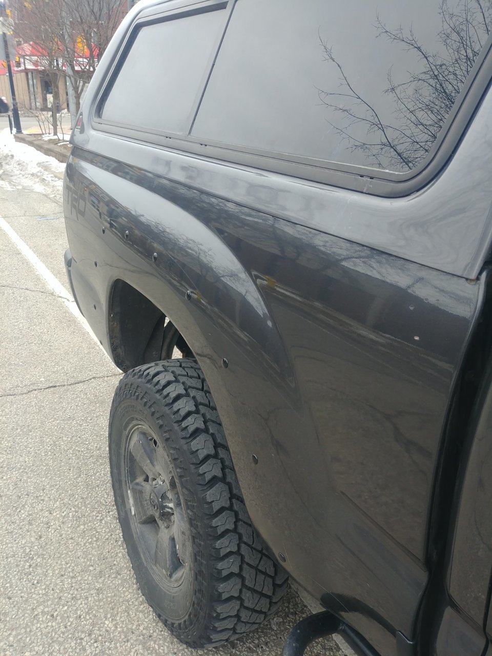

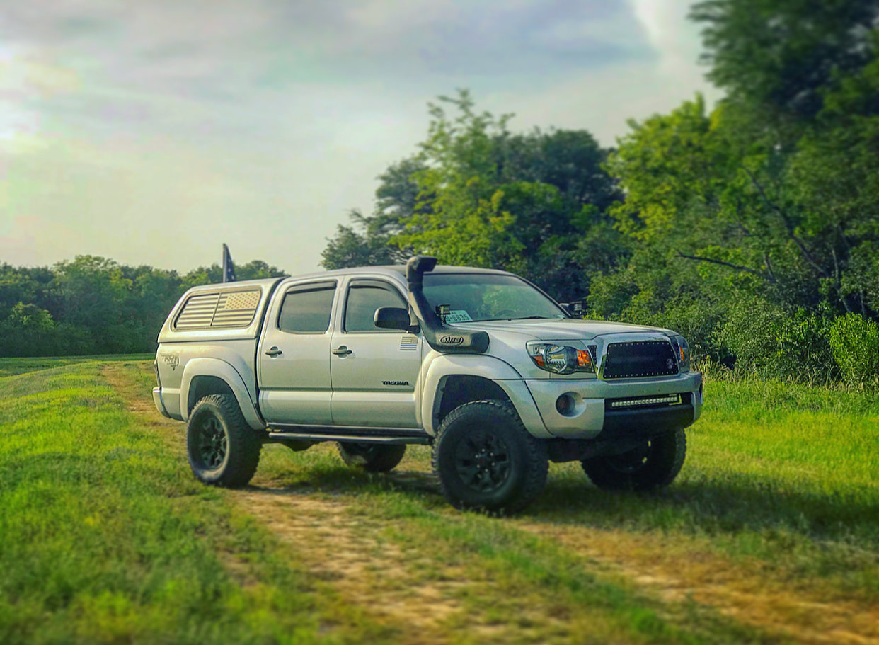

    Hubcentric yes and when installing wheel spacers use the correct lug nuts...see photos for clarity.
    8B04CA4C-6FEC-475A-A5BE-D04FCF3ADCC3.jpg 6F478ABE-B29F-48D4-AF44-B31D61A13FE2.jpg 4CE0EBB8-5D15-4642-A161-96634F6E8010.jpg
