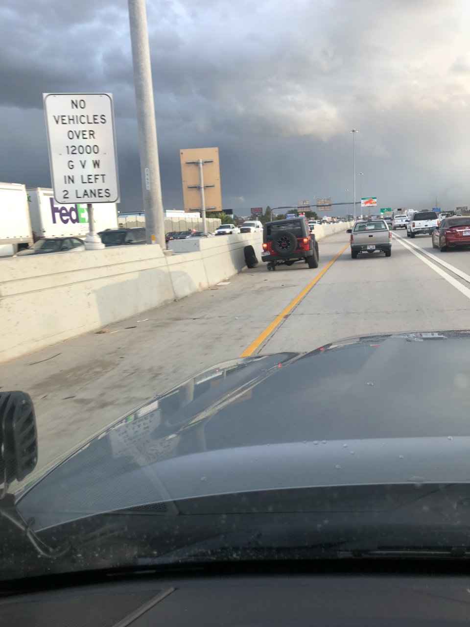

    On my way to Moab saw this Jeep off to the side of the road near Salt Lake. If you run spacers check them, blue loctite them. I have run them on my previous Jeeps with no major issues. Only issues I have run into was when I lived temporarily back east. One nut on a spacer got really corroded and almost wouldn’t come off. Would have been a nasty fix if the spacer was stuck on.
    I have bora 1” spacers now but tomorrow new offset rims go on.

    Spidertrax come with the much stronger RED locktite.
    There could be any number of reasons the wheel came off that Jeep.
    Any claims that 1.25” spacers are bad on a Tacoma OEM wheel are simply unfounded. Overwhelming body of evidence over a decade to support this.
    As others here have said- if someone wanted wheels with better offsets, they would not be on this thread.

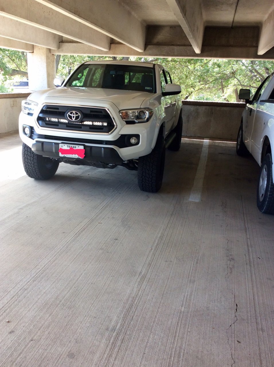

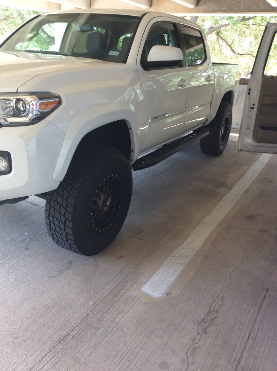

    So I got them. I've ran them for 700 miles I pulled wheels and they look good,and all lugs are tight no issues so far
    tacomavoyager likes this.
  16. Nov 4, 2018 at 1:12 PM
    #96
    Jeremy4x4
    Jeremy4x4 Zero frucks given
    Sep 28, 2018
    #267714
    85
    2017 sr5 4x4 double cab
    3by2 level kit 285 70 17 nitto tires,
    Noticed braking is a little different but ride seams more stable like it's tracking better on the road
