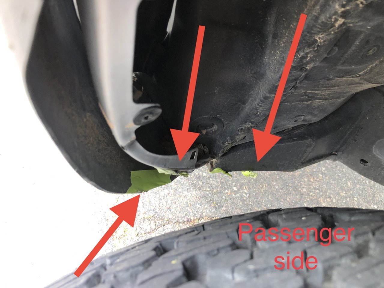

    The one thing I have not done is adjust the castors forward to its max. I hope by doing this will eliminate the rubbing:)DDA99A86-330C-406D-951F-1503A4B991F5.jpg

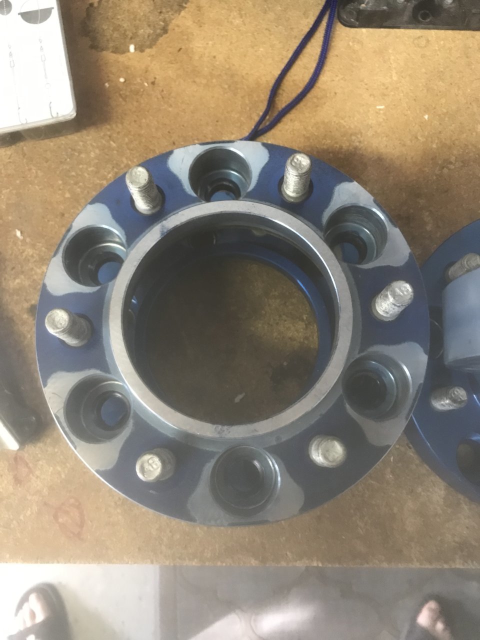

    DEDF32C4-1FC1-4962-9A7E-18F072B17A10.jpg 973486C7-BEA2-4AA8-BFB4-99BE69E5B8A2.jpg I pulled these off as I have changed my setup. What is this discoloration? It’s only on two of the spacers. No scratches or gouging. Heat from front discs?

    looks like where they make contact with the wheel, maybe those spacers weren't torqued properly, and caused some rubbing or movement, wearing the coating off?

    Yes possibly…. Doesn’t explain the discoloration on the outside. That has contact with nothing.maybe brake fluid or road salt as I drive to Tahoe a lot. But it’s only two of them.

    so I looked again, and realized that I was seeing it inverted. The areas with the discoloration are actually the exposed parts, and the area where its still blue, are where the wheel contacts the spacer. so its likely exposure to something, either road salt, or some chemical, like brake fluid, which I know is a really strong paint stripper.

    Exactly……..was going to post them up for sale just wanted some feedback as to opinions as to what could cause this. Thanks for the insight.
