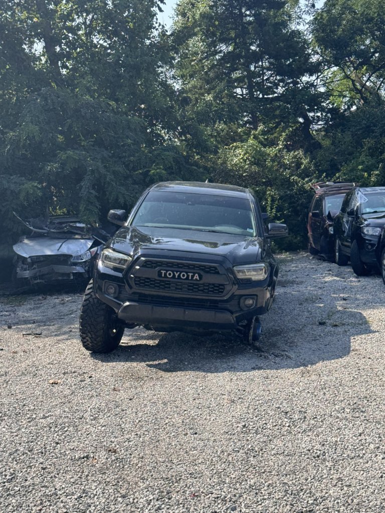

    Be INCREDIBLY careful if you run spacers. Make sure to retorque your lugs after a couple hundred miles of driving on them after install, or you’ll end up like me..
    If you install them correctly, you’ll never have an issue. My truck has been jumped over 10 times, been 110-120 fairly consistently, and I never had an issue with my spacers till I installed them wrong. Moral of the story is just do it right lol
