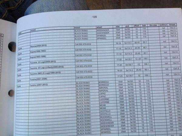

    Dafaq now I'm confused

    Makes sense per that chart I posted :facepalm:

    Looks like centerline is .5" from what I was thinking center is.
    0 offset on 6" is 3.5". 0 on a 8" is 4.5"
    Not quite center

    There's the difference in my 4.14" versus the 4.64".

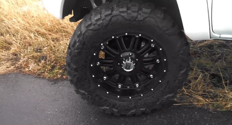

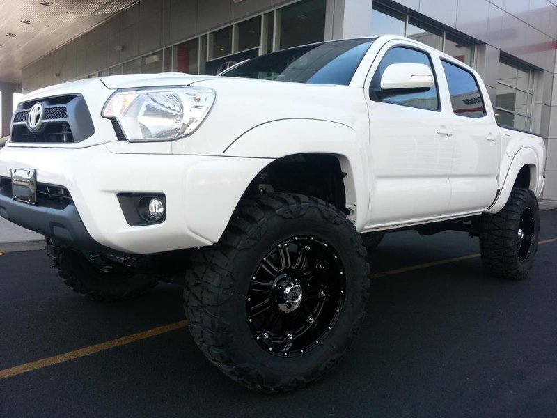

    trying to get this set up.. what offset and backspace do you think this is??? its 35s with 20 inch wheels, what kind offset and backspacing though?

    20 x 9 -12 4.5bs

    spot on!
