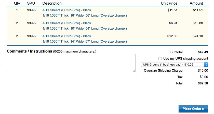

    Ordered. Not as pricey as I was expecting + I ordered a sheet to make my tailgate a flat surface.
    Here is a screenshot of cart if anyone is interested
    The 16x56 sheet is for tailgate, 10 x 54 is for front wheel well (im not going to cover bumper area as I plan on a plate bumper in future), an the 67 x 14 is the rear wheel wells. Hopefully these sizes are appropriate.

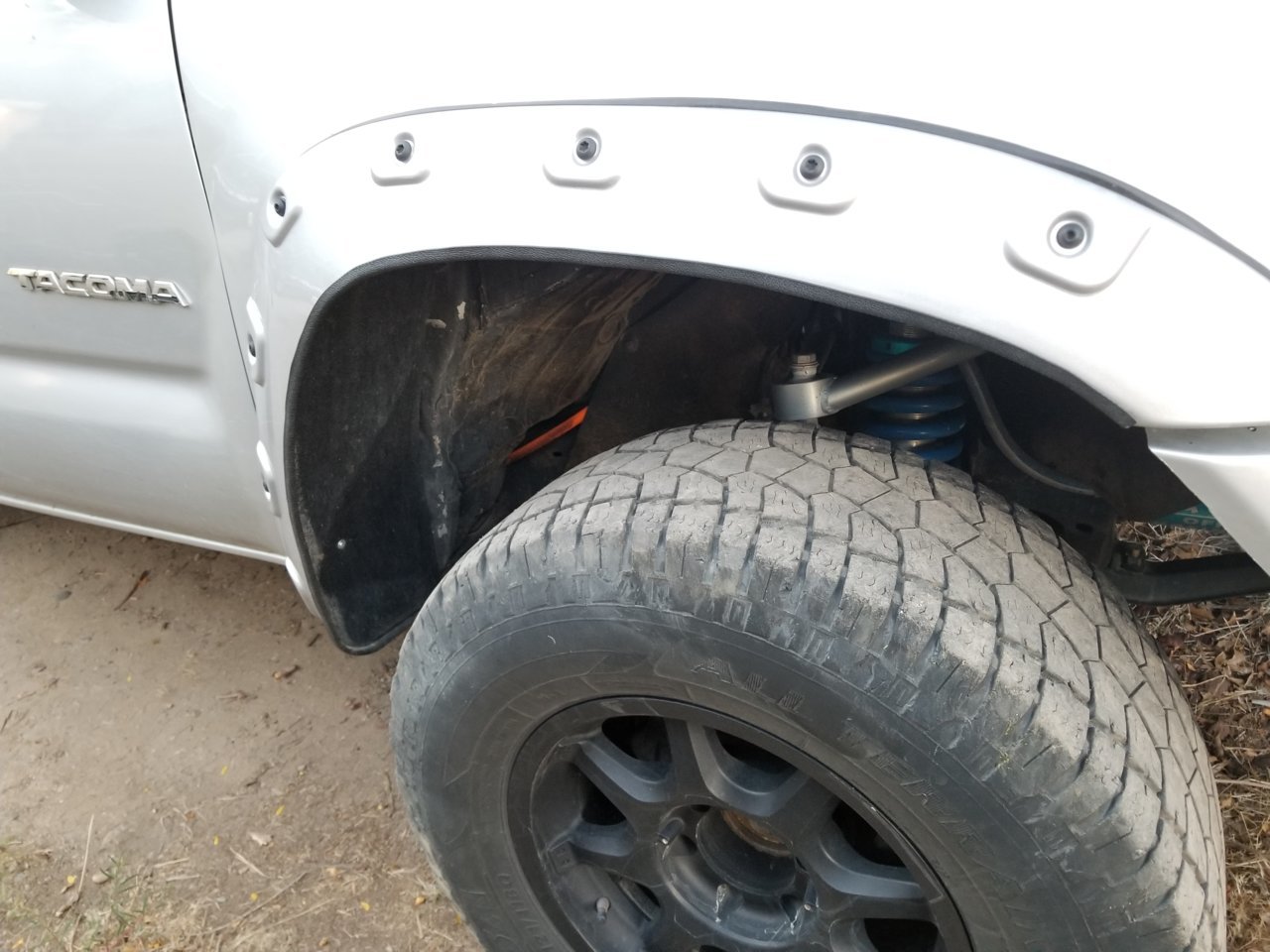

    Yeah... the abs liners have been awesome... and a lot cheaper than that option.. I have his front splash guards and they are all cracked up after about a year on the truck...

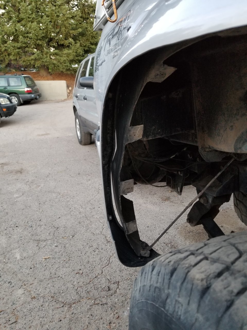

    Here are a couple pictures... just left some tabs on the metal fender and attached with self tappers.
    Use a heat gun to form to wheel well and if you put the time in they can come out to look factory.. I want to re-do mine at some point and be a little more careful to watch where Im trimming as there are a couple spots I left a gap between liner and fender flare.
    I also sprayed the inside of the liners with a few coats of rustoleums rubberized undercoating in an attempt to help with noise reduction.

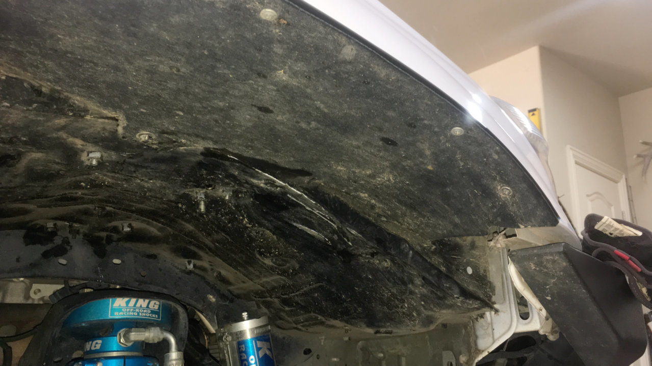

    Here’s a few shots of mine.

    Hey dude, I know this is an old post, but wanted to ask a question. Most people when cutting tabs bend them in towards the truck. From your description is sounds like you bent them out towards the flare. Is that correct? If so what was your theory behind this?
    Doing the chop this weekend and just exploring options. Thanks man.
    Island Cruiser likes this.
  17. May 21, 2020 at 1:17 PM
    #37
    PHTaco
    PHTaco Well-Known Member
    Aug 6, 2013
    #109903
    124
    Brooks
    TX Panhandle
    '13 Trail Limo
    Kings-Dakars-Dirty Fives RCI Skids Demello front bumper BAMF Sliders HC Rear bumper Snug top 4.56 Nitros Engo 9000# Winch w/ syn rope ARB comp & rear locker Home built roof racks Expo trailer w/ RTT
    I bent them out so that they would support the flare. It's a little more tedious since you have to cut the tabs more precisely, but it seemed worth it to me. I cut mine just a hair long so that they would push against the flare slightly. I'm lazy and like going through the automatic car wash, and I was concerned about the flares getting ripped off in there. I've had them cut for about 60k miles, and that hasn't been a problem. Good luck, and post up some pics when you get it done!

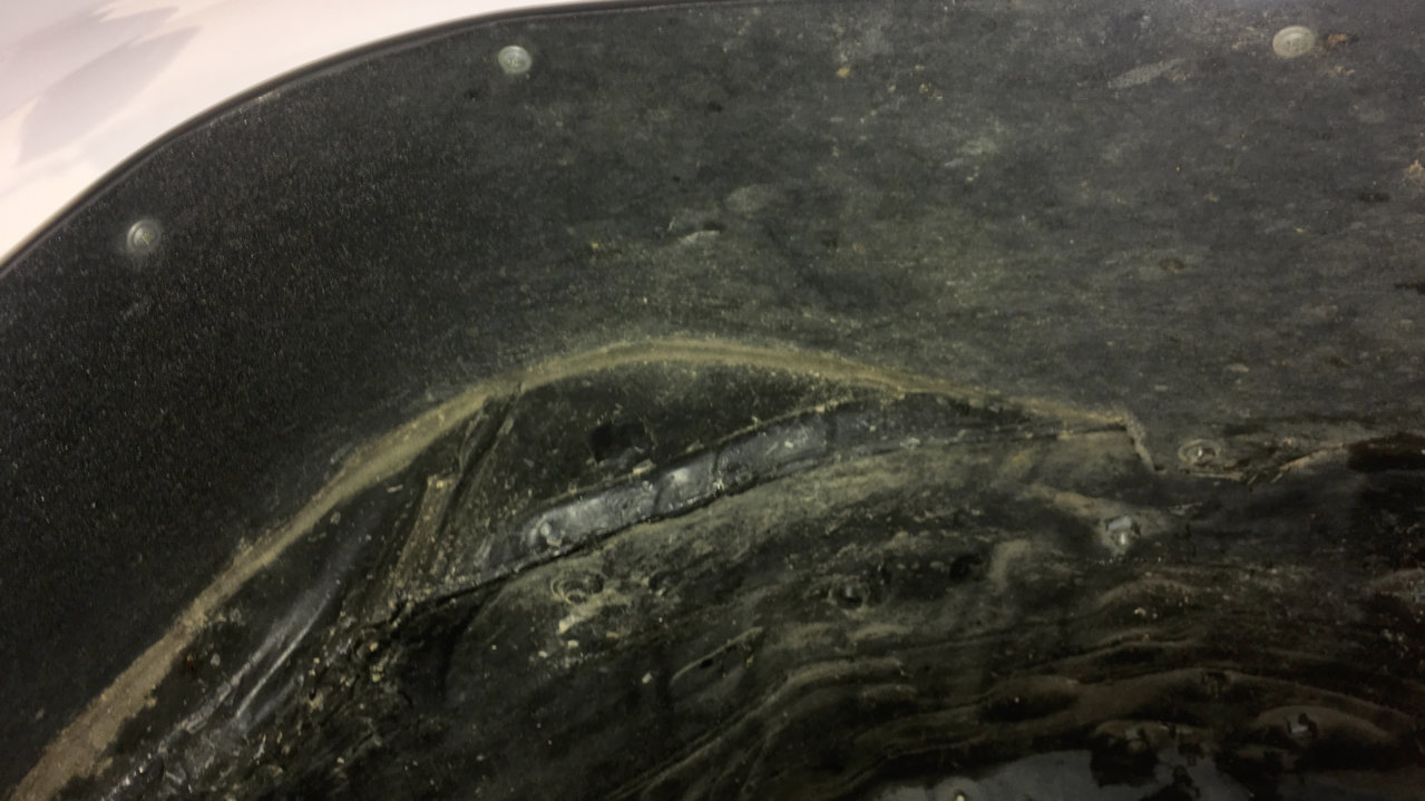

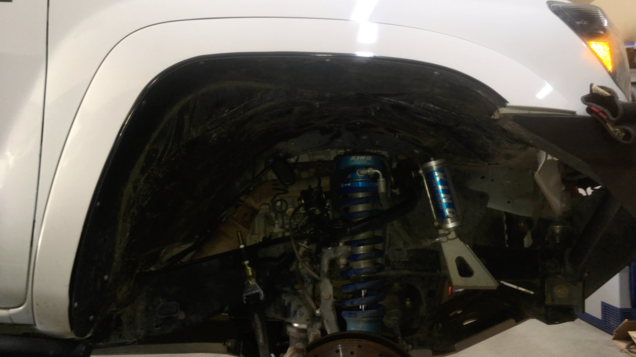

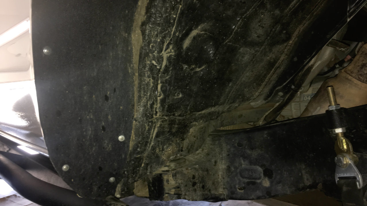

    Kings F/R 2.5" EXT w/700lb springs, JD Fab UCA’s w/ Lower Pivot Kit, Icon Progressive AAL (with TSB and overload in), CB drop, 285/75-17 nitto ridge grapplers, SCS Deep Dish Ray Dimes, Snugtop Rebel Shell, Prinsu Toprac, Gibson SS Catback Exhaust, ATH front /rear steel bumpers, CVT awning, Airflow snorkel, @ Shmellmopwho sliders, SC w/ @justdsm HPtune, 3° Cam Gears @mightytacoman, 2.8 smooth flow pulley, StopTech BBK
    got my fronts done. May need to clean up the flare a bit with a flat disk.
    so here’s my next questions for you Brooks
    i see you fit the abs sheet under the wheel well and attached pre cutting the sheet. what was your strategy for getting the sheet lined up with the tabs and screwing it in?
    Pretty much what was your trick to get it lined up drill hole wise with plastic and tab if that makes sense. Thanks man
