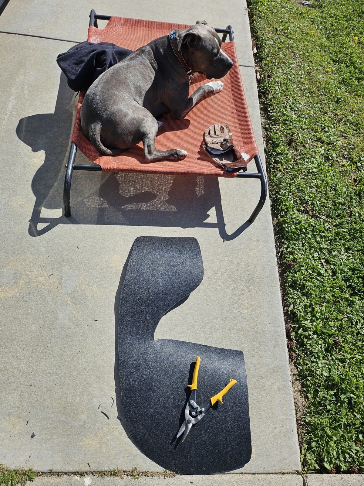

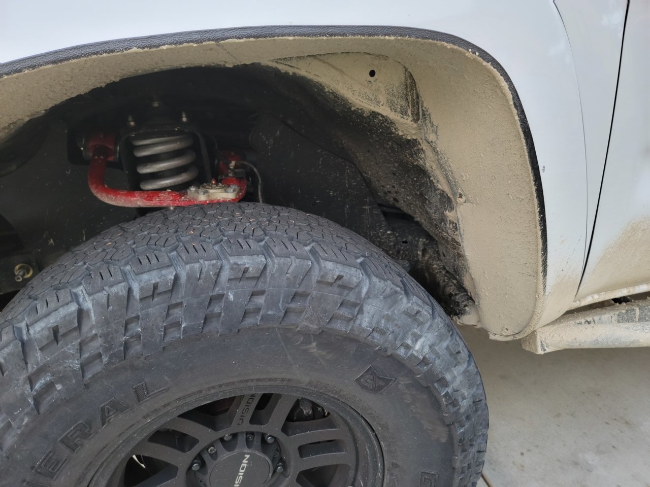

  16. Mar 16, 2024 at 4:40 PM
    #76
    powder1134
    powder1134 Well-Known Member
    May 27, 2020
    #329500
    1,429
    2014 Tacoma TRD Off Road
    Got the replacement made today. At this point I can do it pretty quick. Just wish they'd last. After the first set i learned to make them in 2 pieces so I don't have to replace the whole thing. Just the broken half.

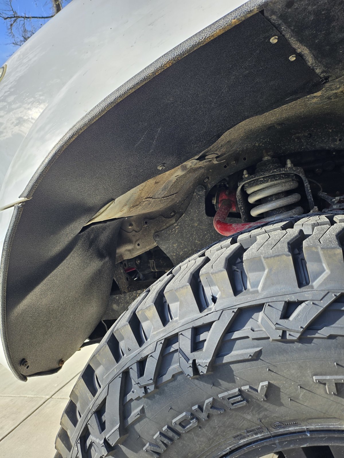

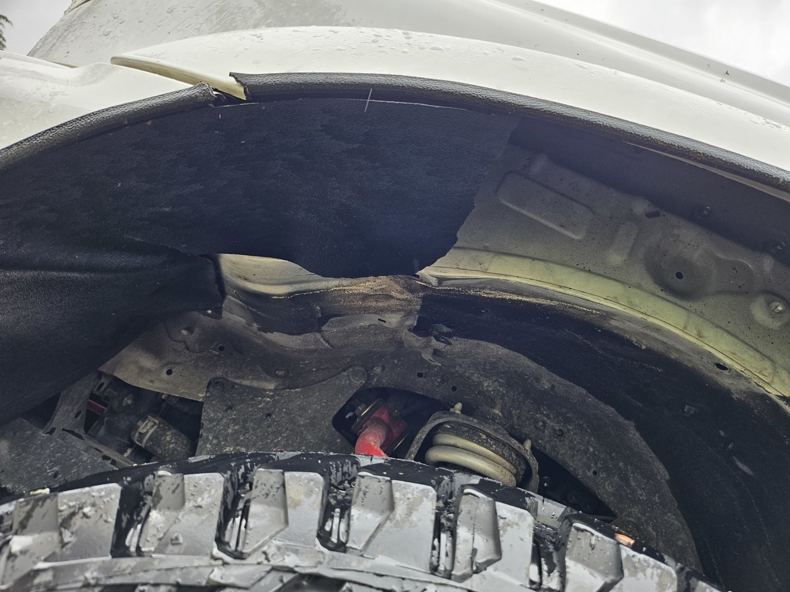

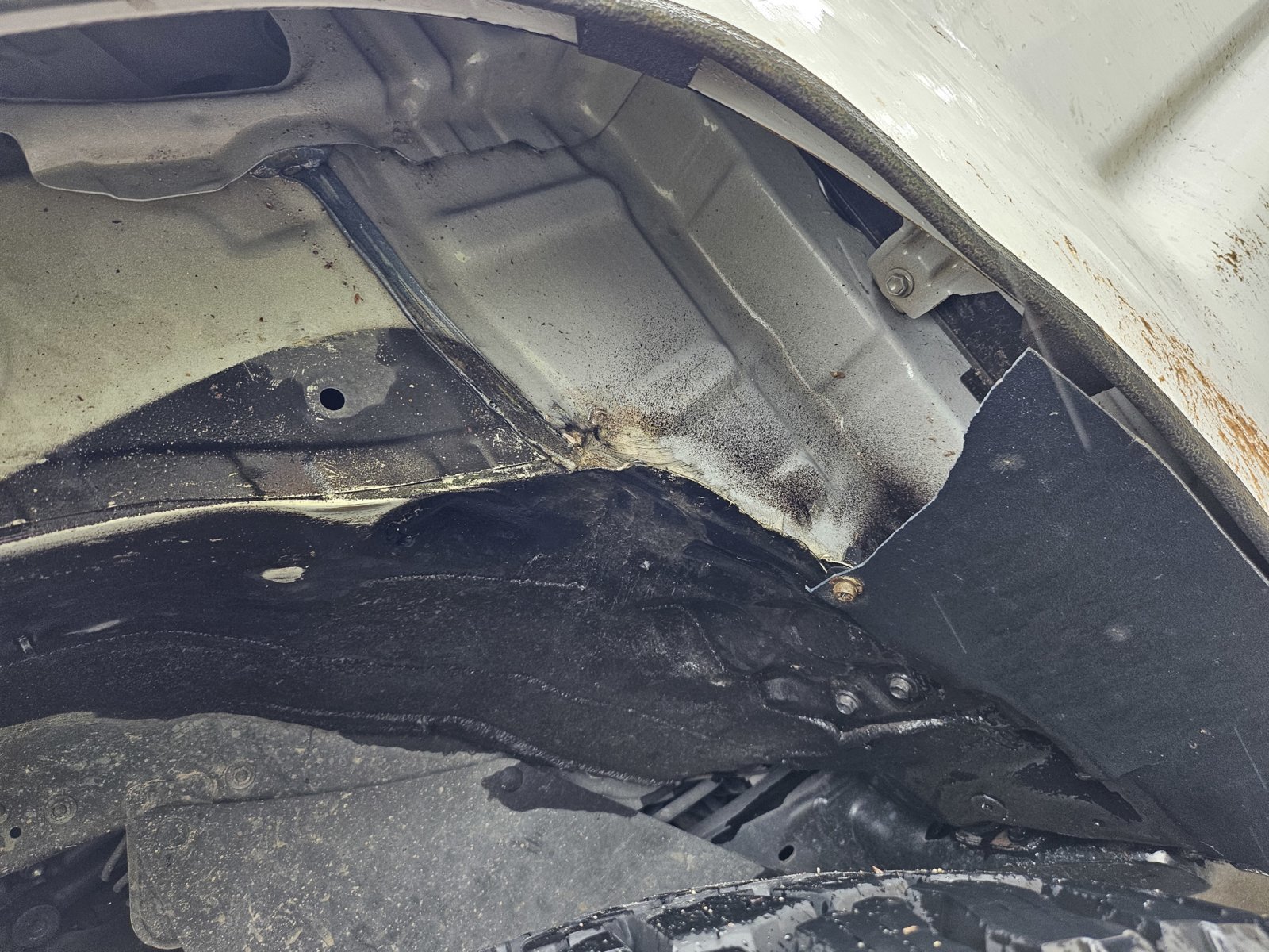

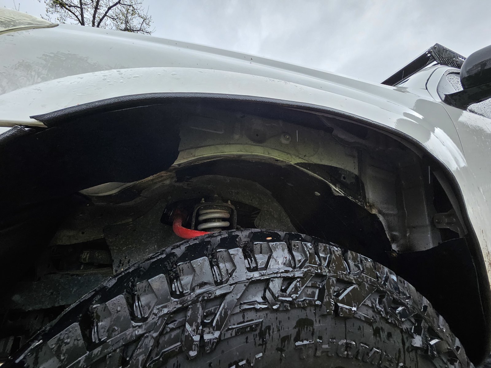

  17. Mar 23, 2024 at 1:14 PM
    #77
    powder1134
    May 27, 2020
    #329500
    1,429
    Well, this set lasted 1 week...... stuffed the tire while offroafing and immediately heard it break. ABS just isn't cutting it.
