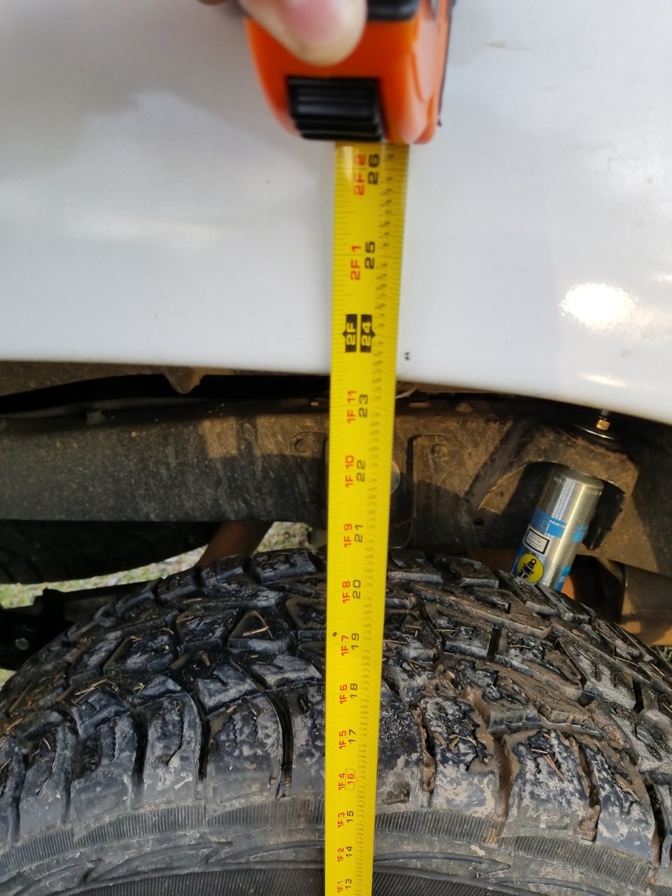

    It's not exactly sitting level in this pic. But it was the best I could do at the time. I'll try and do a better pic later on.

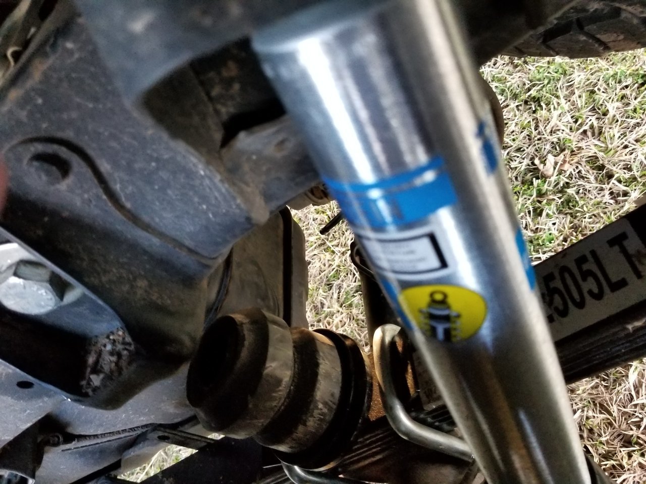

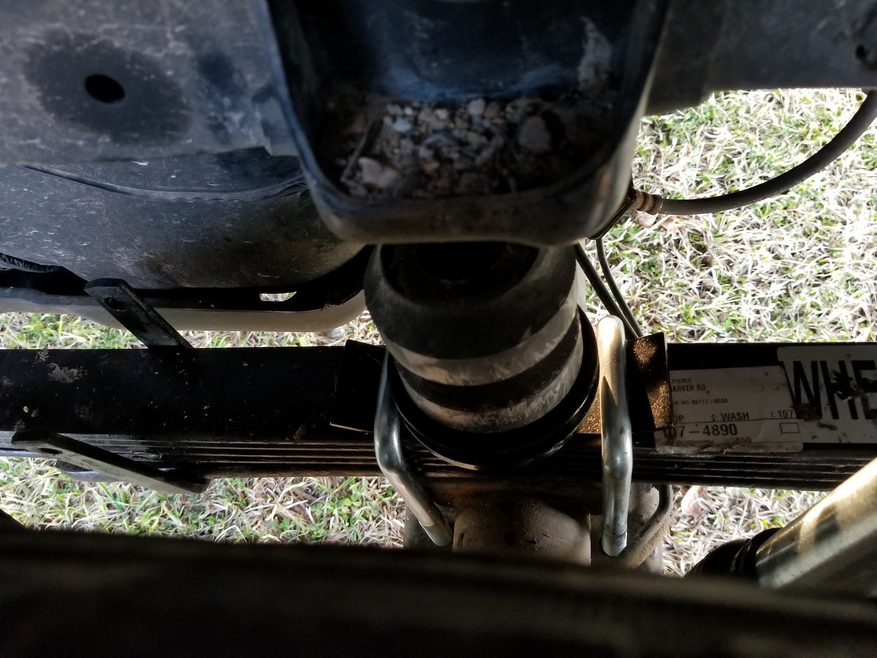

    This will give you an idea of the size of the Tembrens.
    The shocks are Bil-5125's

    I got 1 inch in the rear. I'm running a plate bumper/swingout, bed rack over a bestop and a RTT. I'm level with 22 inches hub to fender on all 4 corners. Shocks are PTR13-35150 on all 4 corners.
    Very pleased with the ride. far smoother in the rear than expected on both small and large bumps. given the thickness of the leafs, I expected a much harsher ride. Given how smooth it is, I may inquire from Wheelers if they have a leaf that can be added to give me a little more rake and little more support. Overall, I recommend this pack for someone who is looking for 2 inches or less of rear lift and needs more support than an add-a-leaf.
