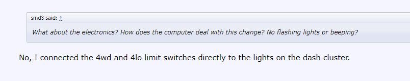

    not a bad idea at all to swap over to the FJ Diff tube. Wasn't nearly as expensive as I thought it would be. Hell the ADD module is about the same price. but as I just stated before, there becomes the flashing 4x4 light due to the 4wd module knowing what is going on. OP's solution below:
    So instead of reprogramming or actually tricking the 4x4 module in to thinking there is still a axle disconnect, he just wired his 4x4 dash lights to his switch.
    I just hate blinking lights and doing a fix like that isn't the right way to do it. I would rather trick the module into thinking the add is still there and working properly.
