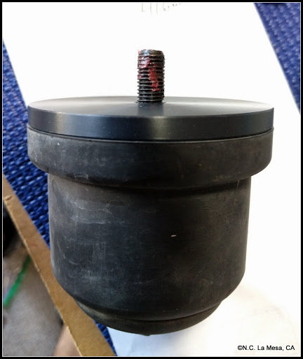

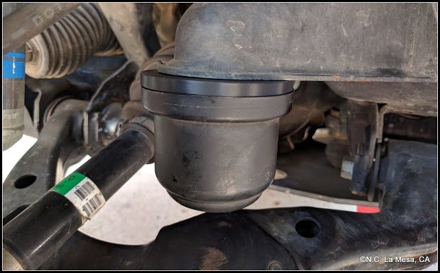

    This is good advice.
    Removing the wheel isn't mandatory though... I initially installed them with the wheel on, only because i didn't want to do too much work. I did have to cut down the supplied 8mm hex key and use a small crescent wrench to install. I used 16" slip groove pliers to remove the factory bumps.
    I just got done adding some shims, 1/4";
    The spacers have completely solved my rubbing issue.

    What did you use for spacers?

    I'm curious as well. I'm also curious if these will work with factory bumps, but I haven't looked at my own yet to see

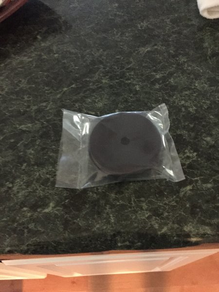

    I'm pretty sure those are spacers from wheelers. I just bought some myself for the rear.image.jpg

    @Dalandser
    Yes. UHMW Thermoplastic. Wheelers sells them. They are very well constructed. Very happy with mine.

    Thanks. It's good to know that they are an adjustable part. There's going to be a set on my truck in the near future. :thumbsup: Have a good day!
