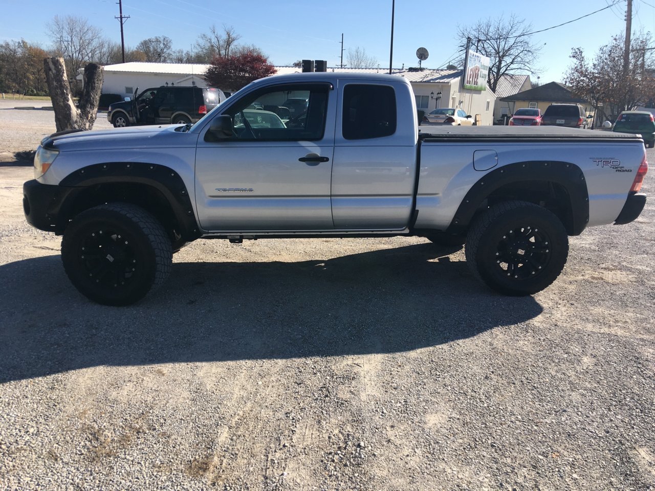

    Okay, I'm new here. Not sure if I could have just searched for info. I have an 08 Taco USED with 18 inch XD's (not sure part number or offset) on Nitto Terra Grapplers 305/60R18's. These wheels weigh about 38 lbs and am getting like 12 mpg... I would like to go smaller/lighter like 17's and tires but not sure what a good setup would be. What are y'all running and what MPG y'all getting? I just don't really want to spend $1500 on new set of tires if I could get new wheels and tires for less and improve MPG. I would like to still have all terrain tires. Thanks.

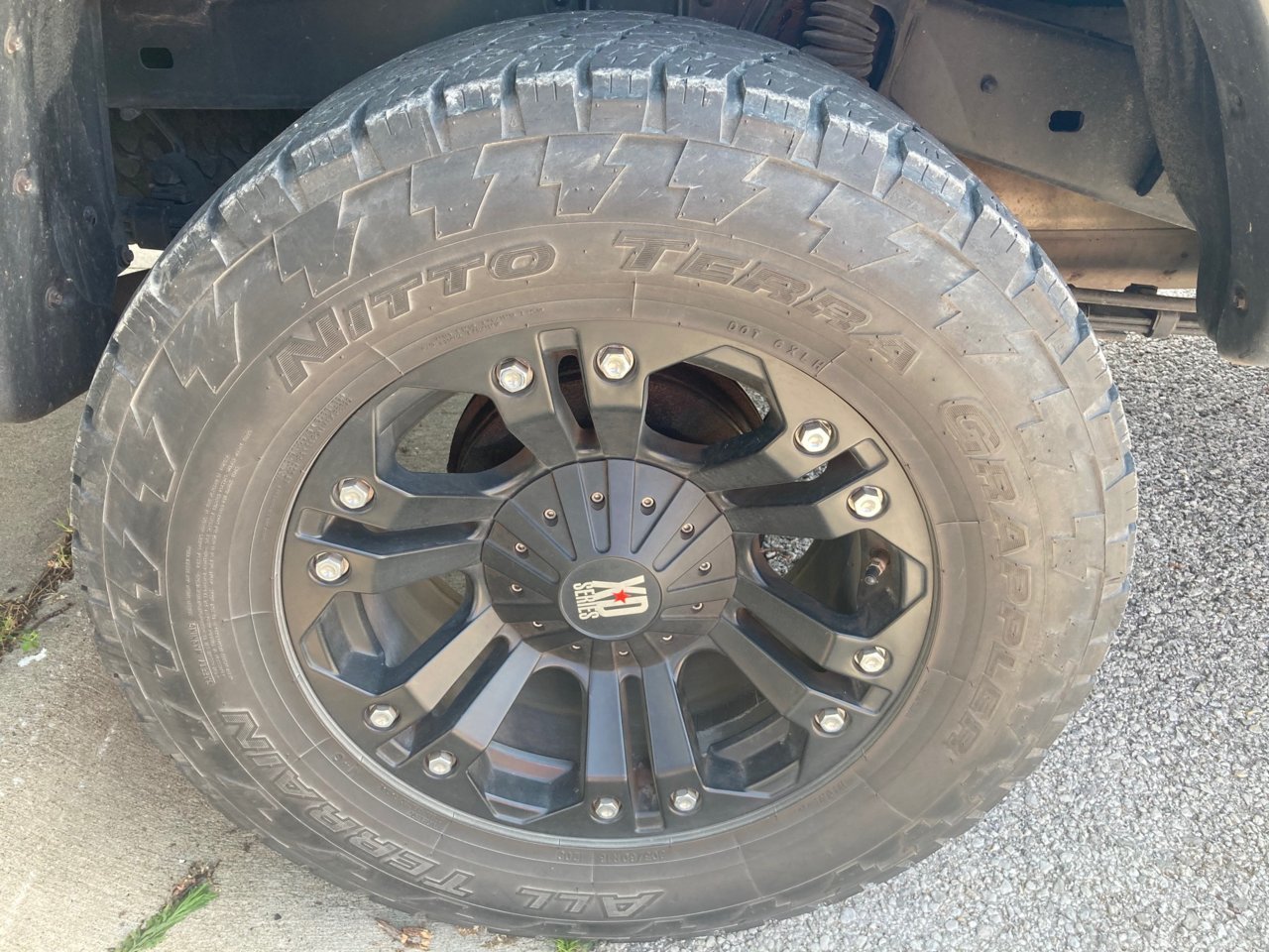

    Thank you for replying. The weight was of the wheels not tires. The wheels picture is below but I do not know which of them they are. I haven't looked up.

    I am sure truck has a lift but not sure how much. I don't want it to look stupid if I drop size of tire and wheels without taking off lift but I do want less weight. I have found some wheels that are 26 lbs each which is a big difference. Trying to examine my options.

    Its those XD wheels. My buddy has basically the same setup on his f-150 and they're heavy af.
    Look for some OEM 16-17 inch wheels for sale, any 2nd or 3rd gen style will do. I see 2nd gen take-offs with tires for cheap on CL all day long. Like $100-200 (set of 4) with tires ready to go. They fit great and don't weigh a ton, you can get bigger tires if you like and still come out lighter than those XD clydesdales
