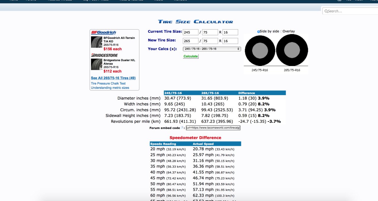

    I am currently running 245/75/16 tires and seriously thinking about upping to 265/75/16s. The tire store I usually use cautioned against this. They are concerned with:
    1. Speedometer/odometer being wrong. But there are solutions to this like that Hypertech Calibrator, ScanGauge, etc. Also I could just keep track with GPS if all else fails.
    2. Loss of power. But can't this largely be addressed by regearing? And if so at what point do you realistically need to start thinking about this?
    Thanks all.

    do a search for the 4:88 mega thread. you may find info there useful. doubt you will see any delta on the odo for that change in tire size. As for regear - spend the $ on the OVTune (several threads for manual and auto trans). Then after adding the Tune consider regear. I have both. JMO.

    I wouldn't consider a regear with 265/75/16.

    You dont need a regear for 265’s. You have a v6 shouldnt your truck have come stock with 265s. My 4 cylinder Tacoma came with 245s stock and i put 265s. Hardly notice any power loss at all and the speedo is only off by like 1-3 mph. You can go 285s without a regear.

    A regear is totally unnecessary for a swap like that.
    Not sure about the 3rd Gen, but I ran 265/75R6 Duratracs on my 2010 4.0/Auto with absolutely zero power issues. The speedometer will be off a little bit, but not by much. When your speedometer says you're doing 60 you'll actually be doing 62, but as long as you're mindful of that it's not an issue.

    regear is more of a 285s and up thing. 35s it's essential.

    Fuck em. They are idiots. Many converters online about speedometer to wheel diameter calcs. Need more power press the gas pedal. 26570s come stock on some models.

    2016 DCSB 4x4 sport
