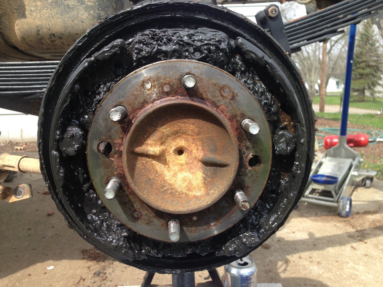

    Definitely. Don't just assume they're good because they're still working. Here's mine at 130000 miles. PA winters destroyed them. IMG_20180420_104812.jpg IMG_20180420_104730.jpg
