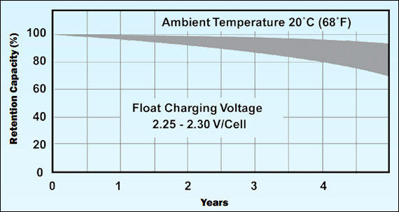

    There's several ways a battery can fail and some are abrupt (like plates shorting) but mostly they slowly age until something makes you finally notice it won't start your engine anymore. It's usually when cold weather hits in the fall that you notice it's too weak.
    What these charts are showing are couple of ways to look at it using reserve capacity and CCA or capacity vs years but there's other ways to measure it.
    Since we're coming into summer I don't think replacement is critically urgent. But you know it's lost capacity so I'd personally put it on the budget plan this spring or summer. But who knows, it make another year. I like the idea of getting a jump box and testing, but I'm a nerdy engineer so I like data and experimenting.
