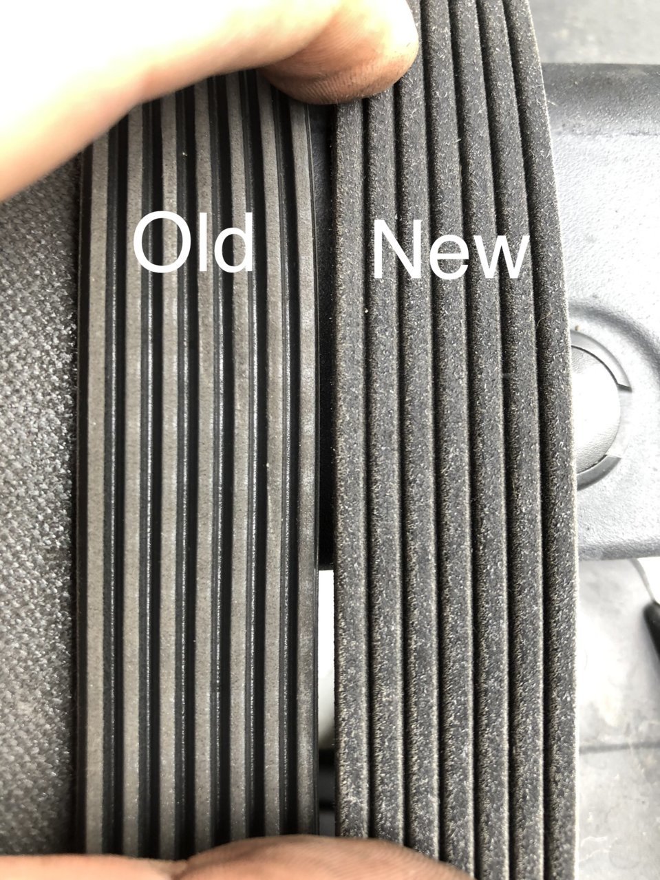

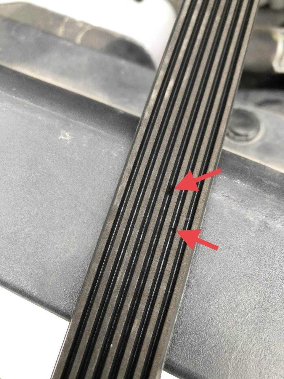

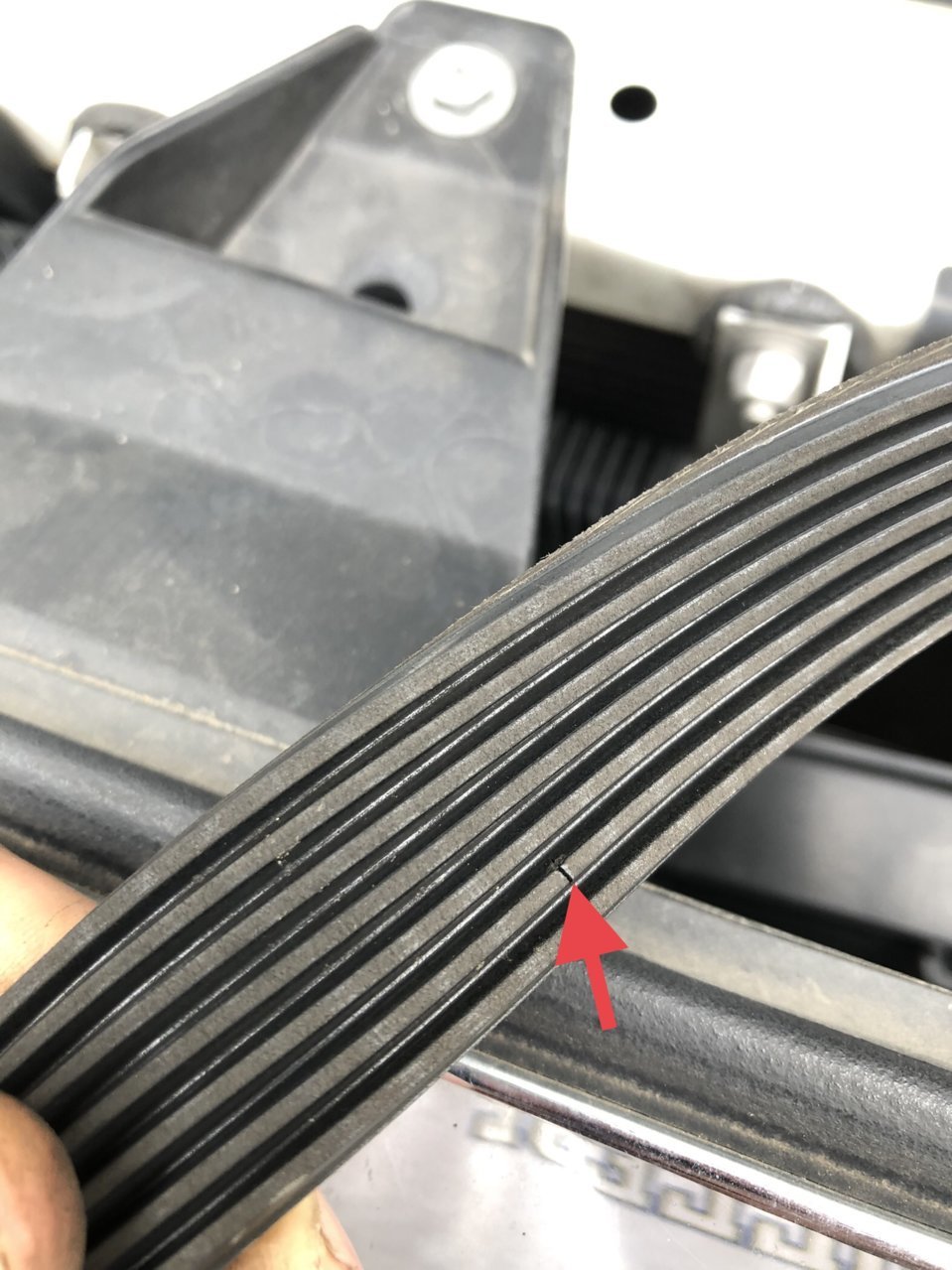

    For those Intrested in a visual comparison between a 102K mile belt, and new. Visually, it looked great while on the motor. Upon removal, there were 2 damaged areas:
    jackn7, Kolter45, NmapFE and 2 others like this.
