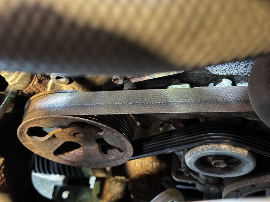

    I just checked my belt today and noticed it's split in half! I have no idea how long its been like that but luckily I caught it.
    Mileage is super low for a '14 truck only 70000km (approx 43000 miles) but it's almost 11 years old so I guess it wore out over time.
    I'm trying to find videos on how to do it myself, can anyone recommend a good tutorial? It's a 4L V6.
    Also wondering how I should check if any other parts need replacing like the idler pulley or if I should be ok replacing just the belt?

    I picked up a new belt from the dealership and not even sure if this old one is split like I thought before. It looks like a line or crack but it's still one piece. Before I start going through the process of replacing this belt, just curious if this is something that needs to be replaced right away?

    I would. I recently watched a "how to replace the serpentine belt on a Tacoma" and one video showed a belt that split in two along the same line that your belt has.
    I'd also be looking at replacing the tensioner and idle pulleys on your rig as well.

    the belt looks done
    and you're hesitating on a $20ish belt showing a picture of something that looks like it came from the titanic.
    However unlikely, a simple belt is the best case scenario.

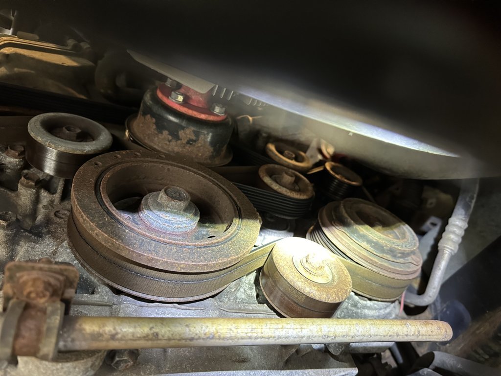

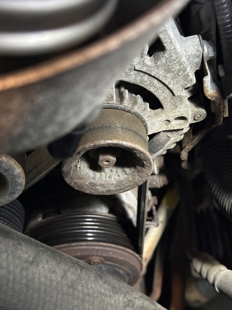

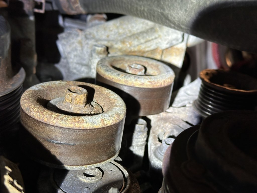

    well it's almost $100cdn around here.
    but either way you're right it's done. I just got the skidplate off and it's nicely split down the middle.
    Looking at that pulley it looks like there's a ridge so it's been worn on each side. Guessing that will need to go too.

    While you have the belt off, spin each of those pulleys and see if they spin smoothly and quietly, or if they make any grinding noise or have play in them, replace them. Otherwise they should be fine for a while as long as that “ridge” isn’t actually raised metal, from the pics it looks like it’s still flat.

    Yeah that ridge seems to be on all the pulleys and I believe it's the rubber melted on from the belt. It scrapes off with my finger nail so I think I can clean them up.
    All the pulleys sound and feel fine except the lowest one, it sounds like an old skateboard wheel so i'll try to replace it.
