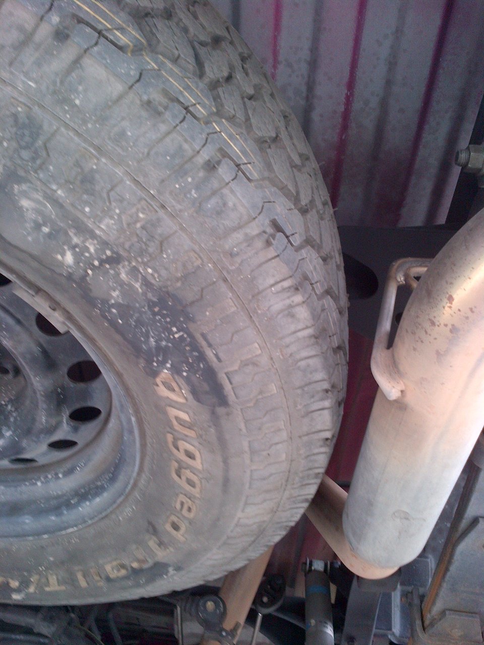

    Can the docking arms underneath be widened somehow to accept a 33" spare?
  8. Mar 18, 2018 at 4:37 PM
    #48
    ggmanning
    ggmanning Well-Known Member
    Mar 21, 2017
    #213973
    77
    07 FJC, 03 TRD Offroad, 11 TRDPro, 14 Landcruiser
    Yes. I just mounted a 285/75/16 under mine with no issues at all. Bend the rear docking arms back a couple inches.
  9. Mar 18, 2018 at 6:59 PM
    #49
    arctic04trd
    arctic04trd VA7XTE
    Nov 23, 2015
    #170508
    880
    British Columbia
    2010 DCLB
    Cut em off. Angle grinder w/cutoff wheel and 4.5 min of your time.
  10. Mar 18, 2018 at 7:02 PM
    #50
    Gyrkin
    Gyrkin Well-Known Member
    Aug 16, 2017
    #227041
    2,386
    Steve
    Wyoming
    2000 Tacoma TRD v6 5-speed
    Do you need to cut them all off, or just the back two?
  11. Mar 18, 2018 at 7:04 PM
    #51
    ggmanning
    Mar 21, 2017
    #213973
    77
    At least keep the front ones or so the axle wont hit the tire articulating. There is no need to cut....bend out the back ones like I said earlier. It takes a pair of channel locks and 30 seconds.
  12. Mar 18, 2018 at 7:30 PM
    #52
    arctic04trd
    arctic04trd VA7XTE
    Nov 23, 2015
    #170508
    880
    British Columbia
    2010 DCLB
    I cut them all off. Axle flexes fine I checked. Also, the cable keeps the tire against the bed...don't really need the front supports

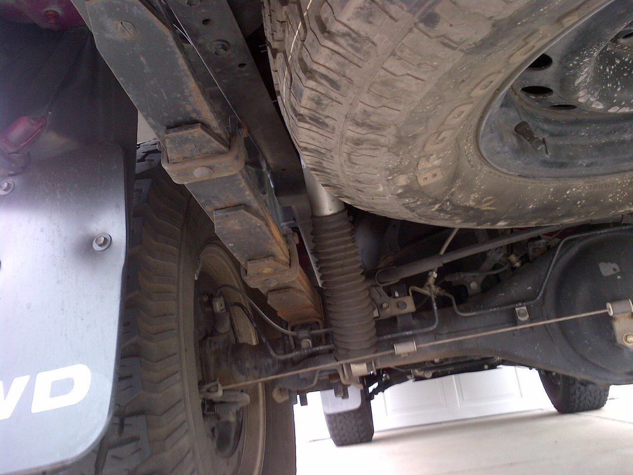

    I am running 285/75/R16 tires, too. Here is a photo showing the original spare (31") tire. (Not sure why I have been driving around with a useless spare all of these years.) There is not much space between the leaf spring on the left and the TRD cat-back on the right.
