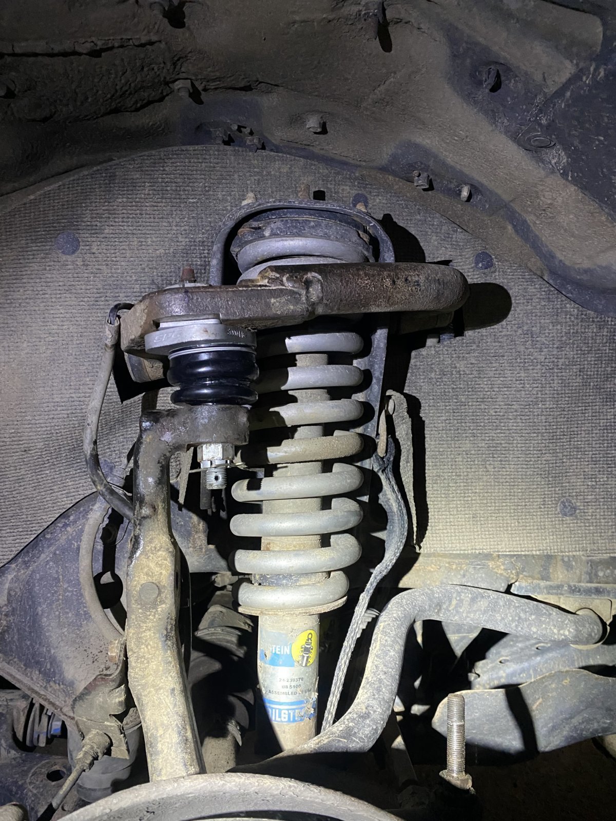

    Replaced the pads and rotors again
    Replaced the ball joints and sway bar end links again.

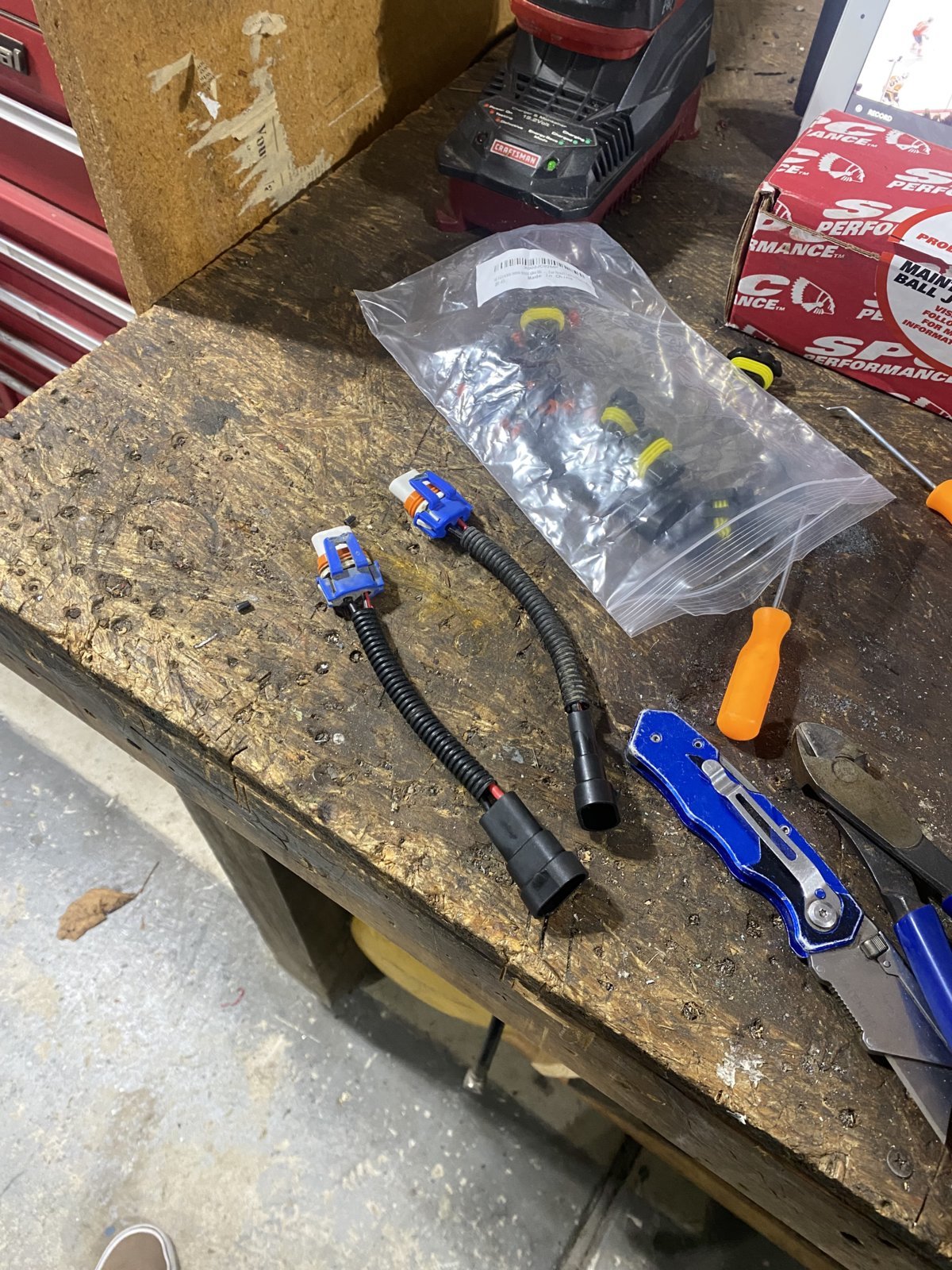

    Rebuilt the ceramic fog light jumpers

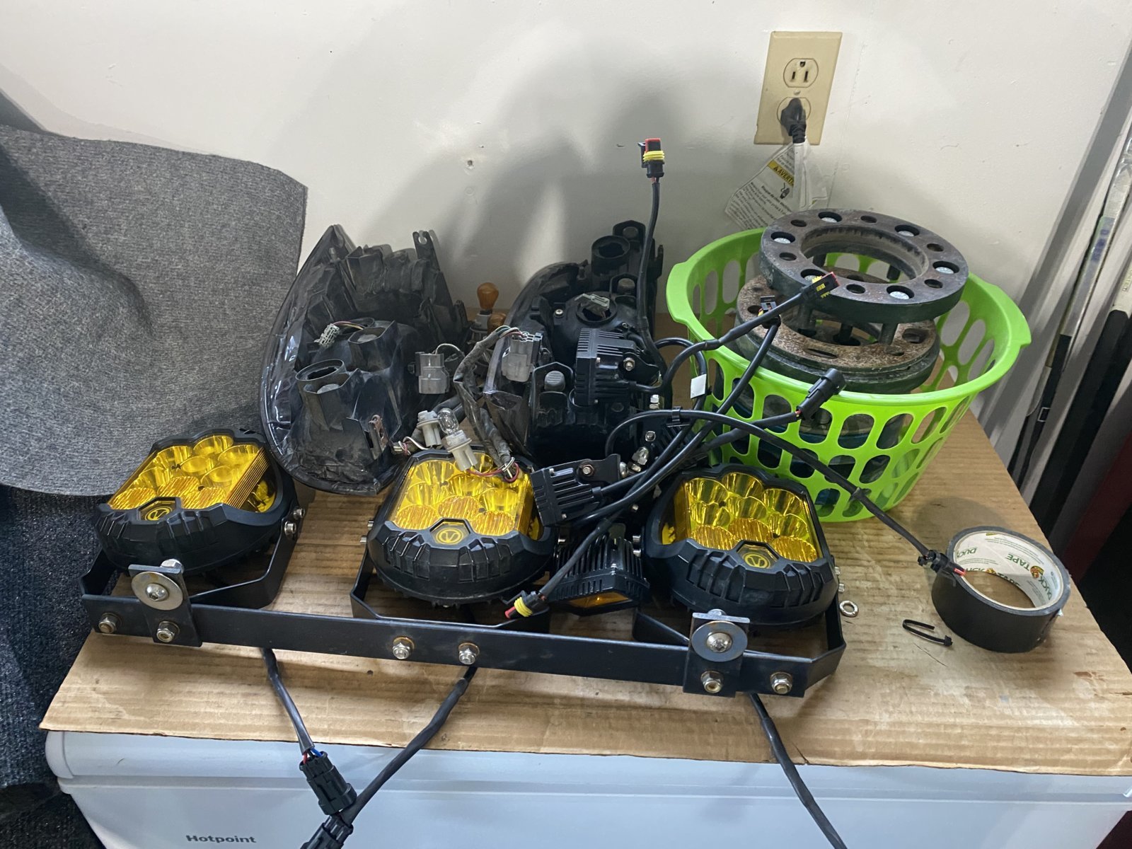

    I need to fix the high mount auxiliary back up lights. There’s a short to ground in the harness somewhere - probably in one of the crappy GM Weatherpack connectors.

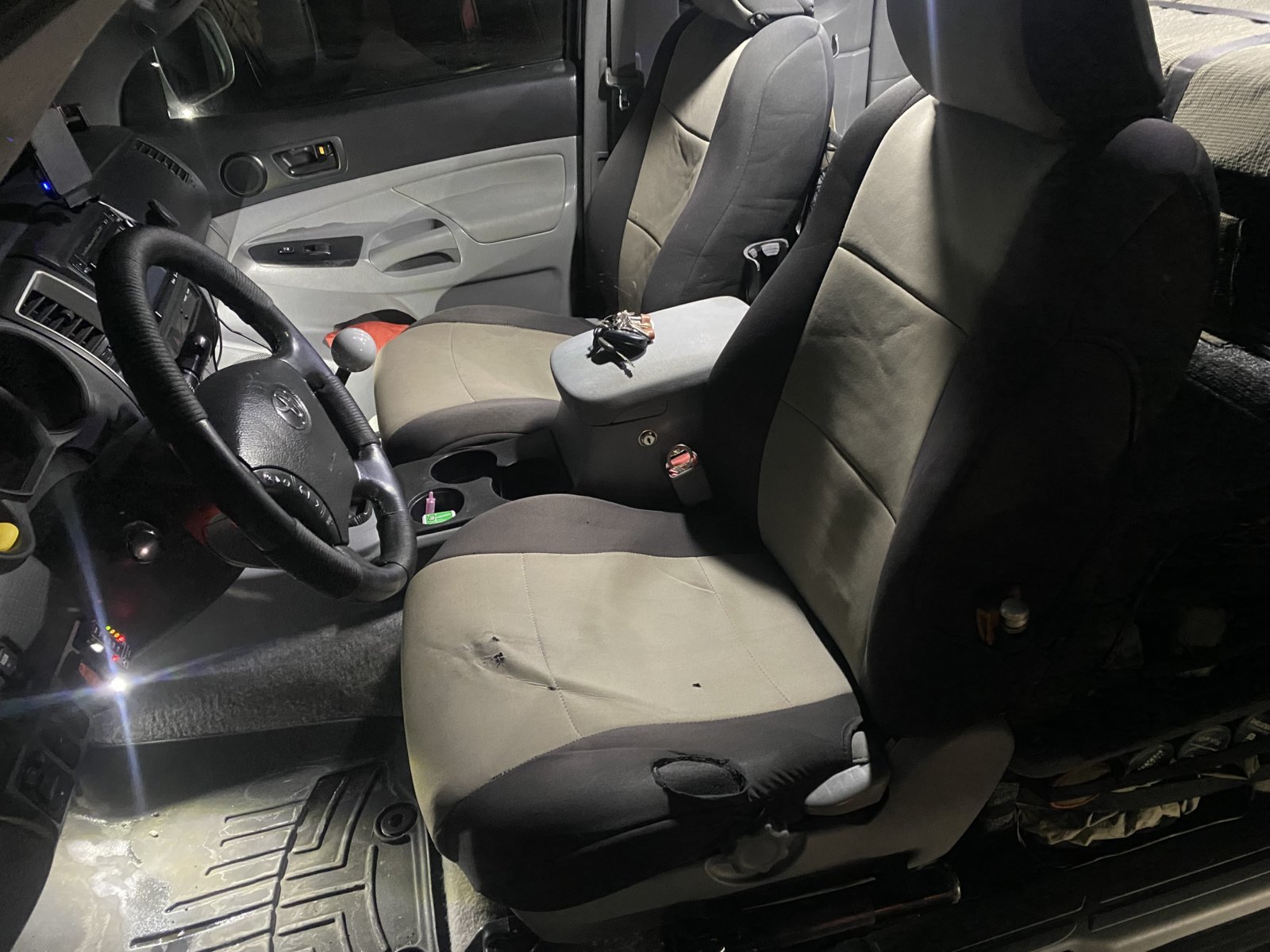

    Update :
    Replacement seat covers showed up.
    The interior looks so much better with a fresh set of sway covers.
    Before :
    After :
    I love that Coverking will replace them for 100$.

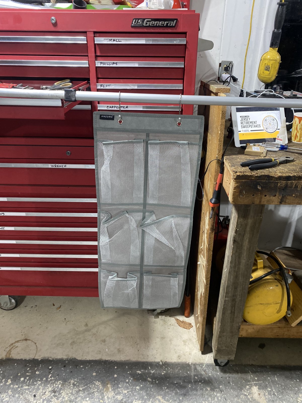

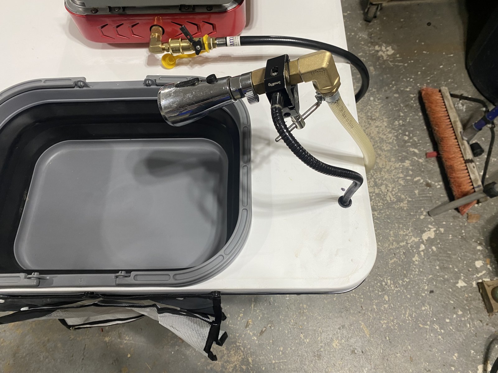

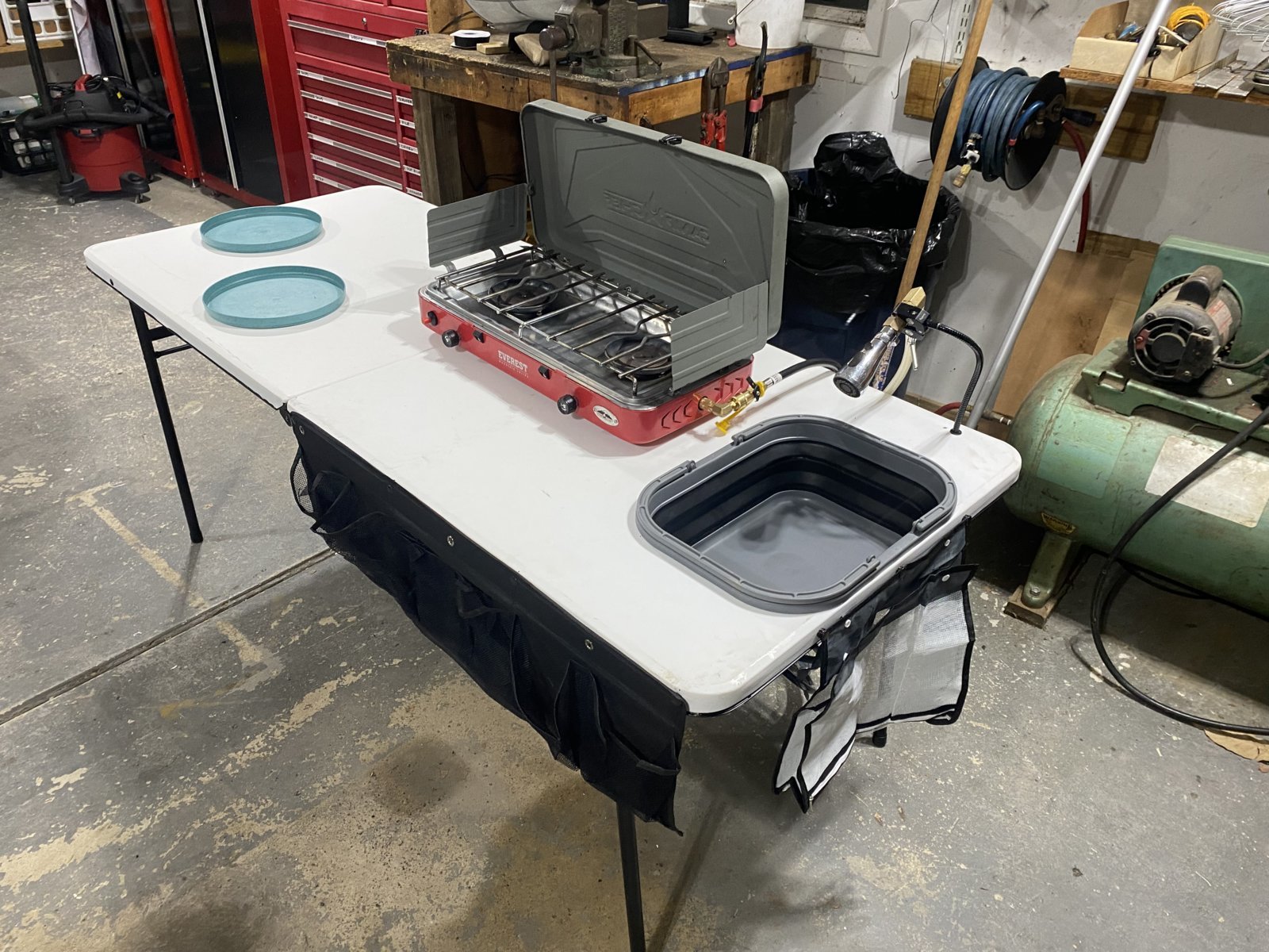

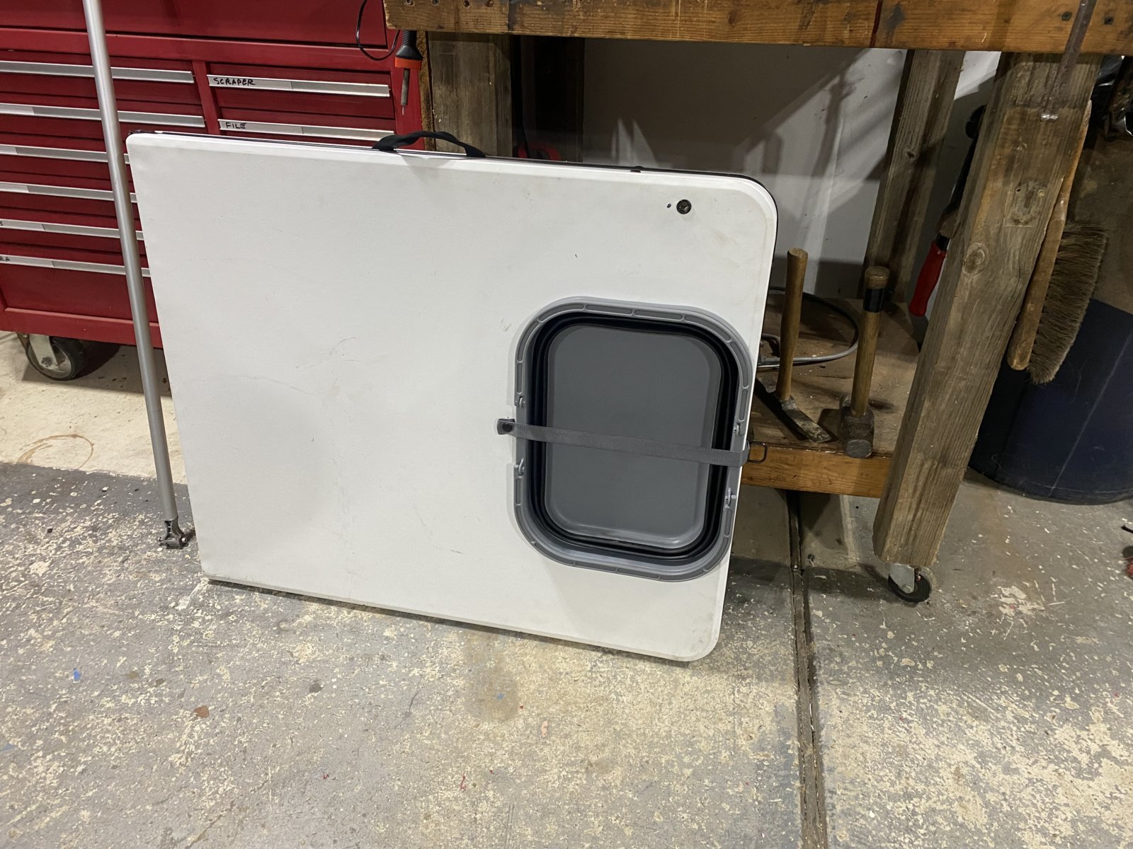

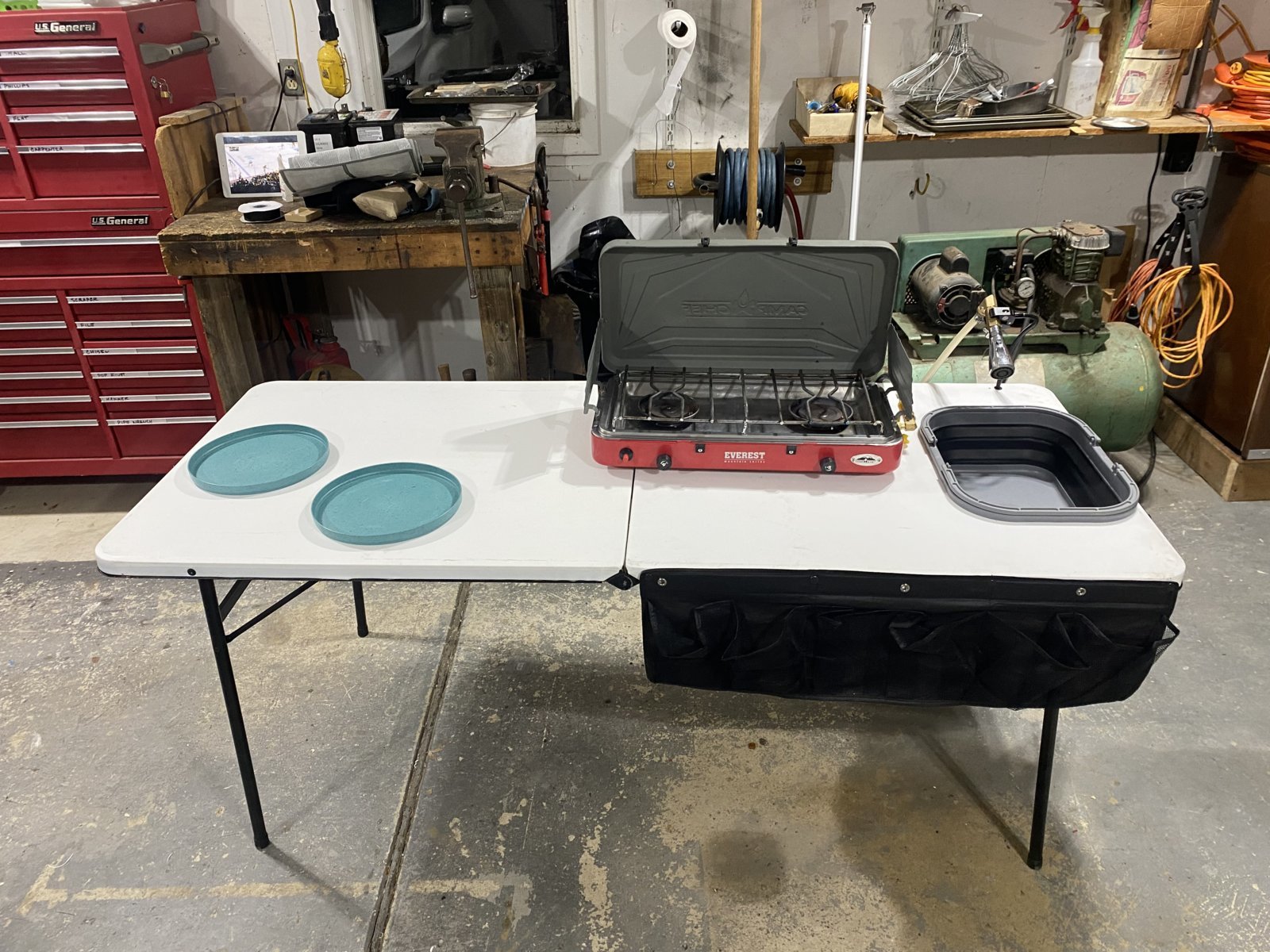

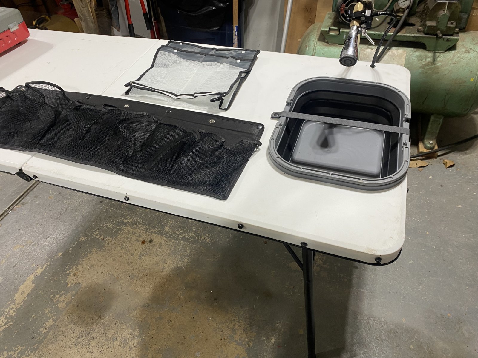

    Other than that, I’ve been putzing around with a new camp kitchen/table.
    We’ve been dragging around 2 48”x24” folding tables for camping - one for cooking/washing and one for prepping and eating. They take up too much room.
    I found a 72”x30” folding table that will do everything. It’s large enough for the sink and stove, enough for prepping, and still enough room for 2 of us to sit and eat at.
    Here’s the initial design:
    And here’s what I came up with.
    I added detachable storage pouches across the front and a mesh drying pouch next to the sink.
    And the sink will fold up and stay attached to the table.
    I’ve been putzing around with other storage ideas as well.
    I got 2 of these - one to hang off the awning and one to hang in the tent for storage.

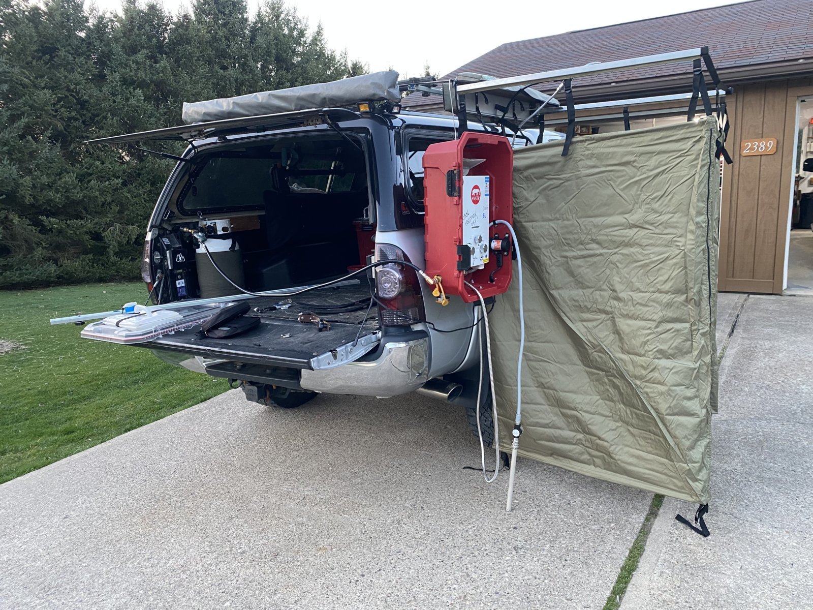

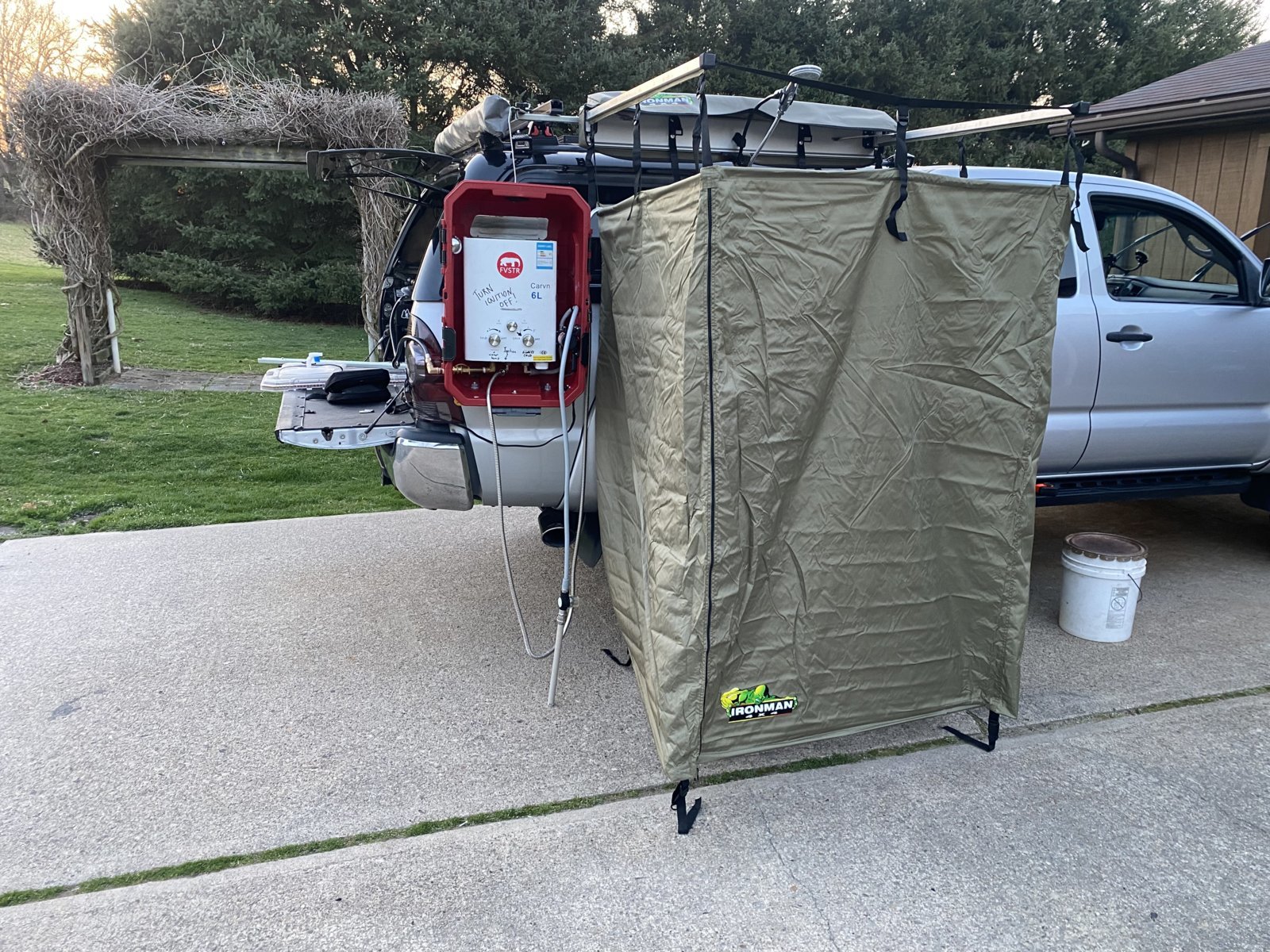

    Another small update -

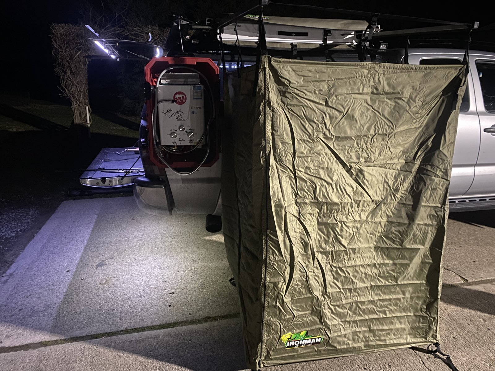

    Got tired of using a little pop up privvy for camp showers.
    Picked up an Ironman en-suite on sale for 120$ shipped.
    Finally got around to mounting it.
    Now it just needs to warm up enough to start camping again.

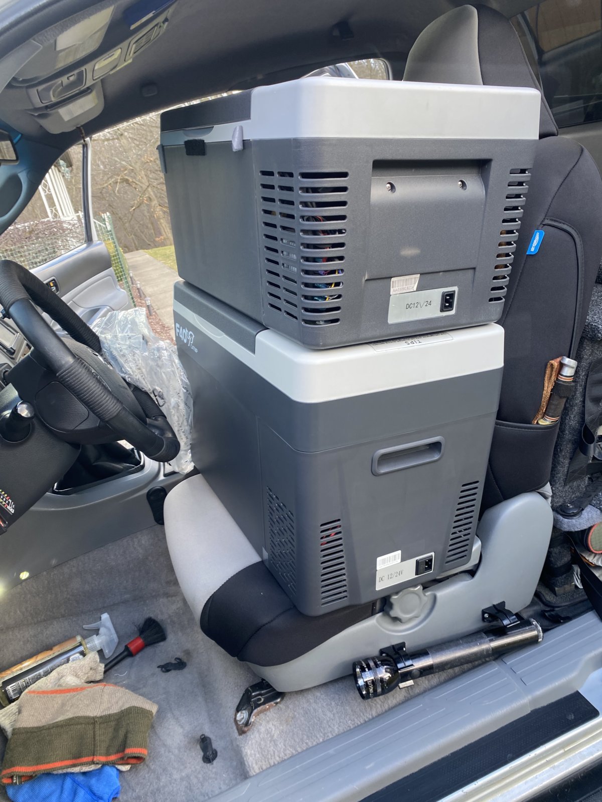

    The fridge I have is cool but it’s not big enough…
    So I bought a new one.
    Same brand, just larger.
    The old one is a 20qt, the new one is a 30qt.
    I cut 1.5” off of the legs on the platform to make it fit better.
    I need to find a piece of carpet cover the new side pieces because the new fridge is just a little wider.
    I’m happy with the fit, I just need to find a basket for it.

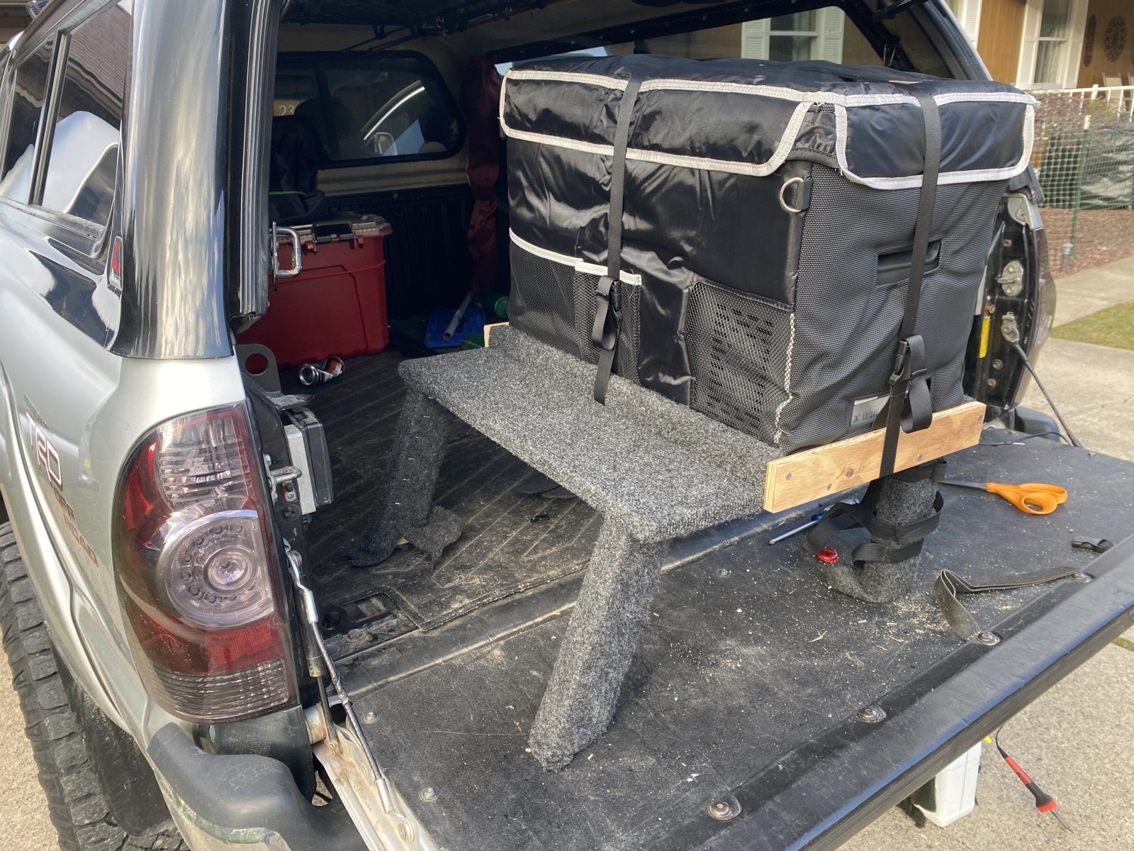

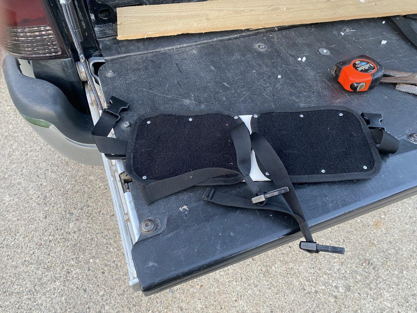

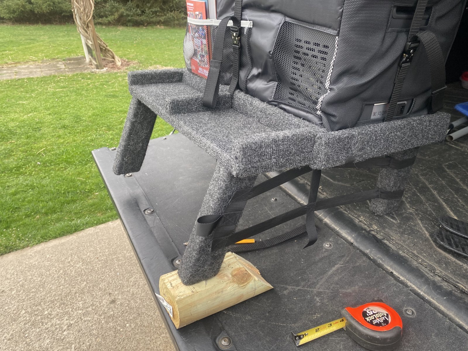

    Finished up the new fridge platform.
    Chopped 2.5” out of the original platform height.
    Lost a little bit of of storage space under the platform, but I can open the fridge enough to get the plastic tubs out out it now so it’s worth it.

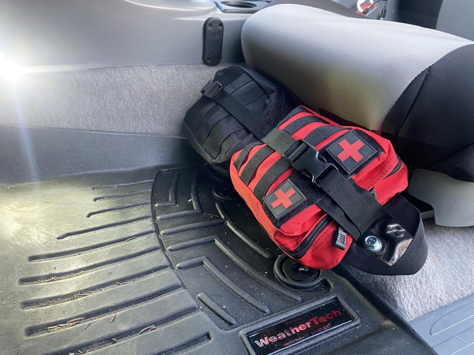

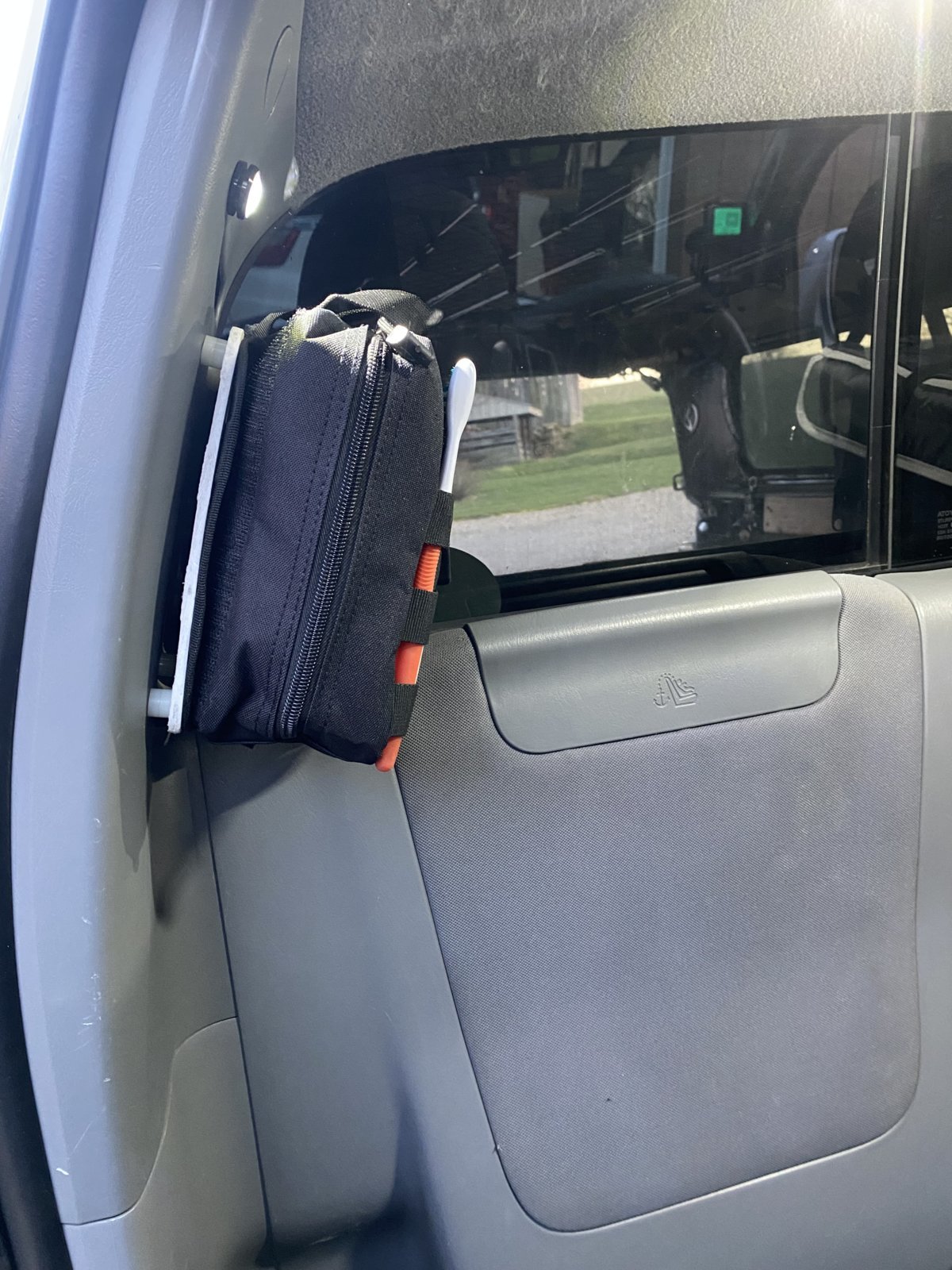

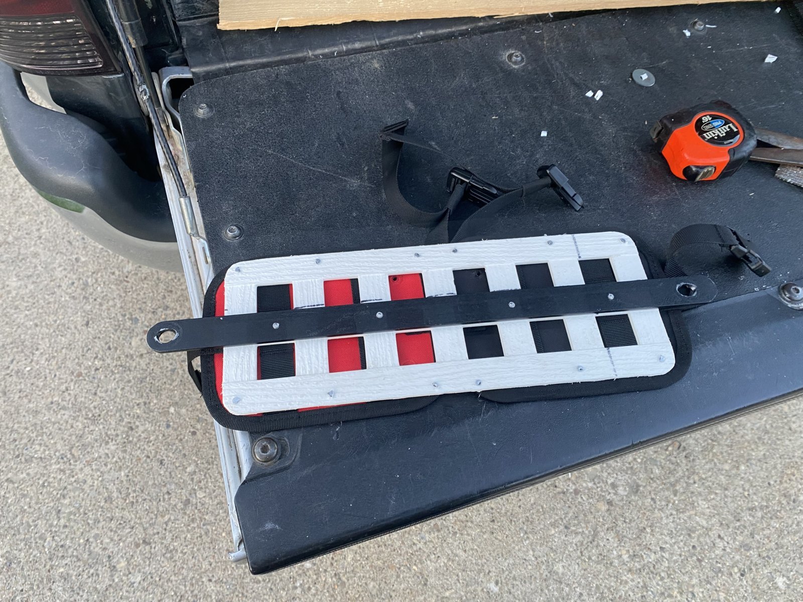

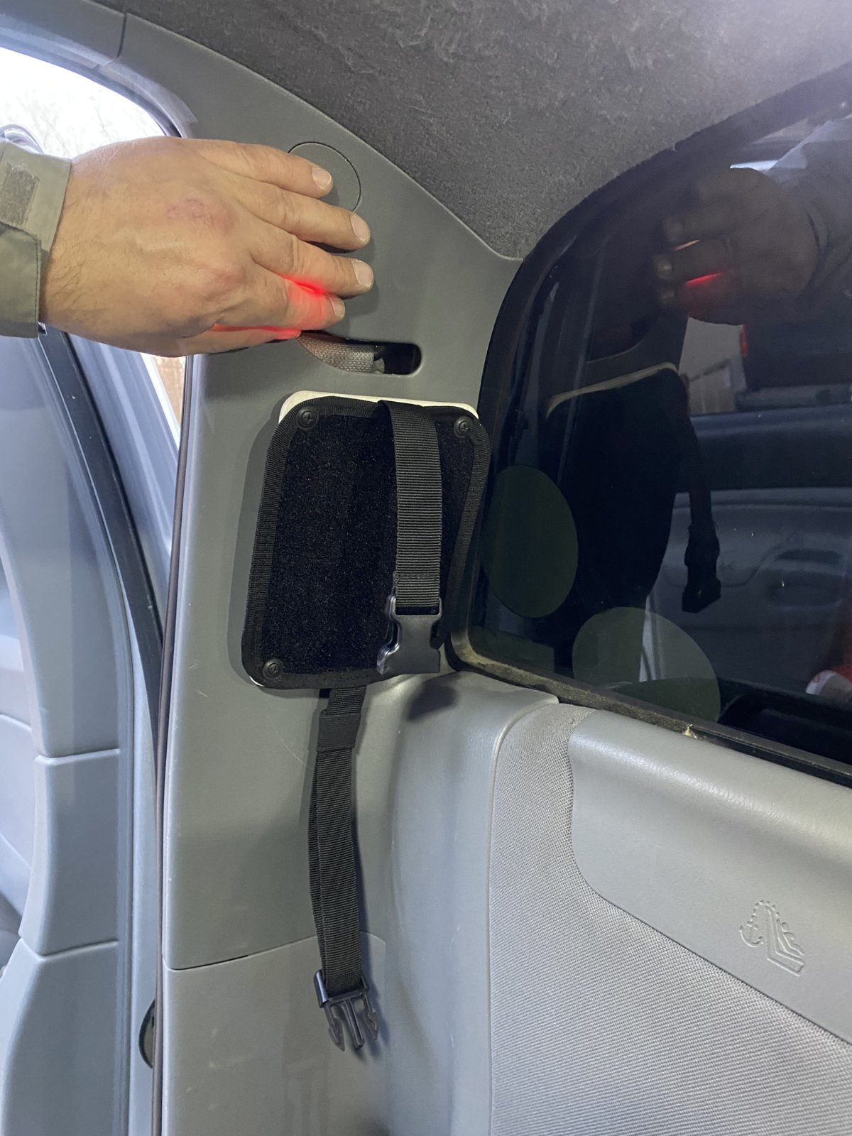

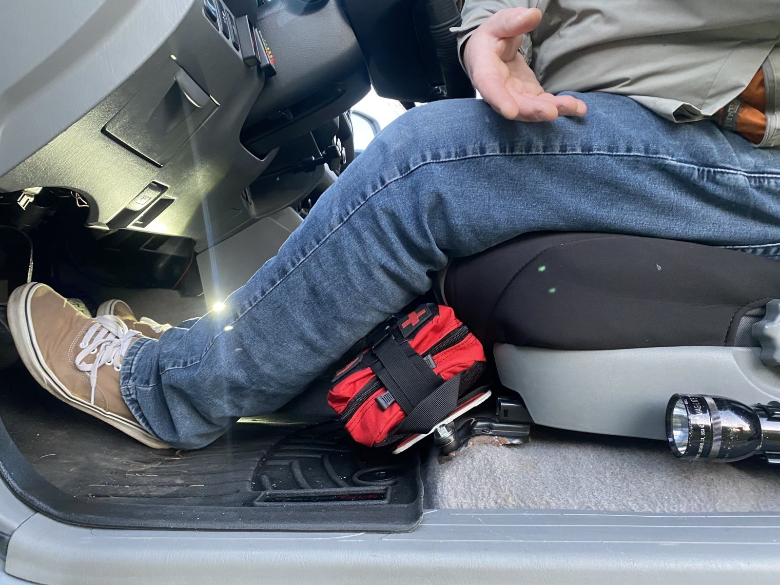

    I finally got around to making a bracket to hold the first aid kit and misc stuff Molle pouches.
    I found Velcro backed Molle pouches that are designed to be “quick release “.
    And I redid my camping toiletries bag to match the other two Molle pouches.
    Crossing more little stuff off the list.

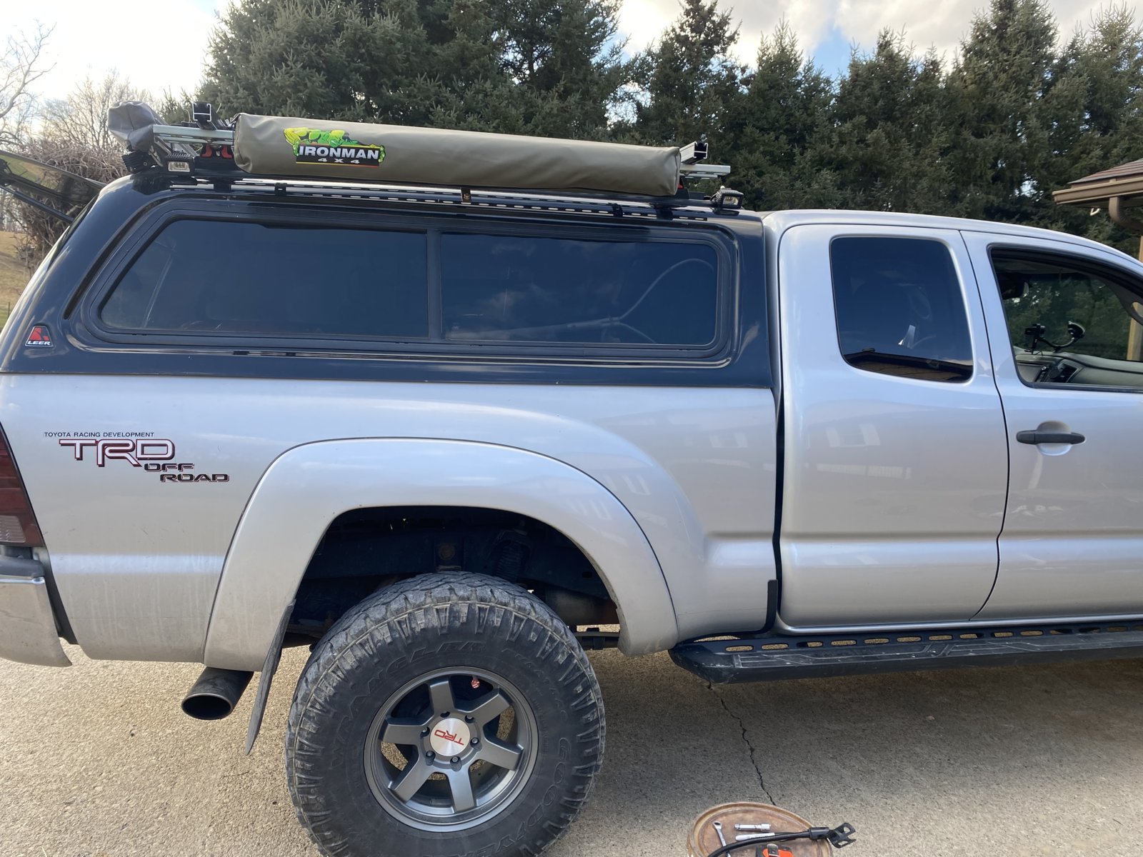

    Finally finished the en-suite and water heater mount
    The mount slides out on the cross bars to get the material off the truck when using. Then it slides back once it’s all rolled up to keep it tucked up agains the shell.

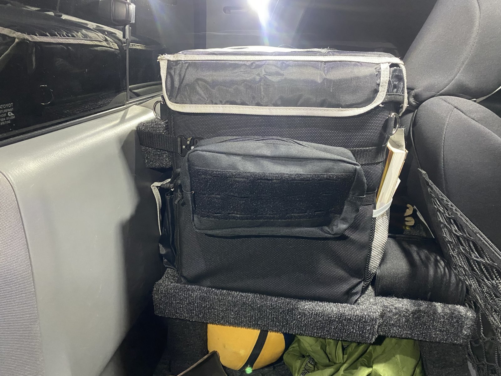

    I’m gettin really bored…..

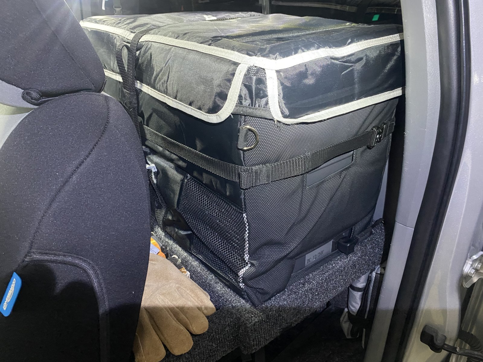

    100% sorted out the fridge platform I think.
    Added a couple small dividers to it.

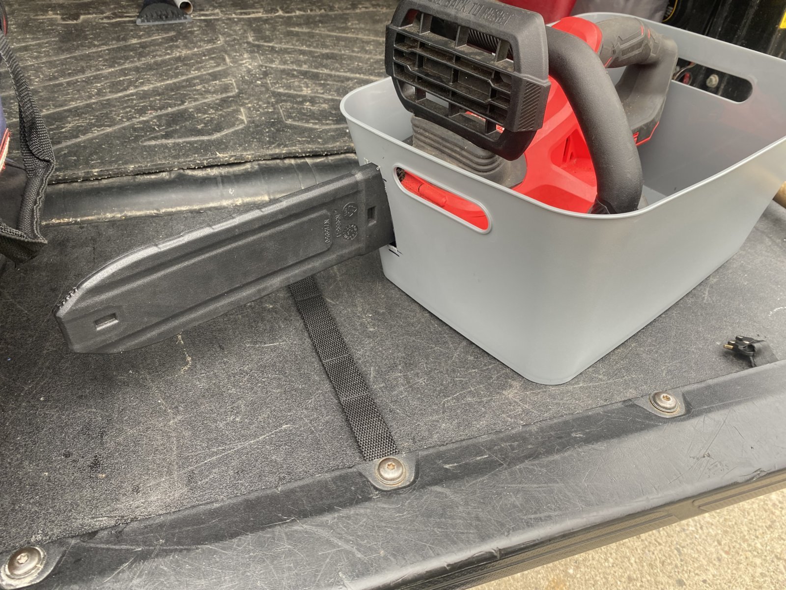

    And I finally sorted out my chainsaw bag.
    The saw leaks bar oil if it’s not on its side.
    Nothing a 5$ bin from Walmart can’t fix.
    Now the stupid bag isn’t gonna be saturated in bar oil.

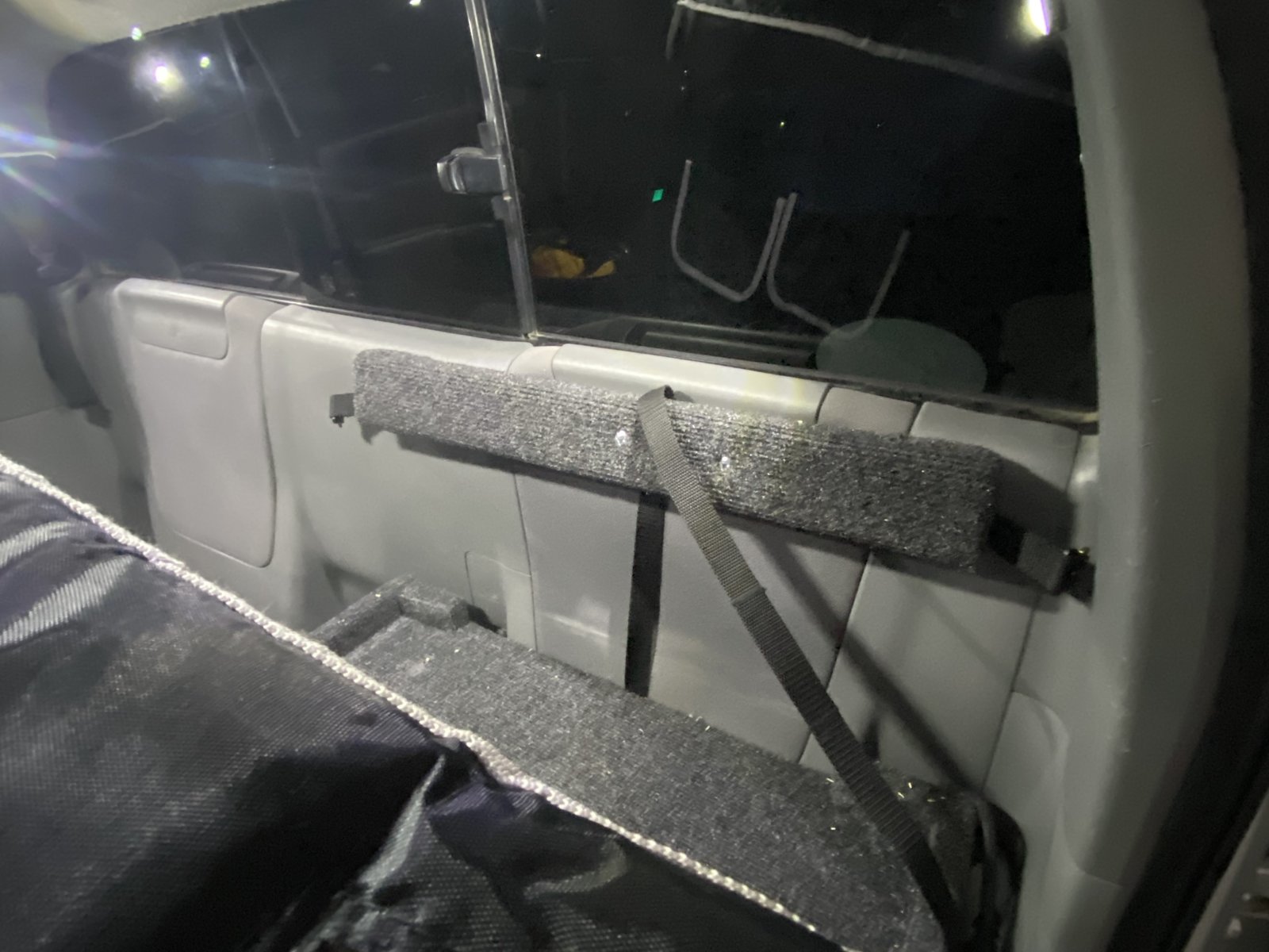

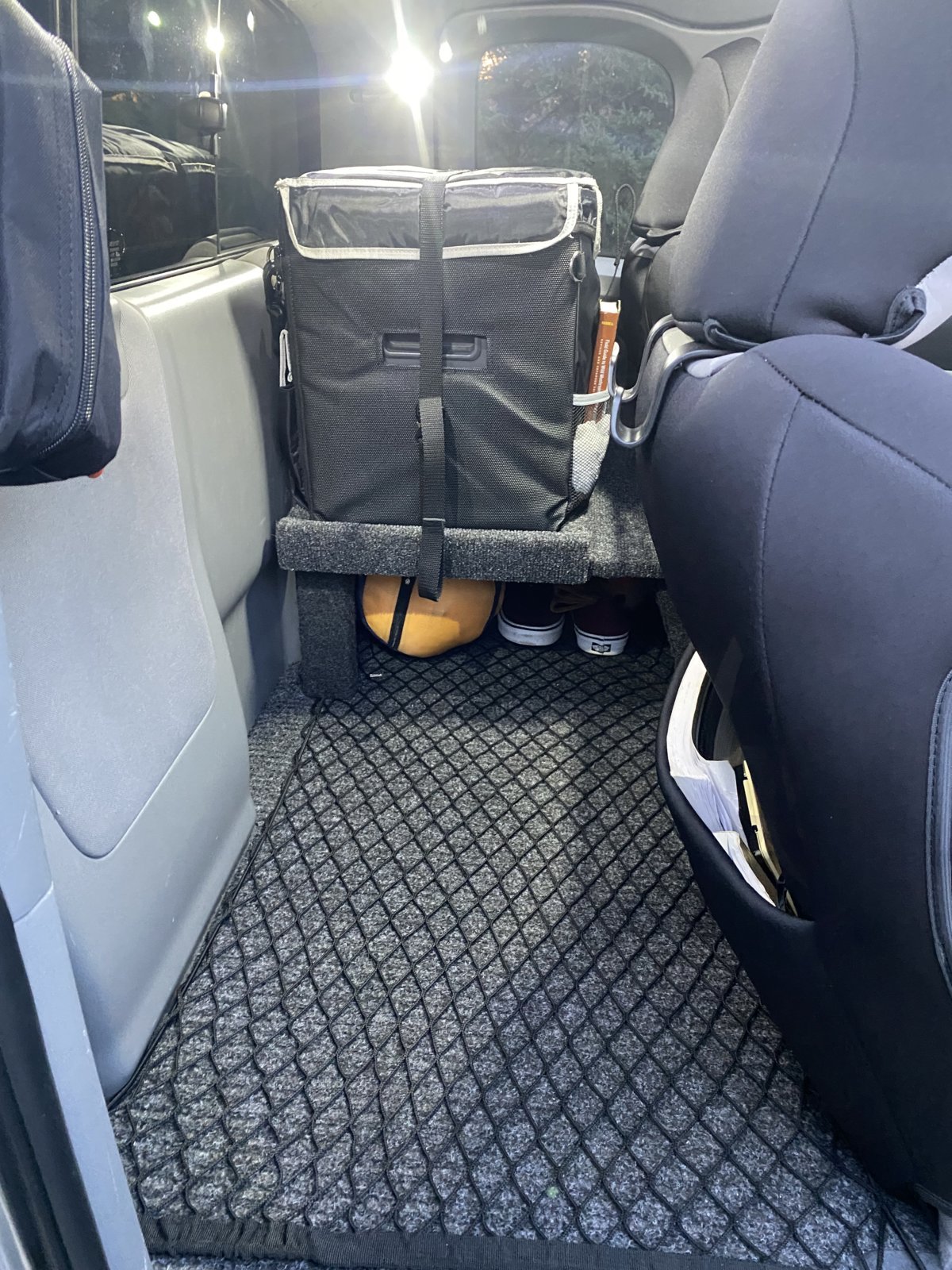

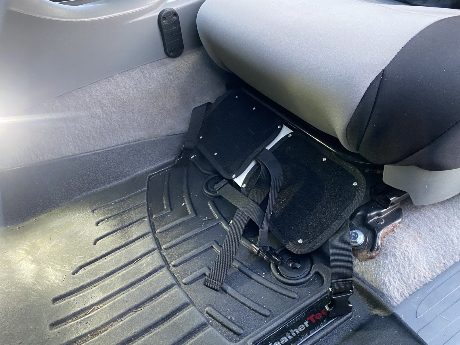

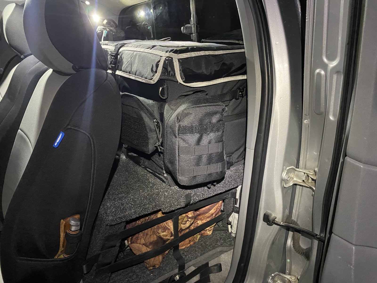

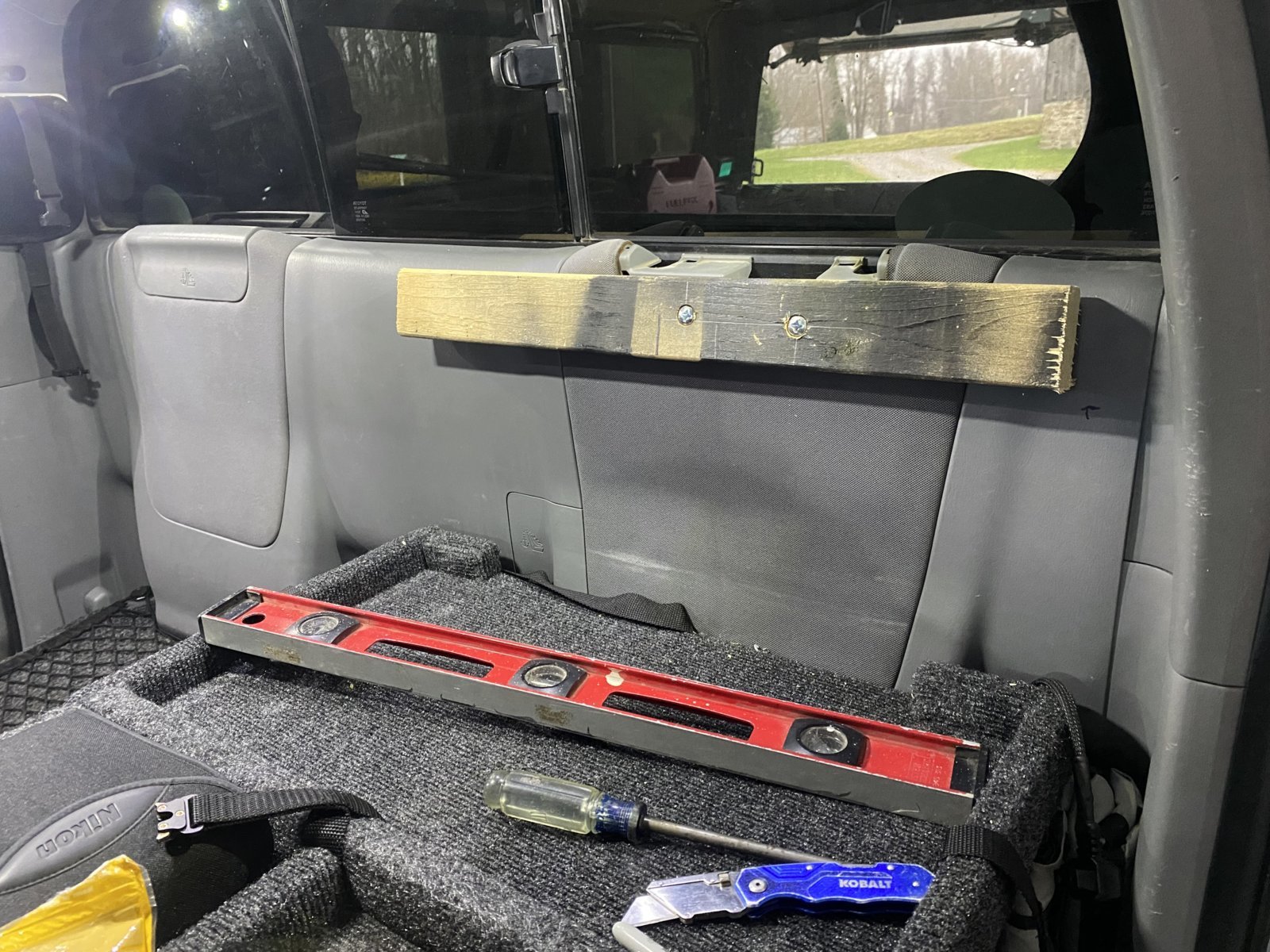

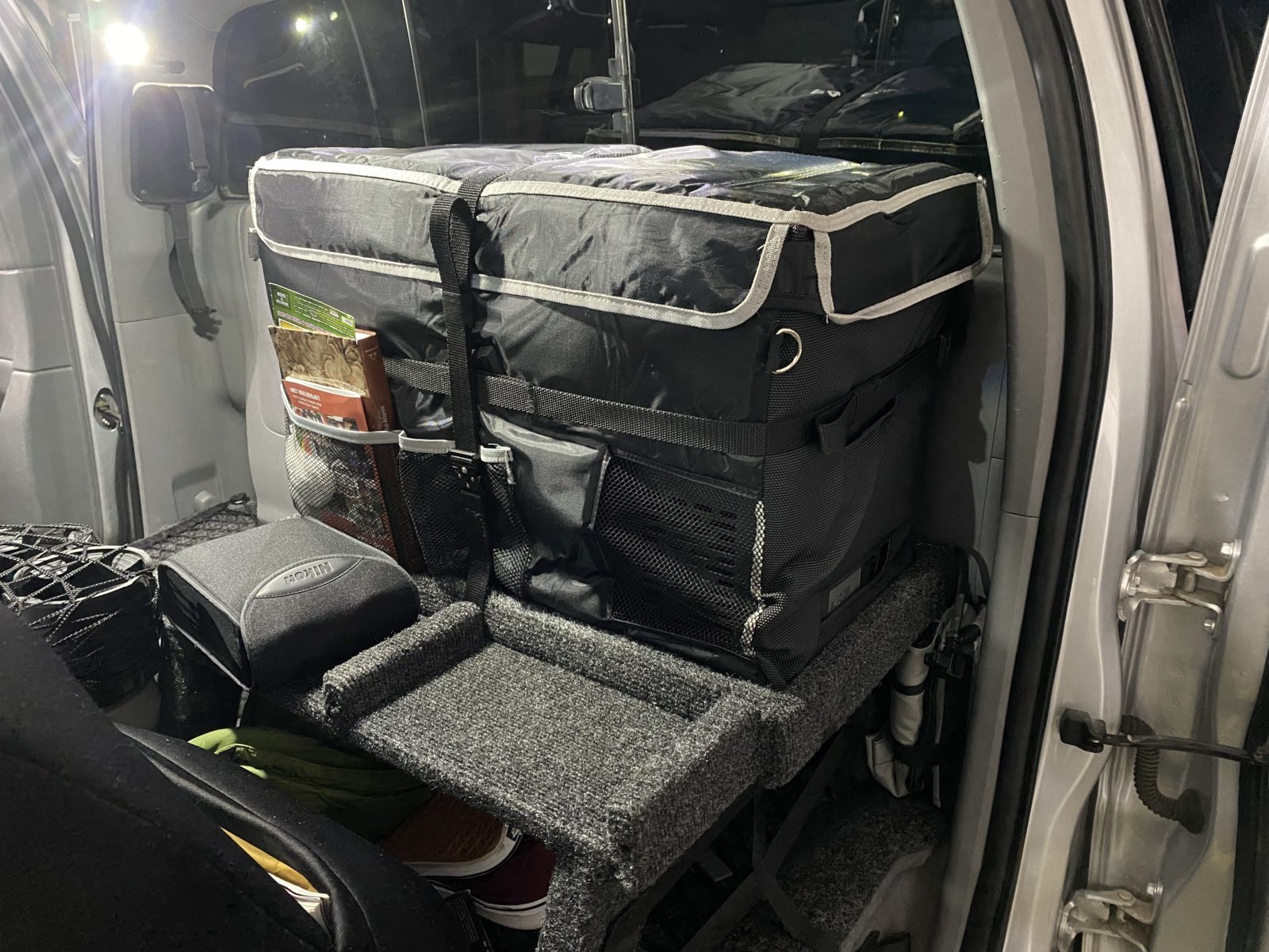

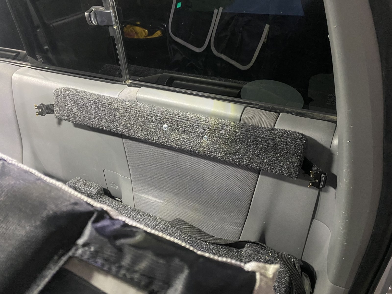

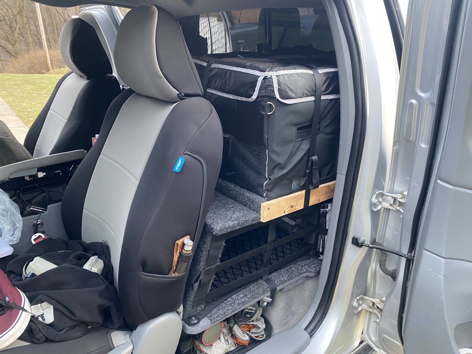

    After staring at the fridge platform for a while, I still wasn’t happy with it.
    The fridge is strapped down to the platform and you have to undo 2 buckles to open the lid.
    However this fridge and the old one wasn’t mounted to the truck and I’ve never really liked that.
    So today I figured out a more secure mounting solution.
    The bulkhead behind the rear seat has threaded mounting points where the headrests mount. Since I don’t have headrests, this would be the perfect place to tie the fridge into.
    I took a piece of 2x3 and countersunk 2 holes into it to bolt it to the bulkhead.
    Wrapped it in matching carpet, and added a strap and 2 buckles to it.
    Bolted up to the bulkhead.
    Now the fridge sits on the platform and the strap pulls the fridge tight against the 2x3.
    The fridge is super secure now. I don’t have to rely on the straps holding it in place anymore. The singular remaining strap is just there to secure the lid at this point.

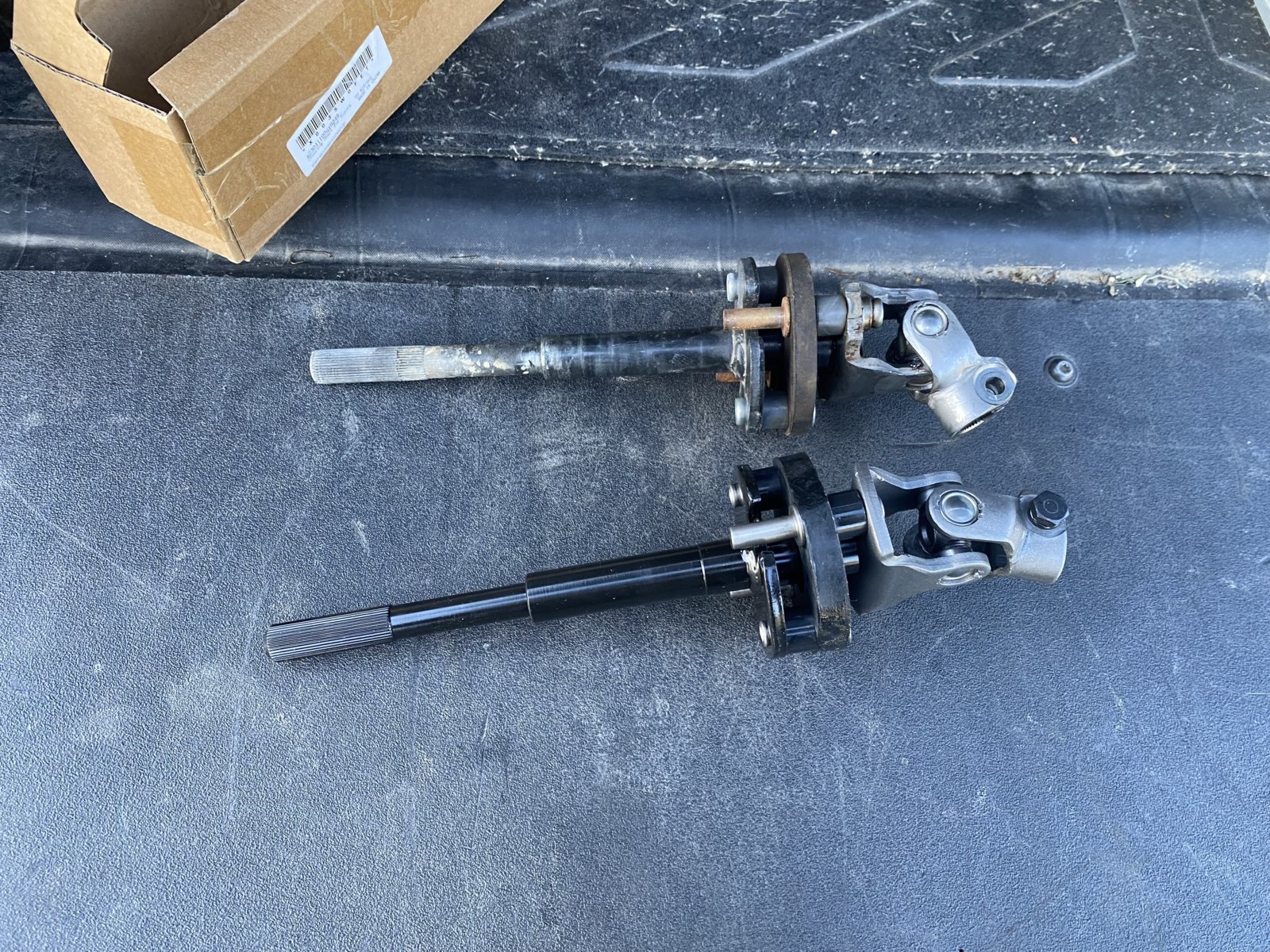

    Replaced the rag joint finally.
    Most of the excessive play is gone from the wheel finally.

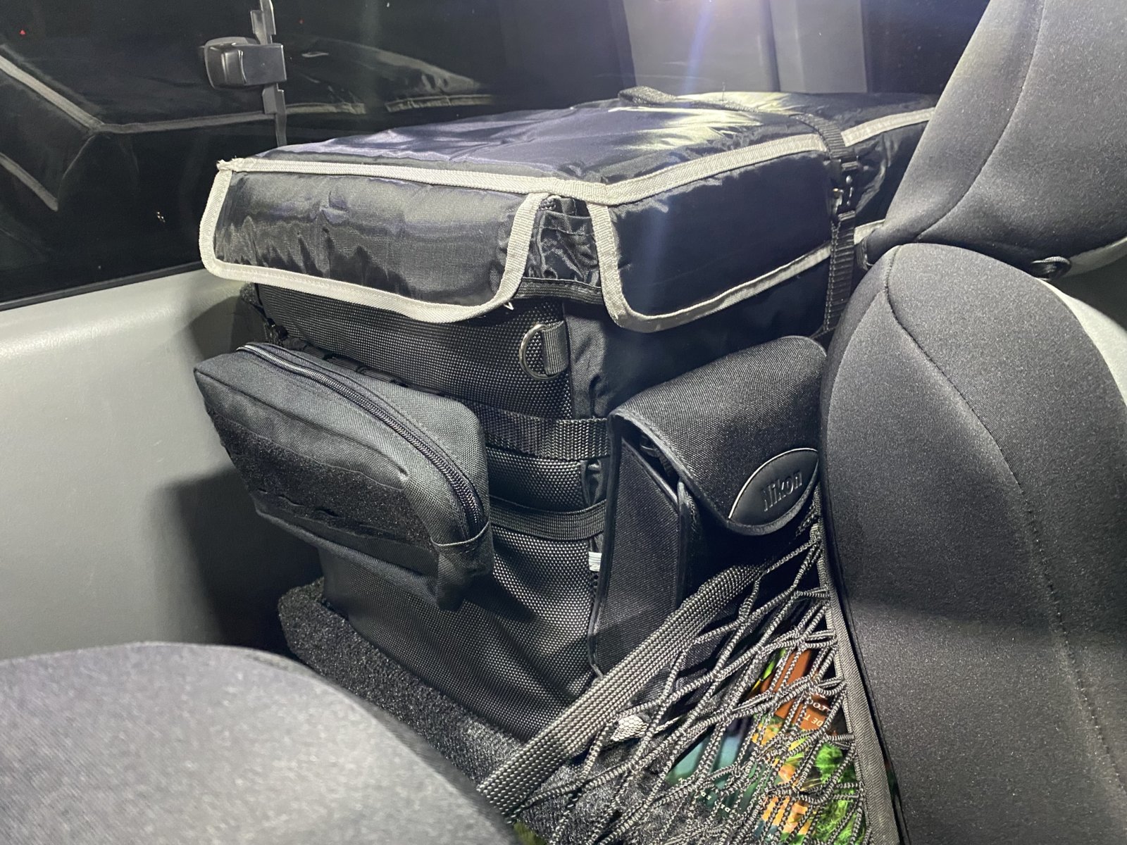

    I added a light under the fridge platform and wired it to the door pin switch.
    And I’ve become really obsessed with storage lately.
    I added a couple Molle pouches to the fridge strap foradditional storage space.

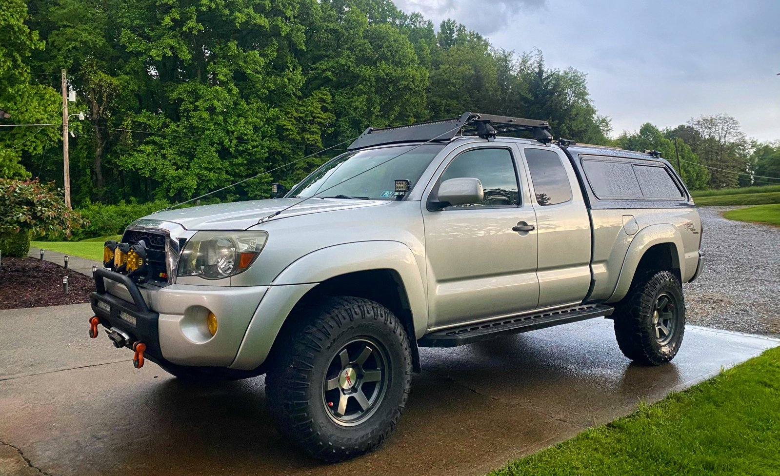

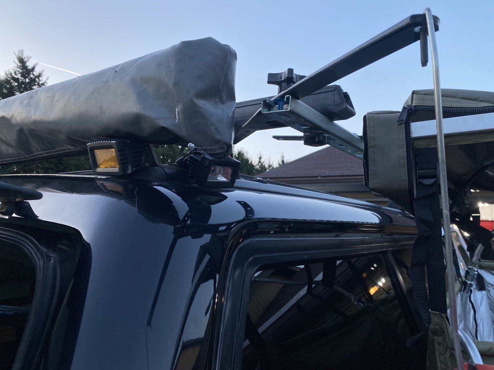

    Got bored. Put the cab rack back on.
    Installed the limb risers just because.

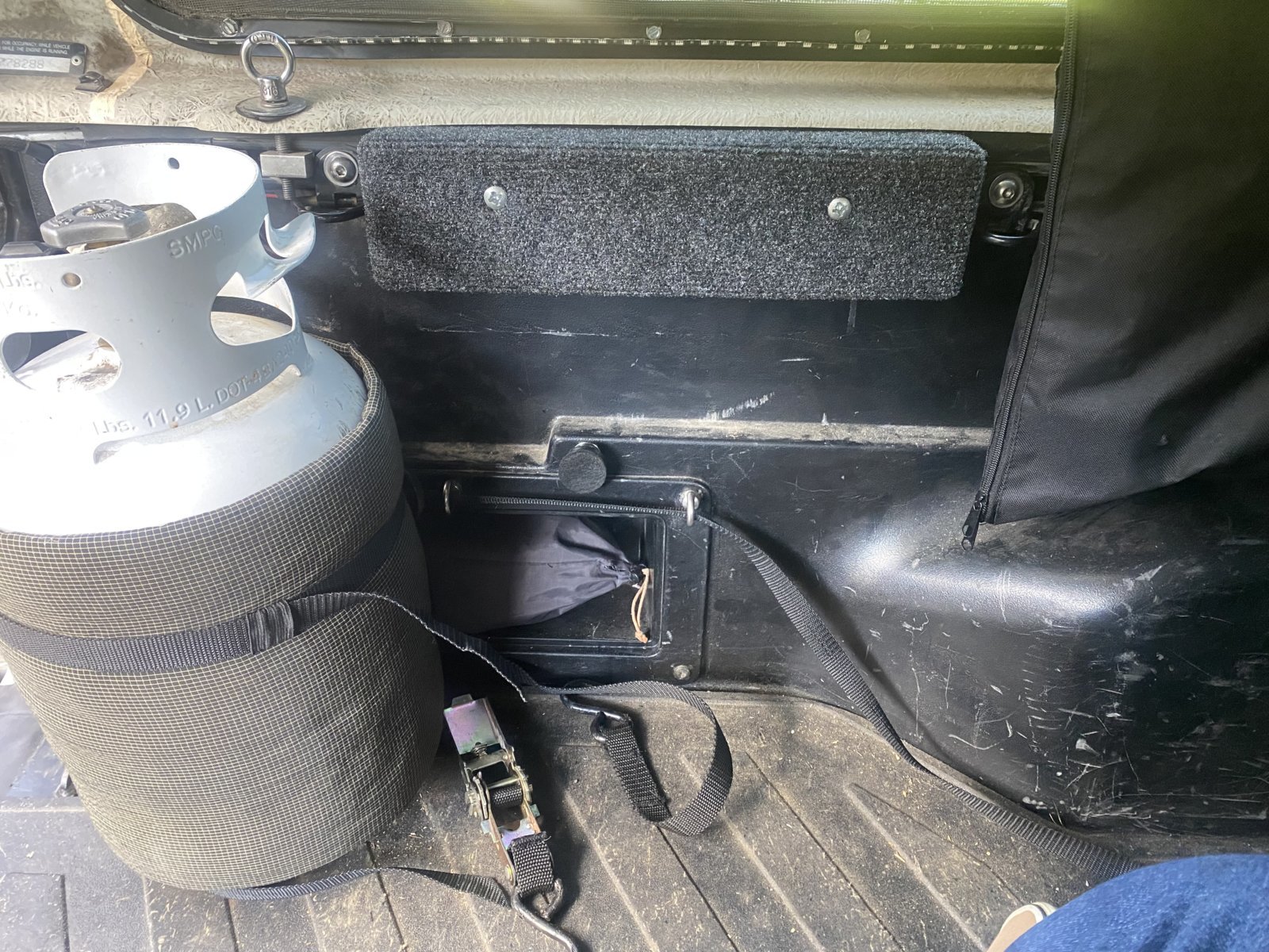

    And I finally sorted out the jerry can / propane tank mount to the point I’m 99% happy with it.
    And I finally sorted out the on board water set up. Just waiting on parts to show up now.

    Ohhhh, I like that rack, I don't really feel the need to drill into my roof and that option looks baller
  20. May 11, 2024 at 9:11 PM
    #240
    steveo27
    steveo27 [OP] Ask me about my weiner
    Aug 12, 2013
    #110326
    6,078
    Steve
    Pittsburgh
    '11 TRD Off Road & 1992 VW GLI
    The same shit everyone else has.
    Thanks.
    I didn’t wanna drill either.
    Rhinorack feet and cross bars.
    DIY baskets - Unistrut and 1.5” angle iron.
    DIY fairing - 1/4” plexi
    40” Amazon light bar.
