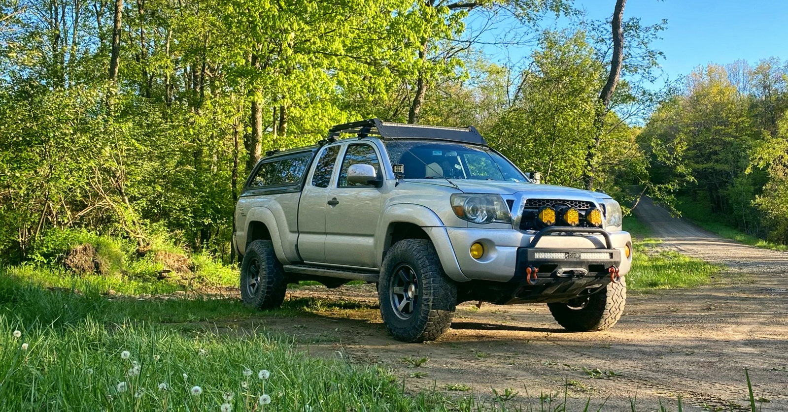

    Took a couple pictures today.

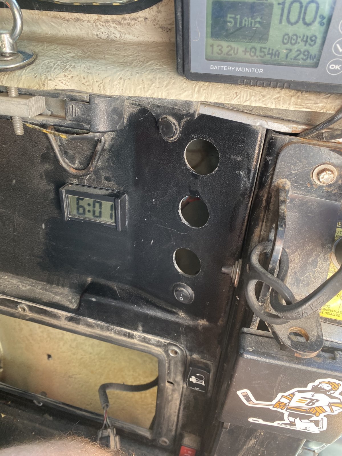

    Sorted out my on board water setup.
    I got tired of the water hose constantly being in the way. Not being able to shut the tailgate and hatch at night without putting the hose on the bed was annoying.

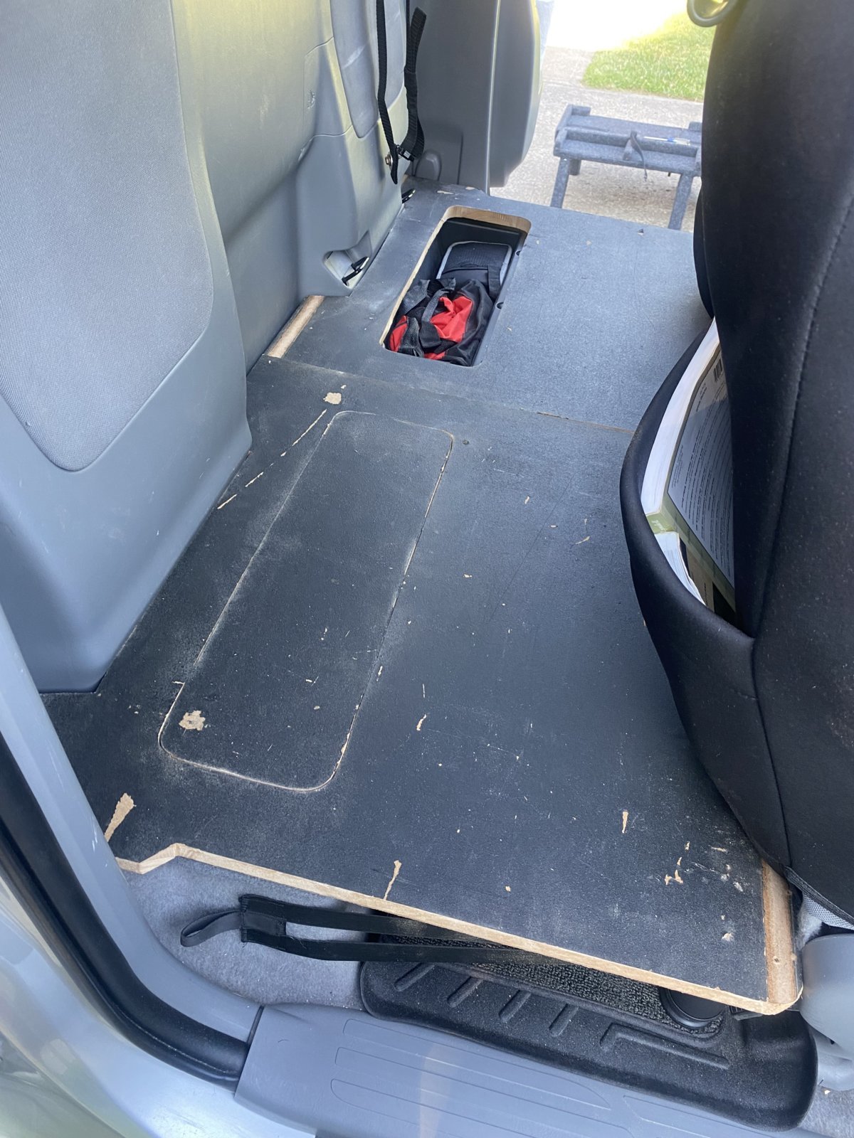

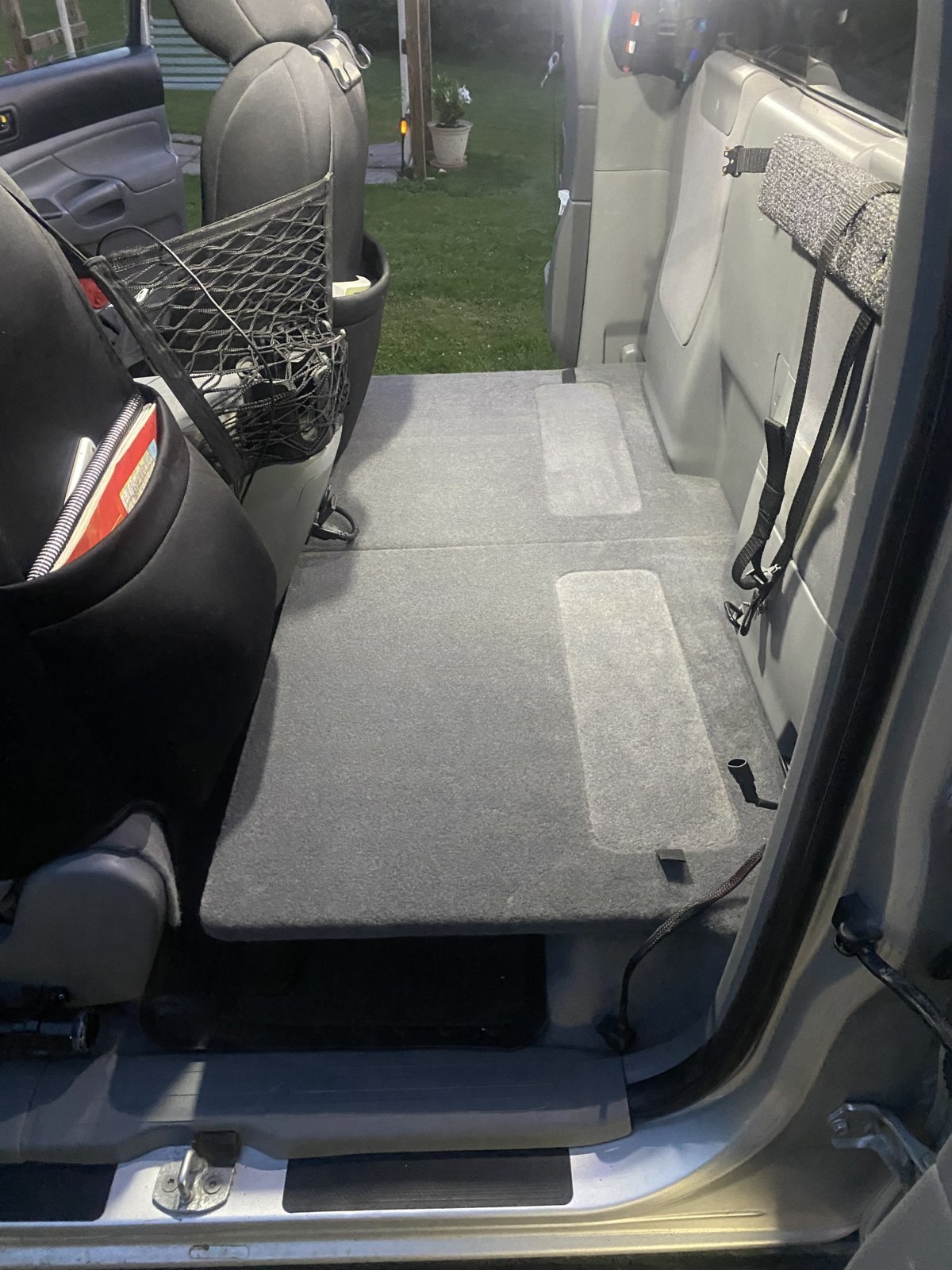

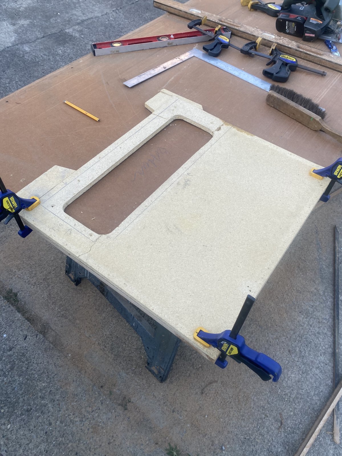

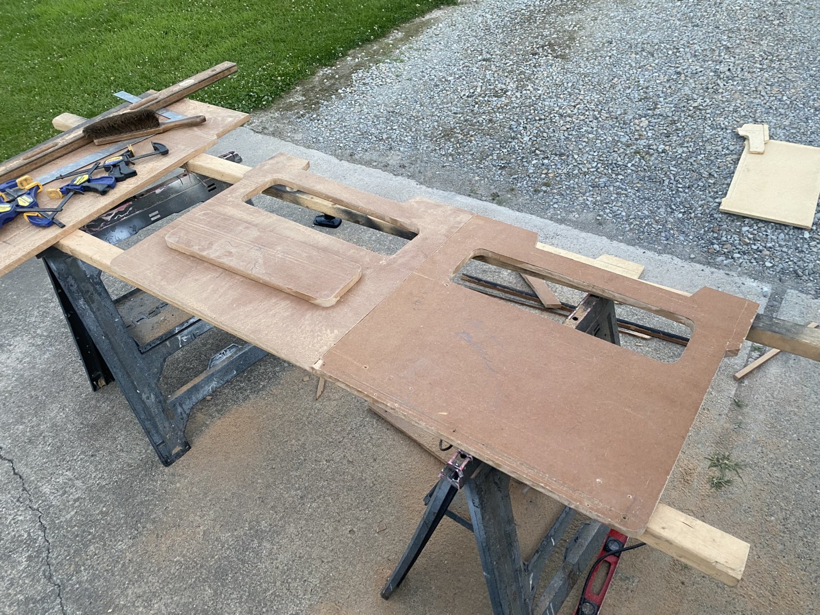

    Started redoing my rear seat delete.
    Ditching the busted cheapo 5/8” particle board and replacing it with 3/4” MDF.
    Got the new pieces all cut out and readyto go.
    My carpet should be here tomorrow and Ican finish em.
  4. Jun 24, 2024 at 9:55 PM
    #244
    steveo27
    steveo27 [OP] Ask me about my weiner
    Aug 12, 2013
    #110326
    6,077
    Steve
    Pittsburgh
    '11 TRD Off Road & 1992 VW GLI
    The same shit everyone else has.
    Done and covered.

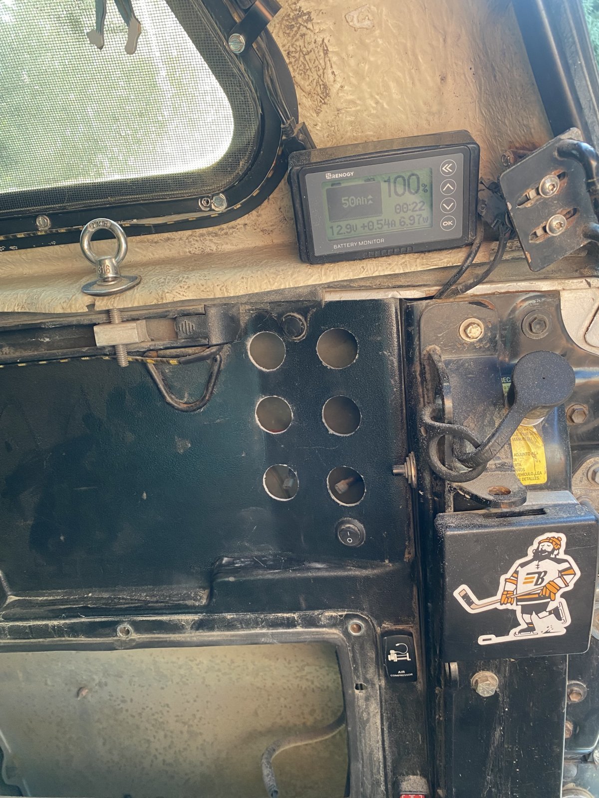

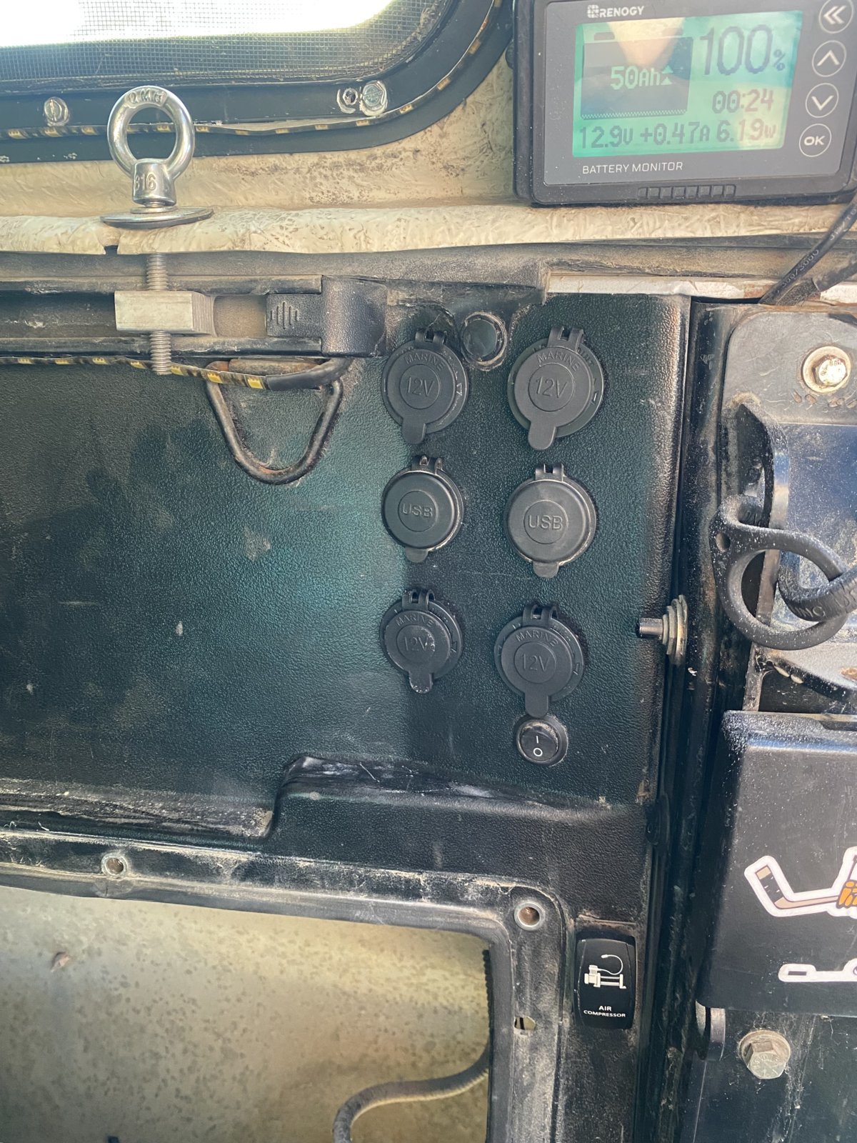

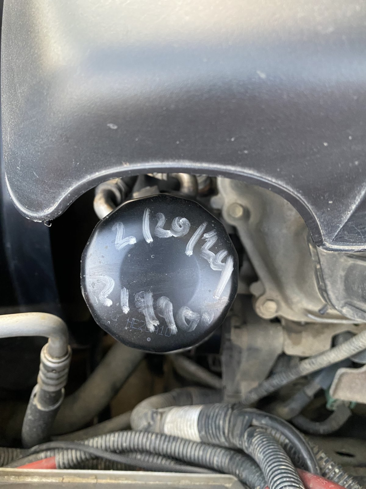

    Drilled more holes.
    Added a second row of USB / 12v sockets to the bed side.

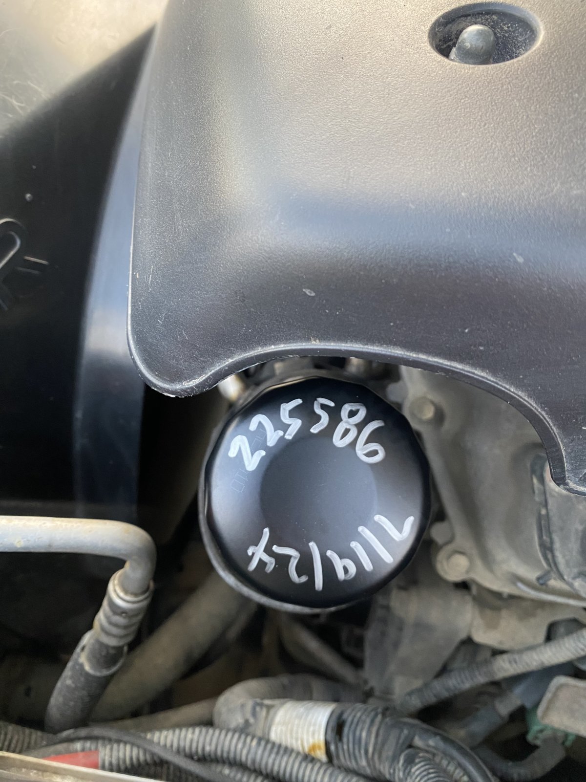

    And finally changed the oil.
    I usually only make it about 3 months between oil changes, made it almost 5 this time. Definitely slacking on adventures.

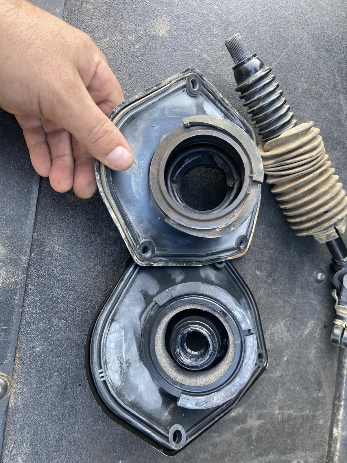

    And im still chasing down a vibration and slop in the steering wheel.
    Ive repalced the rack bushings, intermediate shaft, rag joint, TREs, and tie rods.
    Im about 95% sure the aftermarket intermediate shaft and rag joint are just junk parts. Or the rack itself is finally going bad.

    Replaced the junk aftermarket steering shafts with OEM parts
    Replaced the firewall bushing too
    Vibration and clunking 100% gone.
    It drives like a new truck.

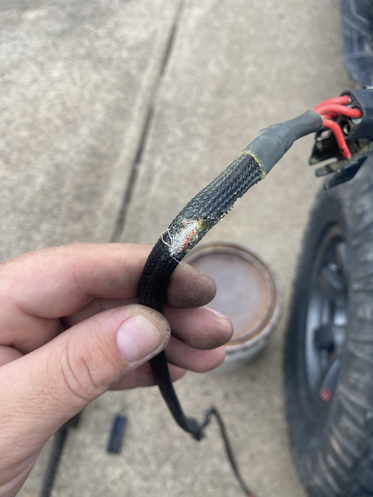

    I redid the wiring harness for the chase lights as one of the plugs was corroded.
    And I found the issue with the light bar harness and redid that. It melted against something hot at some point.

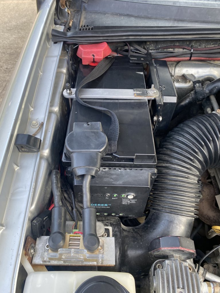

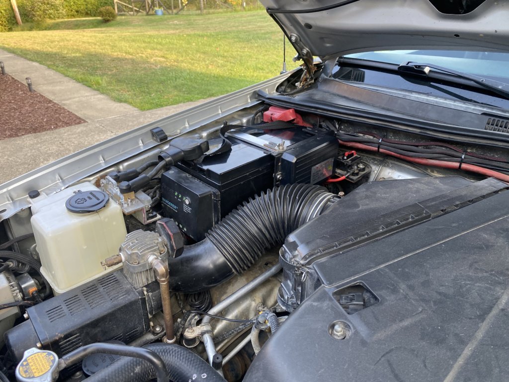

    Upgraded the 50ah FLA house battery to a 100ah Weize AGM battery.
    This was the cheapest, easiest upgrade to get more capacity out of the existing dual battery system.

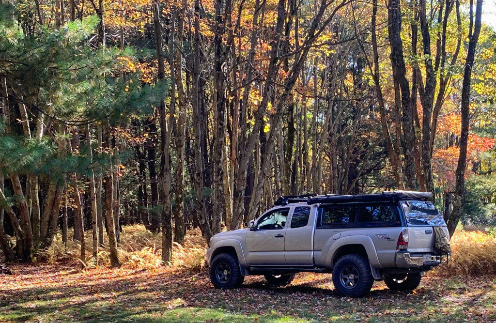

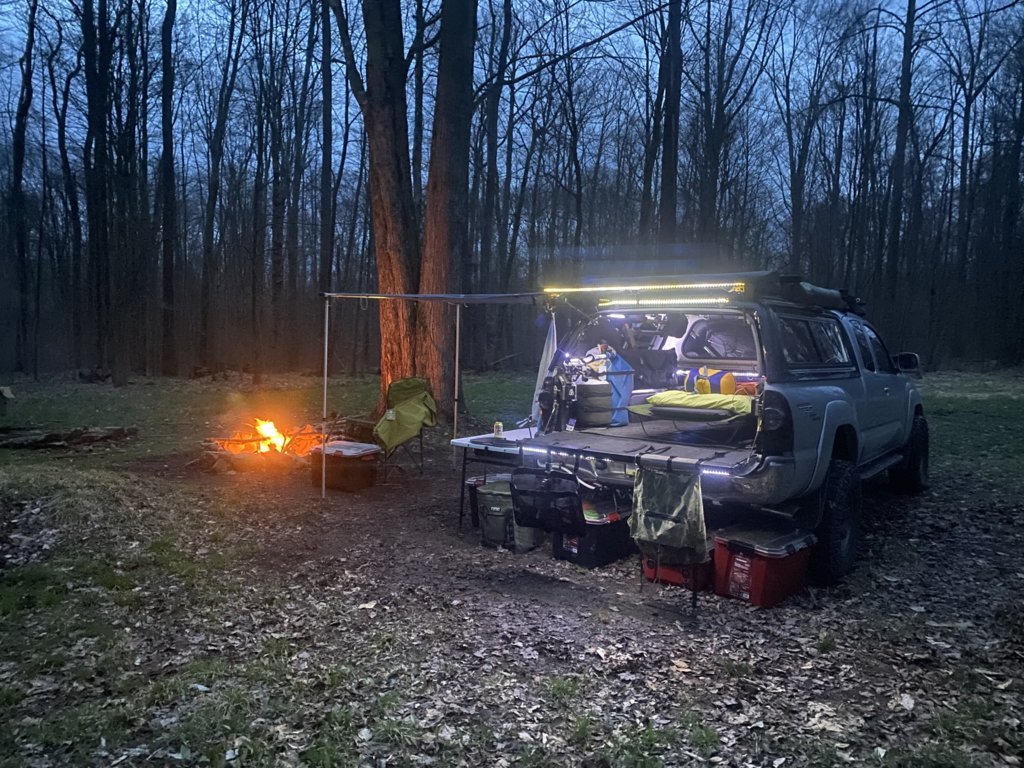

    Coupla pictures from last weekends trip

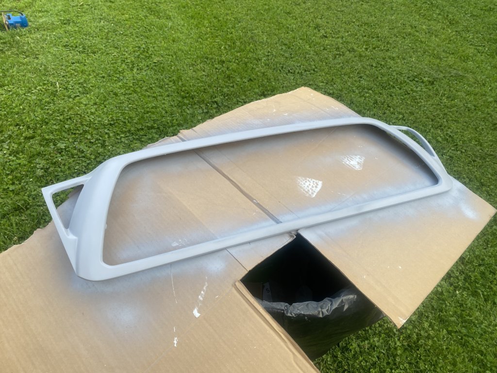

    Started on color matching the grille shell.

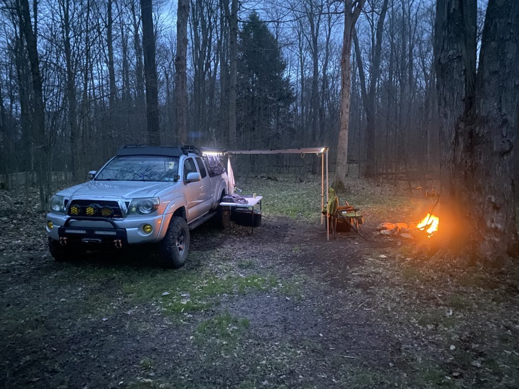

    Did some camping and exploring
    Hopefully I can finish the grille tomorrow.

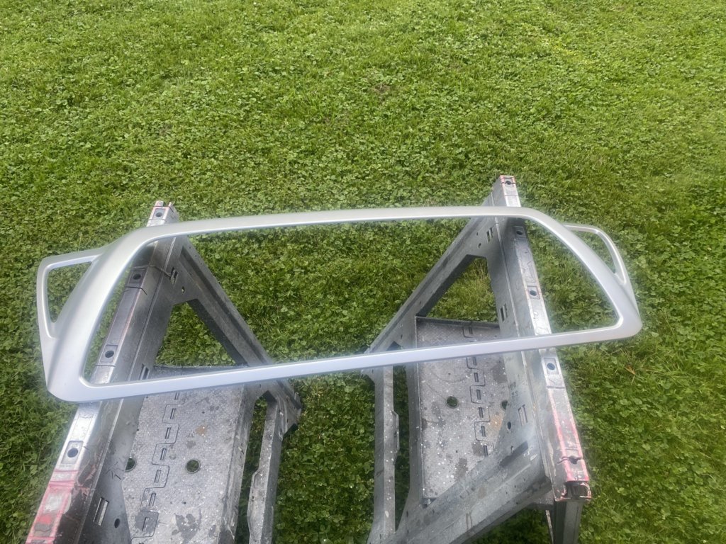

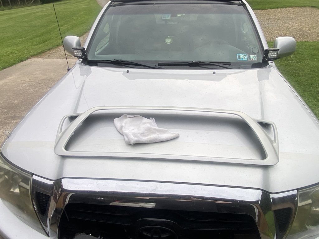

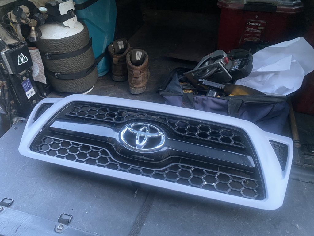

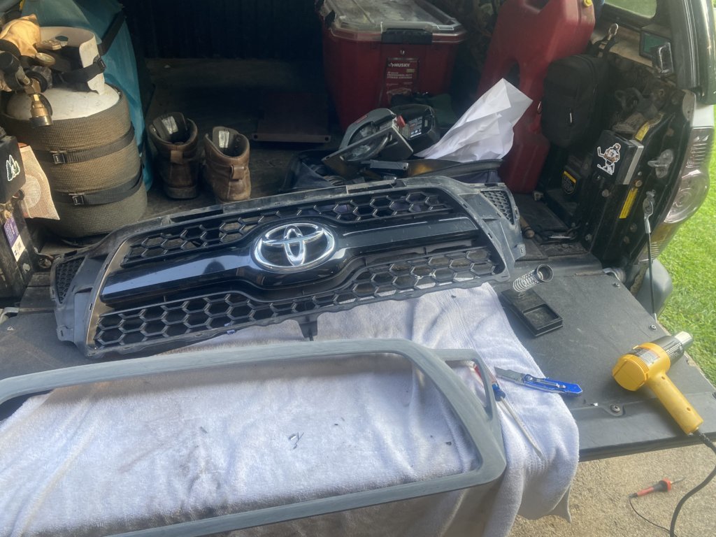

    Grille shell is painted.
    Needs cleared now.

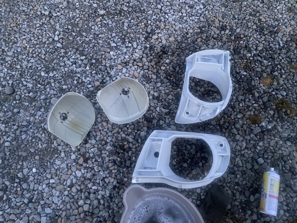

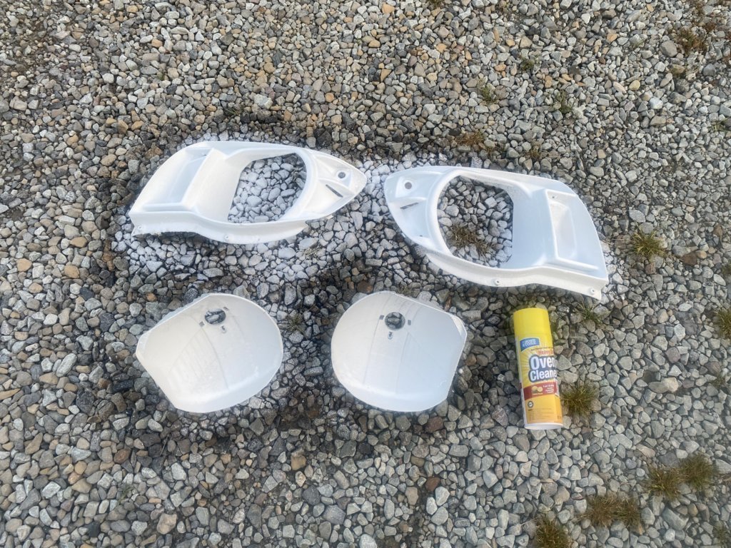

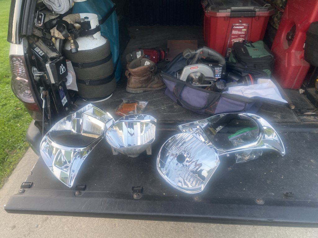

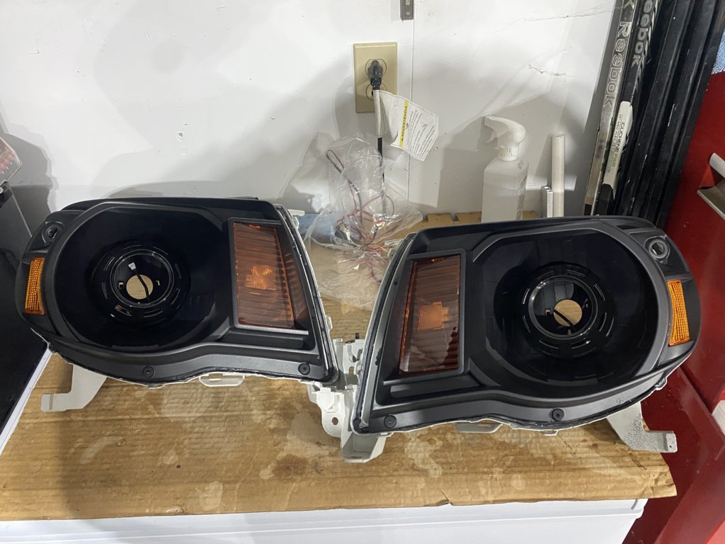

    Broke down a set of headlights to paint for the retrofit redo
    Stripped thd chrome off the bezels and bowls
    And I ordered all the stuff to finish the lights

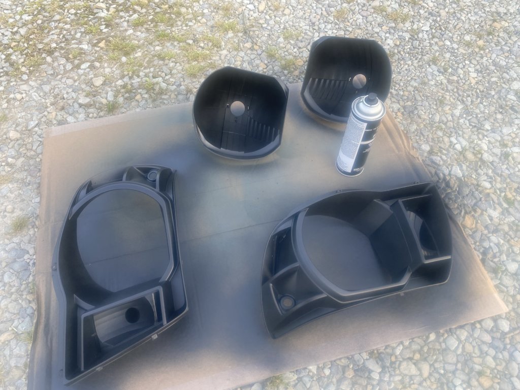

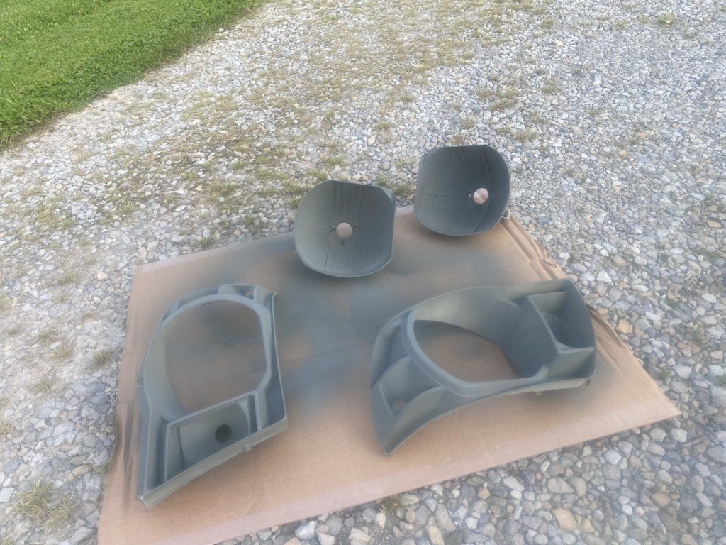

    Bezels and bowls done in trim black.

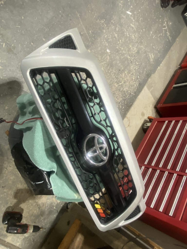

    Grille is done :
    The emblem needs painted black to match now.

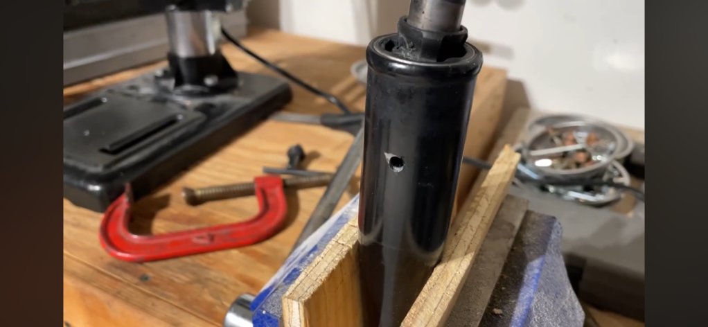

    Drilled and filled the shifter.
    Most of the slop is gone now.

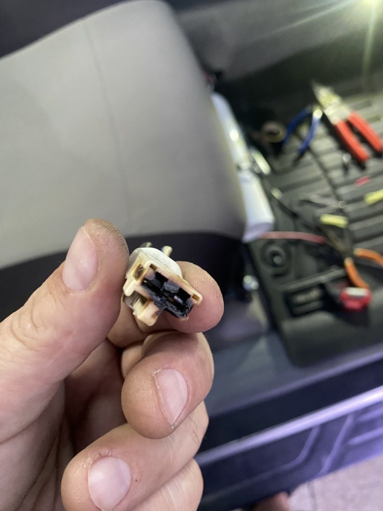

    Replaced the blower motor plug.

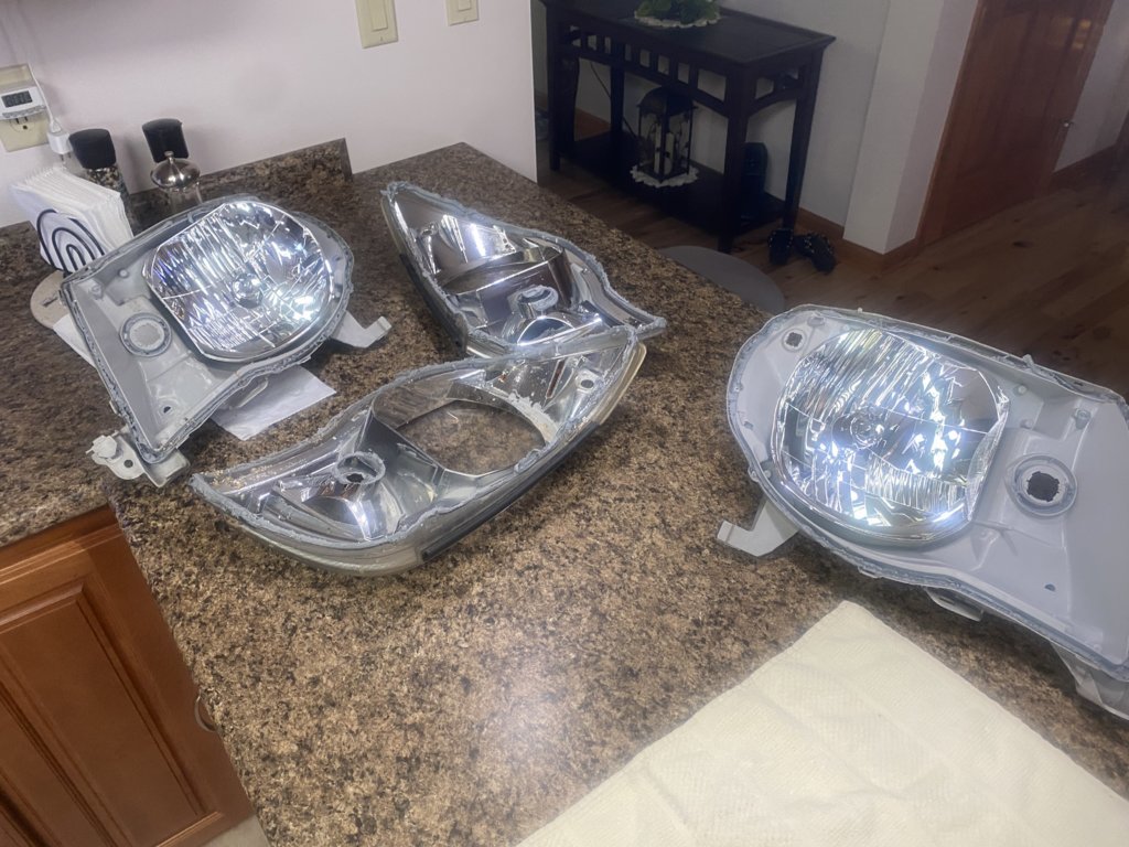

    Finalized the retrofit redo.
    Just gotta bake the old ones apart and rob the projectors from them.
