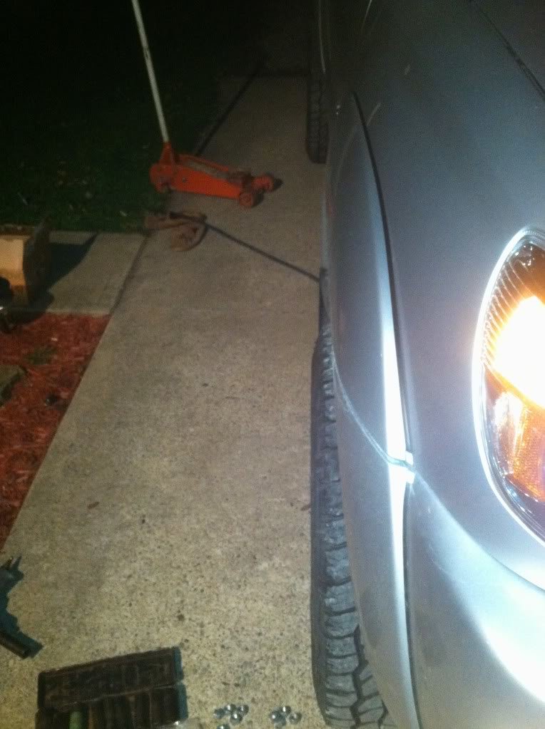

    I love coming home from work to packages from UPS.
    My TRD skidplate and Wheelers add-a-leafs showed up today.
    Got the add-a-leafs installed tonight.
    Before -
    During -
    No pictures cause everyone knows what an add-a-leaf install looks like
    After -
    It was dark when I finished so I didn't snap anymore pics or anything. |
    I'll take some better ones in the daylight.
    I also got the TRD skidplate installed -
    Super awesome night time iPhone picture.
    Its nothing special. I just like the way it looks. I may end up painting it black, not sure yet.

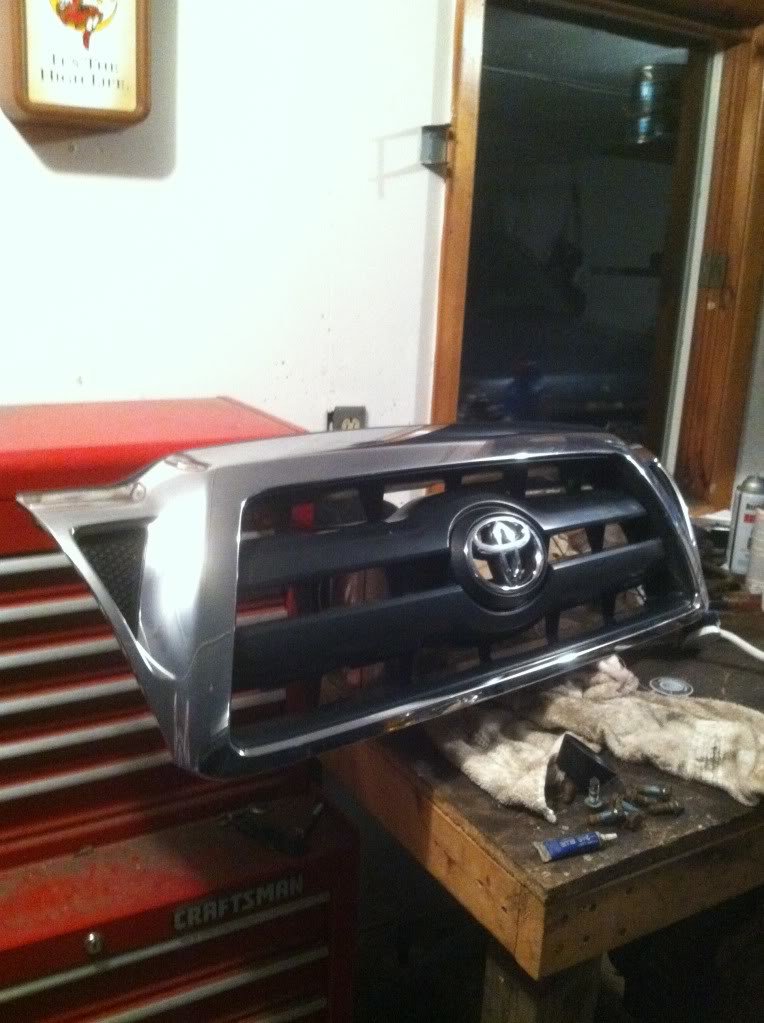

    Picked up a spare grille off of Craigslist on Thursday -
    I never realized how UGLY the 2005-2010 grilles were. Im glad Im cutting this up, and not my 2011 grille.

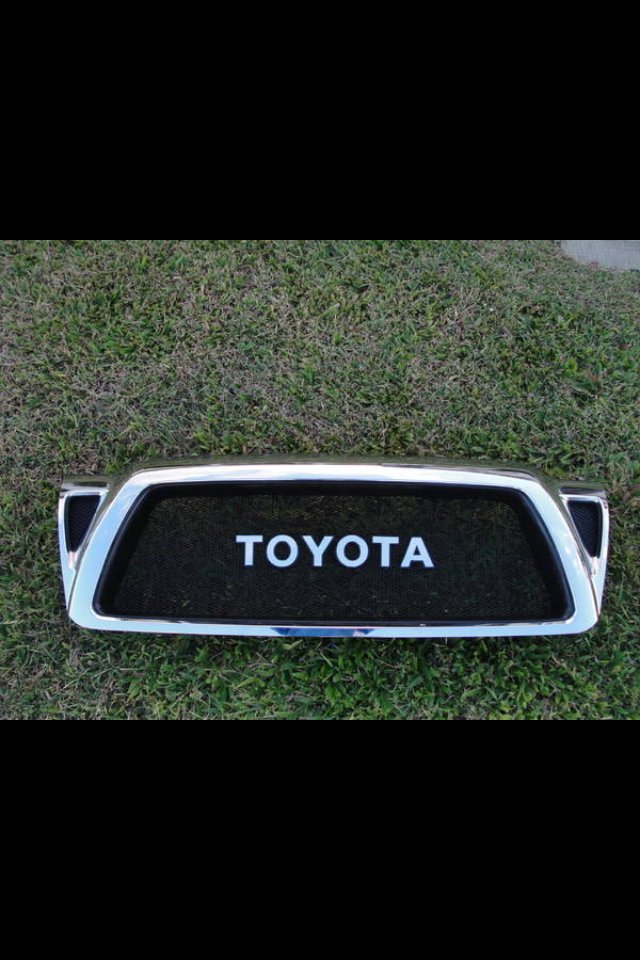

    I plan on building one of these -
    but with out the Toyota badge.

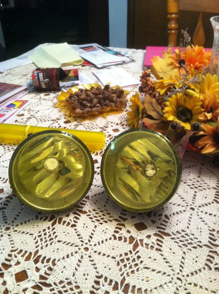

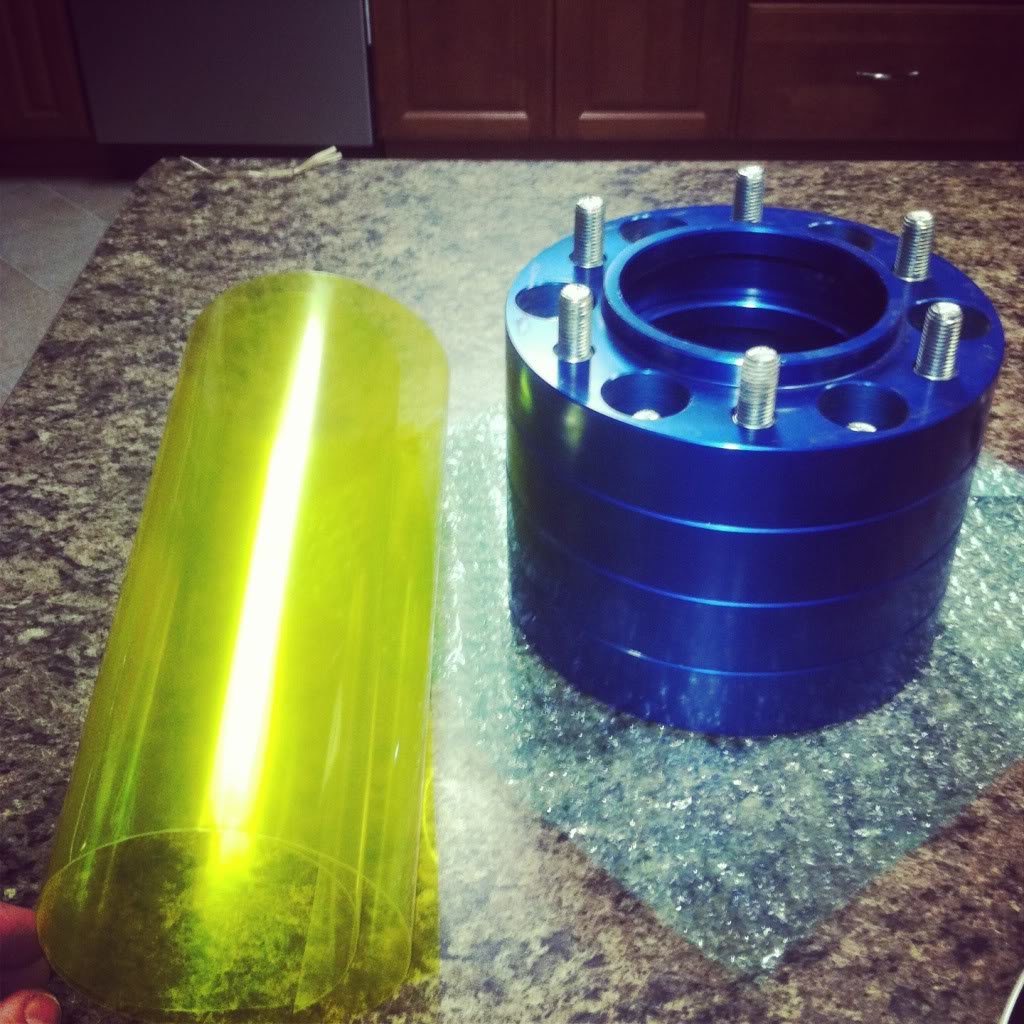

    Friday, these showed up -
    A used set of Spidertrax from a member on here and generic yellow Lamin-x off of Ebay.
    I got the Spidertrax installed after work Friday and love em. The way the bought the wheels out really makes a difference with how the truck looks. It looks alot more like a truck now. Not to mention, it rides better with the wider track.
    Hopefully this week, I can do the fog lights and start on the grille.

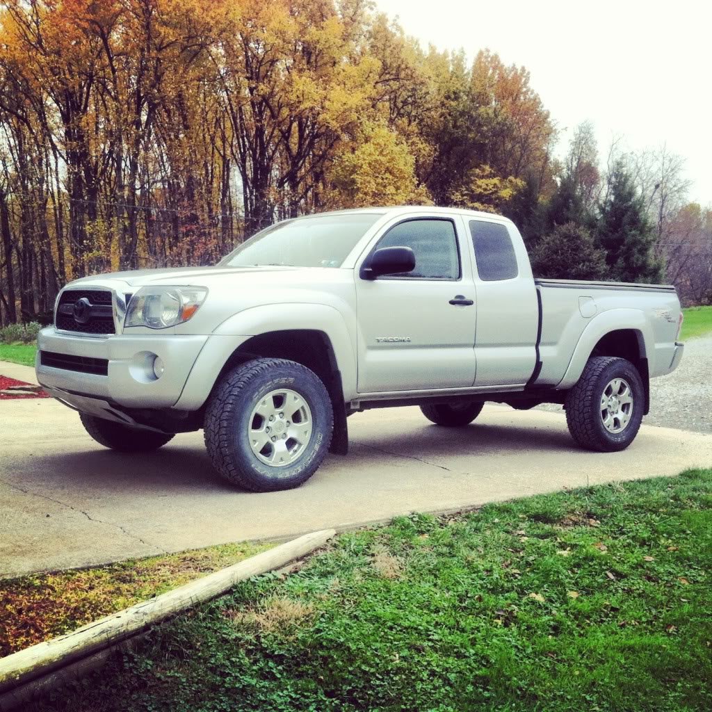

    Here's a super sweet Instagram photo I took before work.
    The more I look at it, the more I think I need to bring the front up the rest of the way. The 5100s are set at 1.75 up front now, and I would like to bring them up to 2.5 but I'm worried about the alignment being too far outa of spec.

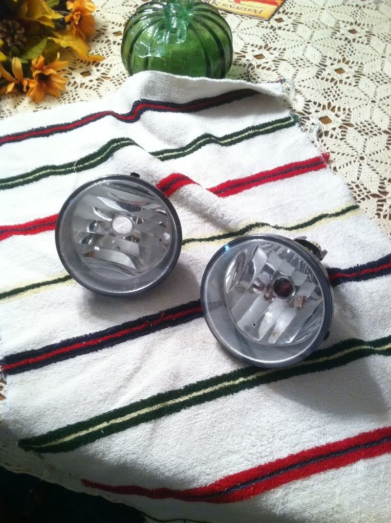

    More updates -

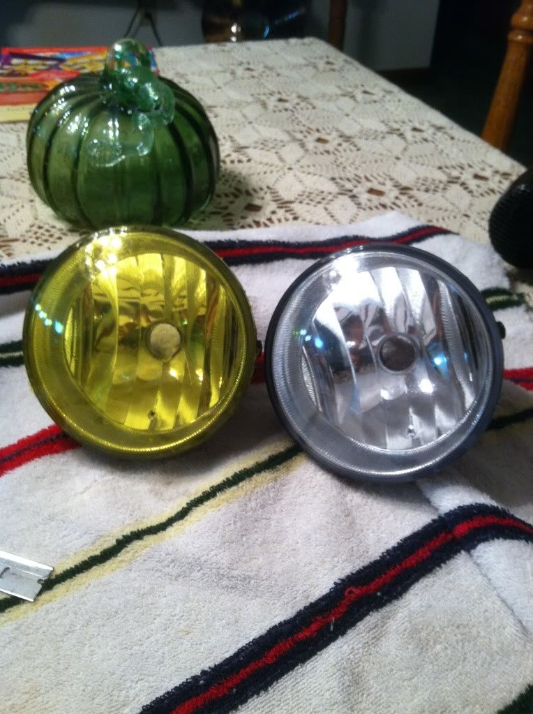

    Installed the Lamin-x on the fogs -
    They turned out good, but not perfect. I think it'll do though.

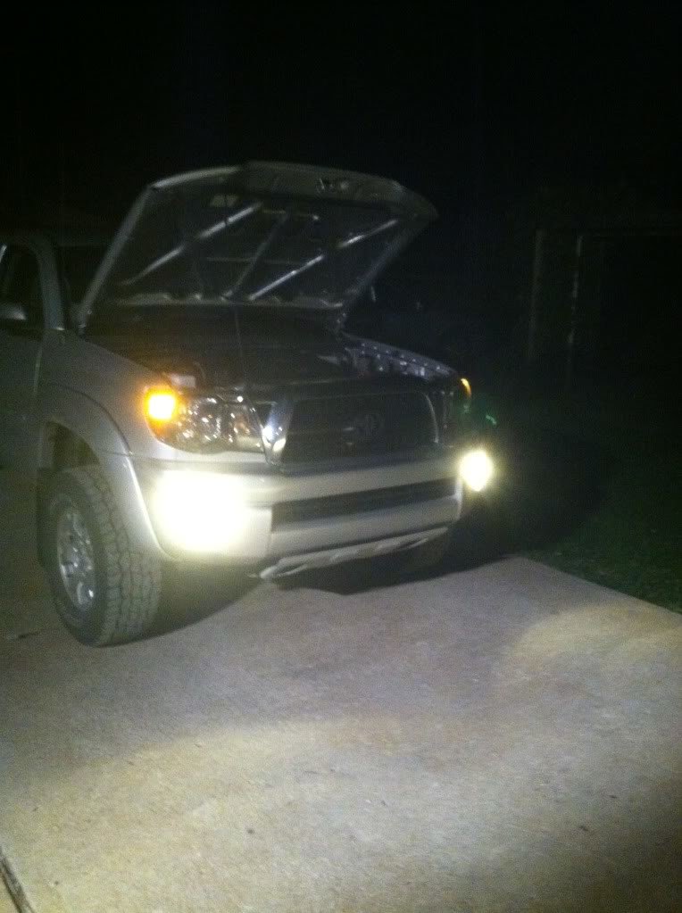

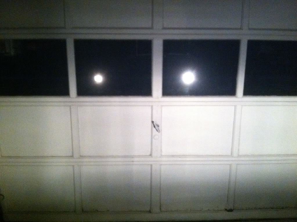

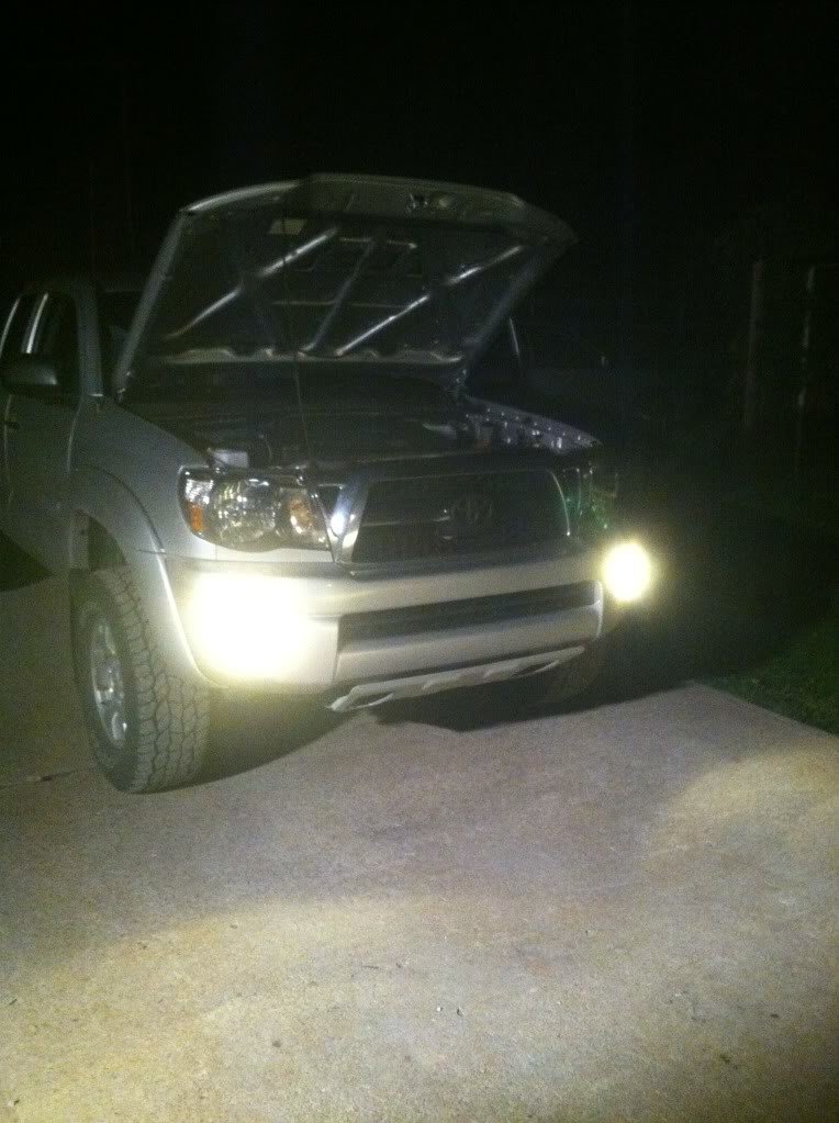

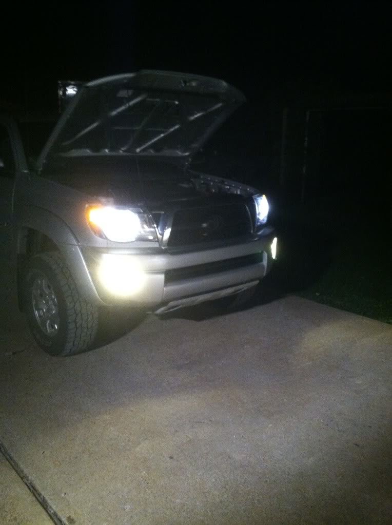

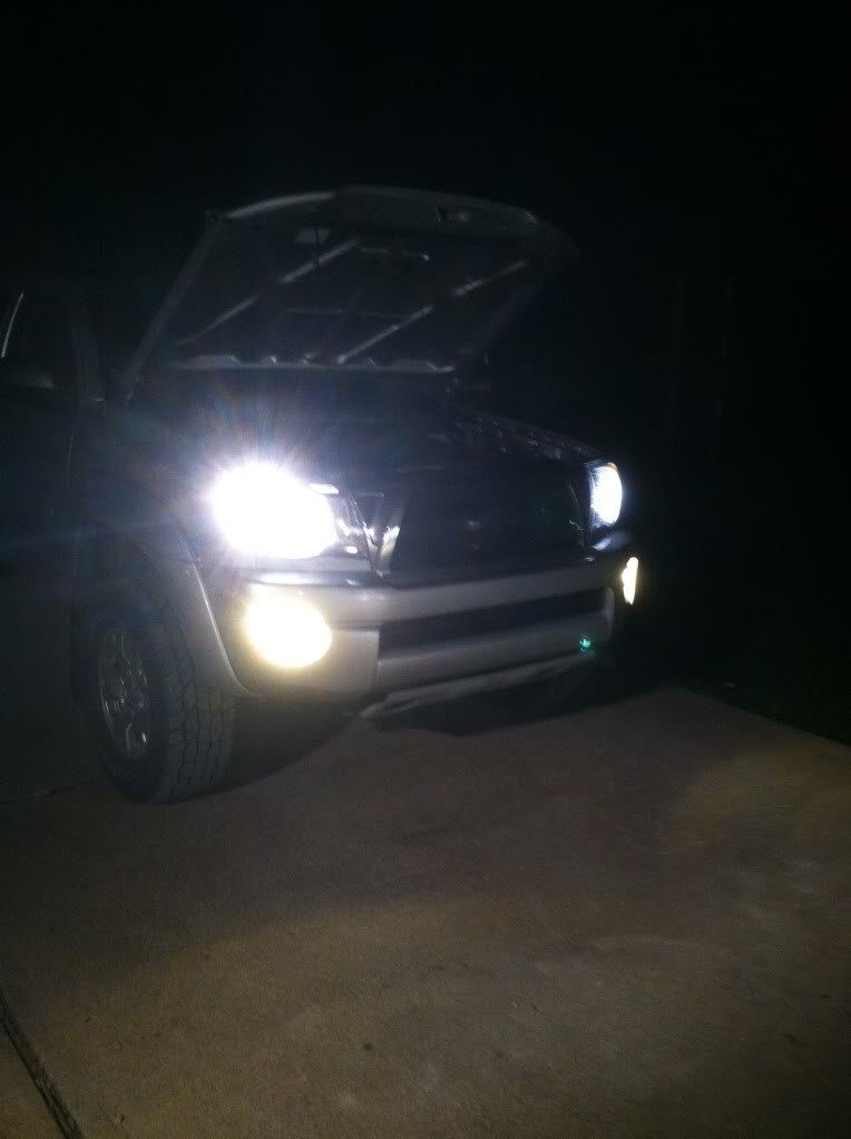

    I also did the "Anytime foglight mod". I hate the idea of using a splice connect and I plan on changing it as soon as i figure something out. Id be much happier if it were soldered and heat shrunk properly.
    Fogs only -
    Fogs and parking lights -
    Fogs, parking lights, and low beams -
    Fogs, parking lights, and high beams -
    And heres better shots of everything -

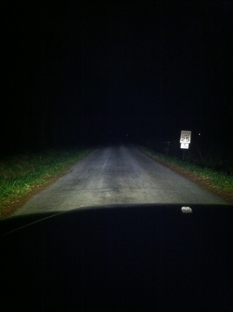

    Fogs only -
    Low beams w/out fogs -
    Low beams w/ fogs -
    High beams w/out fogs -
    And high beams w/ fogs -

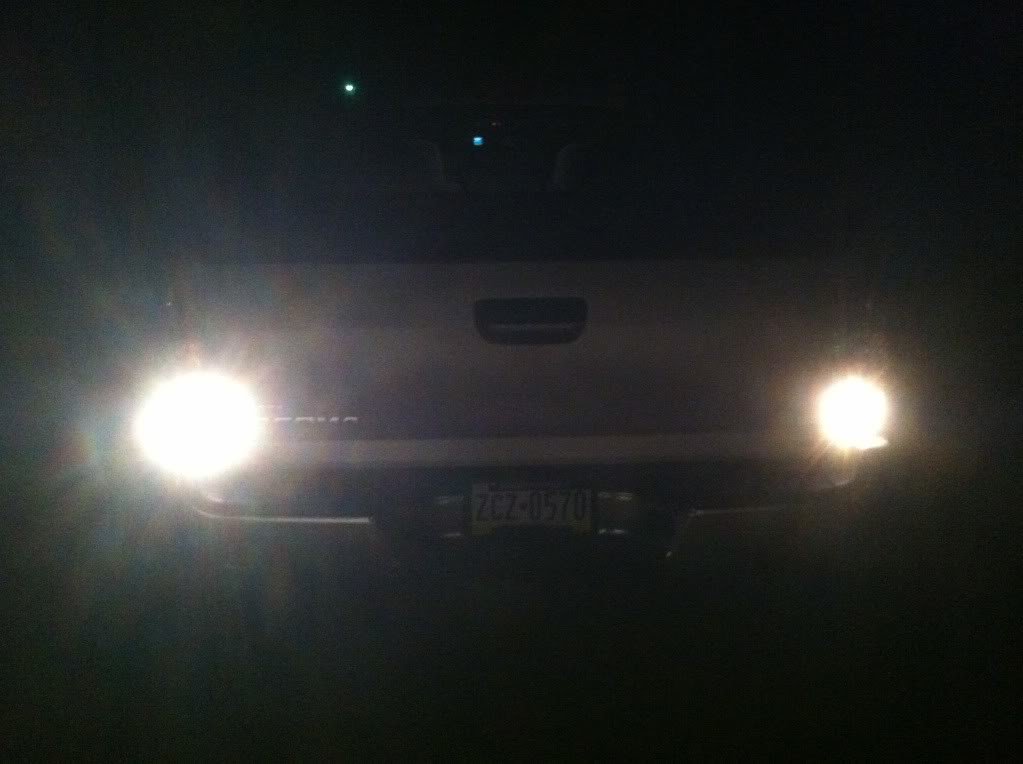

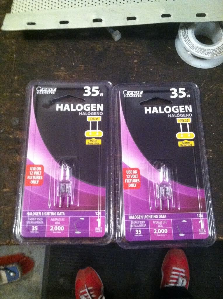

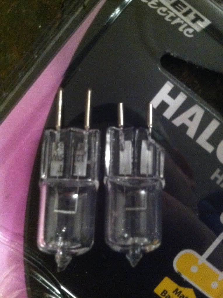

    More stuffs :

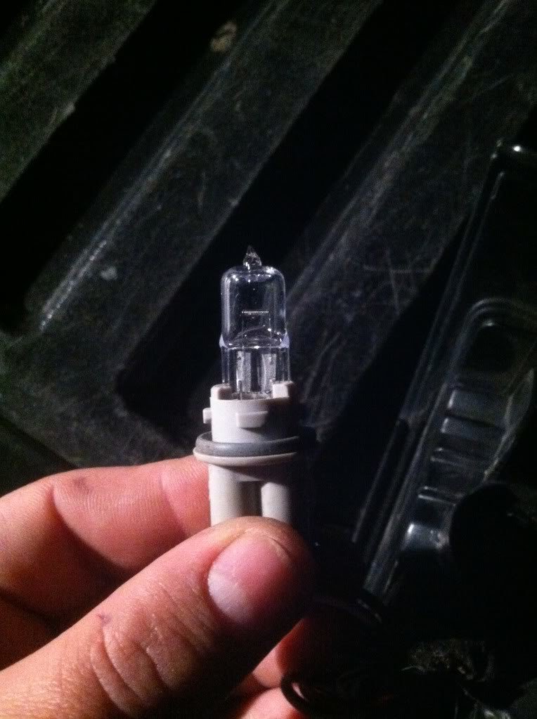

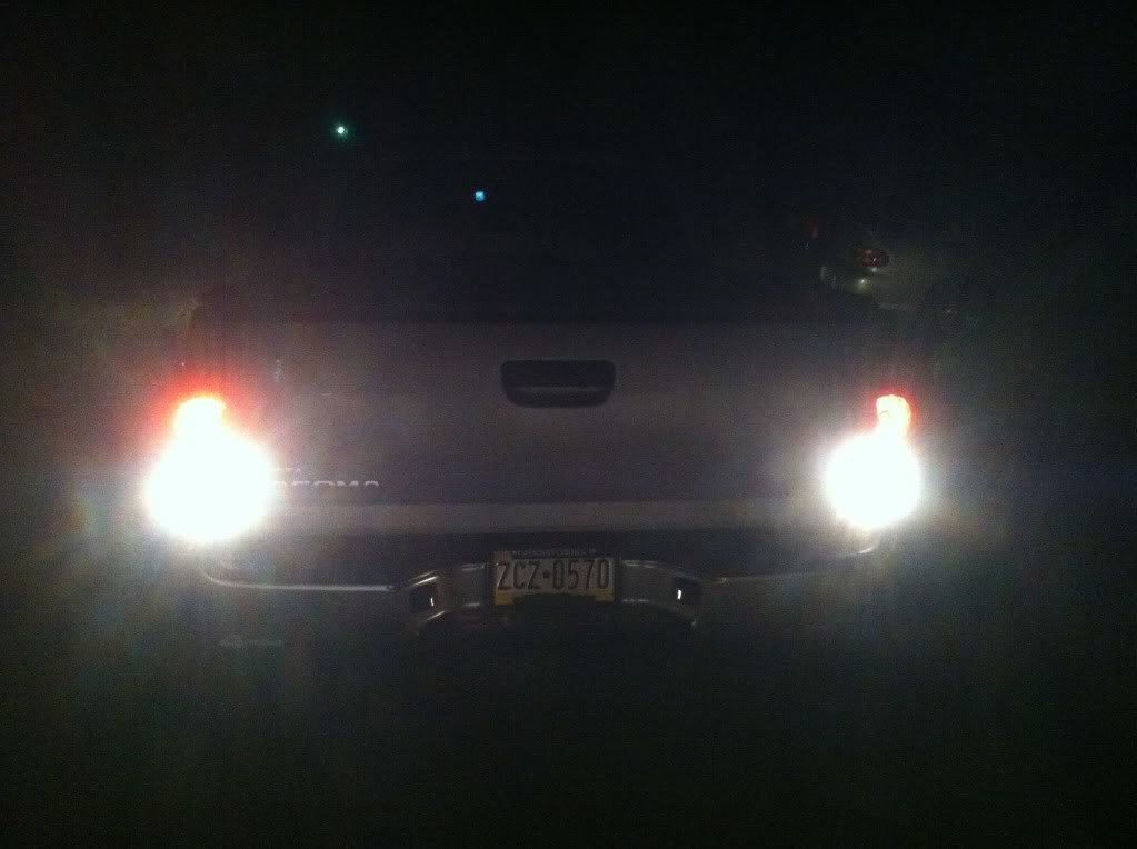

    Tonight, I added brighter back up lights -
    I was gonna use the 886 bulbs and modify them, but after more research, I decided to go a different route.
    These are a slightly lower wattage, and about 3$ cheaper than the 886 bulbs. They came from Lowes.
    I spent a good 2 hours today at work fucking off and researching reverse light bulbs. I work next to a Lowes so I figured I'd look em up on their website to make sure they carried what I needed. Long story short, when you search "12v halogen", "12v gy 6.35", ect, NOTHING comes up.
    I ended up just running there anyways to have a look. Sure enough I found a set thatll work. Heres the barcode number for any one interested in picking up a set at Lowes -

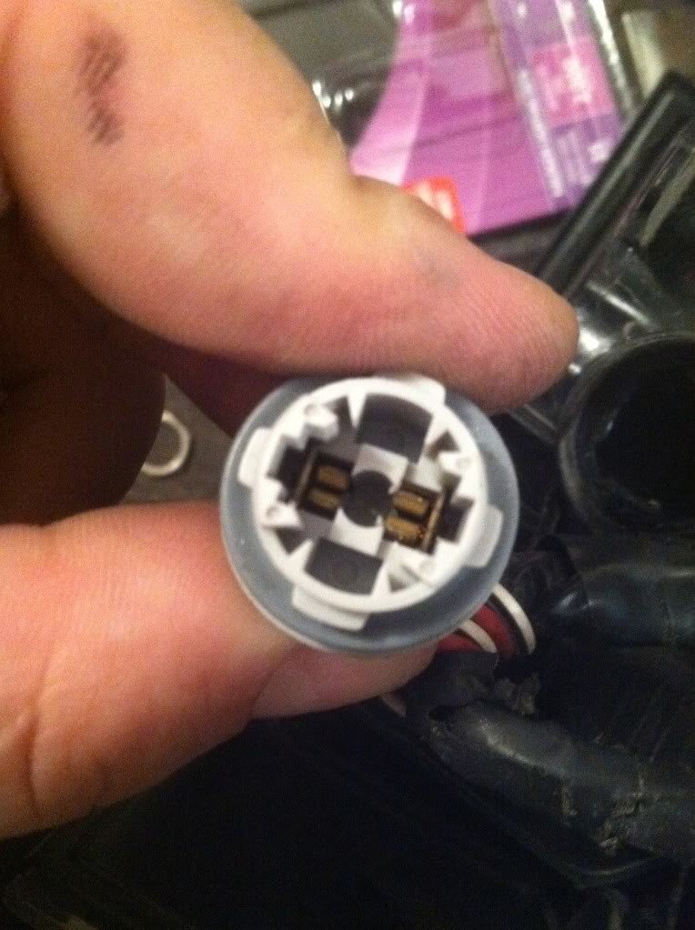

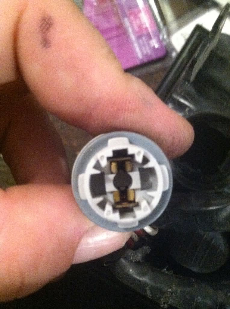

    Its pretty simple to do...
    Remove the OEM bulb and the holder should look like this -
    Bend the copper contacts together like this -
    I used the tip of the blade in my pocket knife.
    I put the new bulbs in, but they seemed like they stuck out of the bulb holders way too much, so I trimmed the leads down. Here's a comparison -
    I used a cut off wheel. You can see where the bulb chipped, so be careful doing this. I bought 2 bulbs, and damaged one of them trimming it, I'll have to go to Lowe's after work tomorrow to grab another and try again.
    Anyways, I installed the one bulb that I didnt break on the driver side. Its amazing how much of a difference it really does make -

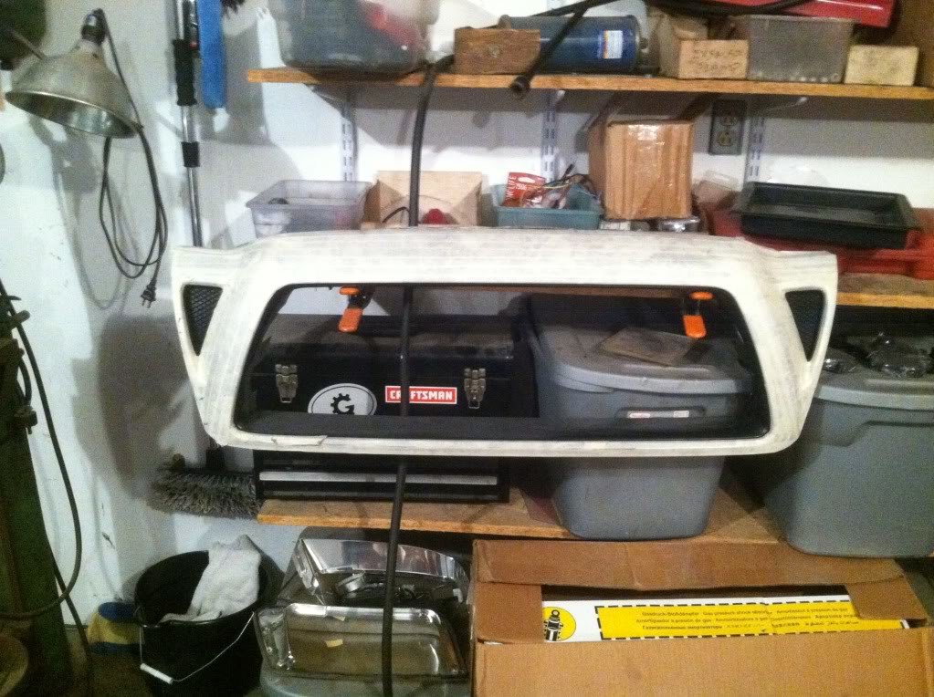

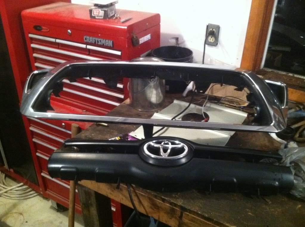

    I also started on the Satoshi style grille -
    I got the center cut out and stared at it for a while. I need to decide if I wanna make it a shallow or a normal style Satoshi.

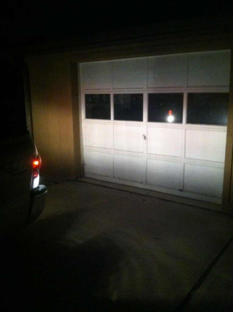

    More small stuff -
    I finished the reverse light install tonight -
    I decided against trimming the bulb on this time
    I wish it sat deeper in the socket, but well see how this works out.
    The light output of the new bulbs is awesome -

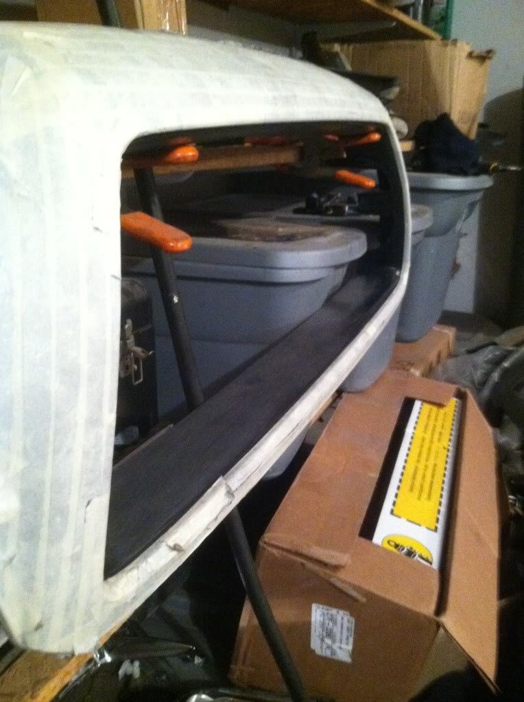

    More progress -

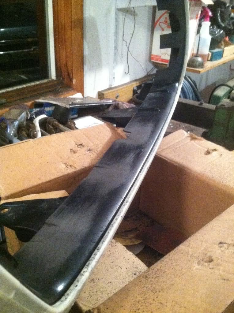

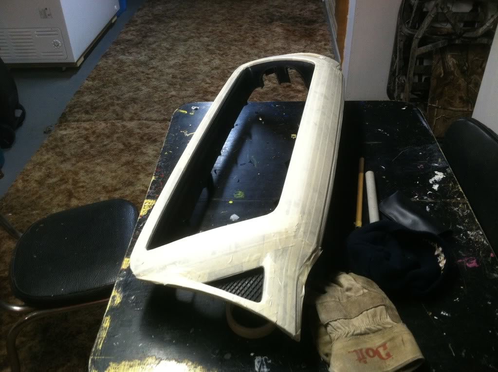

    Got some more done on the Satoshi grille tonight.
    Got it all taped up -
    And started knocking down the remaining plastic -
    Im doing it by hand using 40 grit sand paper. It takes a little bit longer, but its coming out nicer than it would doing it with a DA.
    I've got 1 side, the whole bottom, and 3 posts on the top sanded so far.
    There is about another hour or so of sanding left to do on it. Then I can cut filler pieces out and plastic weld them in place to fill the side gaps.

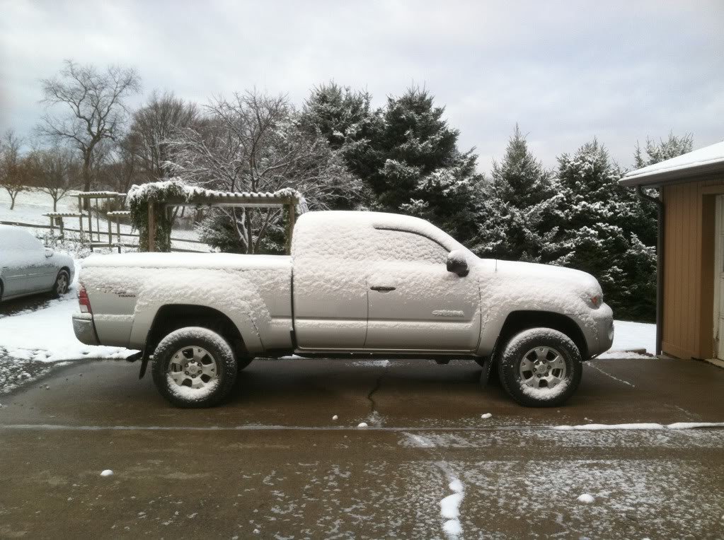

    Oh, it snowed today -
