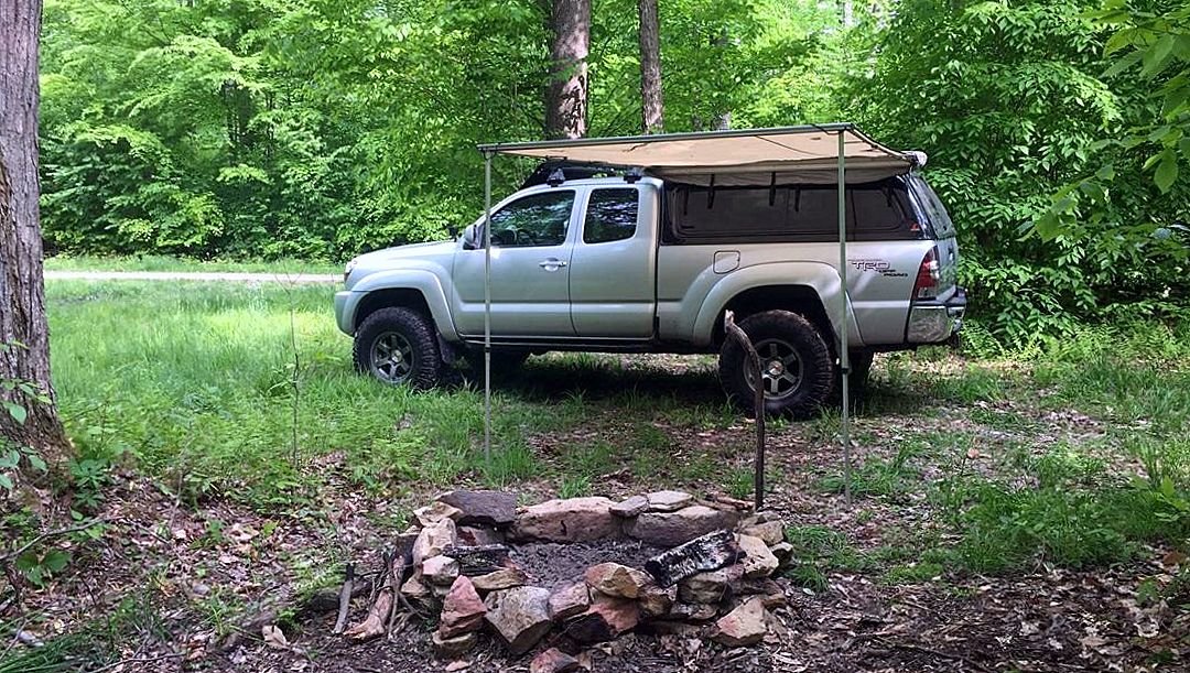

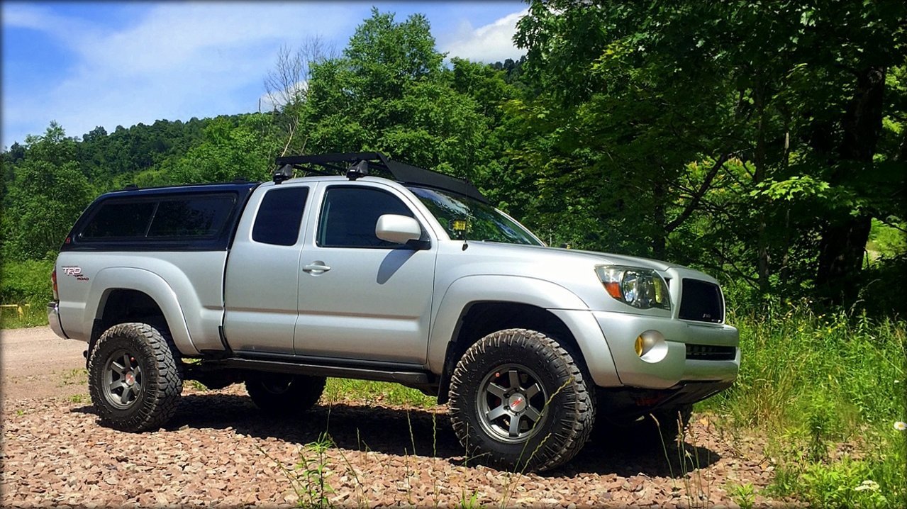

    Coupla pics from the past weekend’s trip. Explored a bunch a new national forest roads and found another great spot for a campsite.

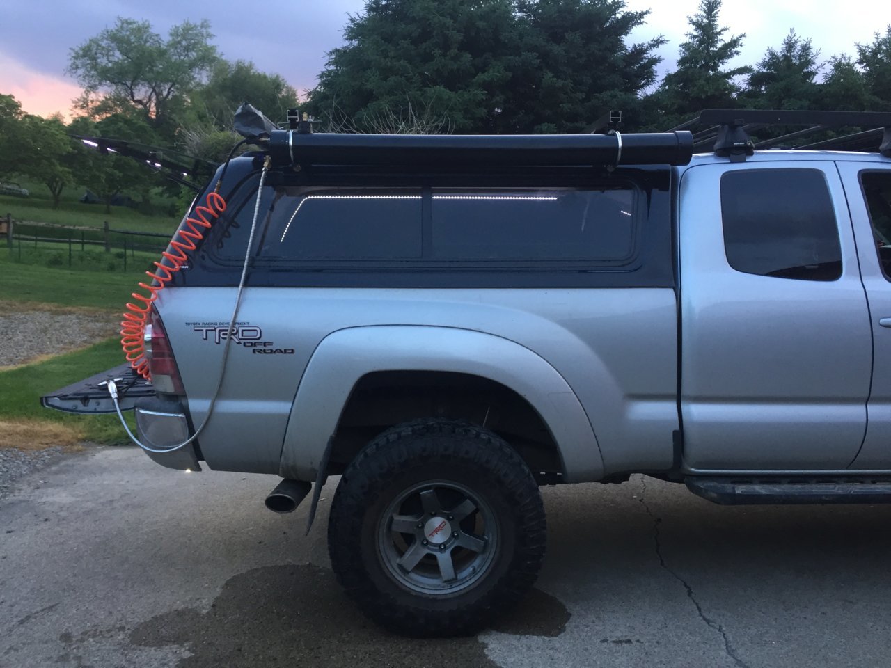

    I ordered another awning for the truck today. A small 4’x6’ to go across the back of the shell to cover the tailgate. Slowly piecing the items to make this truck the ultimate weekend rig.

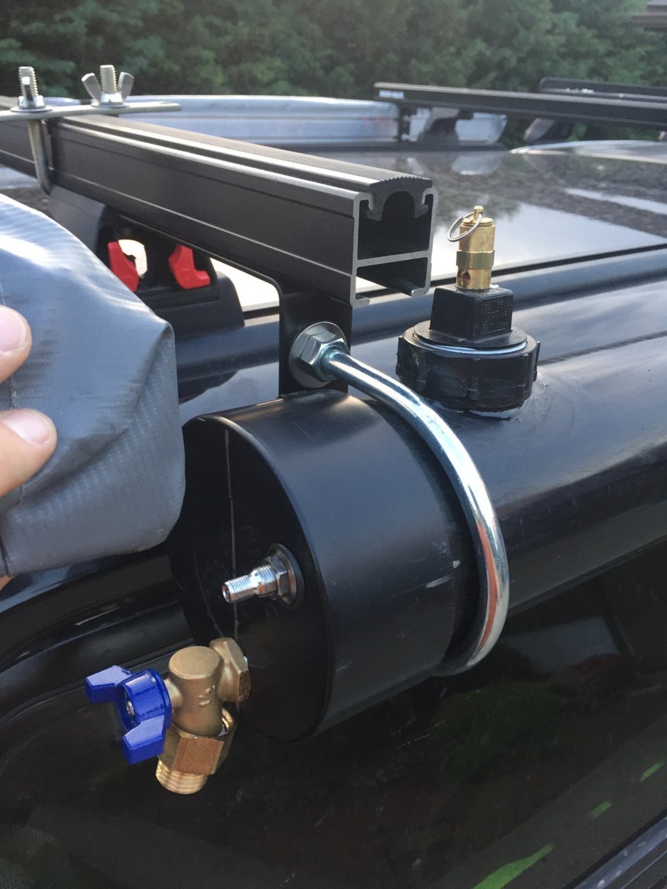

    Diy solar road shower sorted out and installed.
    I’ll post some info when I get a chance

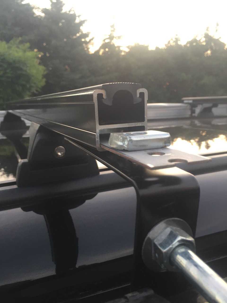

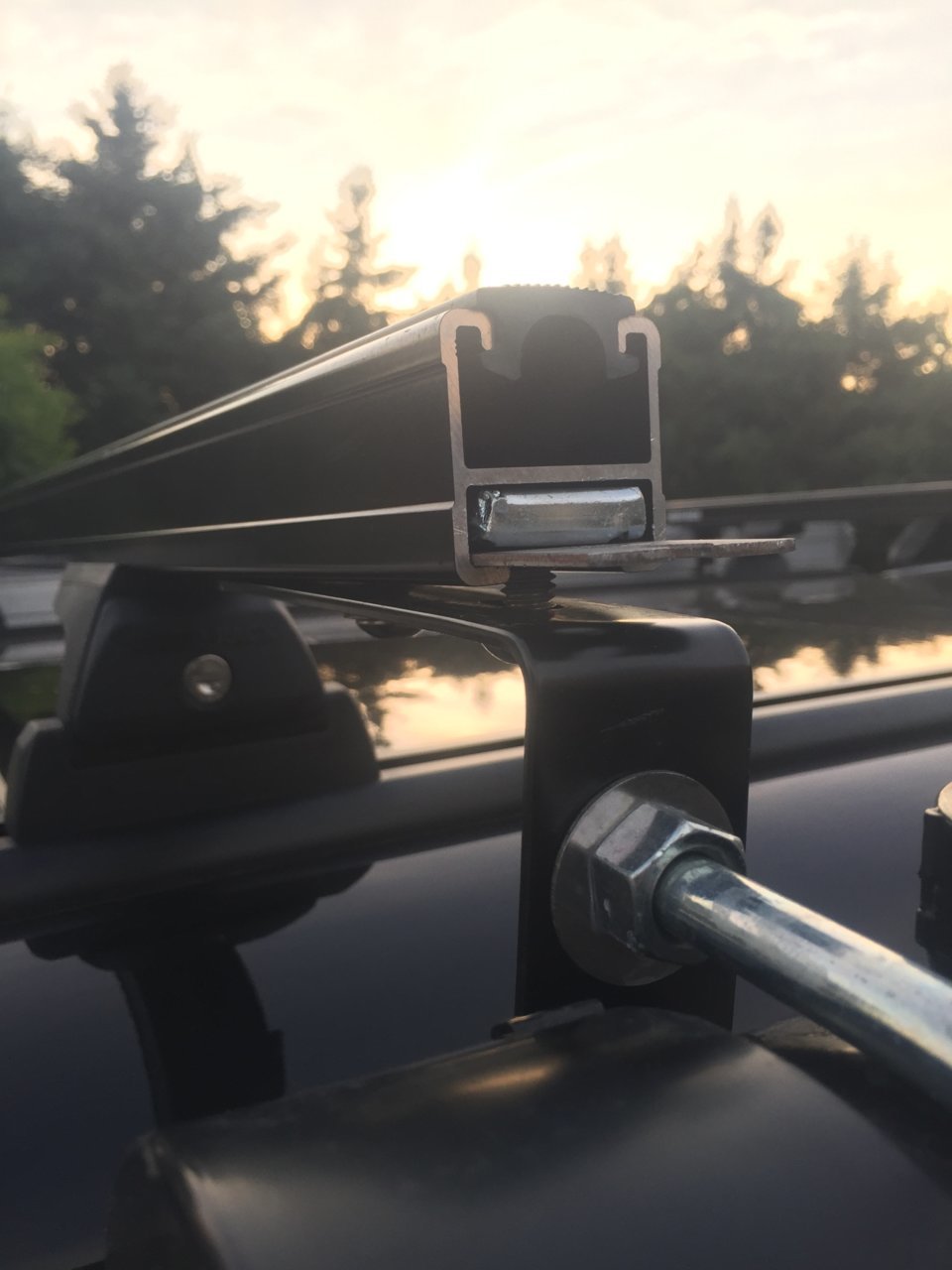

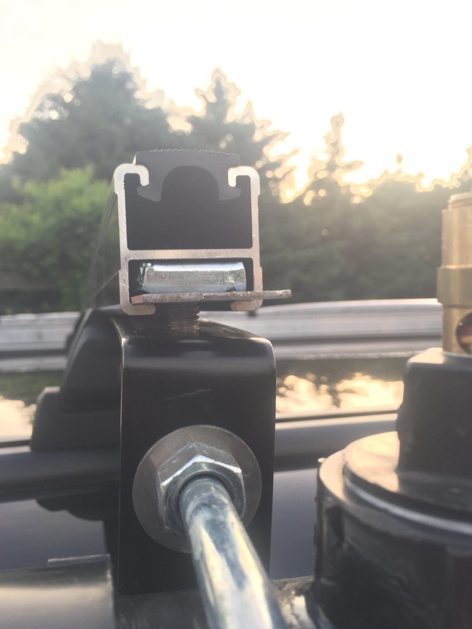

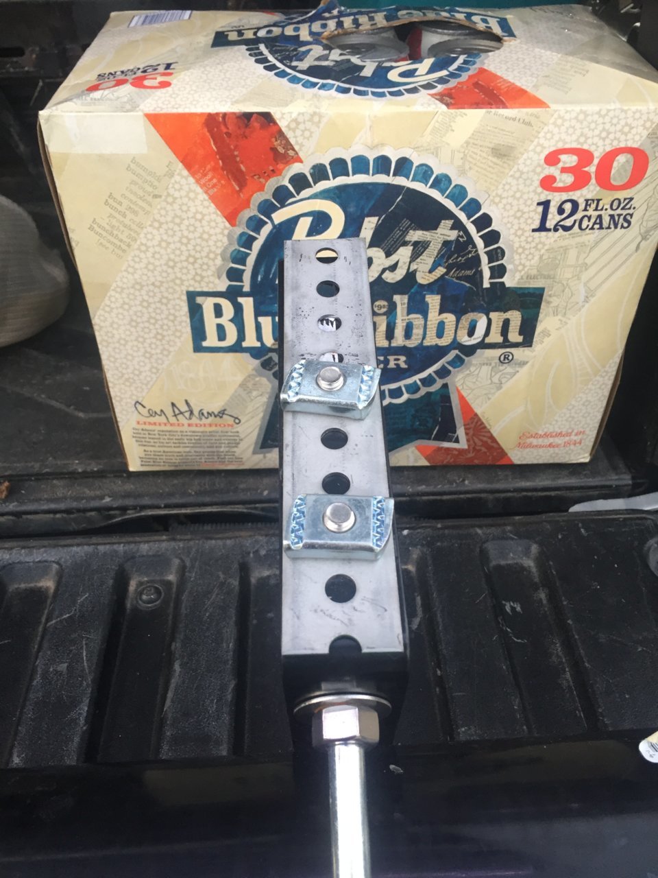

    Can you send some pictures of how you have your awning mounted?
    That’s next on my list!
    Truck is looking super good
  11. Jun 18, 2019 at 8:32 AM
    #131
    steveo27
    steveo27 [OP] Ask me about my weiner
    Aug 12, 2013
    #110326
    6,077
    Steve
    Pittsburgh
    '11 TRD Off Road & 1992 VW GLI
    The same shit everyone else has.
    Thanks.
    I can.

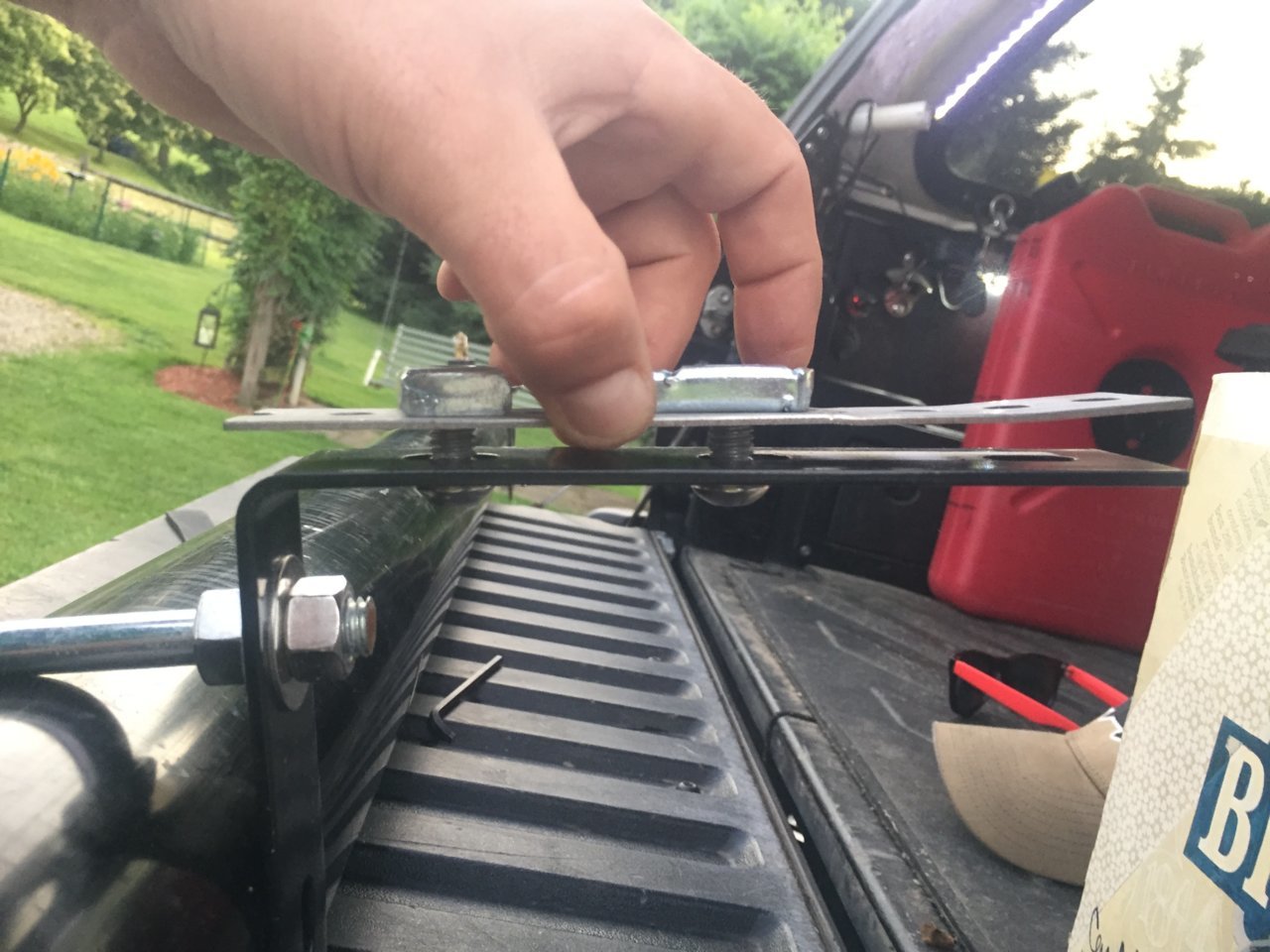

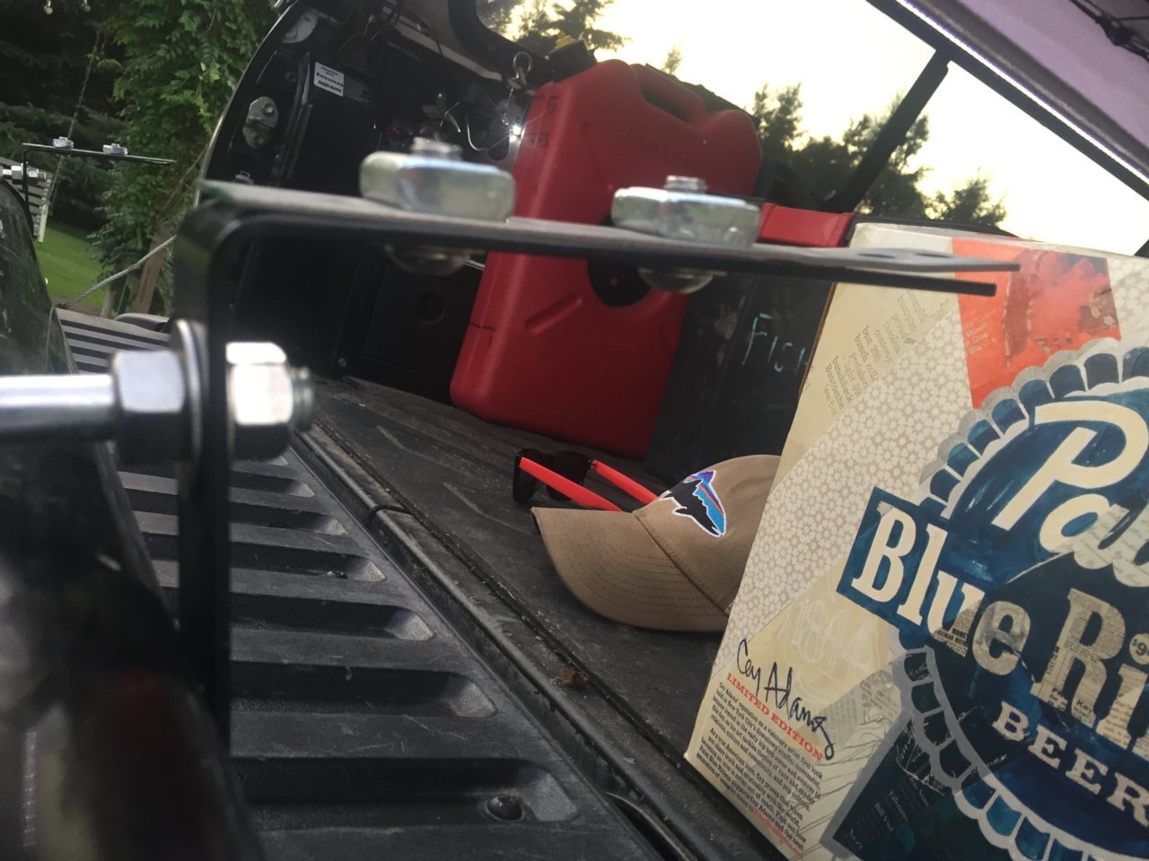

    It’s super simple. The underside of my crossbars have a channel just like the inside rails in our beds. I used some L brackets and Unistrut nuts just like how you’d mount something to the bed rails.
    I don’t have any good photos on my phone, I’ll get more when I get a chance.
    This kinda gives you an idea.

    @mk1jacob
    Pics as promised. Hope this helps

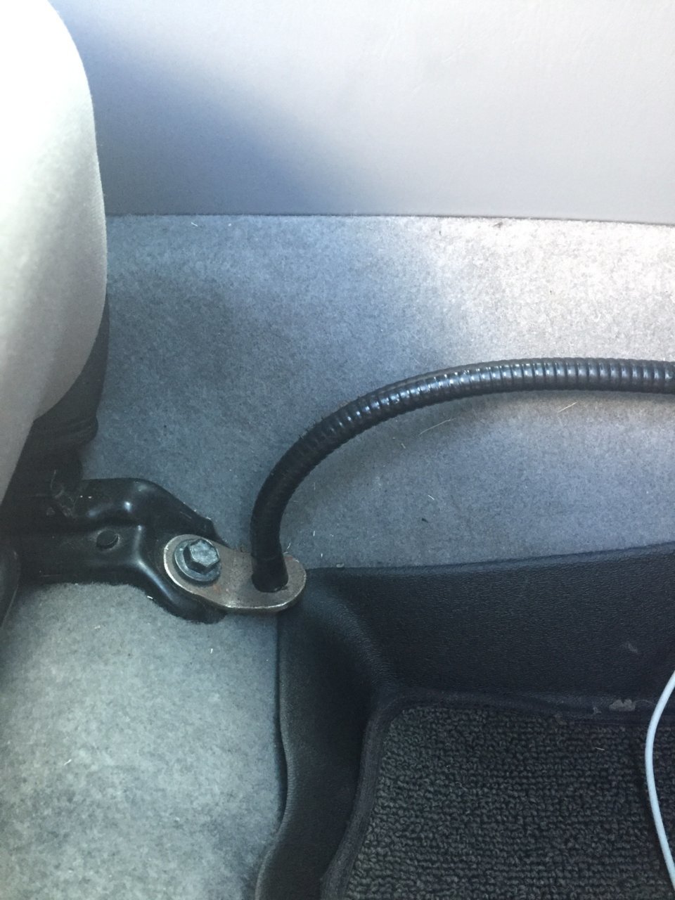

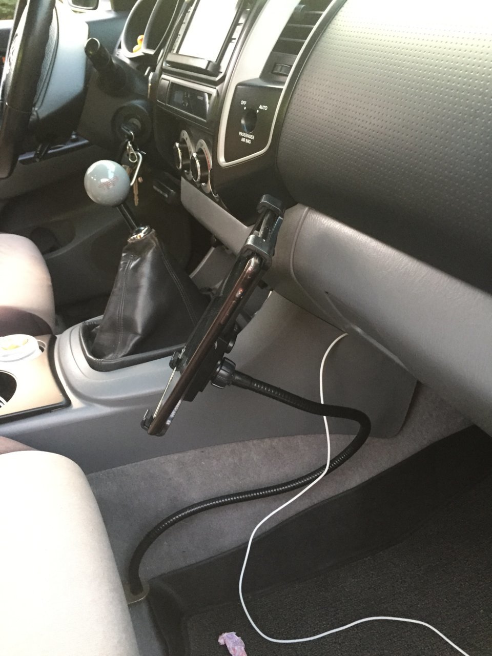

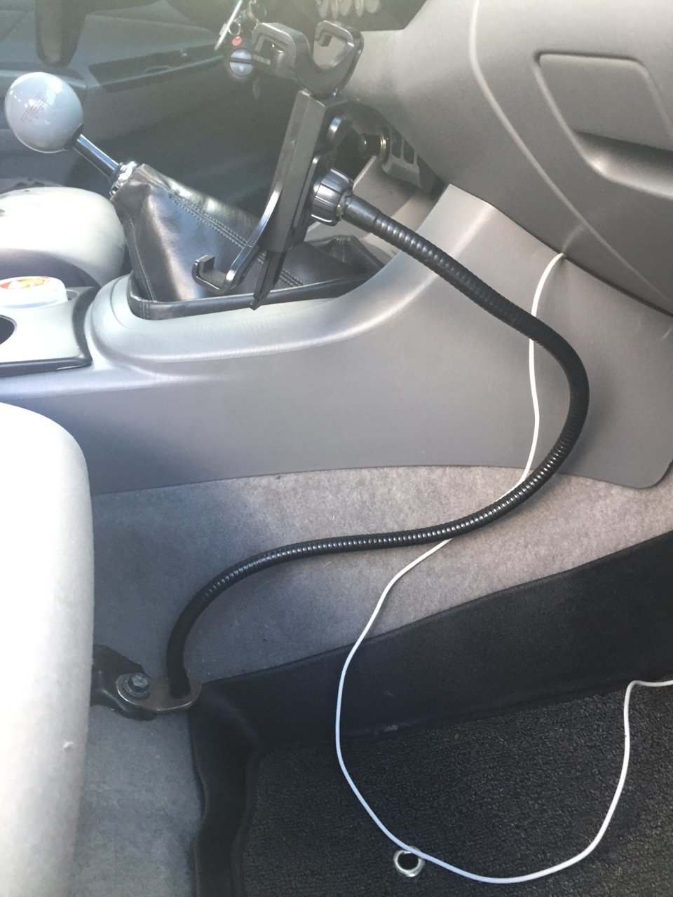

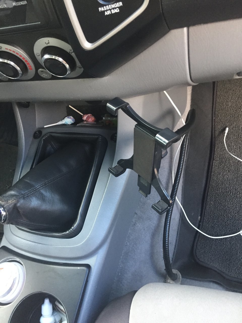

    Diy iPad Mini Mount -
    mk1jacob likes this.

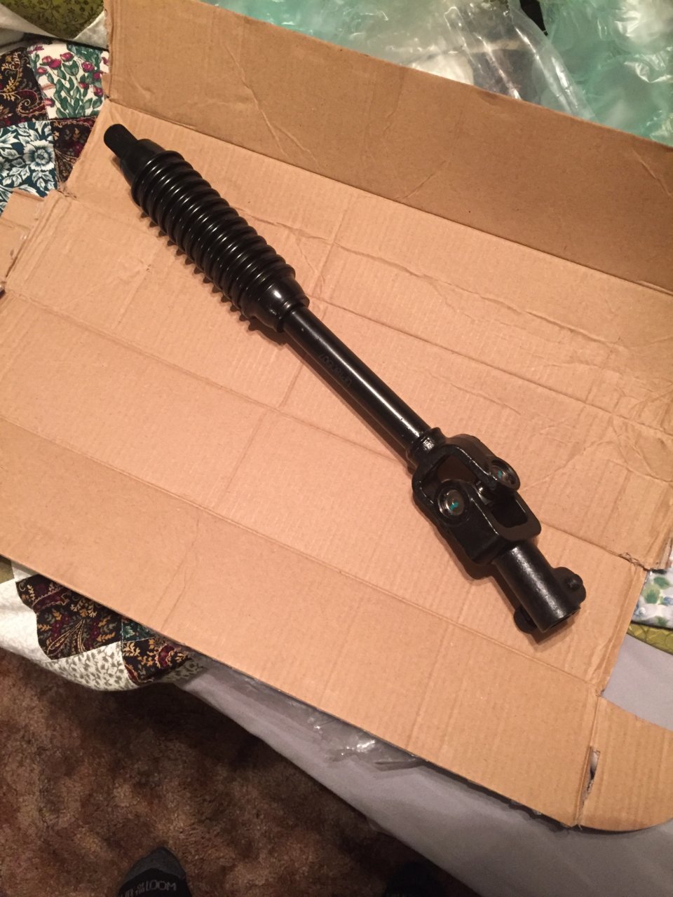

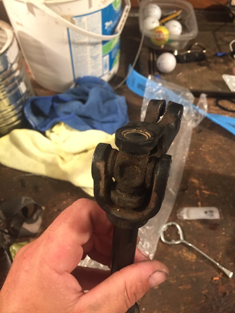

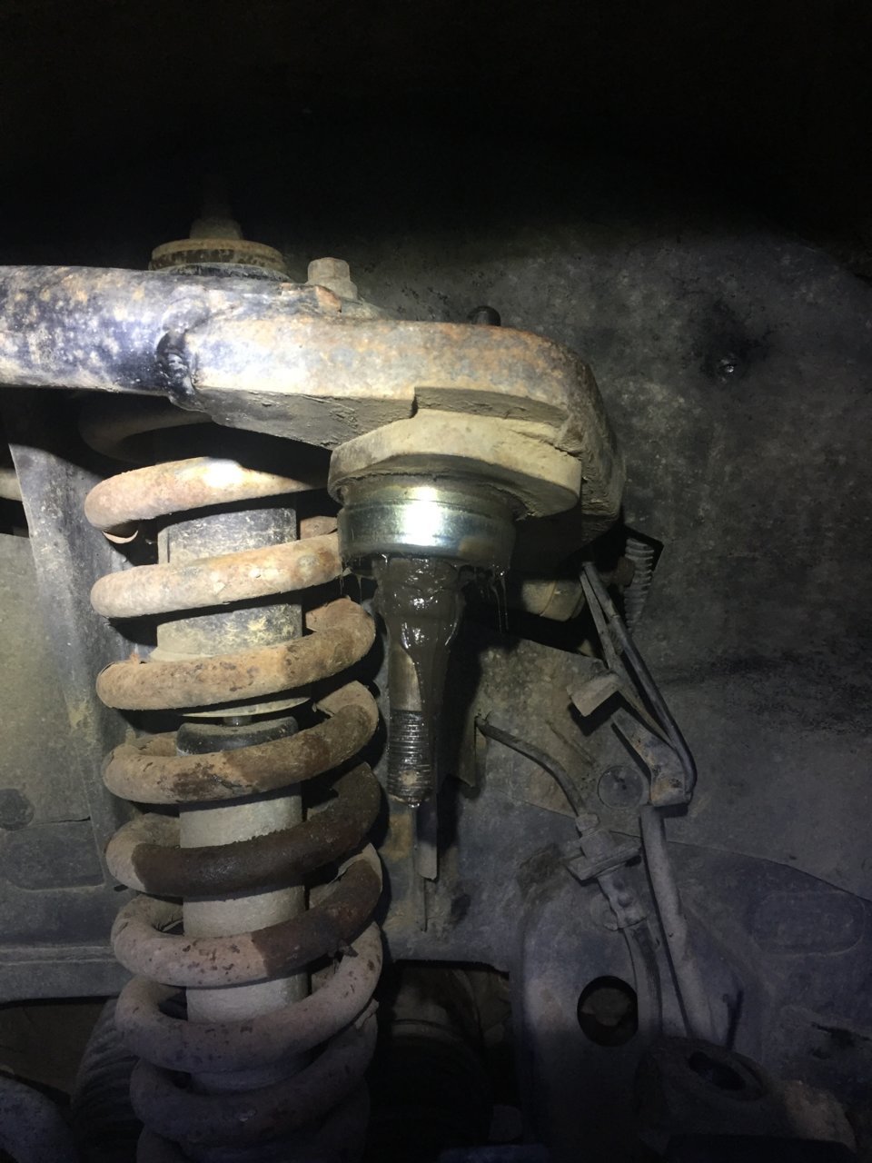

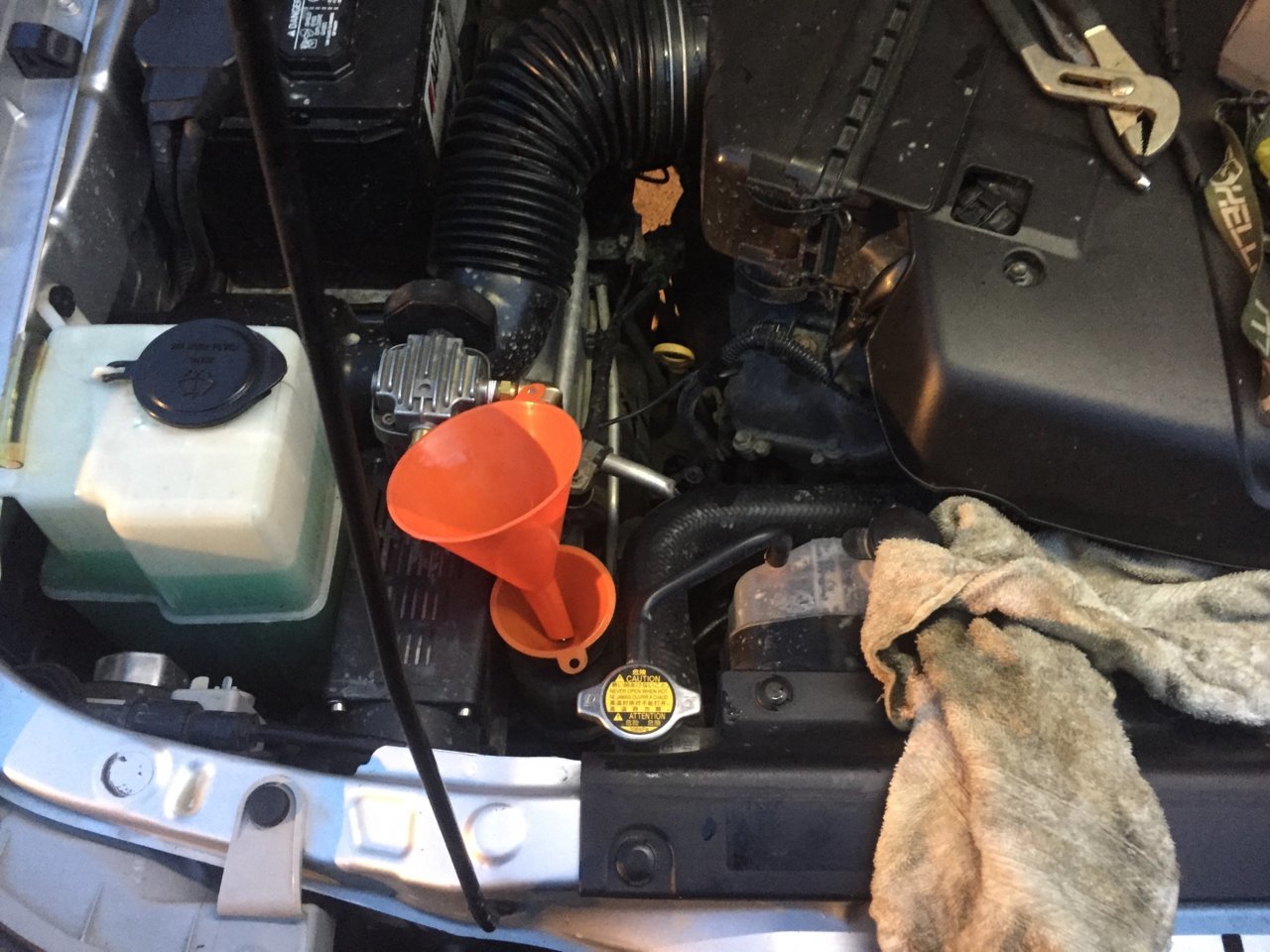

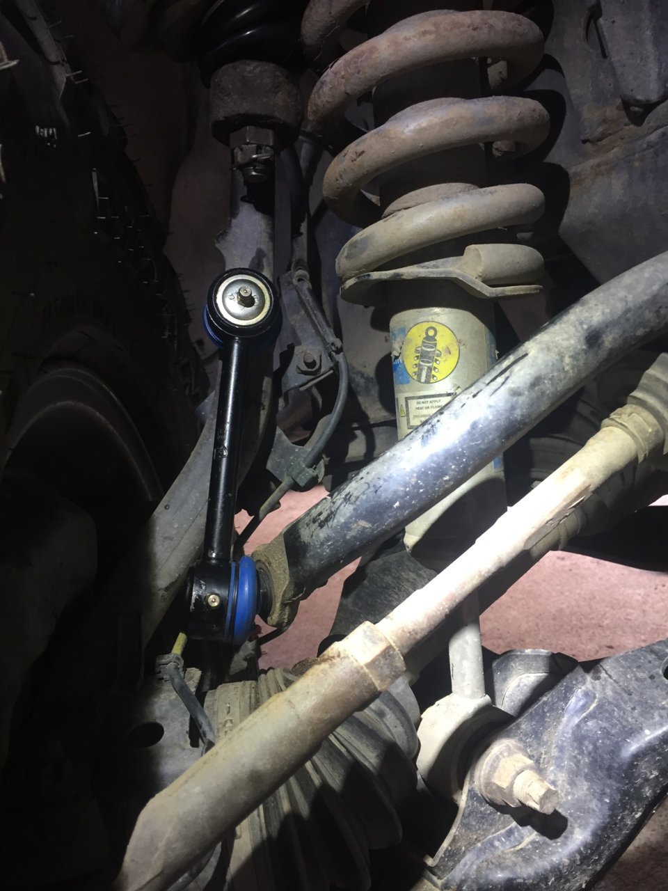

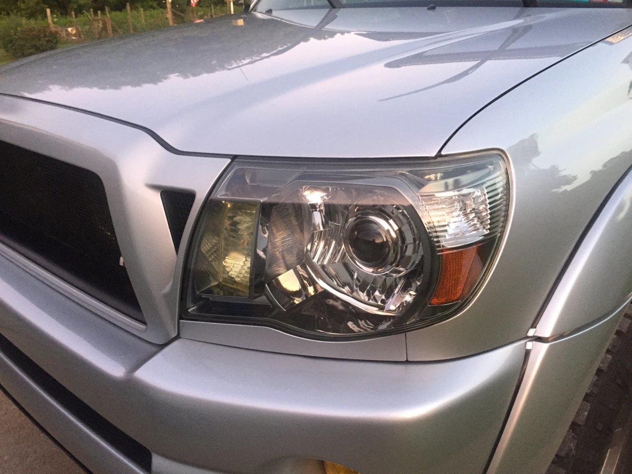

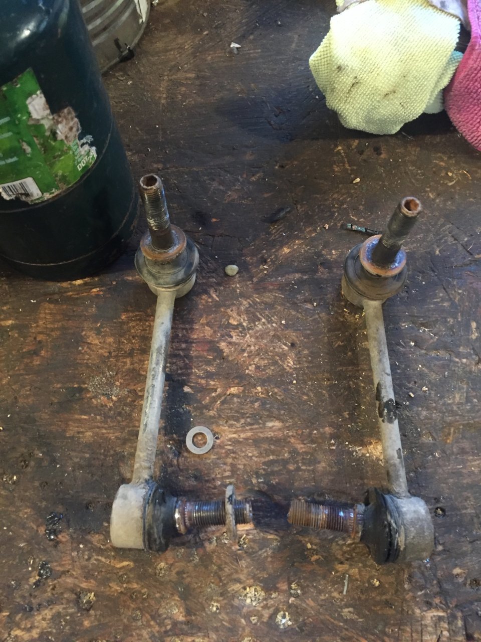

    Some maintenance stuff
    New sway bar end links
    Went with the Mevotech ones since they are greasable and “heavy duty”.

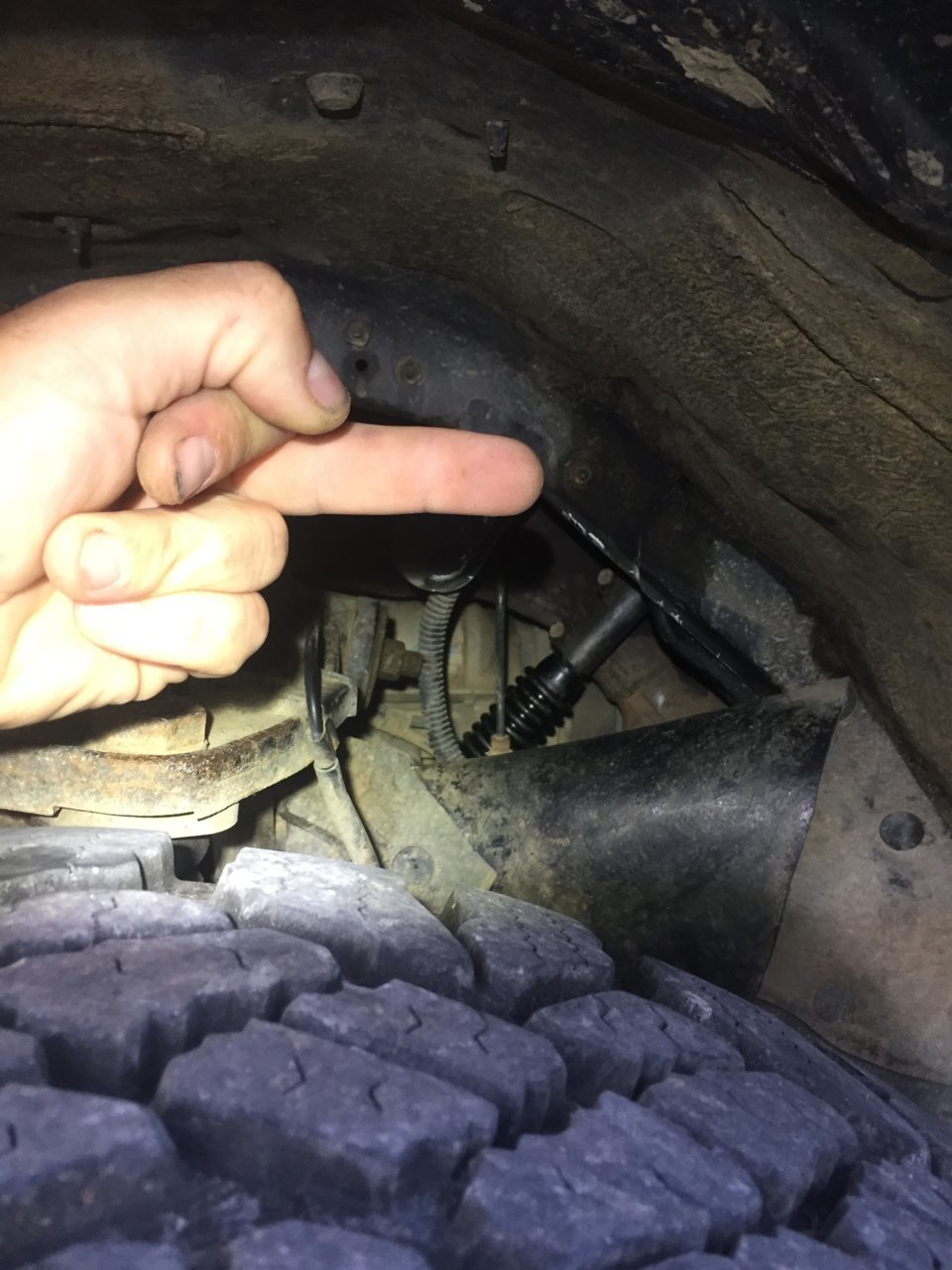

    Replaced the UCA ball joint boots and regreased the ballpoints
    Flushed the power steering fluid
    Replaced the steering intermediate shaft
    Buffed and sealed the headlights

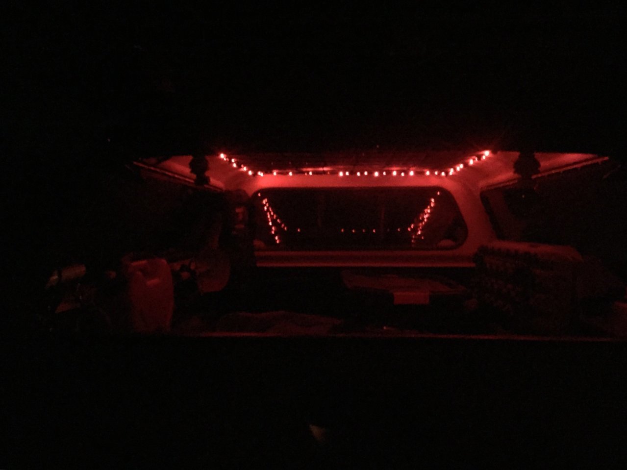

    Added red LED rope lights to the shell for night vision while camping.

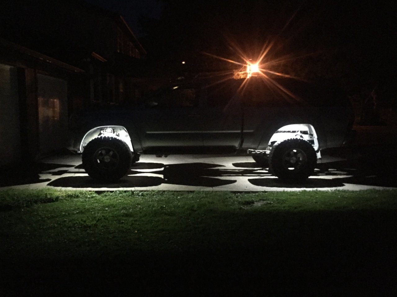

    Installed some rock lights

    How much of a pain was the intermediate shaft? i have a feeling that's going to need changed on my truck sooner than later.
