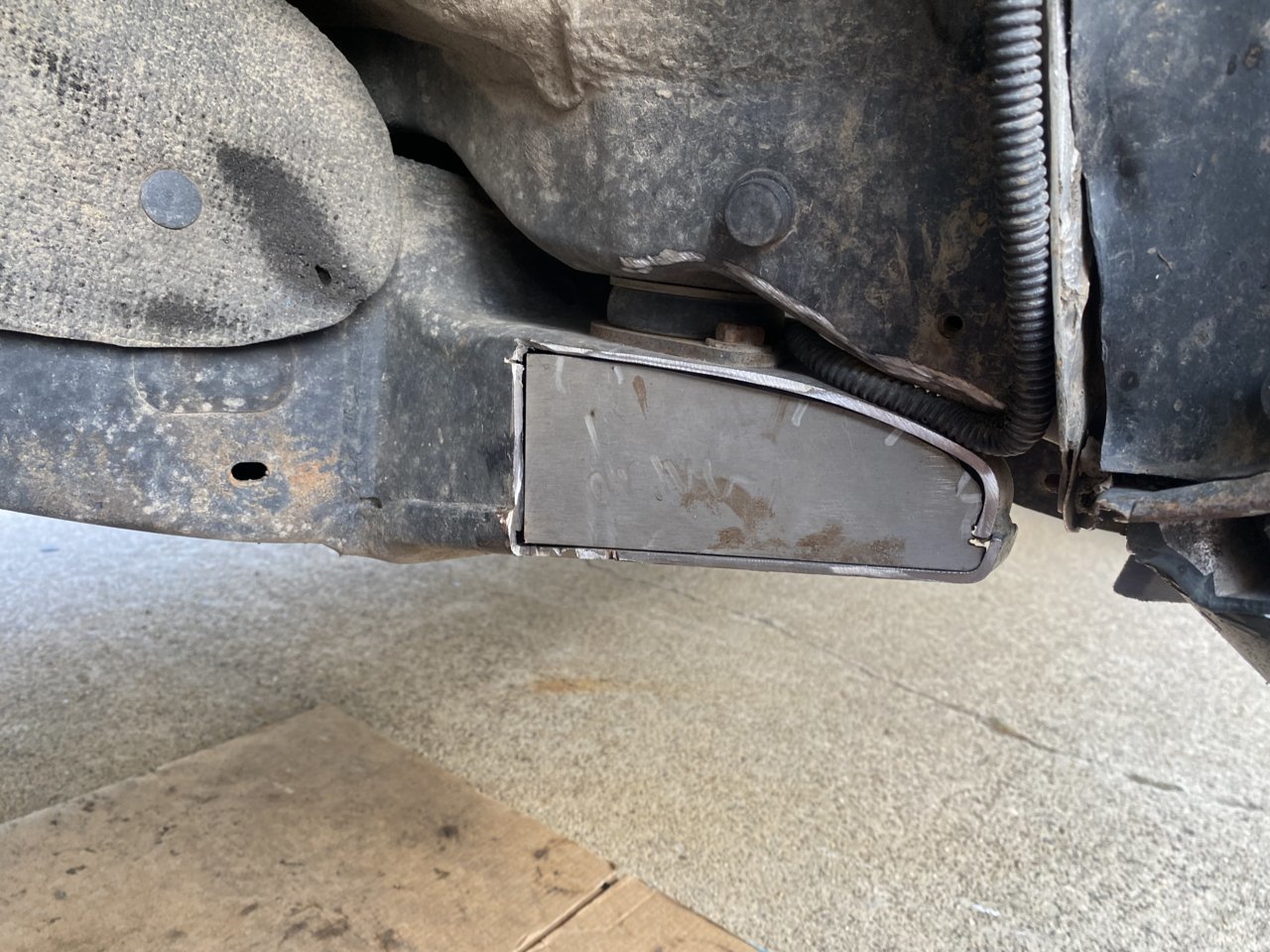

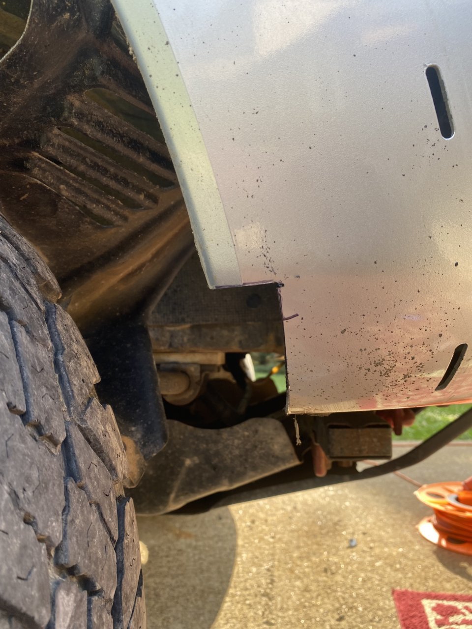

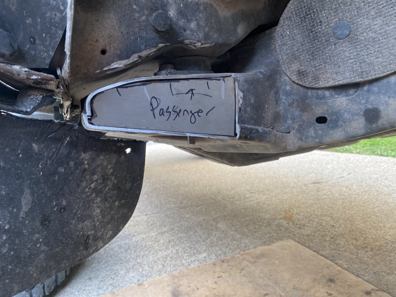

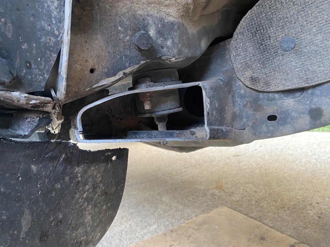

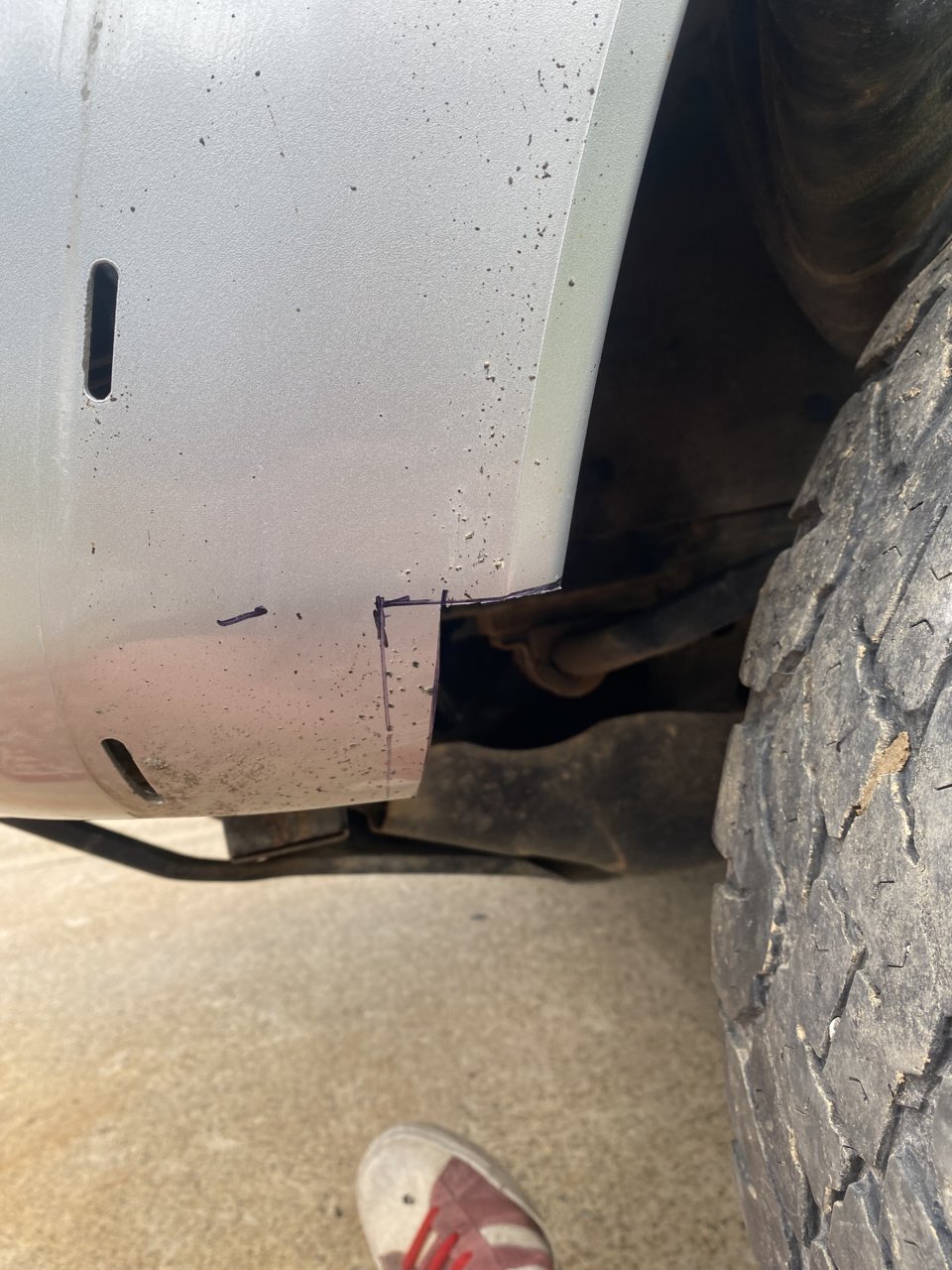

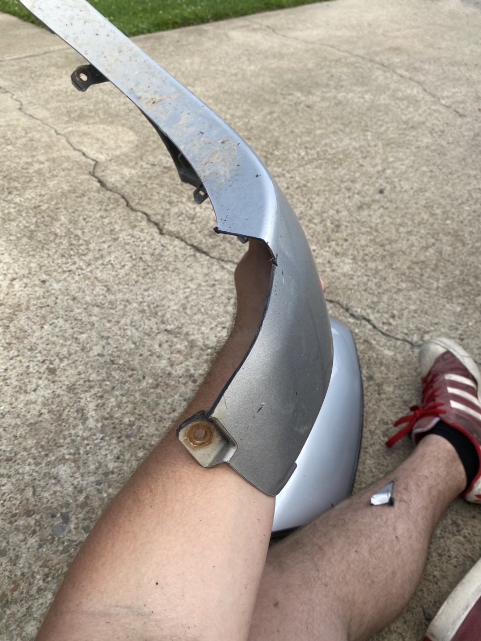

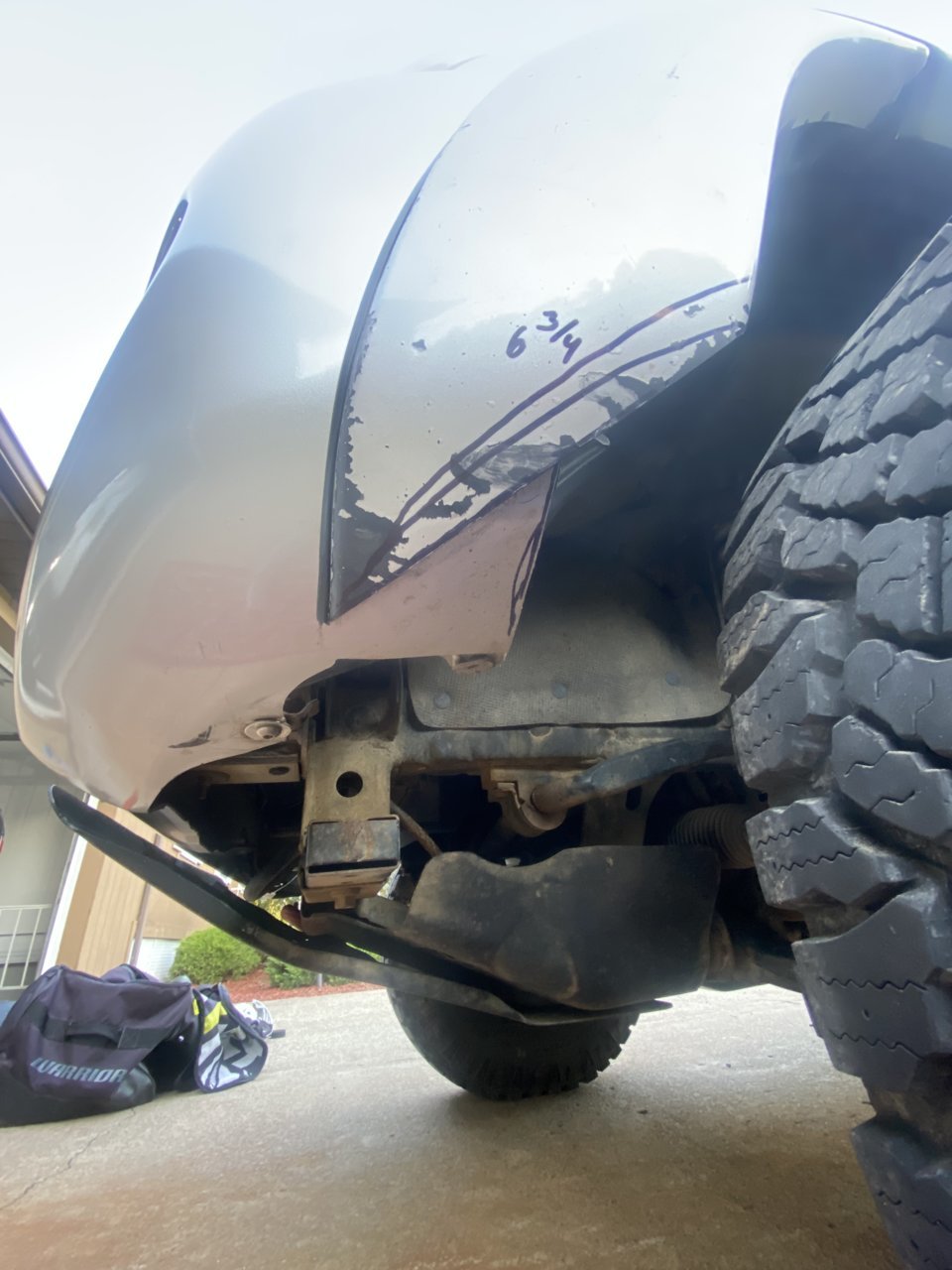

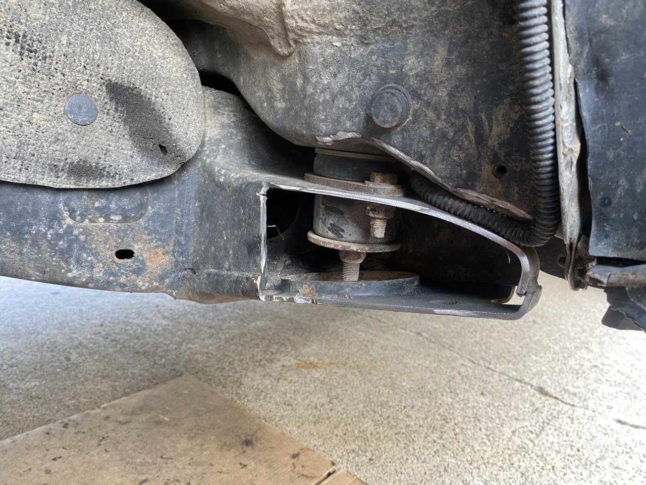

    Finally gave in a did a cab mount chop. After I put the wheel spacers on, the front tires were rubbing at full lock.
    upload_2021-7-8_0-32-55.jpg upload_2021-7-8_0-33-19.jpg upload_2021-7-8_0-34-22.jpg upload_2021-7-8_0-34-47.jpg
    I need to get the new tires mounted and flex the suspension out to make sure everything clears before welding it back together.

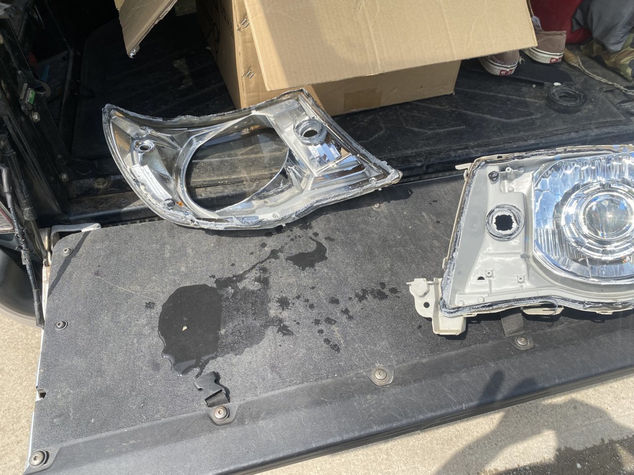

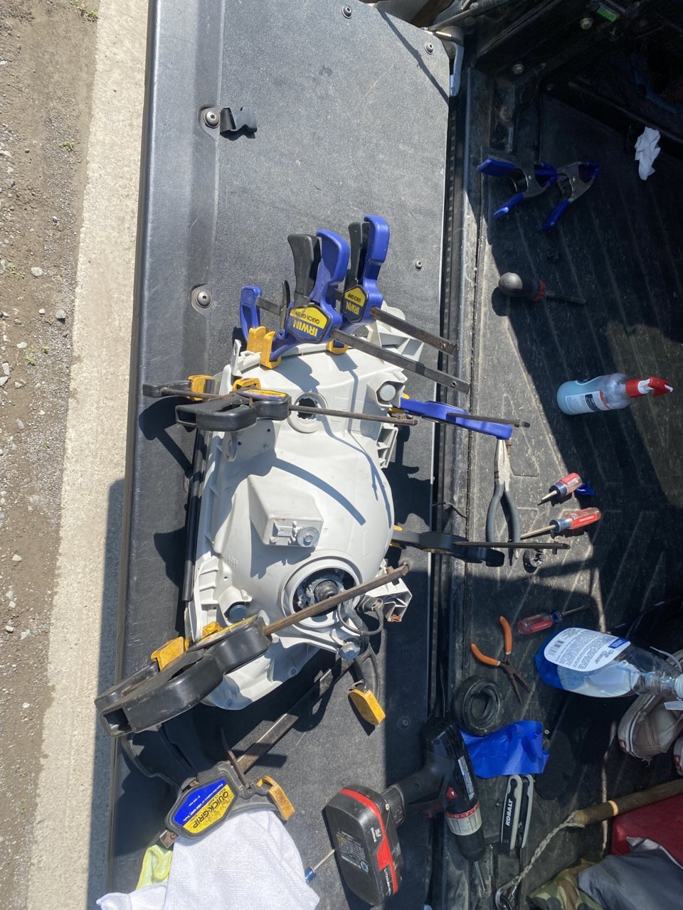

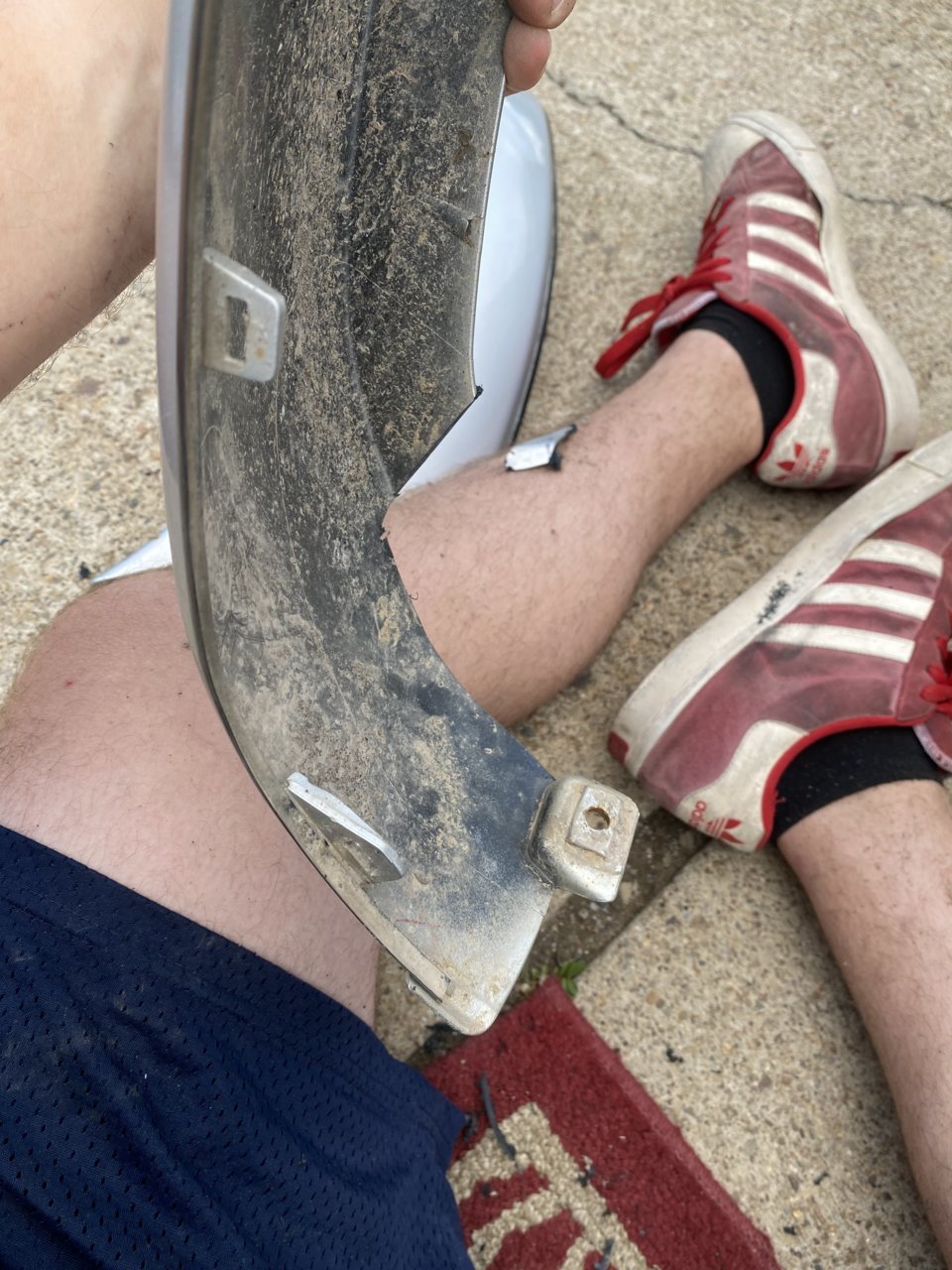

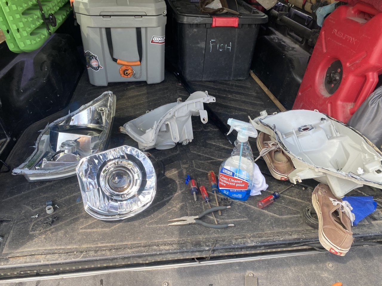

    Driver side headlight started randomly fogging up after being fine since the last time I redid the retrofits. Took it apart. Dumped this out of it.
    Used this as an opportunity to fix this and the broken bucket tab. Swapped buckets from a spare set of lights.

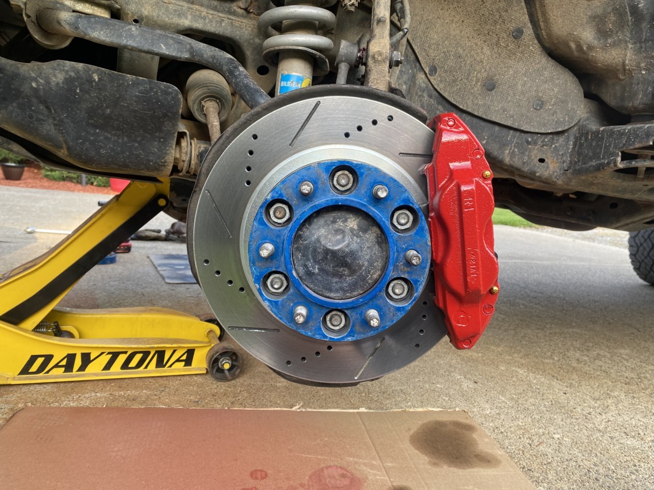

    New calipers, pads, and rotors.

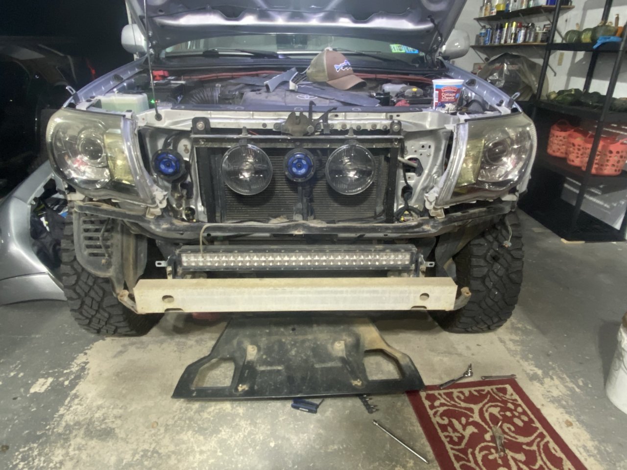

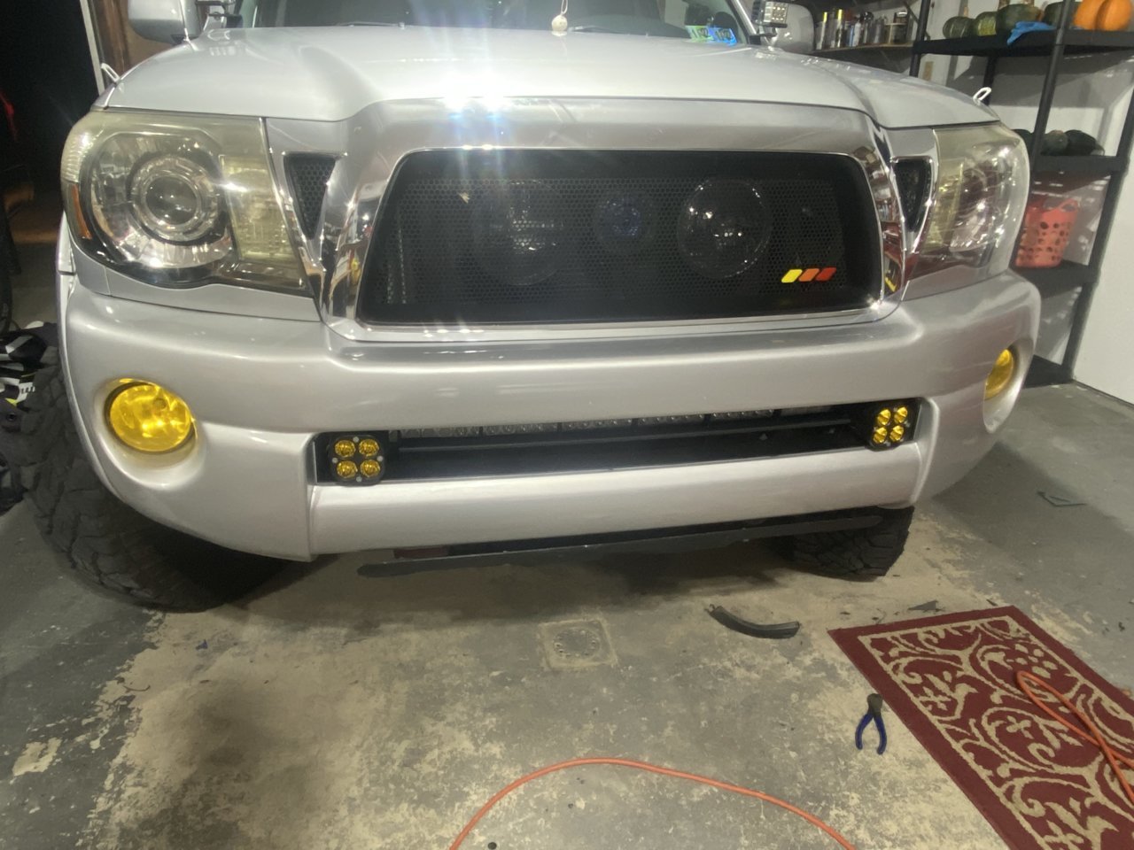

    I moved the aux fog lights from behind the grille to the bumper. The mesh grille blocked more light than I thought

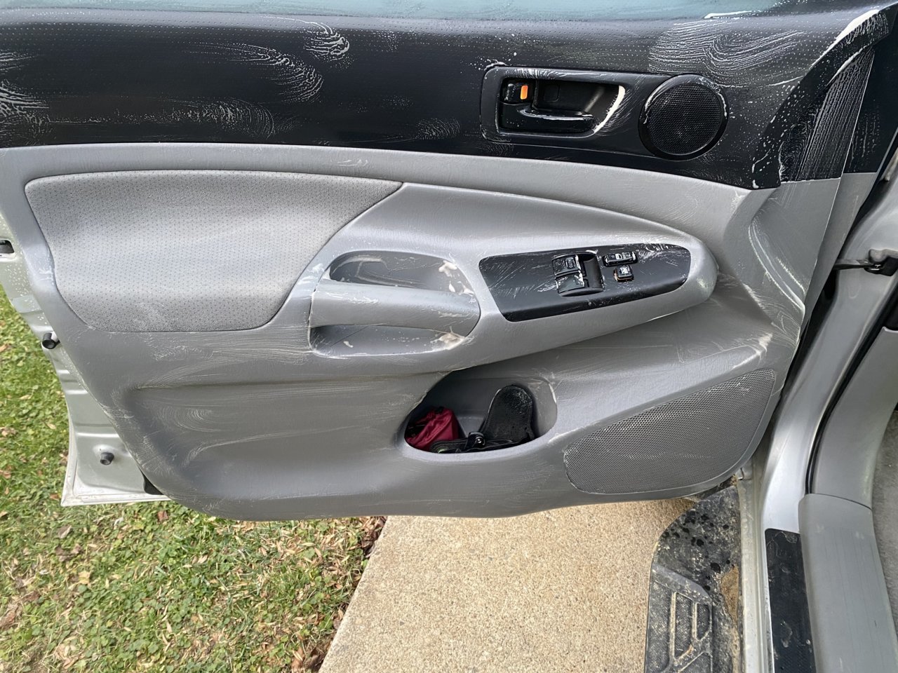

    I repainted some of the dashboard trim

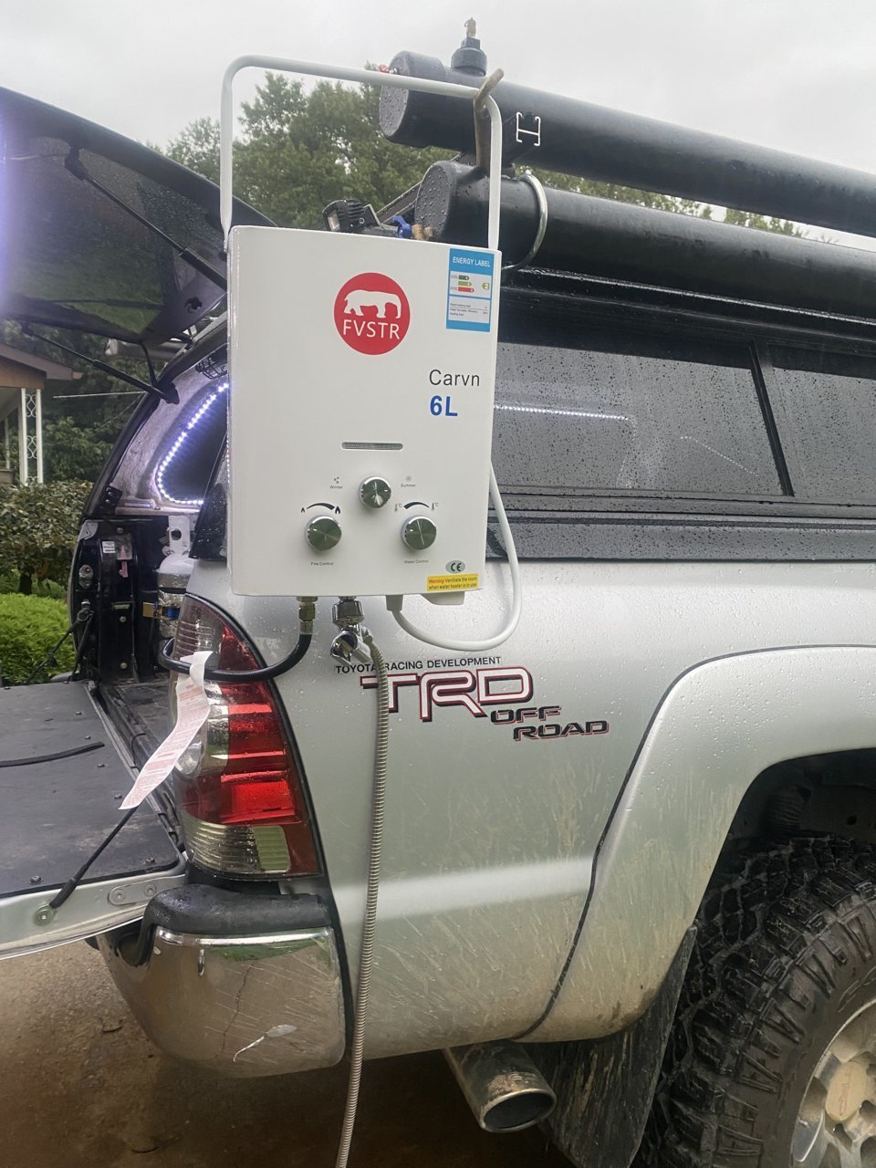

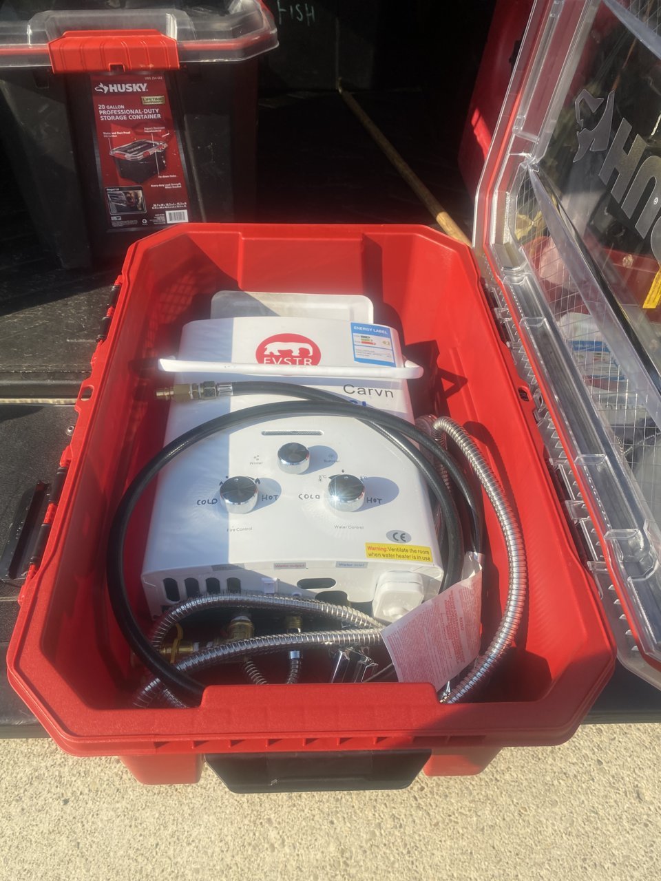

    Tankless hot water heater.
    This thing is awesome.

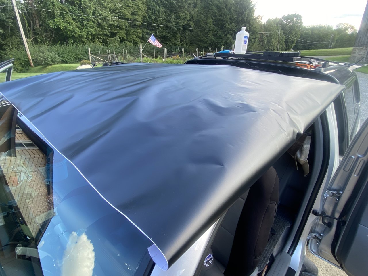

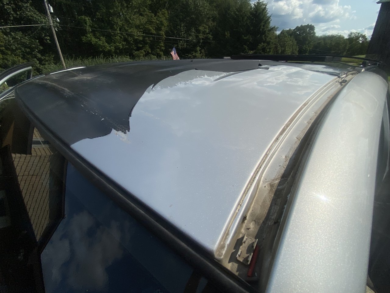

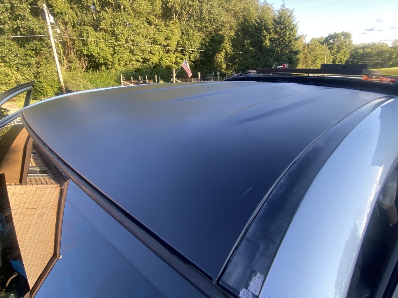

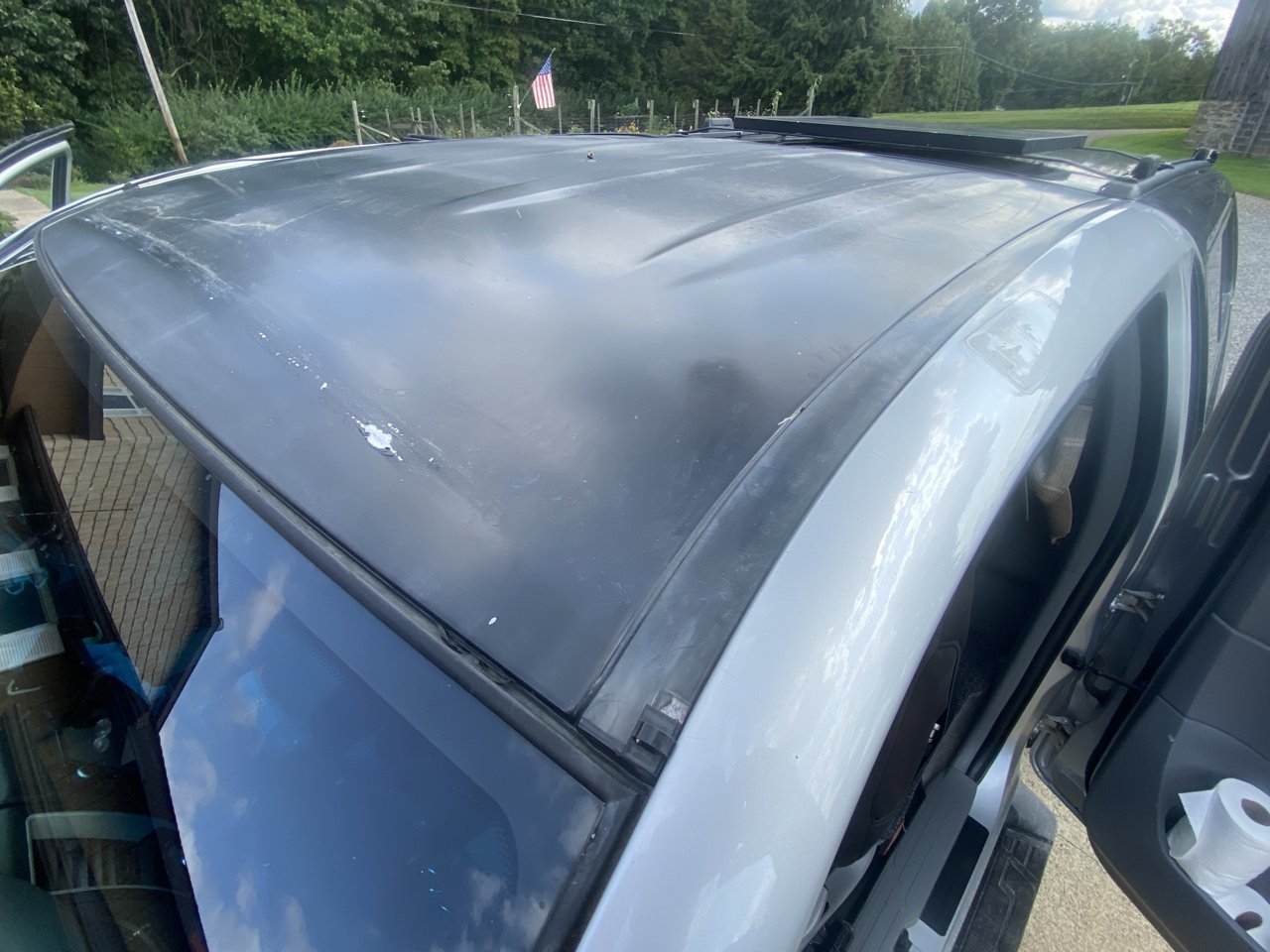

    Rewrapped the roof -
    The old vinyl was fading and at the end of its life.

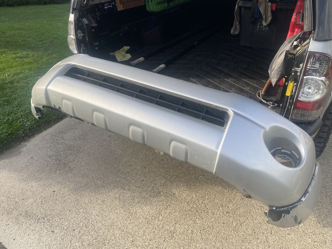

    Picked up a bumper off of Craigslist. Mine had some damage and this one is in better shape -
    Way better now.

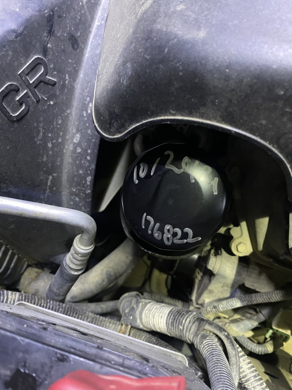

    Did a couple things….
    Another oil change -

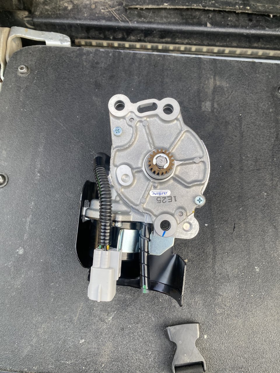

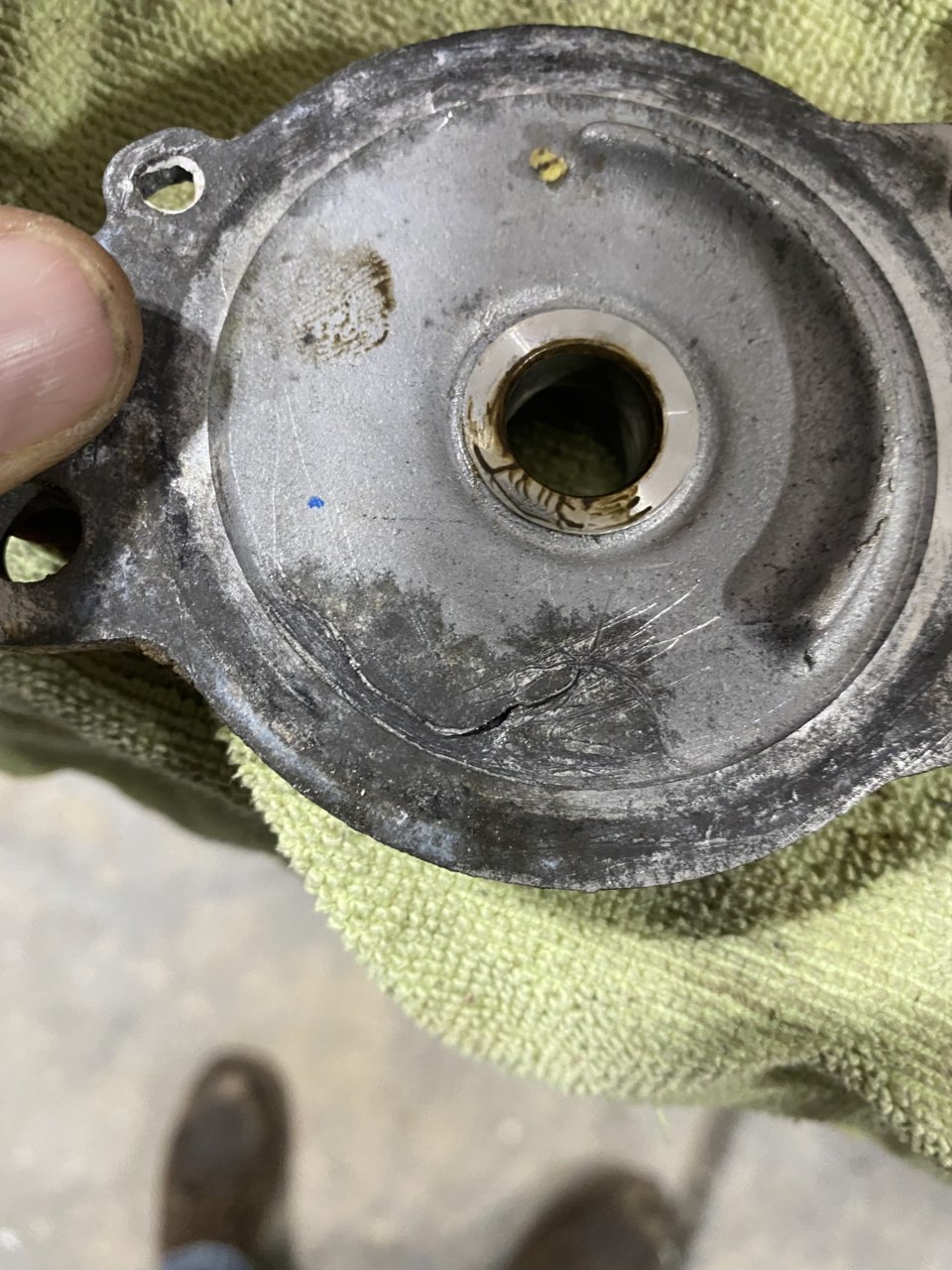

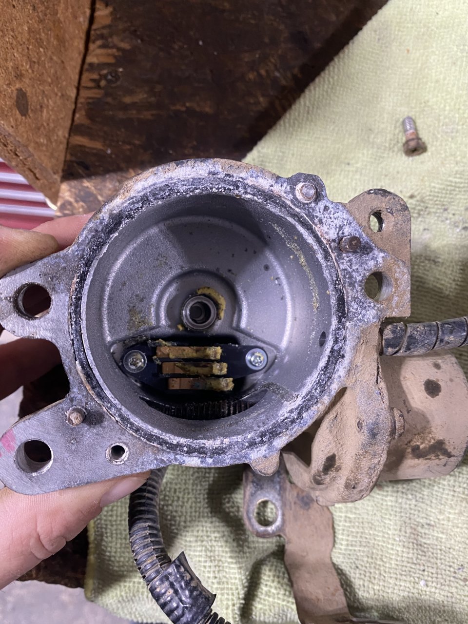

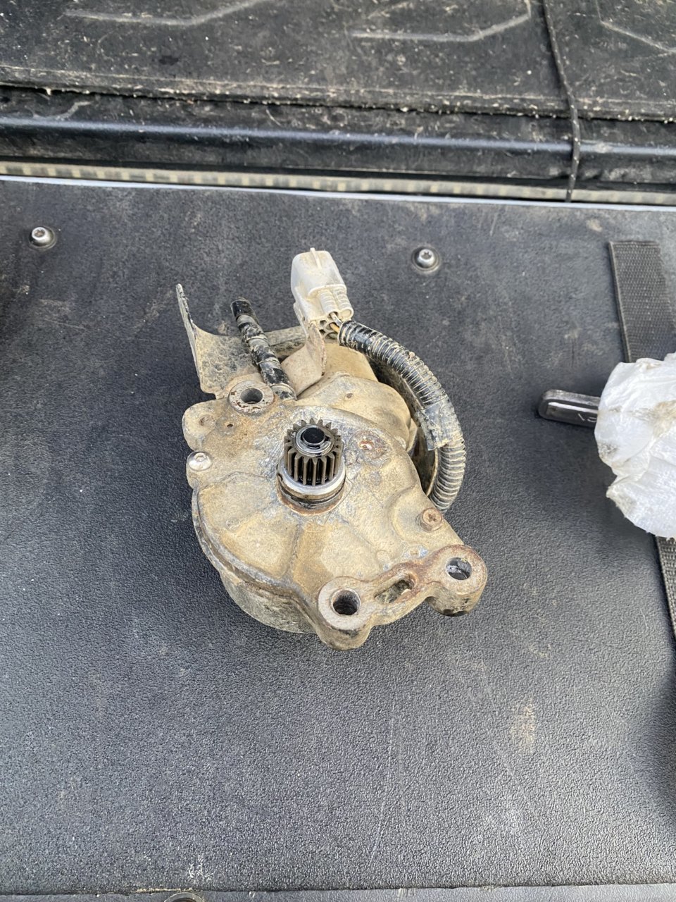

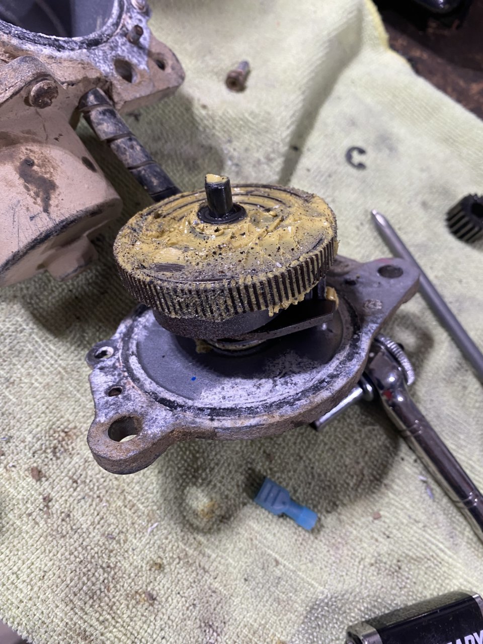

    E locker stopped working. Took the actuator apart -
    Replaced it -
    Fixed.

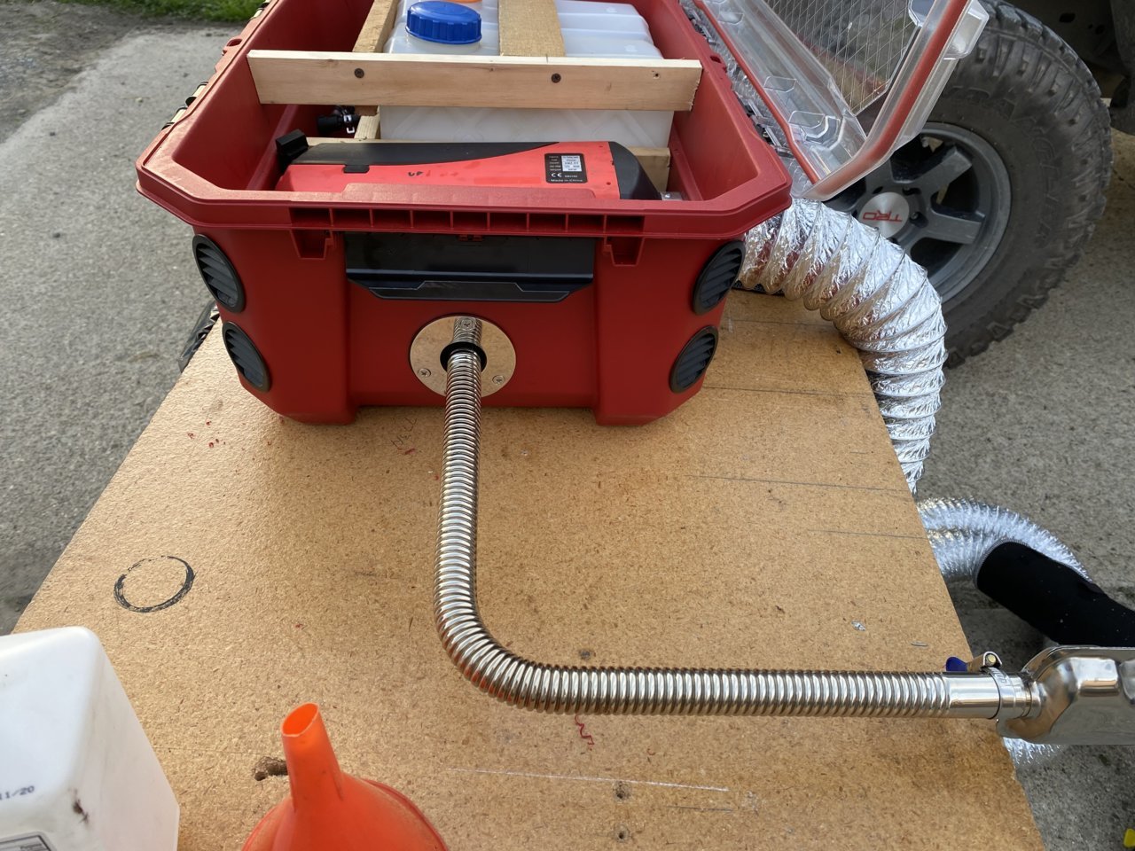

    And I rebuilt my Chinese diesel heater -

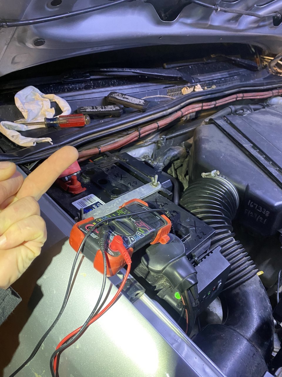

    House battery is bad, has multiple bad cells. Thankfully Advance Auto actually stands behind their warranty. So that got replaced.

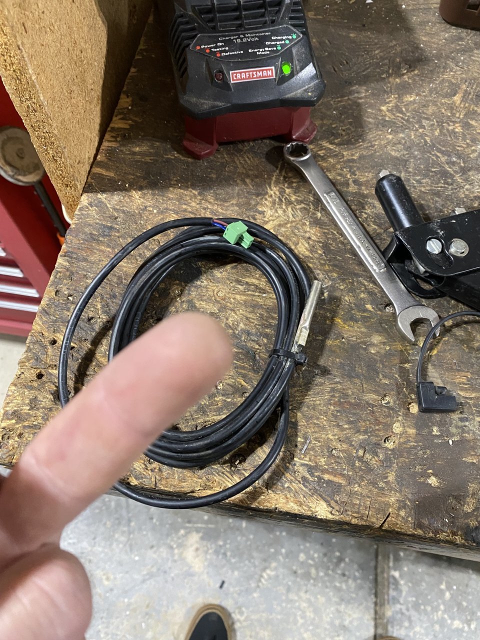

    The temp sensor for the solar controller stopped reading correctly so that got replace.

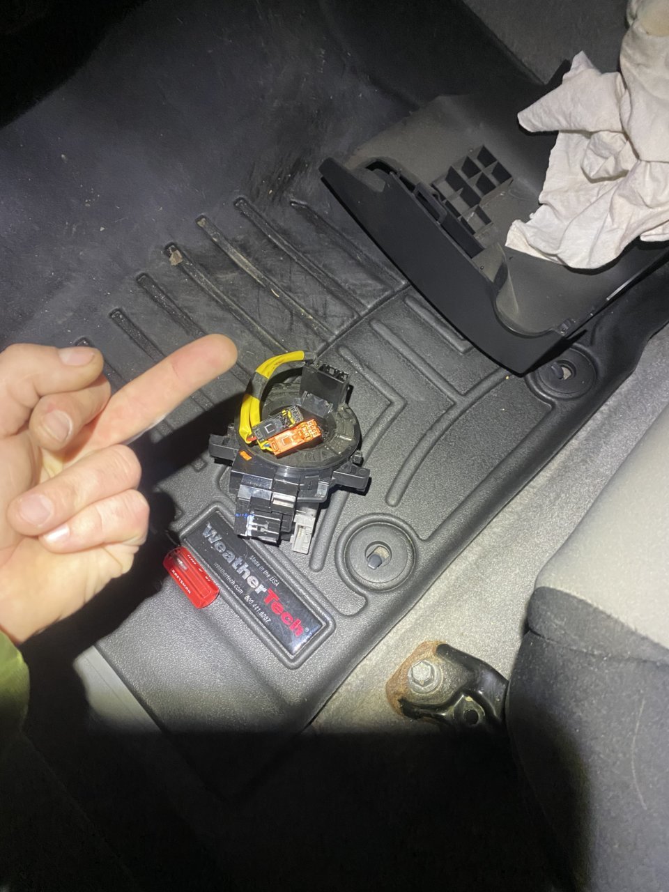

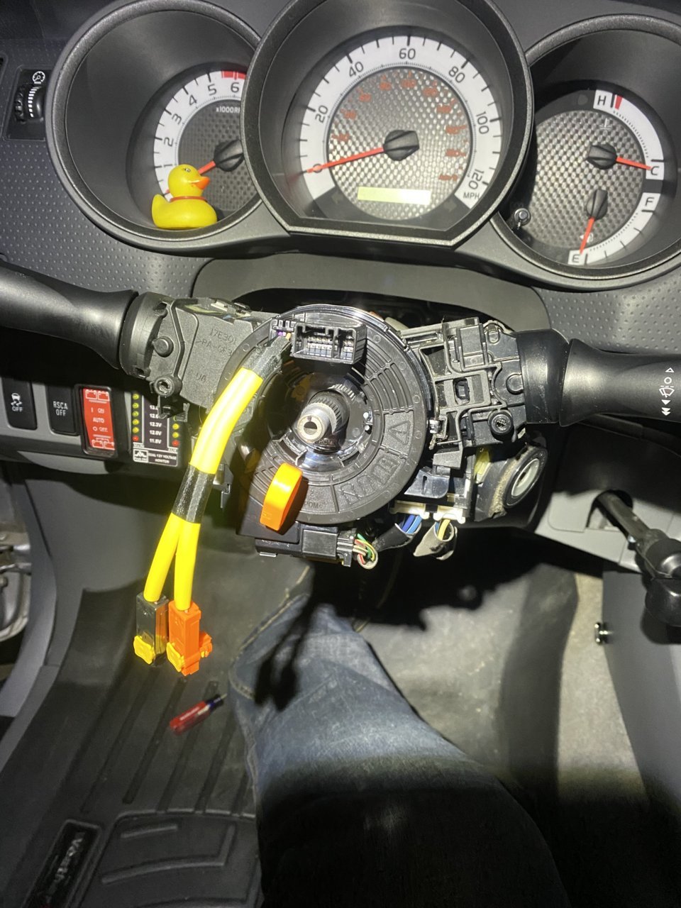

    Horn stopped working unless the steering wheel was turned 90*. Clock spring crapped out at 179k miles.

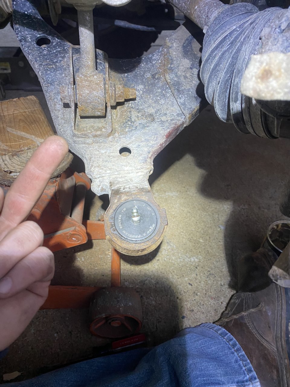

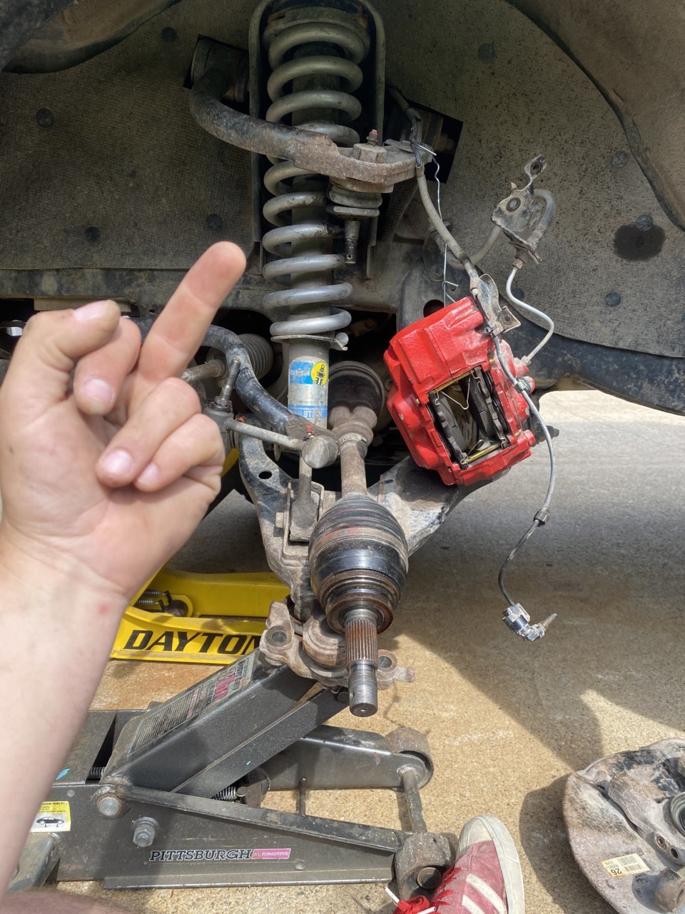

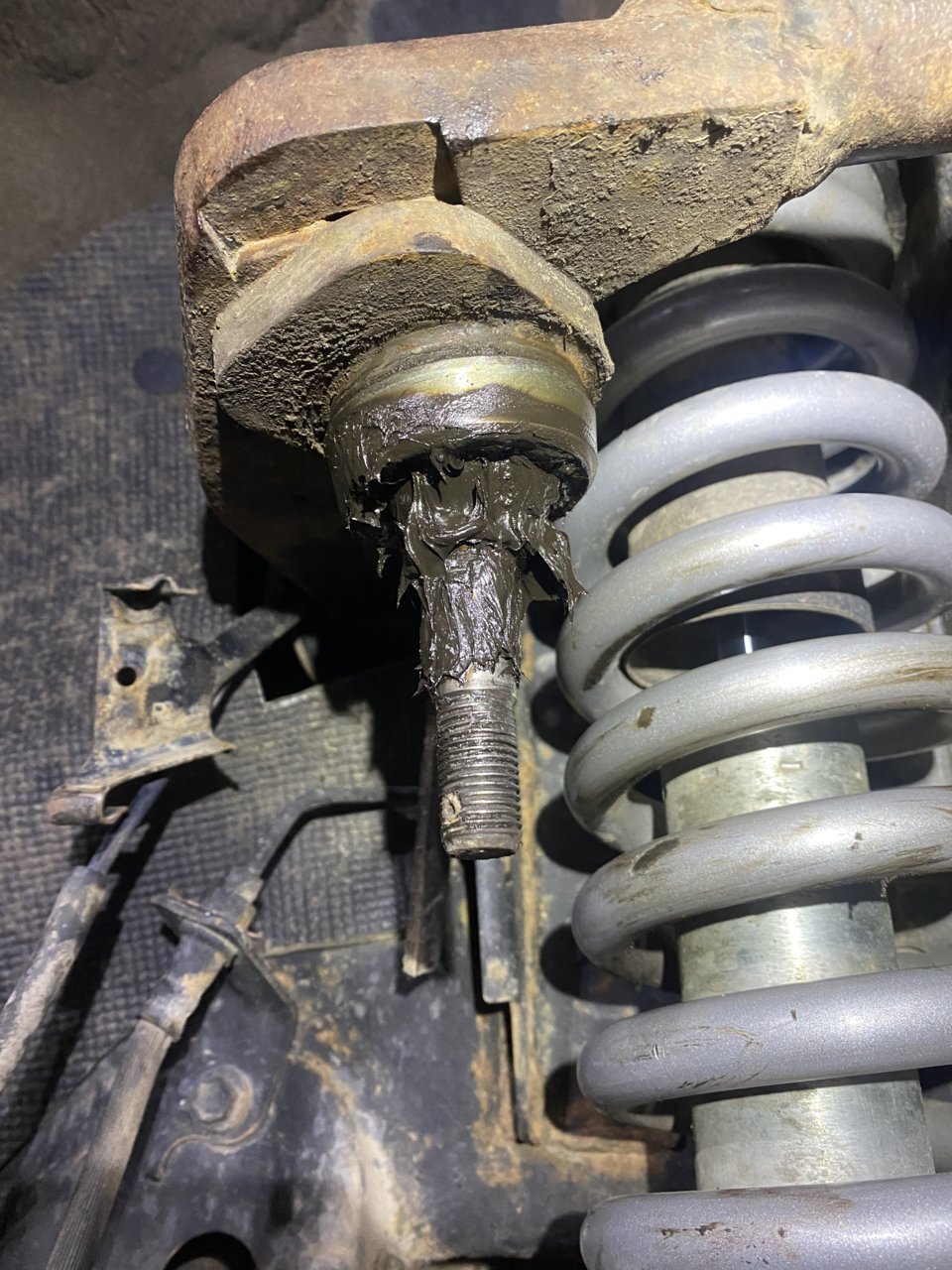

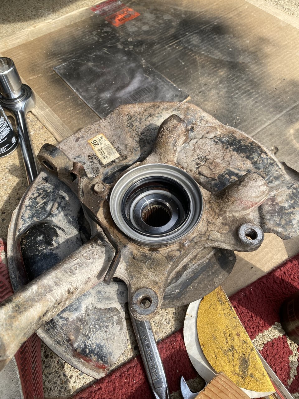

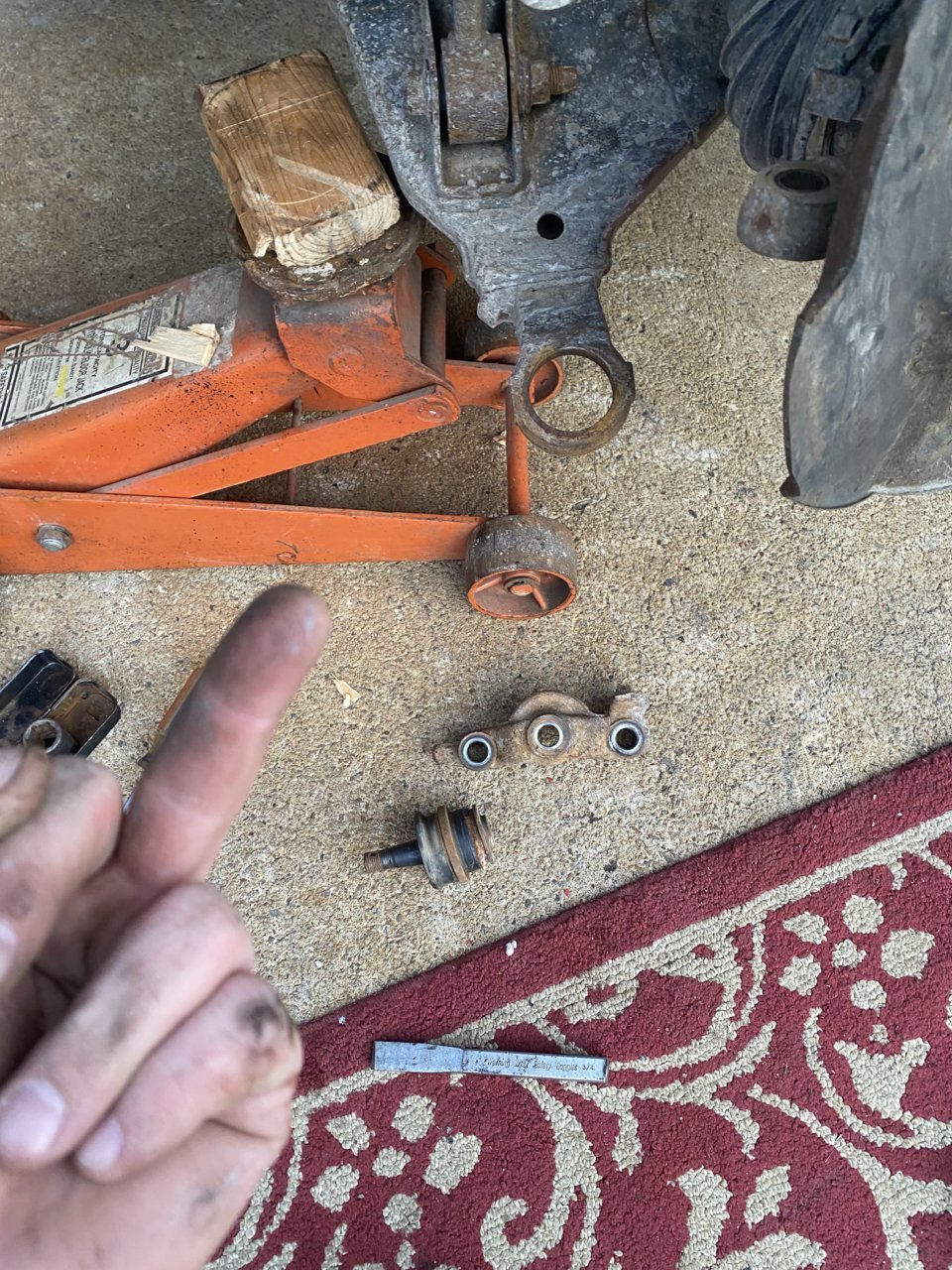

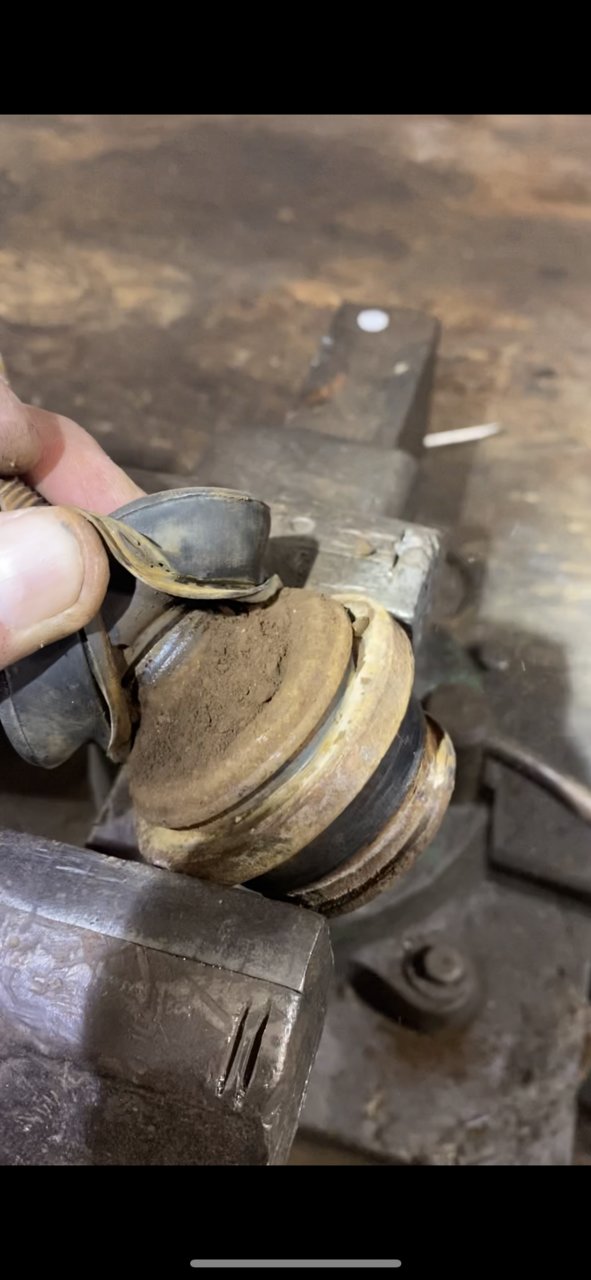

    New lower ball joints
    Rebuilt the uppers

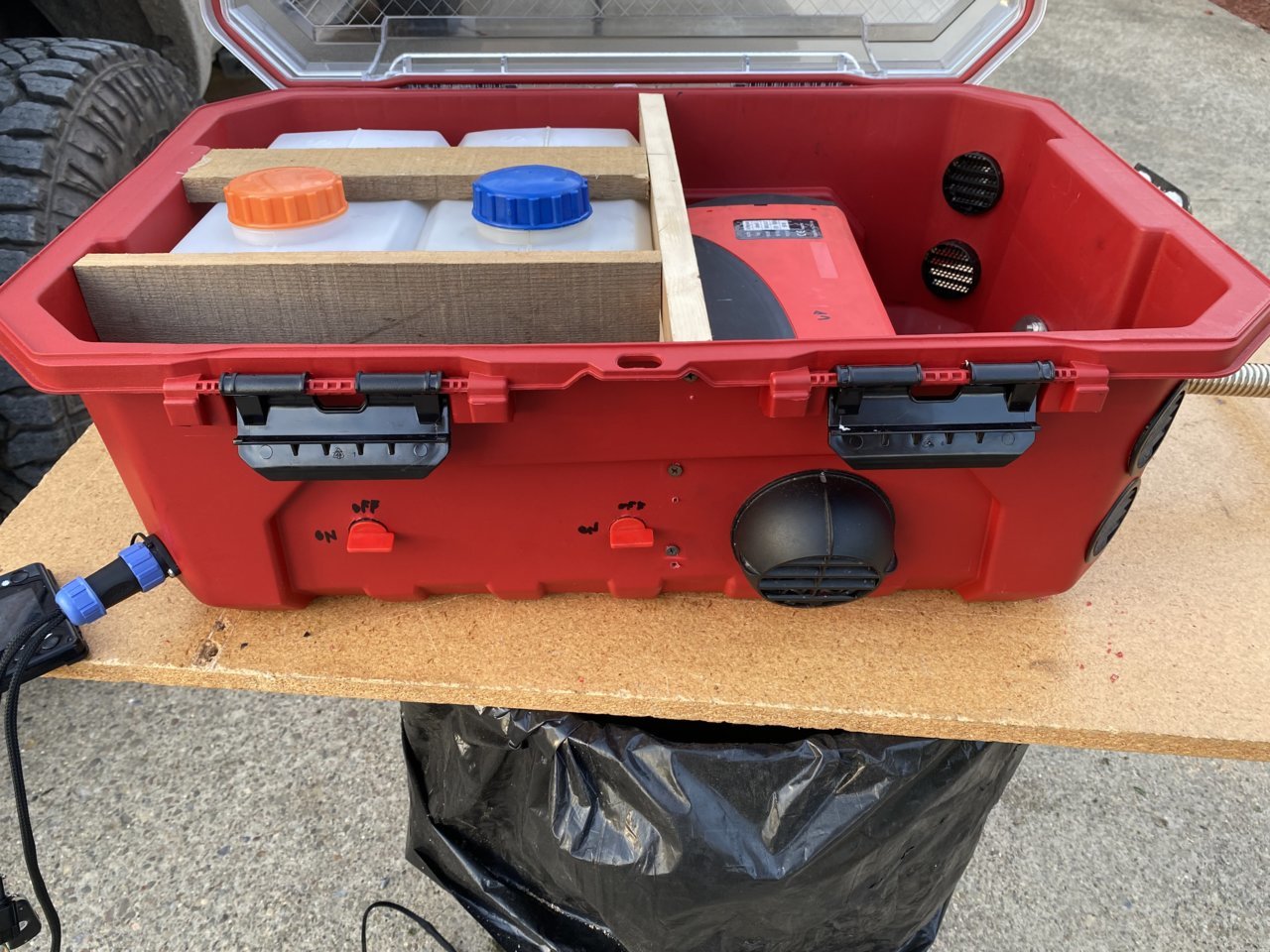

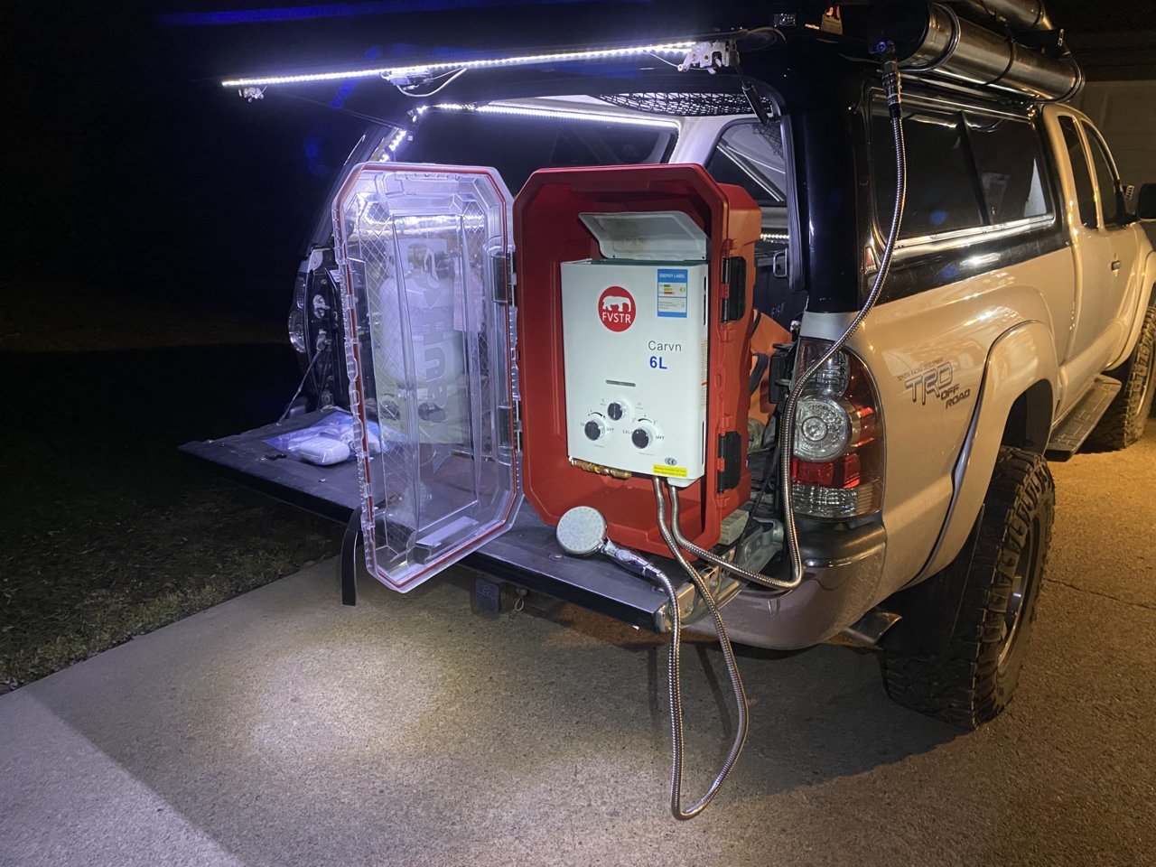

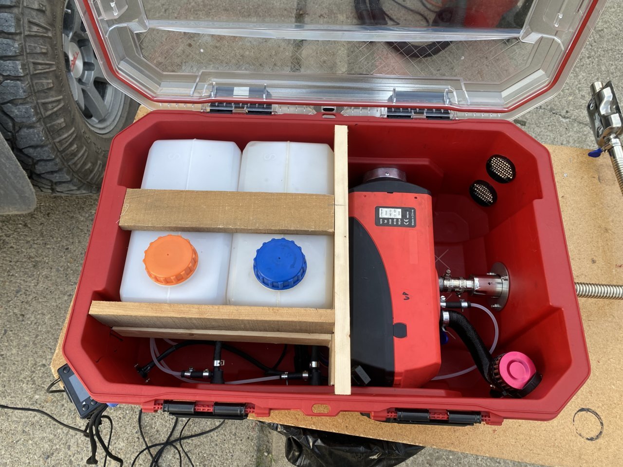

    Redesigned the water heater to live in the tote.

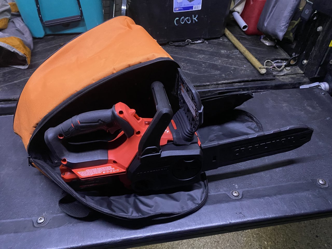

    Picked up a 12” 20v battery chainsaw to keep in the truck for wheeling and camping.

    Gawd, that ball joint looks like it was a miserable replacement. I really like that chain saw though! Deets??
