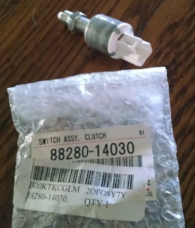

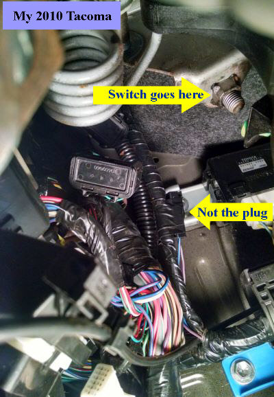

    I purchased the clutch switch (below) for my 2010 manual transmission Tacoma, however I cannot find the "correct" plug that plugs into the switch. I posted pics the "Adding cruise control?" thread here starting with post #35 showing where I originally thought the plug was located but all 3 were wrong. Does anyone have any pics of the wire that is connected to their clutch switch? Or better yet .. a pic of the switch taped to a wire before it was plugged in?

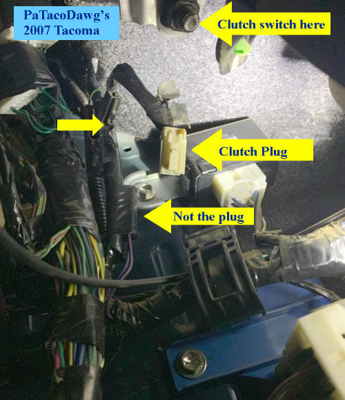

    PaTacodawg sent me a pic of his clutch switch which came from the vertical wire harness shown on the pic he sent me below, however my vertical harness does not have the clutch plug taped to it. Here is the switch, PaTacodawg's pic and my pic for comparison.
    Can anyone unravel (pardon the pun) this mystery? I've spent a total of 60 minutes or so searching for this plug 6 times now and would truly appreciate anyone's help.

    I've been under my dash looking for this elusive white clutch switch "plug" 10 times or more by now for the past 5 days and I still cannot locate it anywhere. So could it possibly be that there were no clutch switch "plugs" provided in a "manual" 2010 Tacoma?? I can't imagine that. Some members here have indicated that the clutch plug exists in their "automatic" Tacomas. So how could it not be available in my manual truck? The wire should be somewhere near the top where the clutch hits the switch when released.
    I live in the Trenton NJ area, so Is there anyone close by in the Central NJ or Eastern PA area who knows where to locate the clutch plug? I'll come to you. If not, I guess I can bring it to a dealer and have them search for it.

    Have you taken the lower dash apart? Mine was tucked behind the wire loom taped off.
    It's also possible you're not prewired for it. Did you try jumping the pin on the steering wheel? If you're wired it'll light up

    I tried it both ways ..with the lower dash apart and without. I already installed the special wire needed for the cruise stalk. So now when I turn on cruise, the "Cruise" light lights up on my dash. But that's all.
