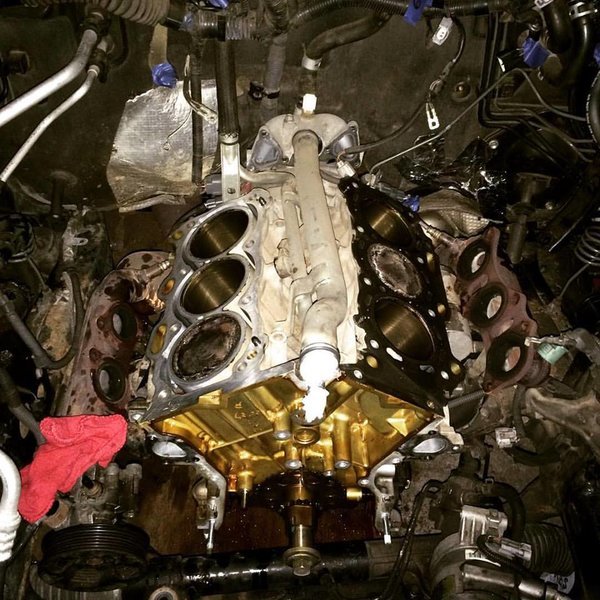

    Update: Progress! I officially have the heads off. And it sucked. I mean it really sucked. I've easily sunk 20 hours into this thing already, and had to order some oddball tools half way through. For one, the head bolts require a 12mm triple-square bit, and the front diff mount requires a 12mm allen bit socket. I also managed to damage the SK triple-square bit getting the heads off. I used a 2 foot breaker bar and gave it all I had. I even had to wear a kidney belt to stabilize my back. Those were the most stubborn head bolts I have ever dealt with, and sure enough, there was coolant in the #6 cylinder when I pulled the heads off. It must have leaked in there while I was waiting for the tools to get here in the mail.

    Congrats. These type of jobs sucked when we were young and suck even more now..gotta try to hang on to that 2000 bux though and glad you know your not just taking a chance that was the problem.
    measure that cylinder pretty good before going back together. See what your going to be dealing with for the future.
    Some jobs tear down easy and go back hard.....hoping this goes back easy for ya.

    I'll measure the cylinder next weekend when I unwrap the engine. I saw some slight scoring in it, but it was pretty minor and nothing I could feel with my nail. One of the cam bearings and some of the aluminum bearing caps had some wear marks/very slight scoring, but nothing that made me think coolant got to them. For having nearly 170k on them, they are probably in pretty good shape. I say probably because I've never torn open an engine with this many miles without the intent of overhauling and stroking/boring it, so I've always replaced or machined the wearable parts in the past without giving them much thought.

    Update: I checked the heads with a straight edge and they are perfectly flat. I couldn't even get my .0015" feeler gauge to slip under the straight edge anywhere. I'll still clean them up and replace the valve seals, but I guess they don't need to be machined.
    I checked the bearing caps and the bearings on the front of the heads again, and everything is in really good shape except for the one bearing that sits over the #1 head bolt on the front of the passenger side head. That one bearing is in sorry shape, and I'm thinking I'm going to replace it. The cylinders all looked really good except for #6 which just looked pretty good, so I'm guessing that one cam bearing was just a fluke.
    edit: I just realized that the timing chain connects where the worn cam bearing is, and the same spot on the other head has more wear there too though not as bad. I think that one bearing just gets hammered because of where it is. New ones are $5 each so I just ordered some.
