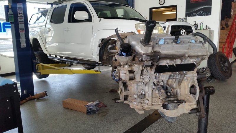

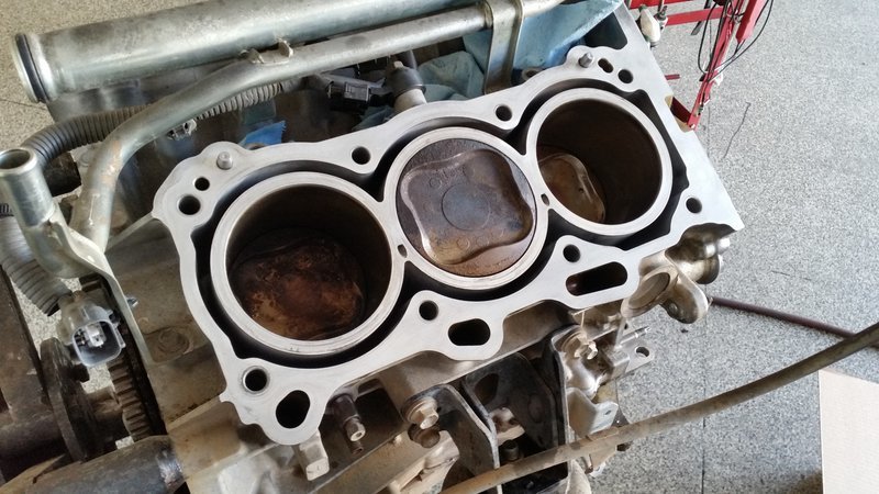

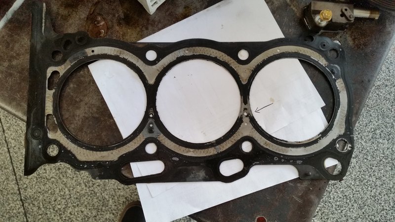

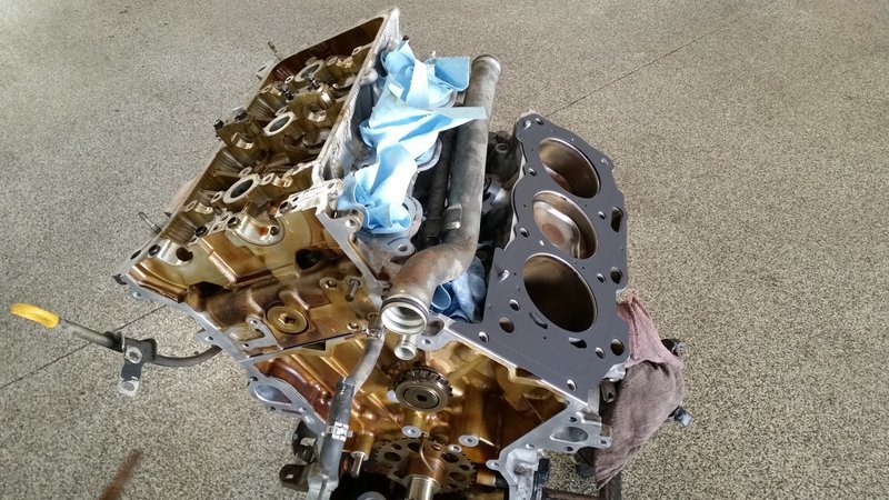

    We've done quite a few head gaskets on 03-05 4Runners/Tacomas with the 4.0. There has been a part number change for the gaskets which usually indicates a design/material change.
    They all like to leak at the tiny cooling port in-between the cylinder walls.
    Have yet to see a warped cylinder head or block.
    We found it easier to pull the engine out and do the work on a stand then struggling to do it in the vehicle. After doing an initial torque down, Toyota calls to tighten the head bolts an extra 180*. To do this in the vehicle SUCKS. It has to be exact as if you go past that 180*, you have to remove the cylinder head, replace the gasket and do it again. The gaskets are multi layered steel and rely on proper torque to seal correctly.
    In addition to the cylinder heads, the front timing cover is much easier to clean and reinstall when its directly in front of you. Making sure it's sealed correctly is important as if it leaks oil, it's a major job to tear it back down and correct it.
    Actually got one in the shop now - also a member on these forums.
