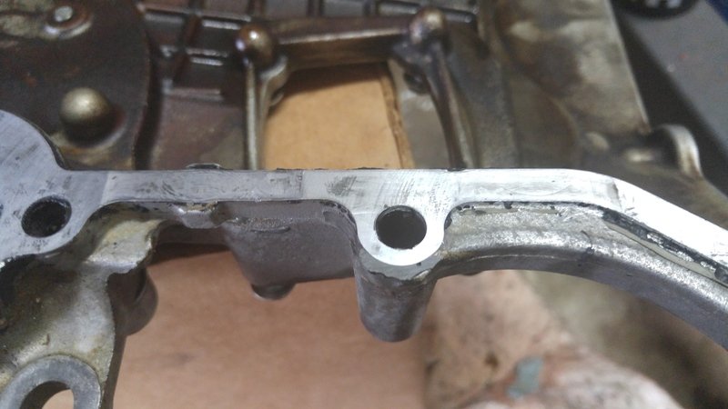

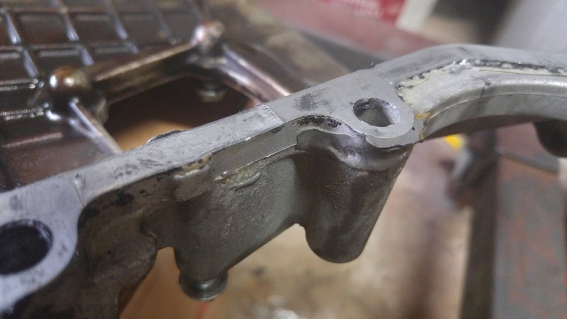

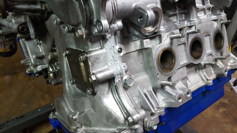

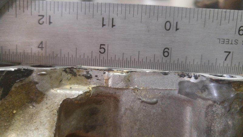

    Any tips on putting the timing cover back on? Does it like to leak from any one spot in particular, like where it meets the upper oil pan? I was planning to bolt the timing cover on and then the upper oil pan right after, hopefully before the gasket maker has time to cure. I have a couple tubes of the Toyota gasket maker since somebody told me it's better than ordinary RTV silicone.
    Also, do you have any opinion on reusing the timing chain? It has 167k miles on it. I pulled the chain tight, set it down, and measured about 5.55" between 16 pins, where the FSM specifies a max of 5.78", but the FSM also said to hold the chain taught with about 30lbs of force for measuring, which I didn't do...

    We don't pull the oil pan off and work around it. This is part of the reason it's easier to do out of the vehicle. In part, yes, it will leak where the timing cover meets the oil pan if it's not carefully put into place. It's easy to scrape the silicone off of the leading edge when installing. The other area it likes to leak is up where the cover meets the cylinder heads, the thickness of the sealing area is very thin. The factory Toyota silicone is great, as is the Permatex Import Grey stuff.
    We always reuse the timing chain. Never been a problem. We measured a few of them and they always check out well within factory specifications. Chain stretch/wear on them isn't really a "thing", they last forever.

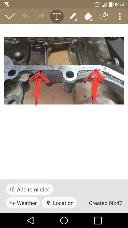

    Torspd Custom Turbo kit [] Borg Warner 9180EFR Turbo [] Haltech Elite 2500 [] TiAL Q BOV [] TiAL V44 Wastegate @ 15psi [] CP Pistons [] CP Carrillo Rods [] ARP Head studs [] ARP Main Studs [] ARP Header - Head Studs [] Ported Heads w/ 1mm oversized valves intake/exhaust [] Brian Crower Forged Stroker Crank [] Darton M.I.D. Sleeved Block [] Kelford Camshafts [] Torspd 160* T-stat mod [] APR Large Fuel Rail [] Walbro 460 LPH E85 Fuel Pump [] FueLab FPR [] APR T56 Conversion Kit [] KP RACING Built T56 [] McLeod Racing Custom Twin Disk Clutch [] One Piece Aluminum Driveshaft [] MGW Shifter [] Custom lowering kit [] Ohlins Front Coilovers [] QA1rear shocks [] Custom Ron Davis Radiator [] Dual SPAL Electric Fans []
    Near the power steering stand-off.

    My experience from my 04 4R, I did not pull the pan and slid the front cover on, and ended up mashing the oil pump o-ring, as well as sliding a bunch of the RTV off, ended up pulling the pan to reseal and change the o-ring, which is a giant bitch as you need to remove/move the diff and the rack to get access. This can be avoided if you pull the studs that are on the block so you can put the cover on at an angle instead of sliding it in front to back, @thefatkid told me this trick after it was too late for me. Same as @1MK on the chain, good to go.

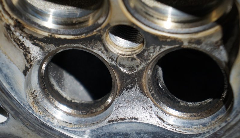

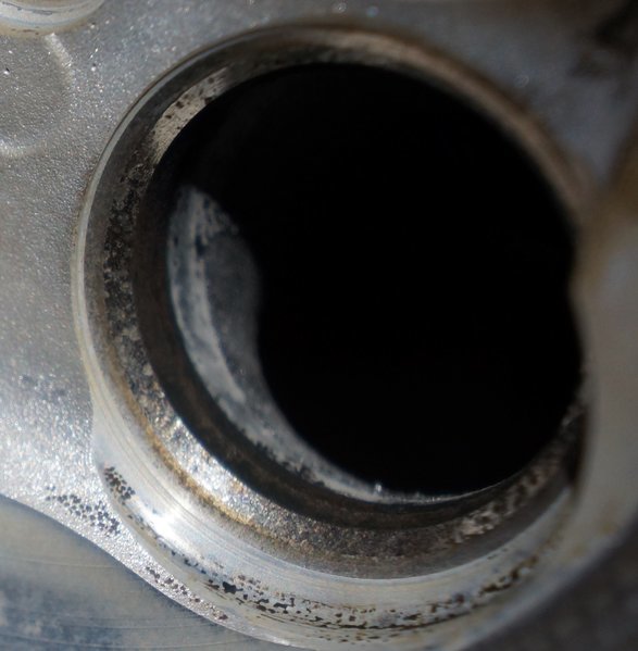

    I finally had time to clean up the heads and was about to reassemble them with new seals and put the engine back together, but I'm wondering about the exhaust valves now. They aren't as shiny as I was hoping they would be. Do I need a valve grind or is this ok?

    Close all of the valves. Add a few CC's of fluid, and see if it leaks out, or not.

    This ^.
    It honestly looks alright to me. There is no engine out there that will be free of deposits, especially on the exhaust side of things.
