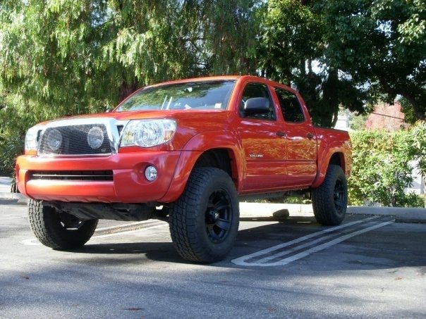

    2.5" lift with 17"x9" -12mm offset and 285/70-17 tires - (tires poke out from the fender about .5 - .75")
