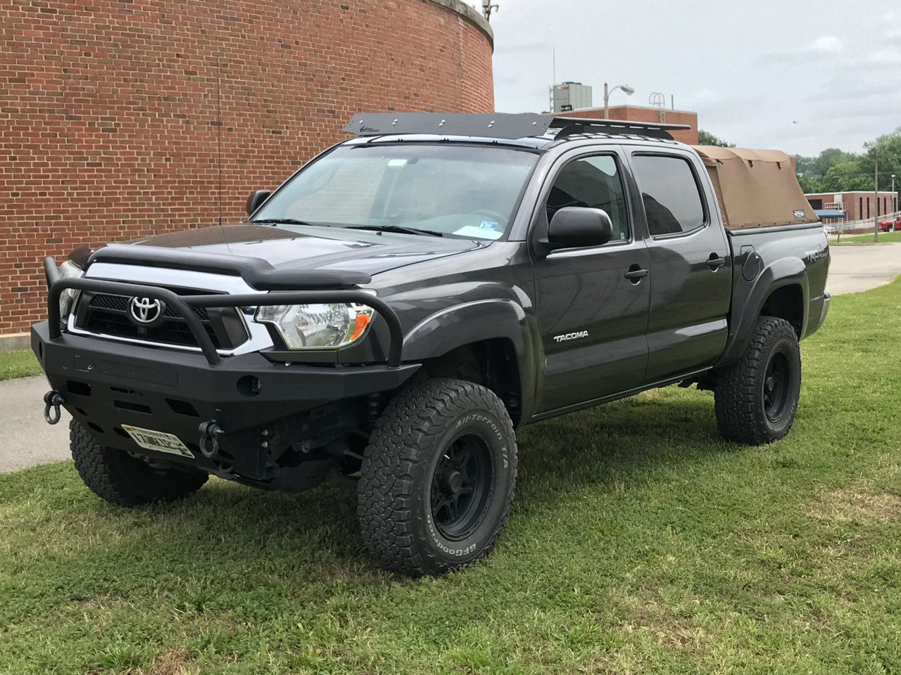

  8. Aug 23, 2019 at 11:12 AM
    WeishaarKC
    WeishaarKC [OP] Well-Known Member
    Apr 6, 2017
    #215526
    47
    Here's what I ended up making. I've had my RTT on it for a couple months without any issues other than the noise of having a tent up there. So far so good. I bought a replacement prinsu windscreen for a Tundra and welded mounts on for it because I didn't have a way of cutting one out myself without it looking like junk. I used the ARB rails discussed above, and I have a tubing bender and a welder so I made the rack itself. After making the thing I understand why they're so expensive. I wouldn't make one for someone for much less than what they cost because it's so time consuming.
